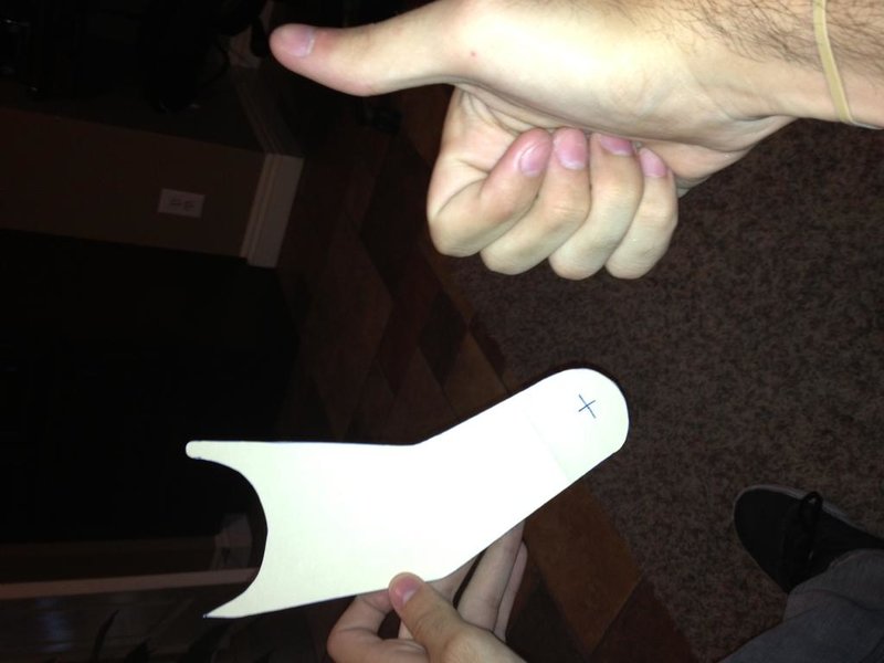

    No problem, I never send the middle part because that all depends on how far apart you want them spaced. I put mine at 2" apart and made some spacers to go outside the bottom of the shock. If you dont space them out enough the mount will hit the rod end of the shock when you flex
