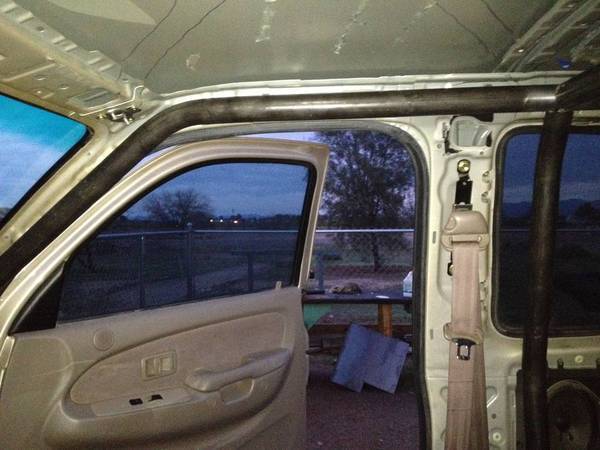

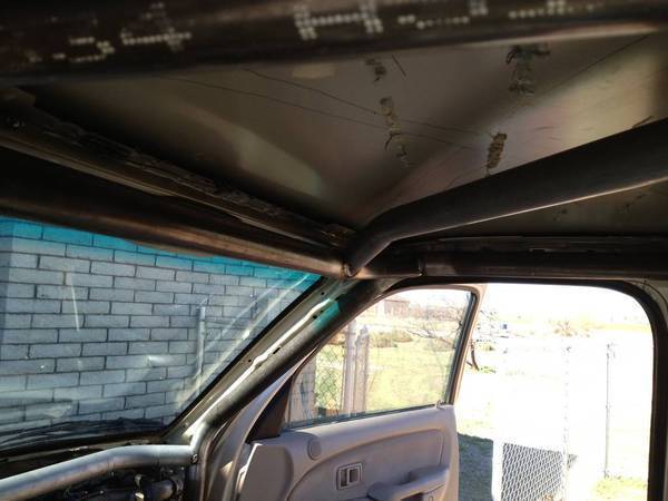

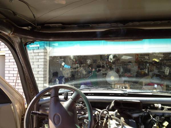

    Did a little work this weekend :D

    Dude...I think someone stole your airbag :cookiemonster:
  5. Mar 11, 2013 at 8:52 AM
    #605
    Cr250jumper
    Cr250jumper [OP] Señor member
    Dec 2, 2010
    #47033
    11,968
    The moon
    50 shades of tan©
    Tacoma with some stuff melted to it
    That was the hardest part of taking out the dash. I figured the plastic would come out and the airbag would stay. But there is actually two bolts behind the glove box that hold the air bag to the dash post and when you take those out the airbag comes out attached to the dash

    Why does your cage end just after your b piller?
  16. Mar 11, 2013 at 2:14 PM
    #616
    Cr250jumper
    Dec 2, 2010
    #47033
    11,968
    The moon
    50 shades of tan©
    I havent done the bars out of the back yet, that is next. Then drop it to 360 weld and then it will probably get the stock seats back in to DD for awhile

    So are you going to just tie into the Bed cage from there or at you going to add a c pillar bar as well?
  19. Mar 11, 2013 at 4:35 PM
    #619
    jberry813
    Jan 21, 2011
    #49636
    28,479
    Jason
    Lake Tahoe
    2012 DCSB Sport
    ...too much shit to list.
    He's not doing rear passenger seats.
    You can stop at the b-pillar and do all your crossbars at the b-pillar and stub out after to save on material and weight.
  20. Mar 11, 2013 at 7:27 PM
    #620
    Cr250jumper
    Dec 2, 2010
    #47033
    11,968
    The moon
    50 shades of tan©
    Exactly. No need for a double because I don't have back seats, plus I have uprights at the front of the bed that will tie into those just before it bends down. So if I did a c pillar bar there would be another one right outside the cab 6 inches away
