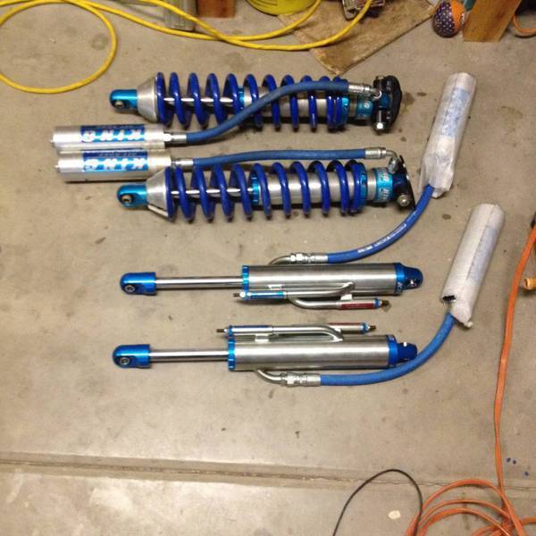

    Did you get new shocks or have them converted to remote reservoir?
  14. Feb 5, 2014 at 8:50 AM
    #874
    Cr250jumper
    Cr250jumper [OP] Señor member
    Dec 2, 2010
    #47033
    11,968
    The moon
    50 shades of tan©
    Tacoma with some stuff melted to it
    Those are 8's :) the ones I bought from your buddy are on the truck

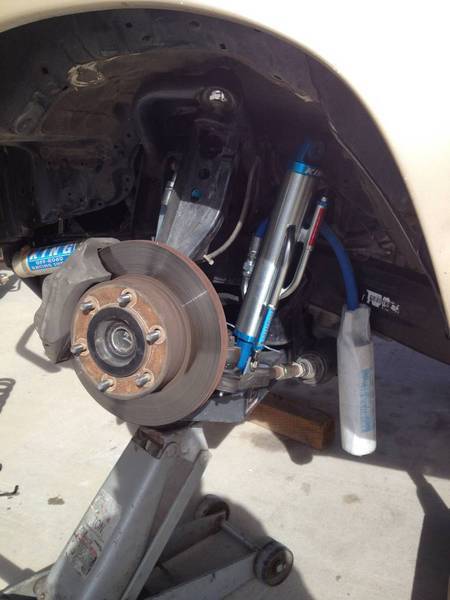

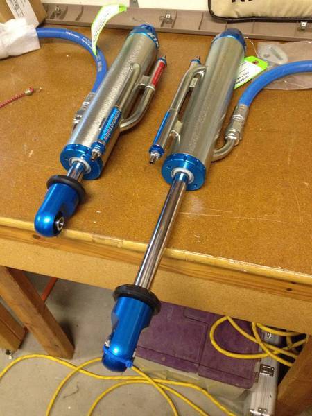

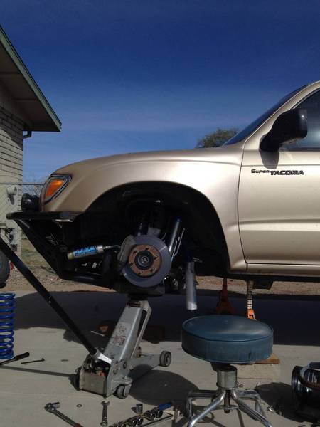

    Front coilovers rebuilt, was about time because the driver side was pretty much an emulsion shock. The divider piston in the resi was buried against the end cap so all of the air and oil was on the oil side. Has to remove the hose fittings just to release pressure so I could take it apart :eek:
    But then to mounting bypasses....
    Went for quick test and it made a world of difference, especially since my driver shock was useless
