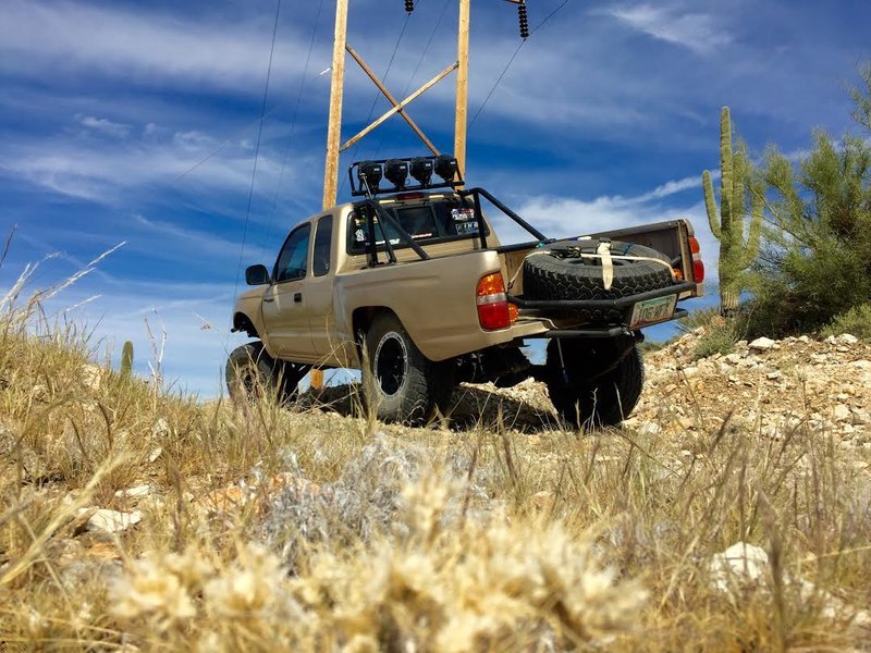

    Top hoop finally done and got some shots, Stefan and Cliff should know this spot

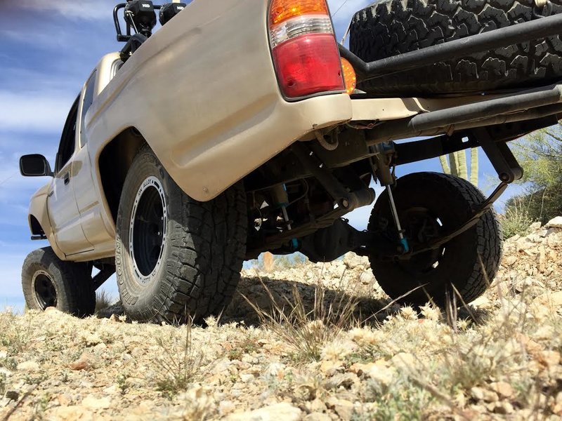

    Some more flexing

    Hey bud. How wide did you make your shock mount? about 3" or so?

    I think 2.75", I would have to measure. I know its at least the wide version of king misalignments plus at least a 1/2" on each side, you can see I cut spacers out of 1" tube to space it a little more the the misalignments. And even then the top of the mounts are round/thin because it was still hitting at gnarticulation

    The first set of pics yes :thumbsup: the other ones are just a field lol

    Technically my truck is in the photo too :)
