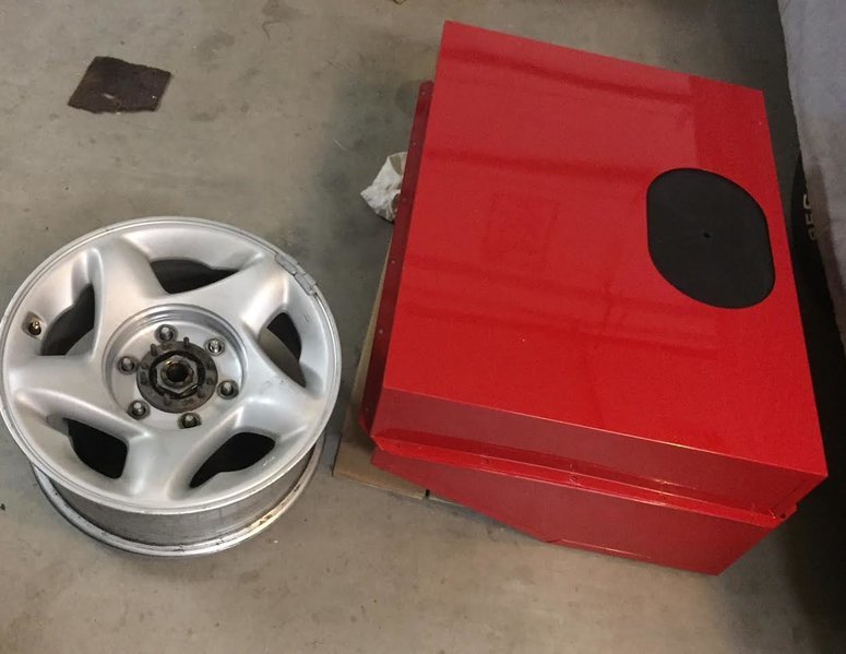

  16. Apr 24, 2017 at 8:35 PM
    #1176
    Cr250jumper
    Cr250jumper [OP] Señor member
    Dec 2, 2010
    #47033
    11,968
    The moon
    50 shades of tan©
    Tacoma with some stuff melted to it
    Yes sir. I need to trim these down a lot more but everything cut from the stock tank so it will all use original gaskets and mounts. Fingers crossed but me reason it shouldn't run just like normal

  17. Apr 24, 2017 at 8:38 PM
    #1177
    Cr250jumper
    Dec 2, 2010
    #47033
    11,968
    The moon
    50 shades of tan©
    Pretty much, was surprised nobody caught that wheel is sitting on a different hub... :)
