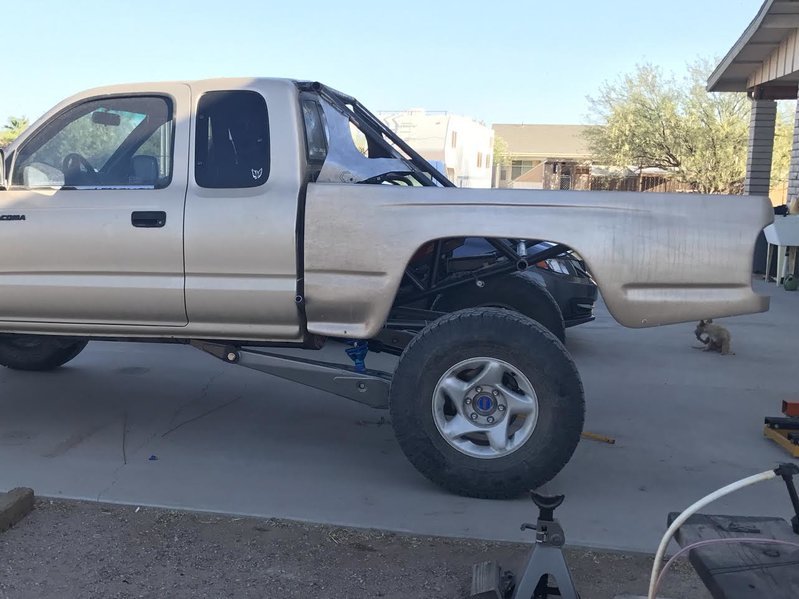

  13. Jun 12, 2017 at 8:48 AM
    #1233
    Cr250jumper
    Cr250jumper [OP] Señor member
    Dec 2, 2010
    #47033
    11,968
    The moon
    50 shades of tan©
    Tacoma with some stuff melted to it
    And its on its own weight :D still need to box and plate the shock mounts but it was enough to check and see how close I am on spring rate, tied up the loose wires and it drove around the block. Sitting a little high and zero preload but missing 27+ gallons of gas, spare tires, etc so it seems like spring rate should be close
  14. Jun 12, 2017 at 8:58 AM
    #1234
    jberry813
    Jan 21, 2011
    #49636
    28,479
    Jason
    Lake Tahoe
    2012 DCSB Sport
    ...too much shit to list.
    Are you using Explorer calipers in the rear?
  15. Jun 12, 2017 at 9:08 AM
    #1235
    Cr250jumper
    Dec 2, 2010
    #47033
    11,968
    The moon
    50 shades of tan©
    No calipers from a 83 Monte Carlo, rotors from a 89 Chevy K1500. The problem was Currie doesn't make an axle with center bore large enough for Toyota rotors so I had to use Chevy rotors, which also let me go to 14mm studs instead of 12mm. Then they make $15 ebay weld on brackets for the Monte Carlo calipers so they locate depth and height of the K1500 rotors. Plus they are super cheap, and they use a 10mm banjo so I could use OEM Toyota rubber lines from the hard line to caliper without re flaring anything
  16. Jun 13, 2017 at 9:32 AM
    #1236
    Cr250jumper
    Dec 2, 2010
    #47033
    11,968
    The moon
    50 shades of tan©
    Rough fender location, these should work
    j0shu4, XPOTRON, malburg114 and 5 others like this.
  17. Jun 13, 2017 at 9:38 AM
    #1237
    snowboard704
    snowboard704 Well-Known Member
    Jan 5, 2016
    #174104
    2,699
    Austin
    Jurupa Valley, CA
    03' 4x4 Tacoma
    Check Build thread
    Lookin good man! Come a long way sense I dropped by a few months ago for nitrogen with @Milota95 for my rear smoothies
  18. Jun 13, 2017 at 11:12 AM
    #1238
    MadTaco461
    MadTaco461 BRO runner
    Dec 30, 2009
    #28470
    13,423
    CA
    99 turbo 5 lug long travel
    Kinda stock
    The rear view of the coilover brace looks cool.
  19. Jun 13, 2017 at 11:20 AM
    #1239
    Cr250jumper
    Dec 2, 2010
    #47033
    11,968
    The moon
    50 shades of tan©
    Thanks and glad I could help!
    Yeah I wasn't sure if I liked the shape when I was making them, they had to bend a little farther than I originally planned but looking at the photos I like how they are going so far
