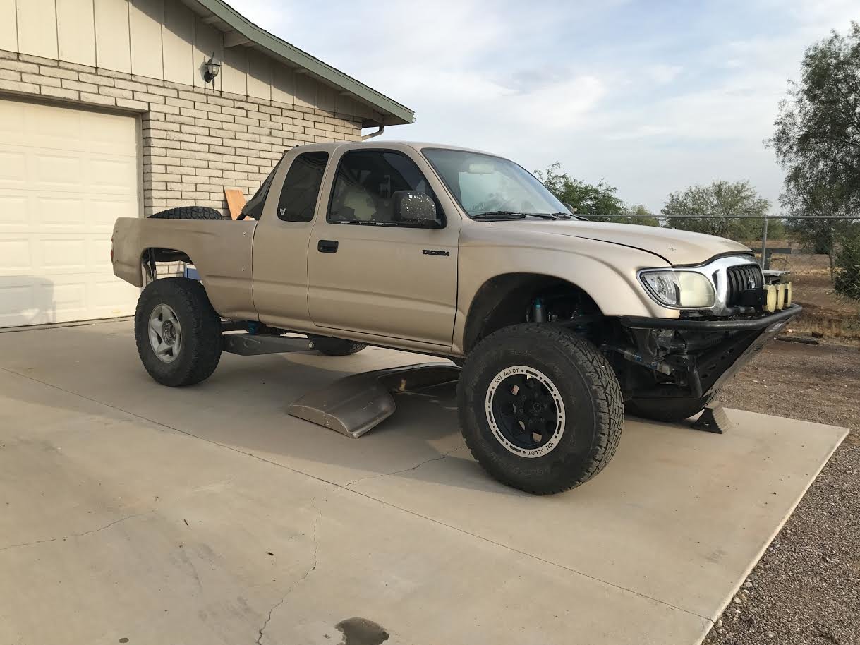

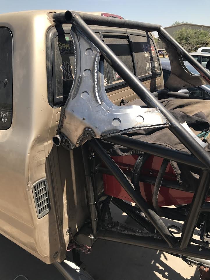

    front looks stock now..

    Tacoma with some stuff melted to it
    Lol I was thinking the same thing

    gonna have to trim those fenders

    Yeah, a lot of trimming will be needed on the rear

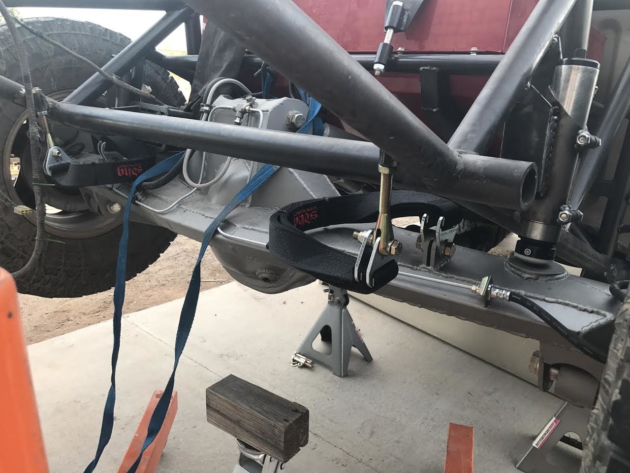

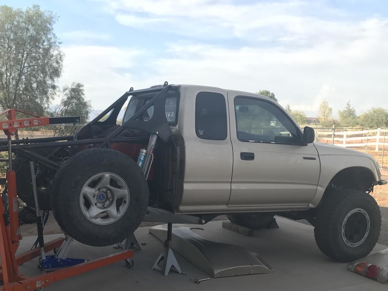

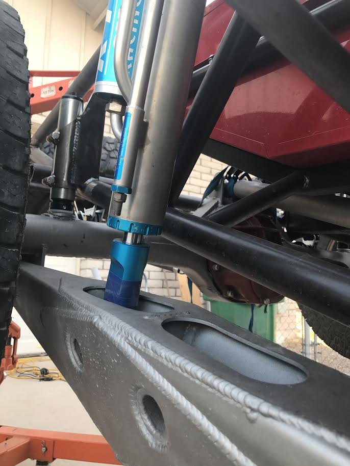

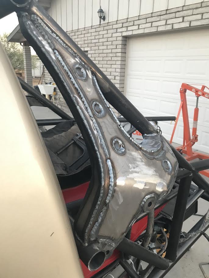

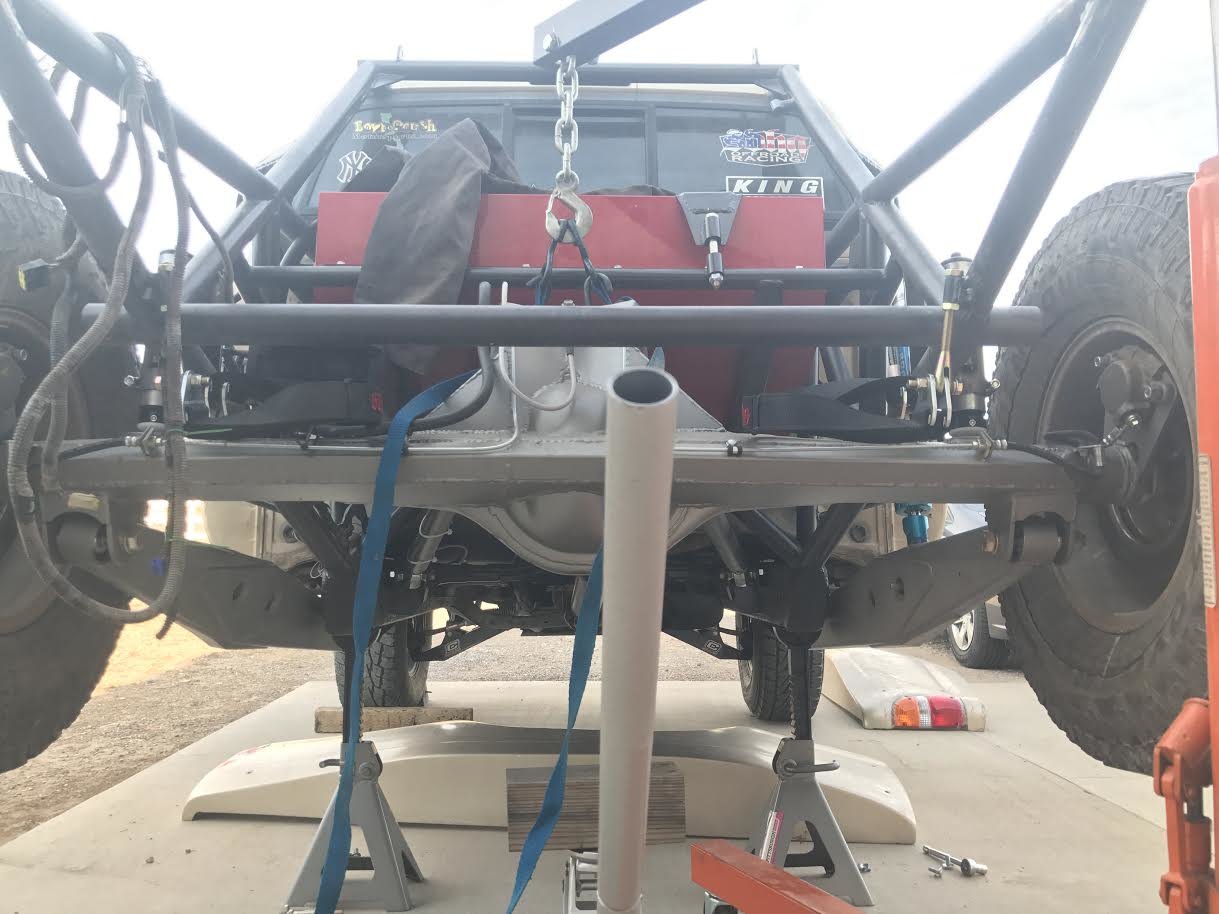

    Light bar tabbed, bump stops, limit straps, rear bumper and first spare started

    Yeah its a little high in the rear, might be ok once I get all the weight added but might need to step down a spring

    whats your spring set up right now?

    350/450 which works out to 197, if I step down to 250/450 it would be 161

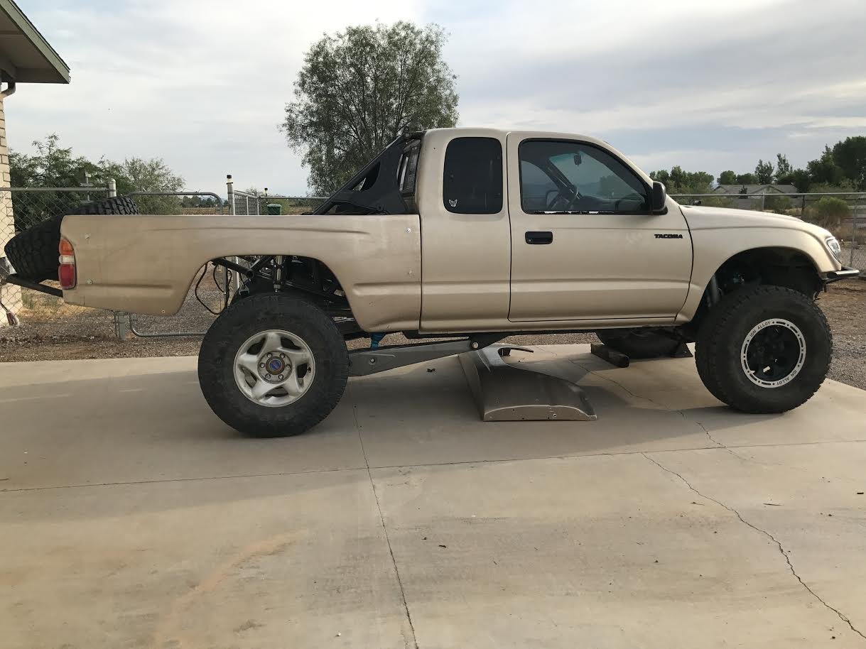

    Getting closer to ride height
    spare tire from @stumbles thanks!
