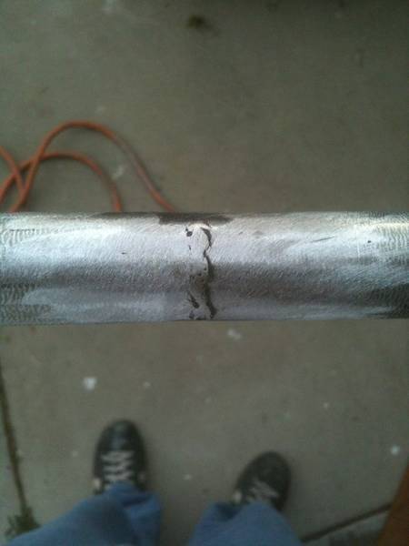

    I want to build something like that for my thule rack. the conduit bender bent the pipe ok?

    Wow nice job! Do you happen to know the weight? I think 1" may be overkill for me.

    Where are they located? You are getting me excited!
    I tried welding for the first time a few days ago. Did ok since this stuff is galvanized. I am going to practice one more time and then hopefully start. I have finals next week so I cannot start until after that. But then it's on!!!

    i have to go down the mountain tomorrow. working in orange. I want to go sometime this week because i need to make something for my spare tire to mount on the top of the cap. maybe a roof basket. something to mount the highlift and shovel rather than flying around in the bed. and a full size spare wont fit under my truck(i dont think)
    I can talk to Ninorth and maybe we can go to his house one weekend and work on stuff. ive got the chop saw, welder, work bench, and pretty much all the tools needed setup and ready to rock!
    you using MIG or flux core wire?

    Bending .065 is really easy with the foot bender I used .095 for a big truck and it was a bear. I just like the way 1" looks on the truck but 3/4" would be lighter and just as strong.

    Ok. Let me know. It's flux core.
    Might go this route than. I need to hurry up and decide.

    another tip is to get flux core "spray" it keeps the splatter down and keeps it clean looking... almost like welding with gas
  12. Mar 9, 2011 at 9:45 PM
    #52
    jdkeller
    jdkeller [OP] How many words can be fit in this s
    Nov 26, 2008
    #11040
    12,926
    Jonathan
    Inland Empire, Ca
    2008 Tacoma Prerunner TRD Offroad
    Dome light LED, 6000k HID Headlights and fogs, Grillcraft black mesh, rear 5100's, Total Chaos UCA's, 285/75/16 BFG KM2's, Spidertrax spacers, Blacked out emblems, cb,kenwood tm270 ham radio, All Pro 3" leaf pack, Fox 2.0 coilovers, Revenge Fab Sliders, u bolt flip kit, Pioneer avh4200, bed bar with light and antenna, Wet Okoles, Weathertech Mats, Wet Okole Armrests, Rear KR Fab bumper, bed mat, N-Fab spare tire carrier with full size spare on 16" TRD rim, Bedlinered flares and grille. Camburg Spindles, All Pro front fenders.
    Do you just spray the area your going to weld first and then weld?

    yep and the splatters just wipe off.

    Definitely need to get some then. Thanks.

    HOLY SHIT....
    ok people, only going to say this once...
    WELDING GALVANIZED PRODUCES ZINC-OXIDE FUMES!!!!
    Unless you have a full face welding hood, or you want a new cancer named after you, welding galv is ill advised...
    People get paid a lot of money to do this professionally, because there is more to it then meets the eye.

    Thanks for the reminder :)

    I'm an electrician. Don't use conduit for welding. Especially emt. If you must I'd use imc or rigid.
    But regular steel tubing is better to weld with.
