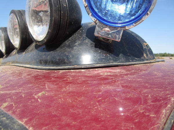

    Finally got my lightbar in the mail!!![​IMG] I snagged 'em off ebay for 70$ plus another 4 i bought for another 70$
    Got everything installed and its oh so easy to do. The light bar is made of molded plastic with the lights bolted on and comes complete with a wiring harness and everything you need to install it basically. It uses 3m adhesive to attach to the roof, and lemme tell ya, it sticks! i can pull on it all day and it'll rock the truck before it gives (it hasn't). It does fine on the road, and i'm pretty sure i'll be using a razor if I ever want to take it off.
    (can you kinda see the gaps where there was no adhesive?)
    Sadly, the major downfall is that you can't adjust your lights without cutting an access hole somewhere once it's mounted, so i had to be double sure they were where i wanted them. there is also a small gap between the roof and the light bar in a couple spots (for some reason they didn't want to run the adhesive the whole way across) and theres a good sized gap in the back since the back of the bar is flat and the cab is curved... I'll have to seal it all up with some silicone soon. Also It only came with four lights, and it looked too narrow for the pickup so i went to o'reillys and bought a cheap set that i mounted on the sides to make six. looks alot better that way. I also bought a couple smaller ones to mount for bed lights someday. I haven't got around to it yet since ill be on vacation in washington tomorrow through the 7th.
    but anyways, here they are!
    I made the side lights point off to the side a little since the original 4 are pretty much set straight and can only really move up and down.
    Before
    After install

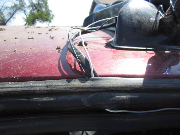

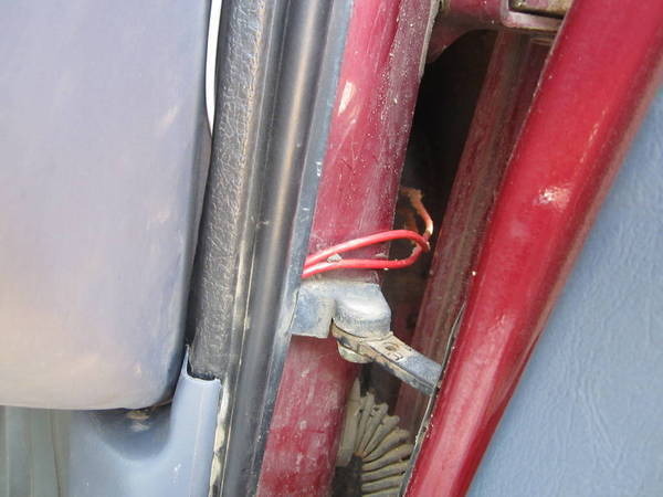

    Grey Wire Locker Mod, 3" coil spacers & custom leaf packs, 2" BL, Skyjacker rear nitro shocks, Monroe front gas shocks; 15" eclipse sub & 1400 watt visonik amp with Kenwood stereo, Billet Petals, Black Aries series Grille guard, ebay baja lights (unsure of brand)

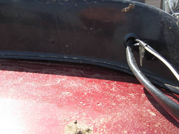

    Down through the weather stipping on the passenger door since thats the way they were designed for. Dunno why though, i would've preferred driver's side. I'll get more detailed pics as soon as i get back to my truck next week.

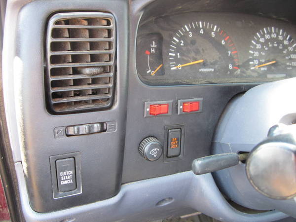

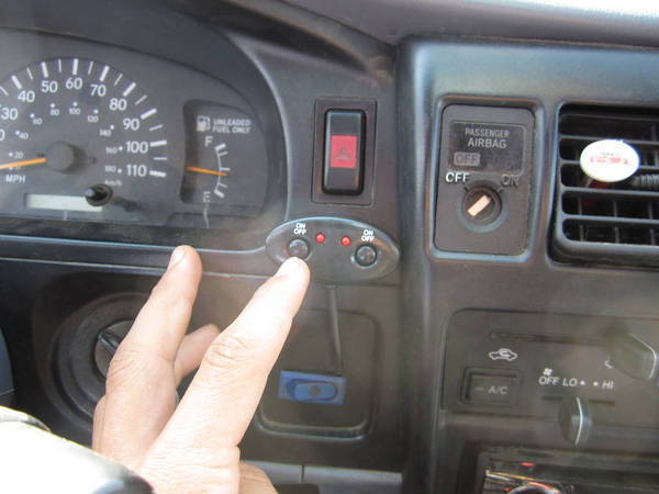

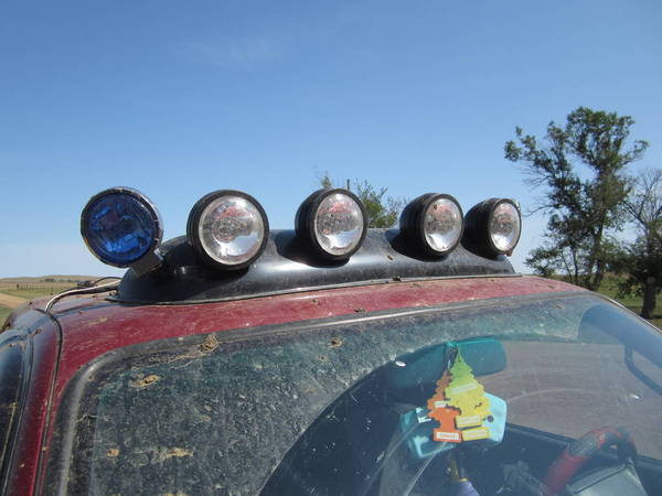

    Heres some more pictures of my lights. I'm hoping this will help clarify for everybody. As you can see the fit is not perfect. I need to wash my truck and then let it dry good so i can silicone around the whole thing and hopfully keep it from ruining my roof underneath.
    All of my relays and fuses are stuffed underneath the gray cover that pops off on the side. From there i ran a main power wire through the fender where the intake goes and to the battery. all of my switch wires i ran to the other side along the firewall and since the switches are grounded i just did that on any metal i could find in the dash.
    Everything works great! Its budget lighting, but for something i might use once a month i didn't want to drop a shitload of money. It works for me.
    Heres the switches. I know, i did a shitty job on the blue one. That was a previous project for my brushguard lights and i did it like a noob. I'm not a real big fan of the switch provided for the light bar since it didn't come with a way to mount it. I'll just use velcro buttons on that.

    It would look funny with just four because it wouldnt be wide enough plus the 2 on the side point down and out to the sides...that helps alot
