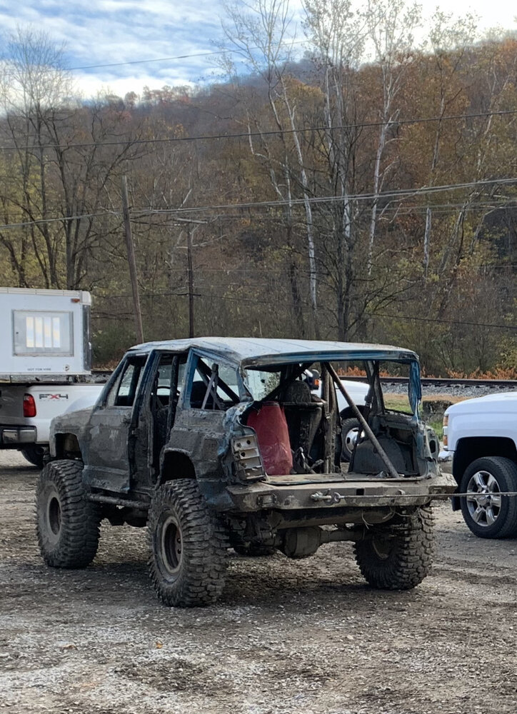

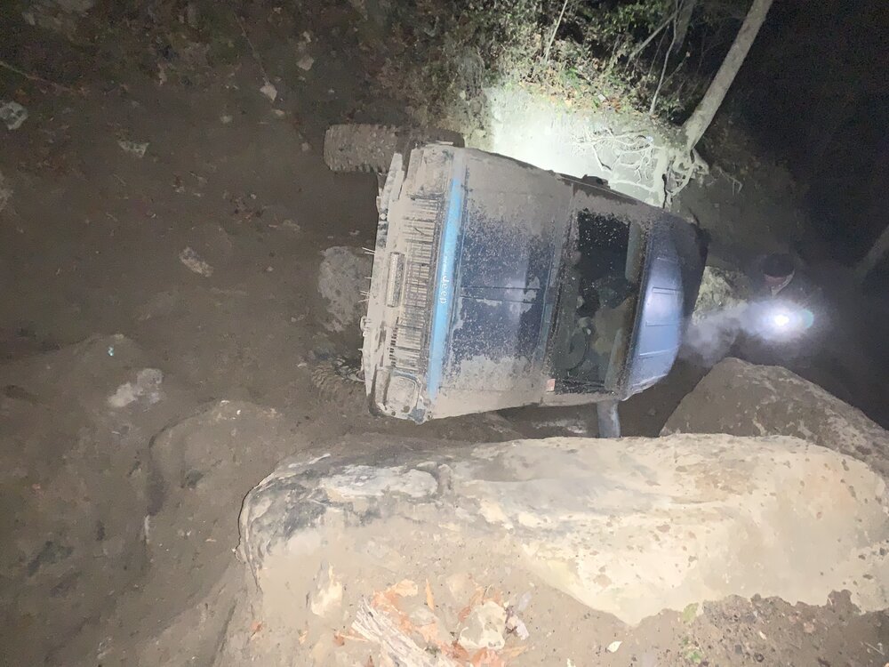

    I would not swap a Dana 35 or 30 into a Tacoma regardless how built they are, there are people running 40"+ tires on stock Toyota rear axles, a built 35 can't handle that. I would do one of 3 things:
    Pick up a cheap xj body and swap everything over that that and have fun bashing it off trees.
    Put a cage in the xj as is and embarrass everyone on the trail regardless of how rusty the floor is.
    Scavenge as much as you can suspension wise off that kit, and sell the axles to a jeeper for $$$ and build a new front axle for a Tacoma.
    To put it in perspective, this xj I wheel with is setup kind of like the one you describe, has a full cage on 35" sticky SXS tires and regularly embarrasses built trucks and buggies.
    DC583E84-FAF3-448E-A55C-692E1DB21503.jpg 7C04A140-3ACF-4140-BC0E-E31975224177.jpg
    Do not swap those axles into a Tacoma no matter what you do.
