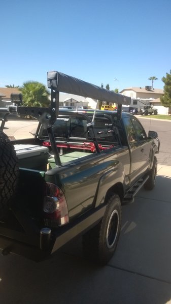

    Yes that sounds like a good idea. But make them very secure to handle the rigors of serious off road in the "low" position. And for reference ARB reccomends three mounting brackets for serious off road. I added a third center bracket on mine.WP_20160812_09_58_05_Pro.jpg

    I know that looks high, but I can stand up under it with a couple inches clearance, and it is no higher than the RTT when both are mounted.
