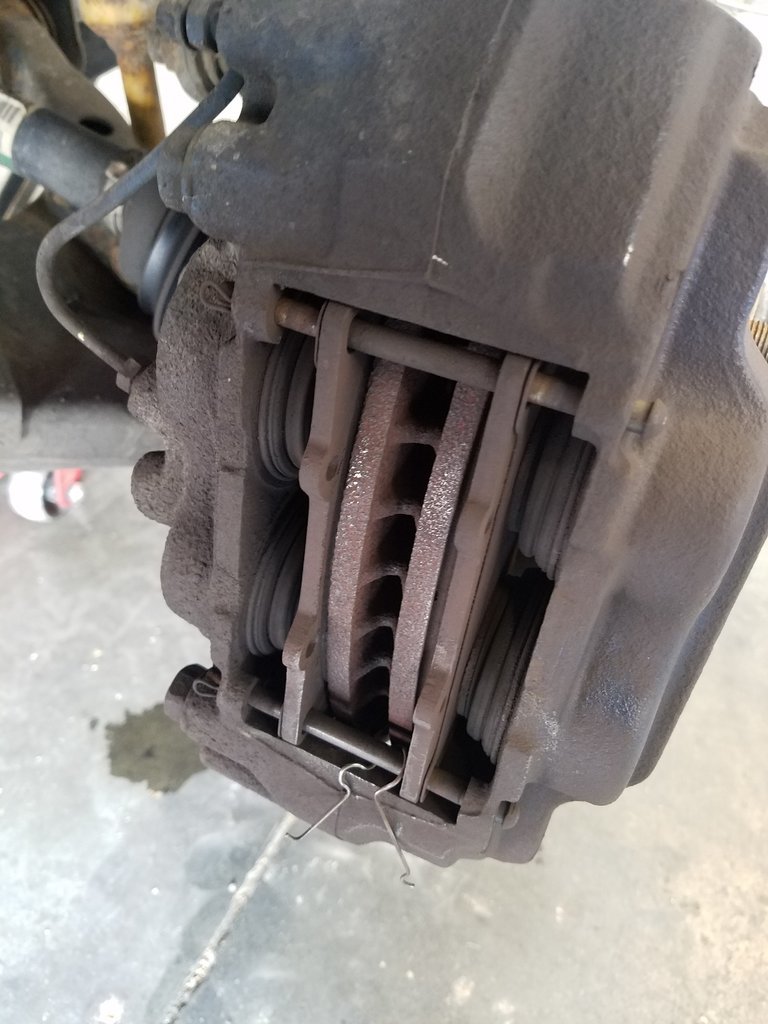

    Wonder is you have a brake caliper hanging (rust where caliper slides) or pistons in caliper starting to seize up? Have you noticed more brake pad dust on the right front rim? After a short drive feel the left front rim then the right rim and see if it is warmer. Careful because rims might be a little hot. Good luck.
