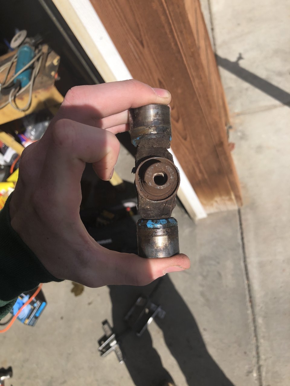

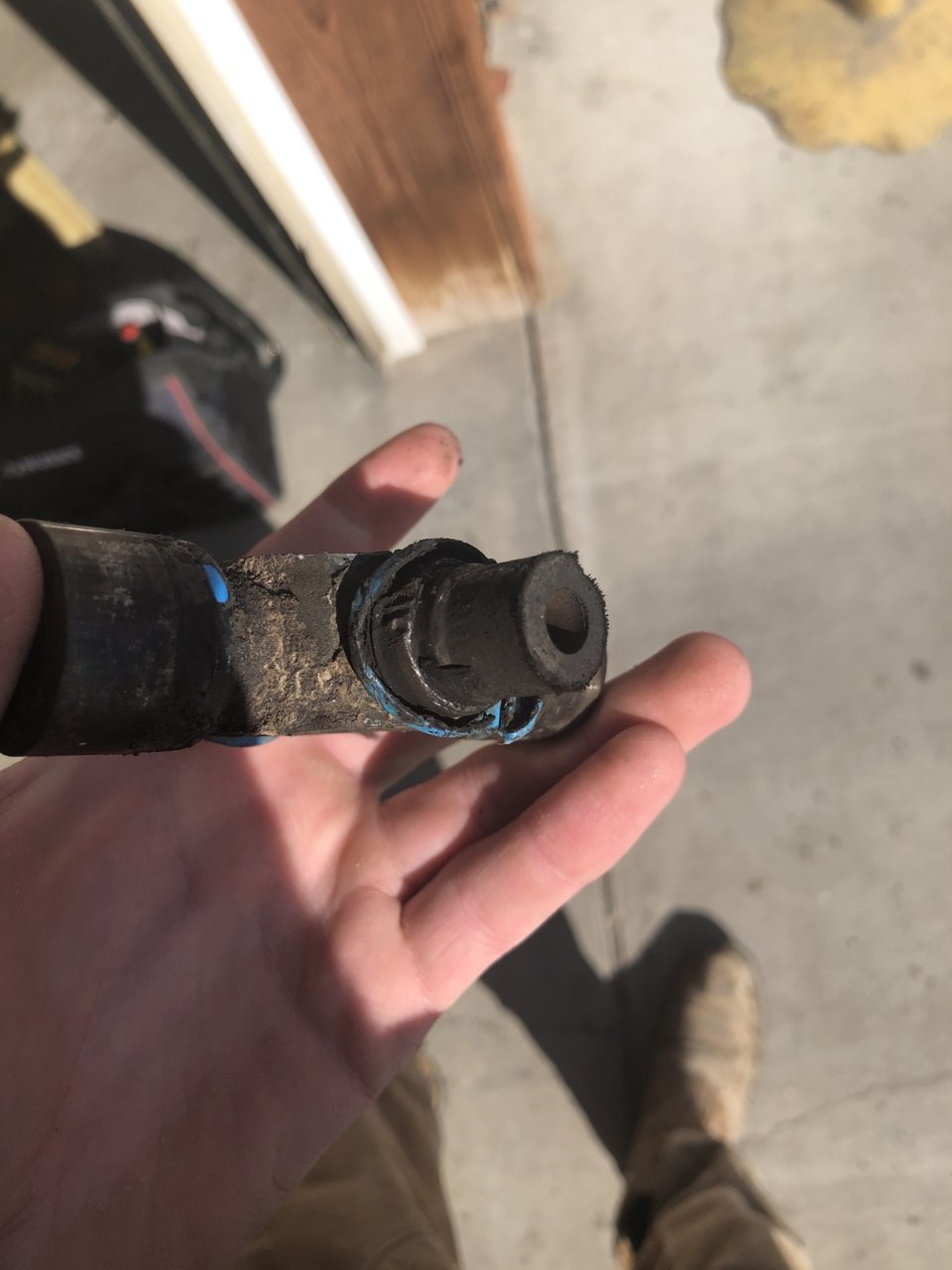

    Well I've been hearing some strange noises coming from the under side of my truck for about a month. I looked under there and the center support bearing had about 2 inches of play in it so I decided I should changed that out... but when I took off the rear drive shaft yoke I noticed the rear u-joint was toasted. Like really toasted see below. Hopefully this should help with the 14-15 mpg I've been getting the last month or so.
    and the opposite side

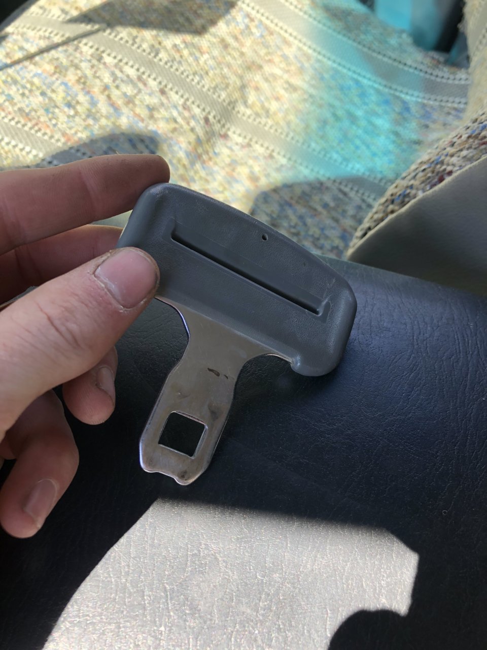

    In other news me and my friend were looking around the local junkyard for exhaust pipe and other random assortments and I found the seat belt clip from a 07 tundra.
    I've been thinking of making one because when my dog rides in the front seat he sets the seat belt alarm off and I have to buckle the seat belt which he sometimes gets tangled in. This buckle is not going to be used if an actual person is riding in the front seat but only my dog or other heavy stuff that can't be buckled in.

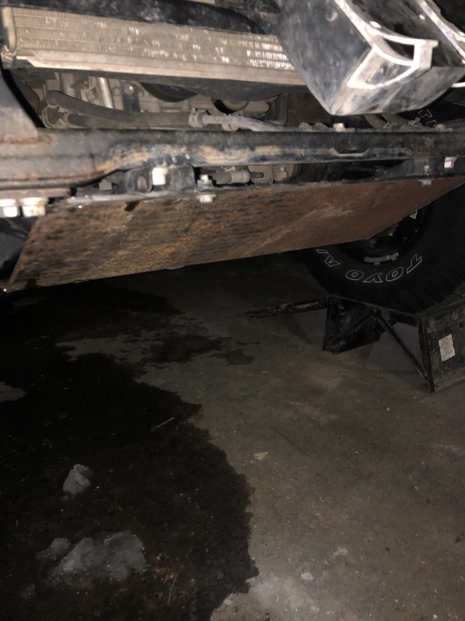

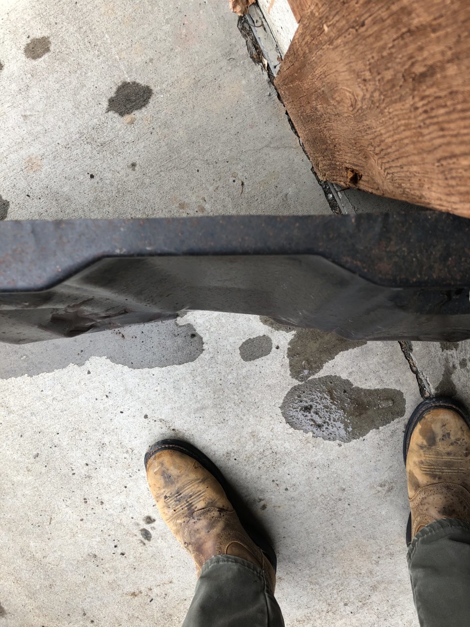

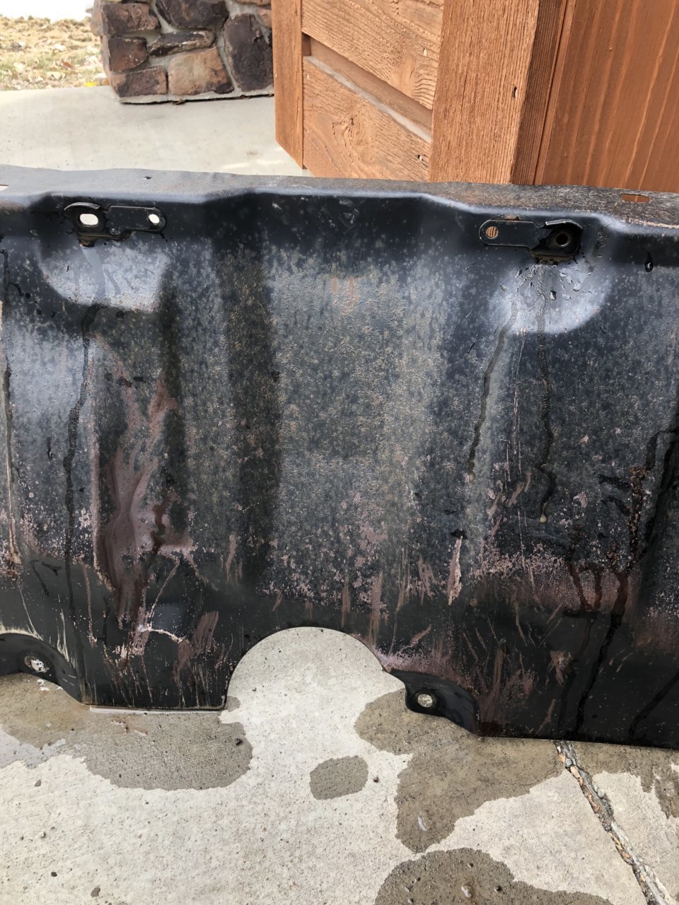

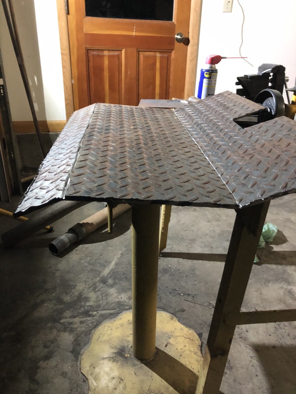

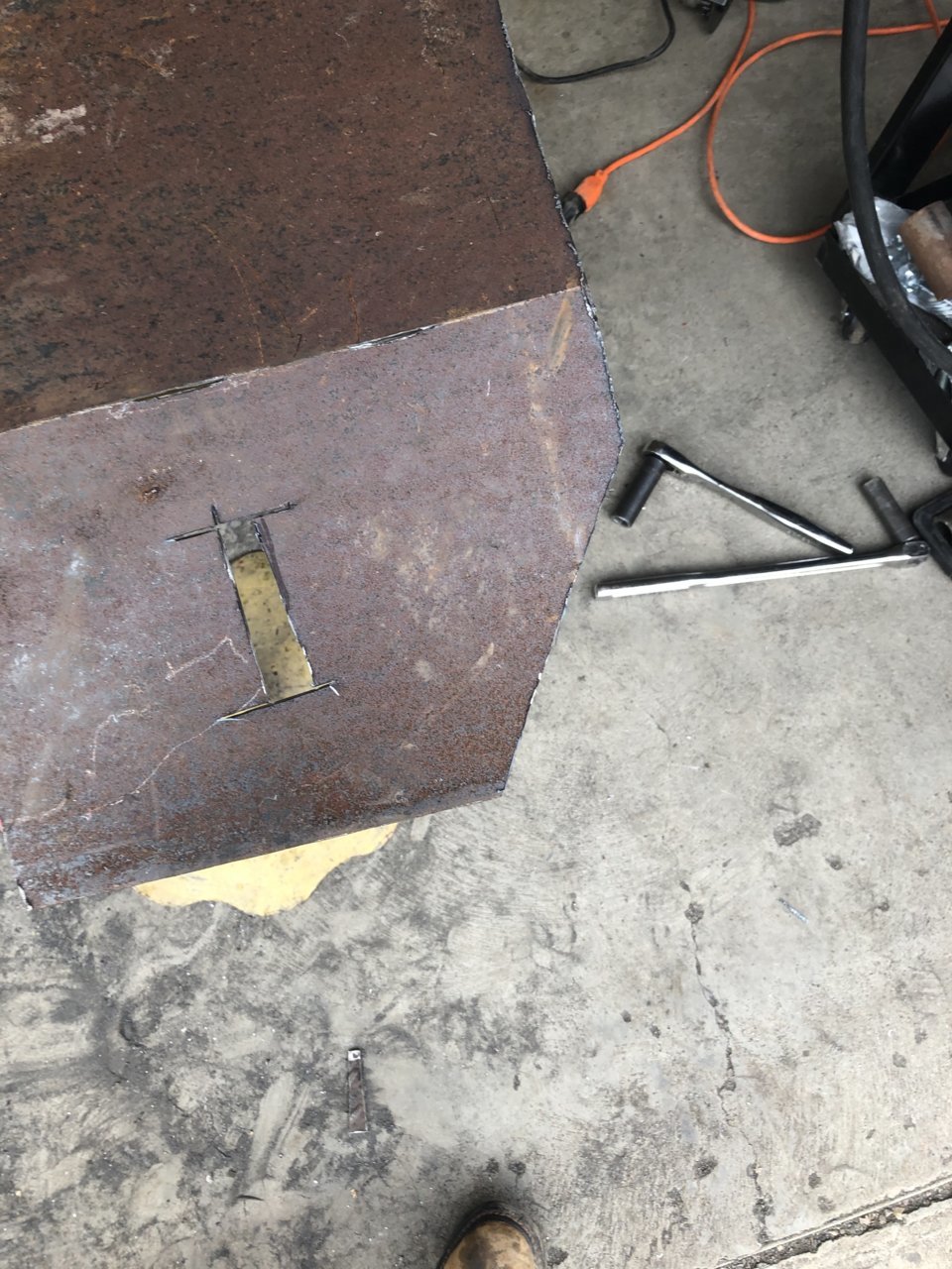

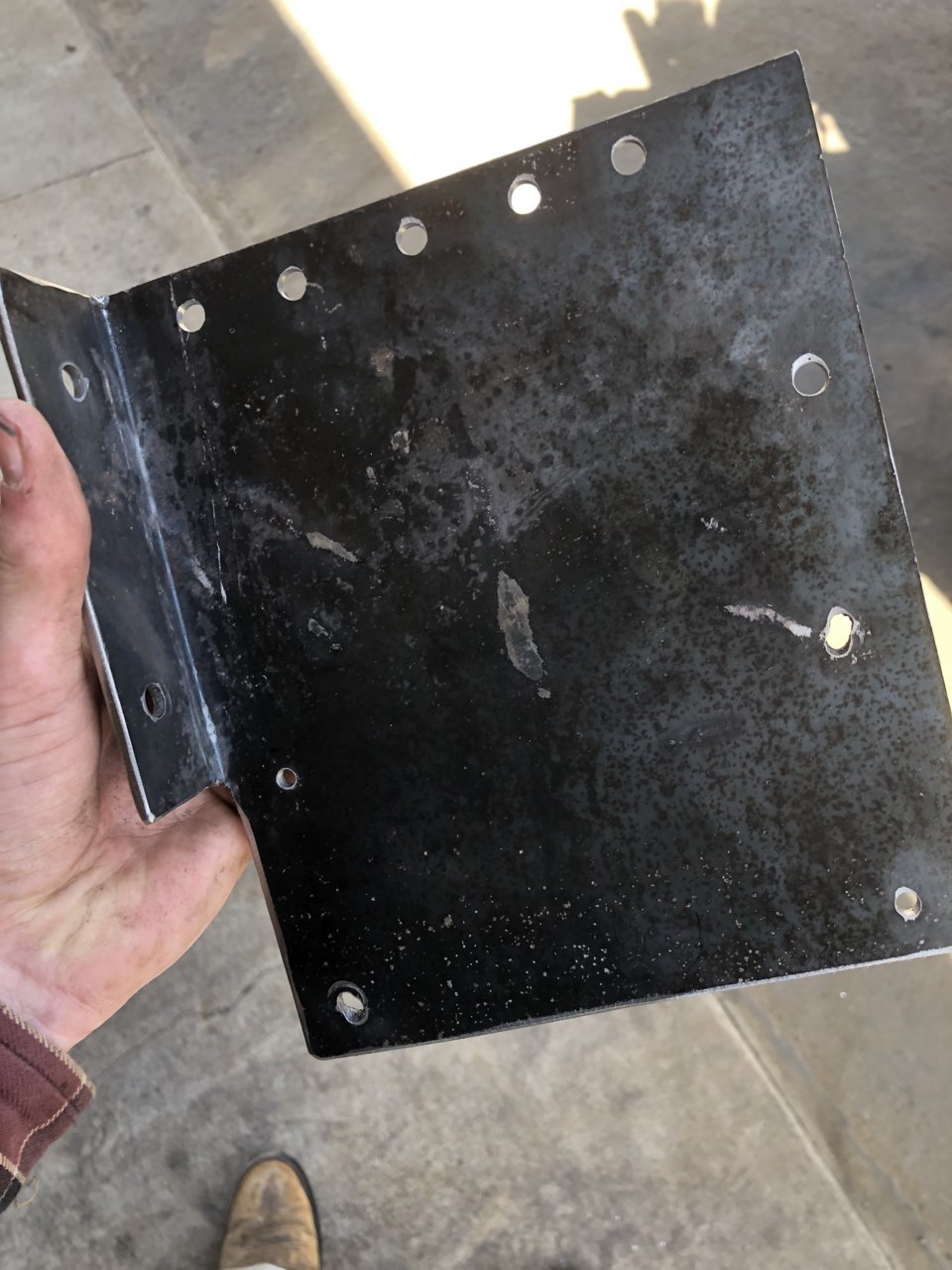

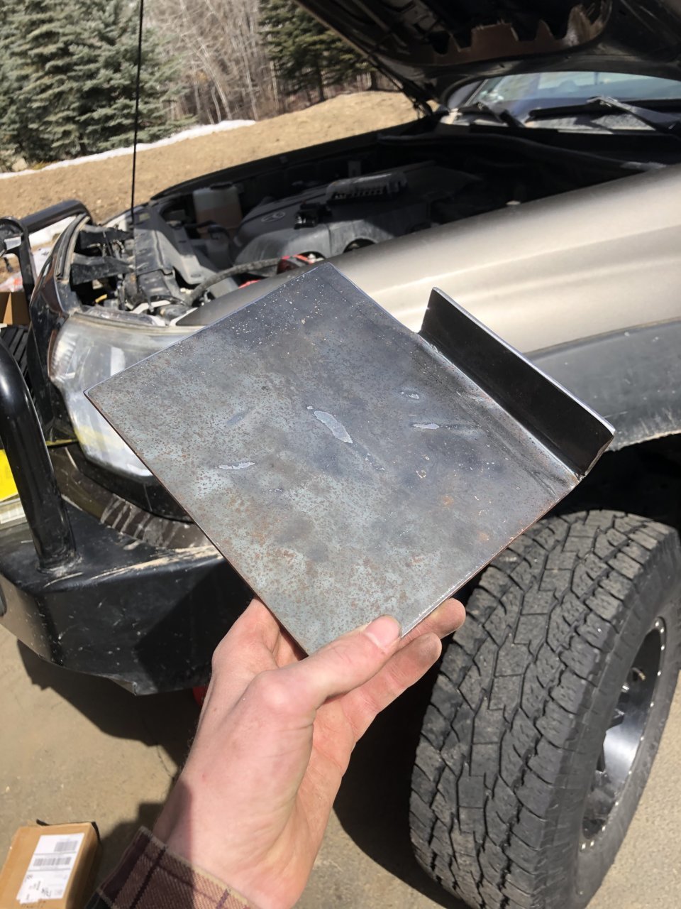

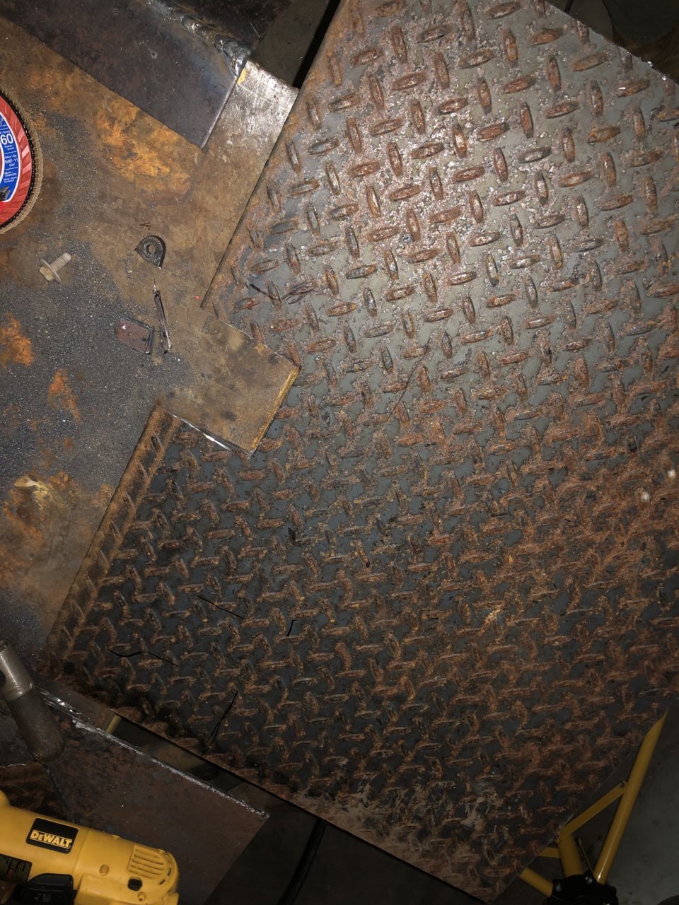

    Well I noticed that my original front bash plate was dented in, and because I was going to pull my front bumper off for some other maintenance and upgrades I figured I should just make a new one to beat up on.

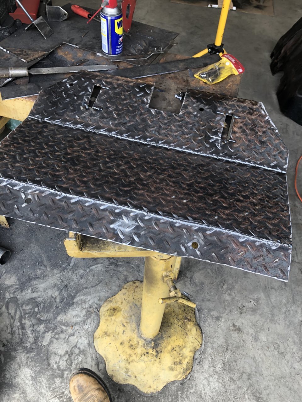

    step one find large thick plate and cut out rectangle

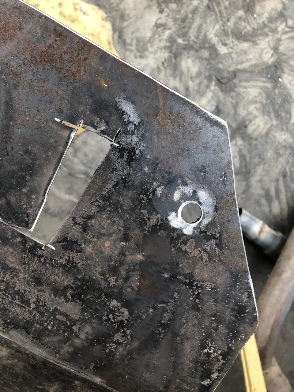

    step two cut out space for the lift thing in the middle
    Cut about half way through with a cut off wheel then bend it by hand, ok bend it a little more... good. Now do it again on the other side.
    now cut it up some more to make more room for stuff
    Now drill out the holes to mount it up and grind all the sharp edges off so you don't cut your hand every time you move it.
    optional :weld the seams and anything else you want cause you need more practice

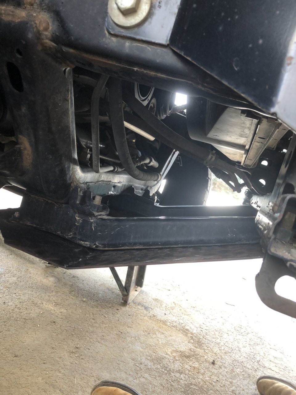

    Now you get to bolt this cut up hunk of metal to the truck. Make sure you strip out and cross thread 2 of the 4 bolts because your an idiot but its on your truck and all 4 bolts are in...

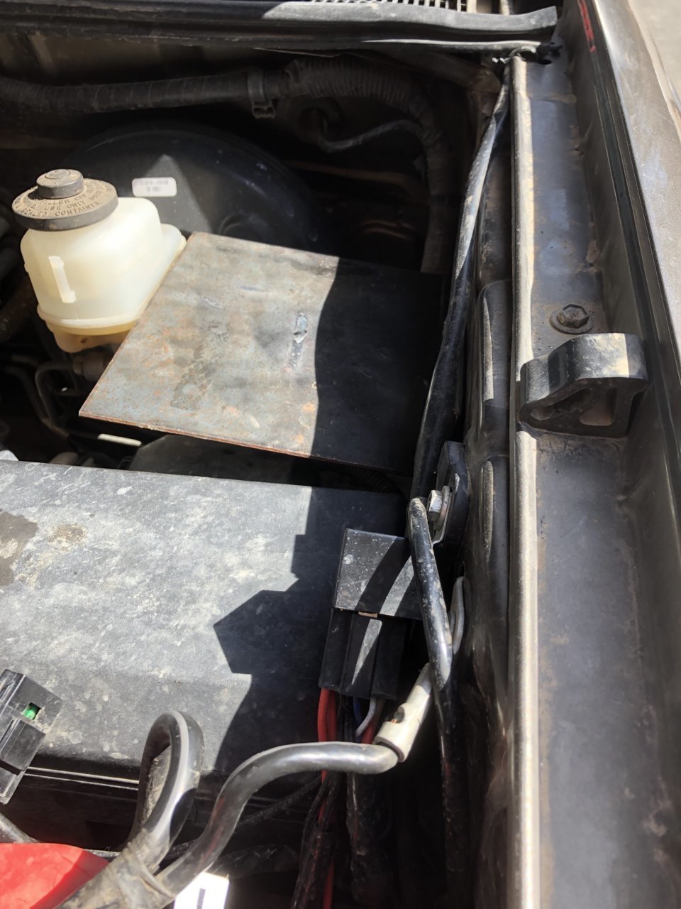

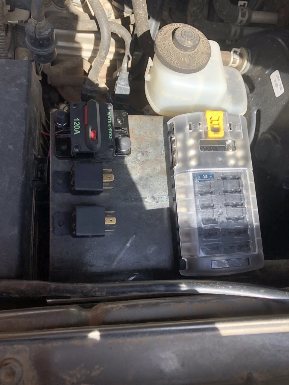

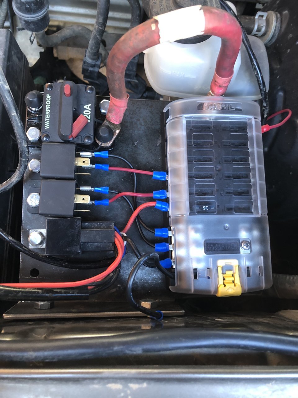

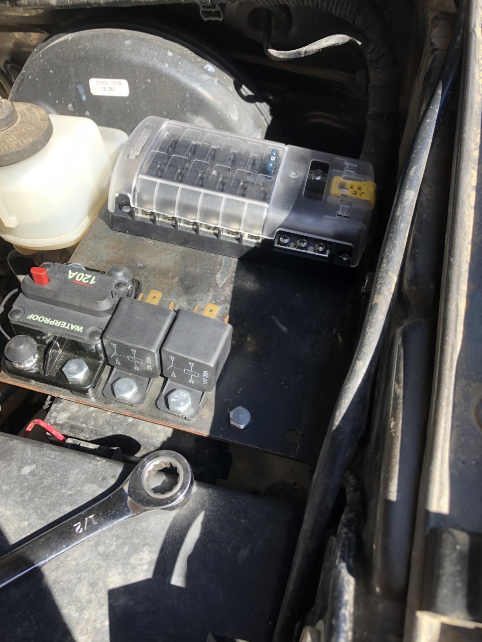

    I started on my auxiliary electrical today, I got the breaker, fuse block, and relays mounted to a plate. Hopefully my bed light strips and switches get here soon so I can add them on.
    Finalize placement of everything and mark for holes
    Now Swiss cheese the plate
    Check clearances and grind down any bolts that interfere
    And wire everything together on the board
    Yes the ground is only a 14g wire, it will be swapped out when I can get a proper ground cable. I will also be running wire to the rear of my truck and all around so the fuse block will start to fill in once I have all then wiring finished.

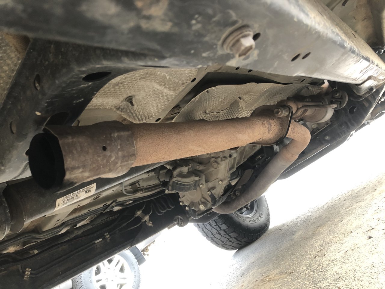

    Lots of cool upgrades. I gotta ask tho, why remove the muffler? did you replace it with anything?
  6. Mar 23, 2020 at 6:33 PM
    #26
    Jensonbt
    Jensonbt [OP] Well-Known Member
    Dec 15, 2018
    #275931
    1,006
    Beckler
    Idaho
    2012 gray tacoma DCLB
    Just enough to look kinda cool.
    As I said, I've been hanging around with my redneck friends too much. We go to the junk yard often so when we were there last I found an exhaust section off a 04 4runner (same motor as a 2 gen). So I just bolted that on and it took away all the in cabin droning but leaves a similar exhaust note.
    I live in semi rural Idaho so I don't have to worry about passing emissions even tho I still have all the cats. And it still isn't something really loud it just opened up the sound more.

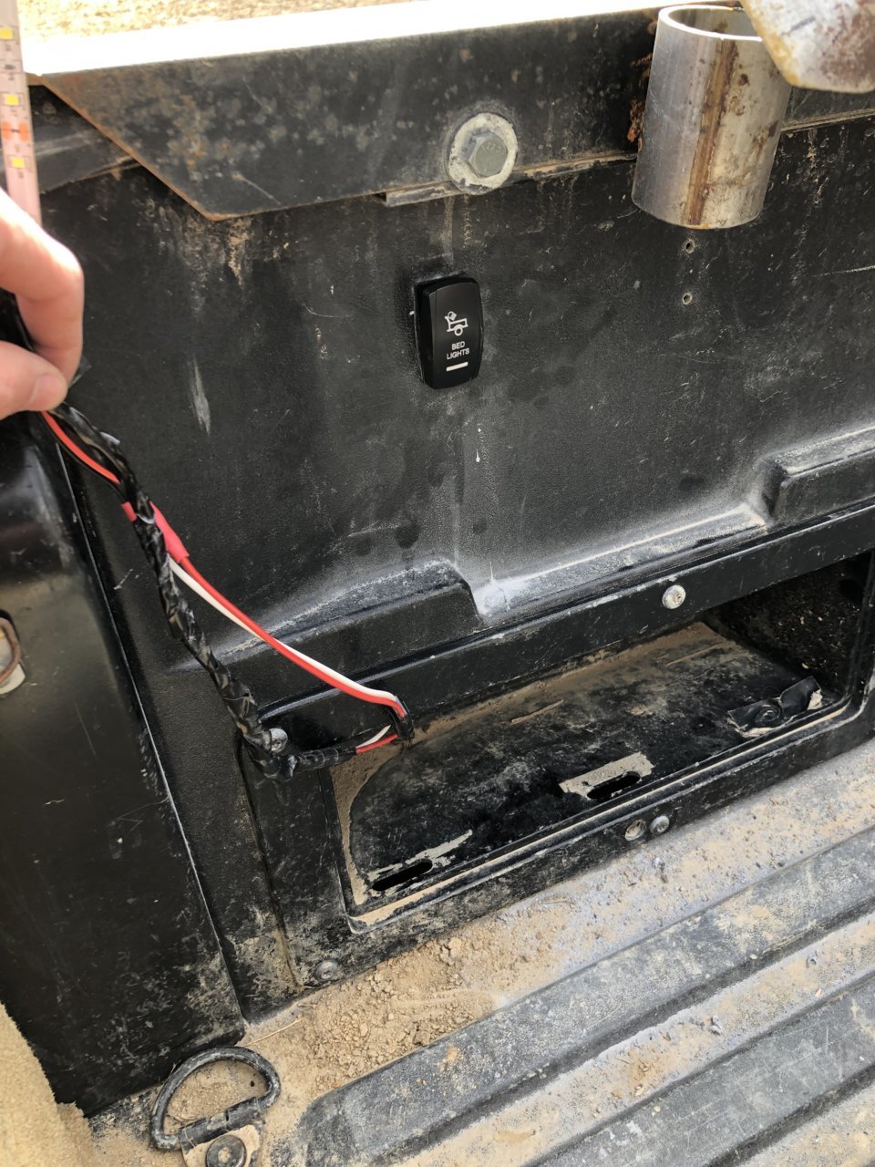

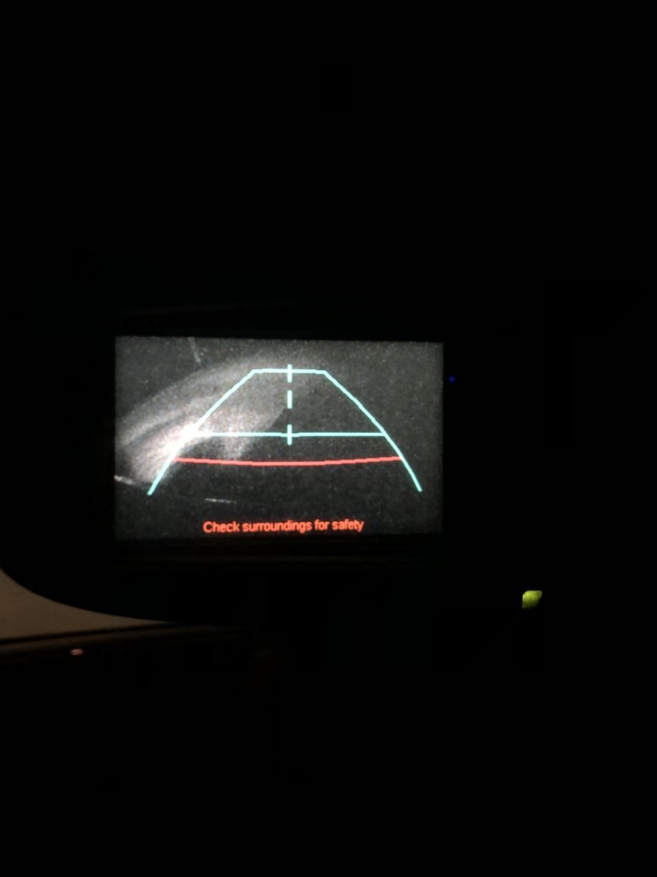

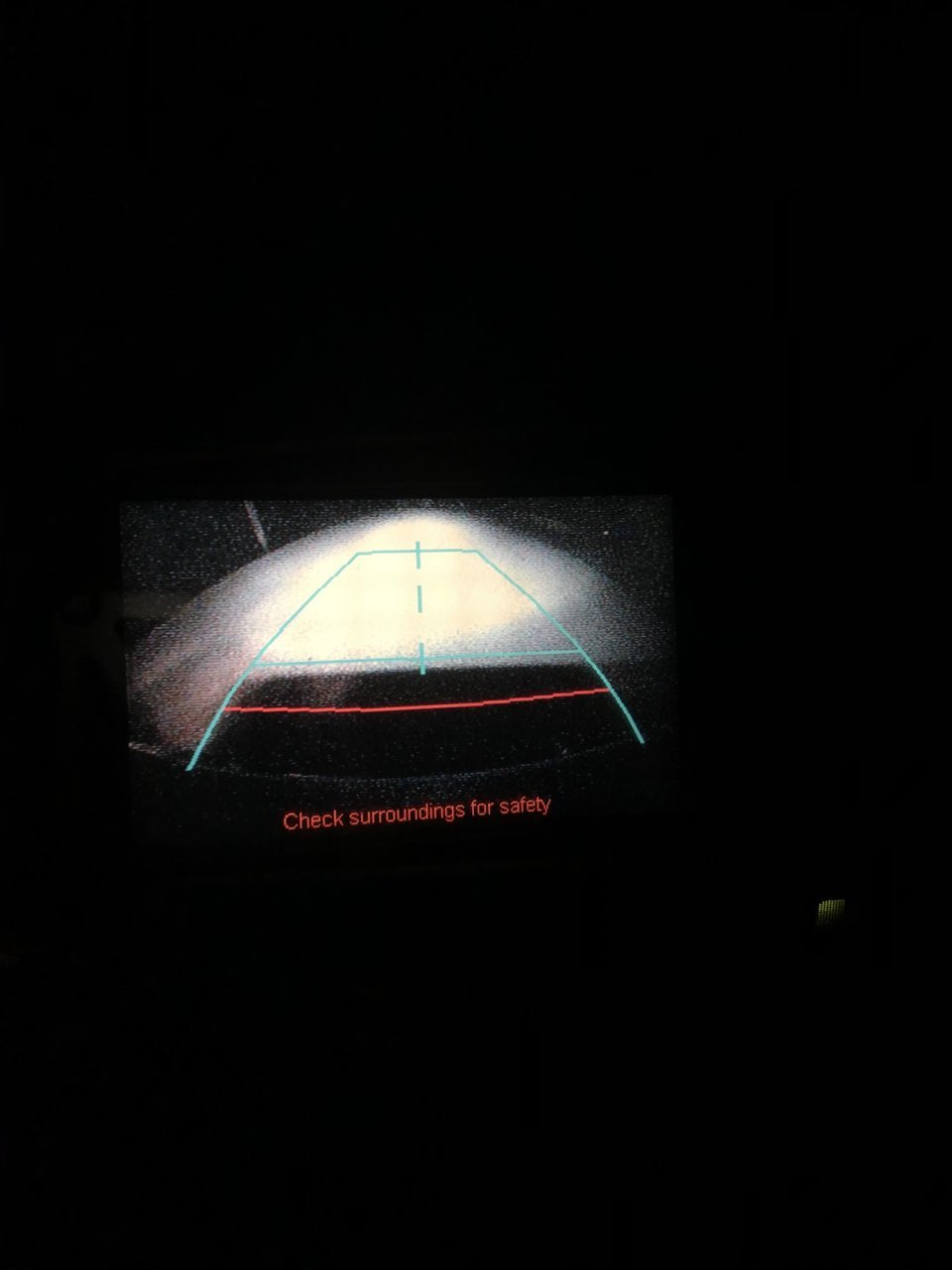

    Got my rear lights wired in, the switch is just floating in the little drawer/fuse cover box but here's some before and after photos. I've had the passenger reverse light out for probably a couple years and just haven't bothered to fix it so that's why in the reverse camera is only half lit up. I learned to just drag brakes slightly so I could see but now with lights I can actually view where I'm going.

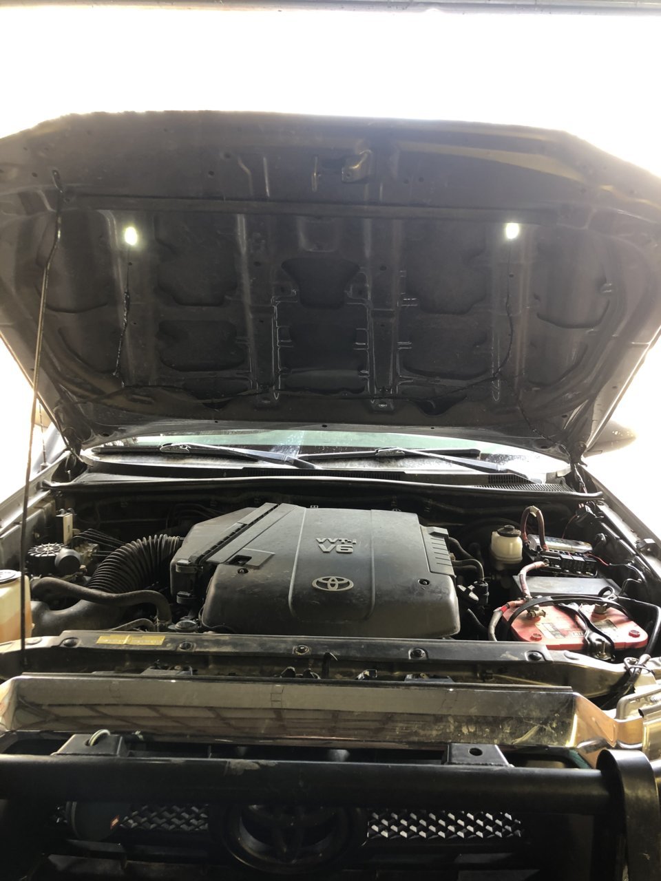

    I also had some small magnetic led lights laying around from a friend so I put them under the hood of the truck. Since they are magnets I can pull them off and stick them almost anywhere so I can see under my hood at night.
