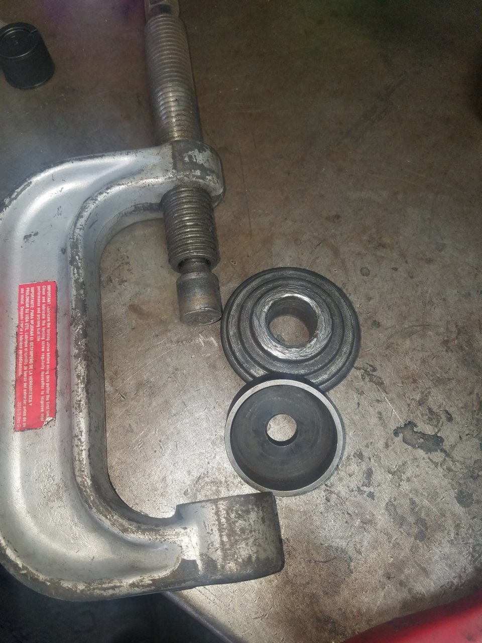

    far reach here but could you use the bottle jack somehow to press it back in?

    I pieced together something from my work, on my way from Alhambra..

    Grab a bit of grease too to lube up the cup a bit.

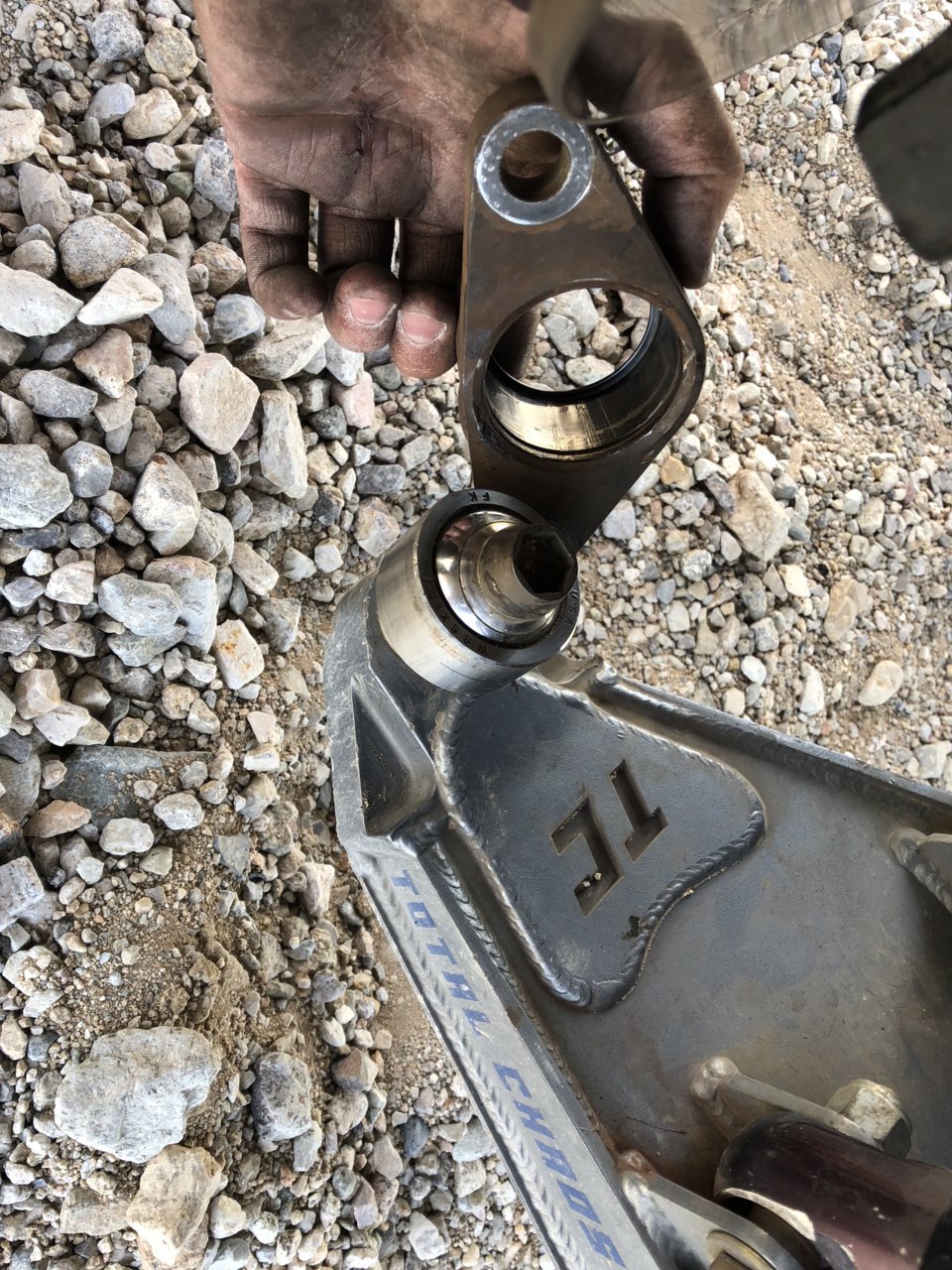

    I’d recommend a hand torch too so you can heat up the adapter, then tap the uniball in.
    Weird situation, also I hate those adapters haha
    Good luck!

    Thanks I have my friend going to Mattel to get me the whole uniball and cup already assembled to just unbolt and throw it on and gtfo lol
