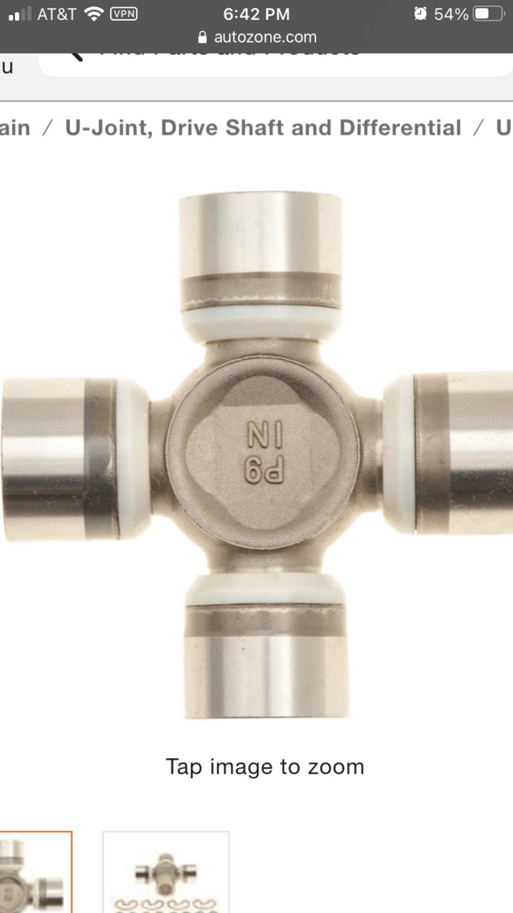

    I’m kinda having a hard time pinning down your exact symptoms.
    The driveline or “ propeller shaft” is in sections. Those sections are connected via U joints or universal Joints. They go bad due to age or neglected greasing.
    causing vibration issues and it can be from mild to incredibly violent and if they fail can be catastrophic. The cups
    On the ends contain needle bearings
  18. Dec 15, 2021 at 6:49 PM

    Clickbait title for sure…
    but might by drive shaft u-joint. I had this happen on my 2012 somewhat recently.
