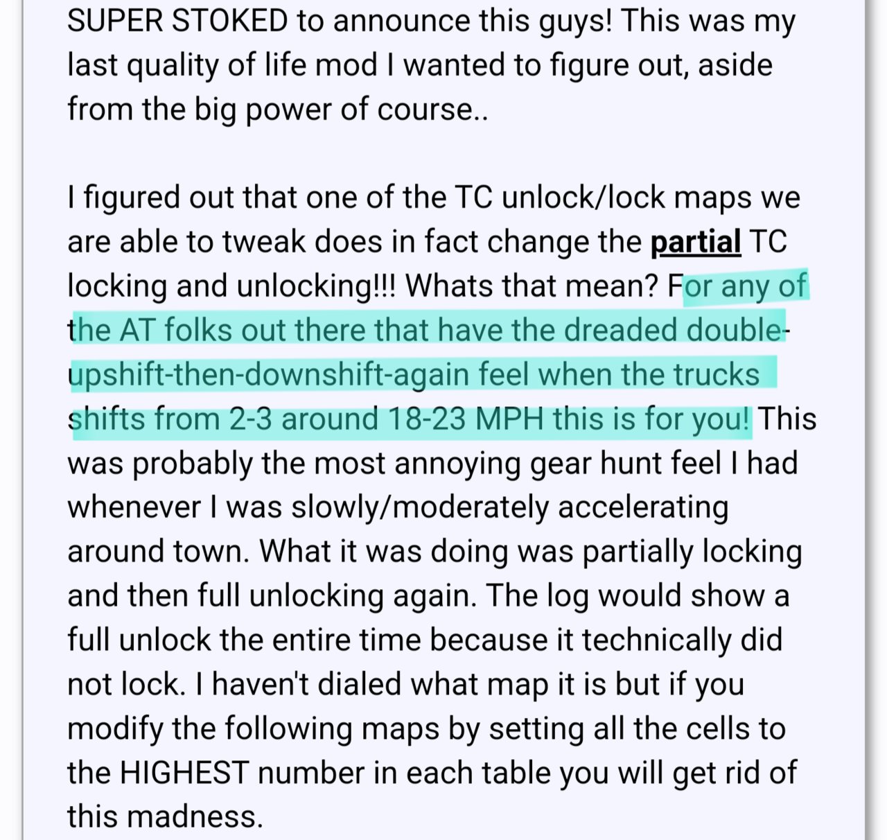

    Take a look, this is a known problem, even though it may not seem like it based on the majority of the comments (who I might add do not have 3rd gens and have a much more simple torque converter design than us).
    When the torque converter is partially locked (slip lock) you will feel this. I feel it more in my 2020 because 2nd gear also does a partial lock. Not an issue but easily fixed with a tune. Keep in mind, most tunes do not eliminate this, but it can easily be proven by disabling 3rd gear slip lock in the tune.

    Thanks man this is good info. I’ll bring it in tomorrow and let them know about the tc
