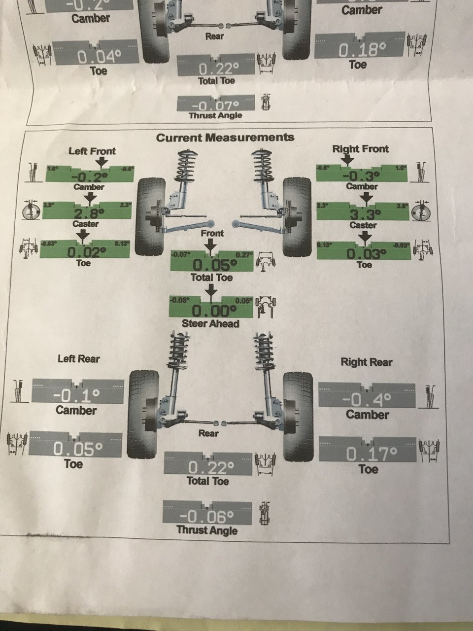

    Not Necessarily true. This is still a decent amount of caster, and well within acceptable parameters. My first thought is caster as well but he looks to be ok. When people just throw caster at it it can also very negatively impact wheel travel capabilities if the wheel is moved too far rear word.
    How are people offering solutions without even knowing the wheel/tire specs, the answer might be much easier than we think.
    OP, what are your wheel/tire specs?

    Also...
    What does the top of that sheet say? Year/model?
    Camber should be; 0.50-0.58, +/- 0.75.
    These trucks require positive camber to compensate for suspension squat/bushing deflection while underway. You're at the far end of negative. It will also have an affect on how caster is measured.

    They are 285/70/17. Wheels are 17x8 +0 4.5 backspacing I think

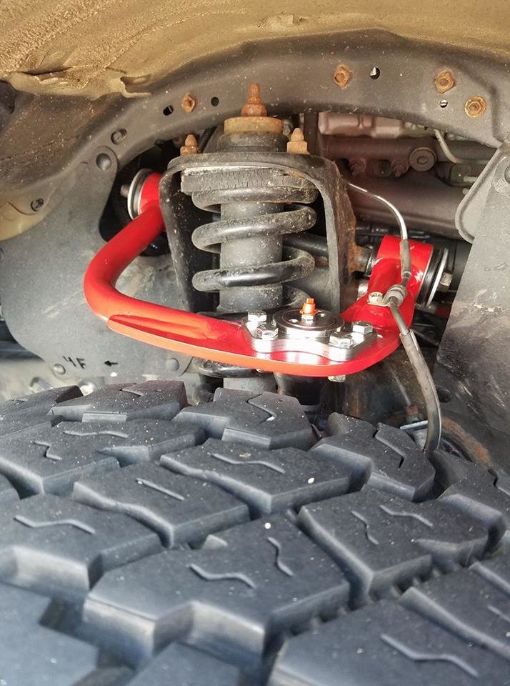

    Well it depends on what’s causing the negative caster, short upper control arms will cause this exact problem. When he puts his light racing upper control arms on and adds castor and corrects the a arm angle the bump steer will be gone and then how will you explain that ?

    this is subjective and likely a combination of things.
    my thoughts are:
    - caster can help a bit when very low, but these caster readings are not extremely low. too low for me and many here, but not a total mess.
    - bump steer is exacerbated by a lack of compliance, usually coming from overly stiff tires. they are too firm and don't mold to the road surface enough, thus transferring that force up through the linkage. that's why reducing psi can help by allowing more tire deformation/compliance. but, for some, E range tires take this too far... mostly folks not used to driving E tires.
    but there still may be a bit more to it with a given setup.

    TOYTEC 2.5 kit, SPC UCA, N-fab side steps, TRD pro grille, FN FX PRO Wheels, BFG KO2S (265/70/17 C Rated), TRD Skid plate, Tyger Tonnue Cover, OVtune, Borla S type exhaust
    I have similar issues, toytec boss lift at 2 inches. 265/70/17 c rated ko2s on 0mm rims, spc UCA. Tracks straight on the hwy no problem. It's the slower speeds on crappy side streets that gives the bump steer from potholes, raised and dipped portions of the street etc.
