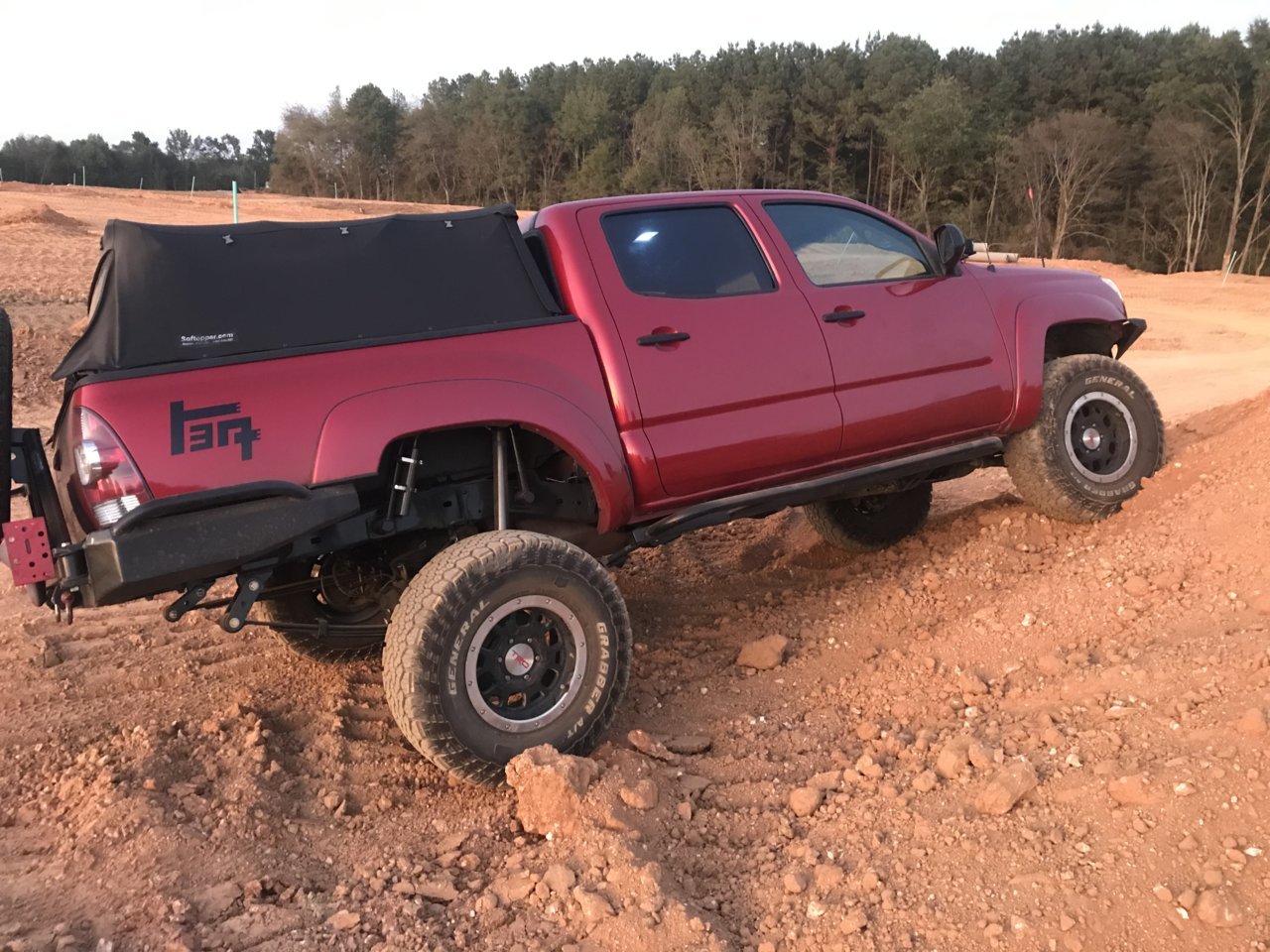

    Little flexing in the neighboring construction site. Couldn’t find a dirt pile that I could get completely flexed out in. Still have some room to drop out.

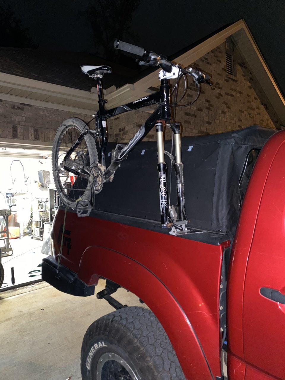

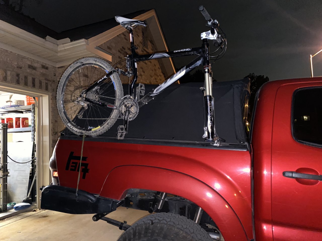

    Trying out another way to haul the bike. Built some outriggers for the fork mount. Holds the bike well I’m just concerned about the weight being on the outside of the bed rails and shifting while driving. We’ll see over time. For now it’ll do the job though and didn’t cost me anything but time to make.

    Reworking the swingout. Didn’t feel like loading it back up. The heim joints didn’t work out so well. Lol. Waiting on an actual hinge kit.

    Getting one from Comp4x4. Uses bronze oilite bearings instead of roller bearings so less maintenance. It’s in double shear and uses a 1 inch bolt. It’s 4 inches long so I give me some room to weld in some more bracing to minimize the twist I’ve been getting. If I had to redo it, I’d use 3x2 square tube as the base but I’m not about to spend more money on it.

    Is is twisting front to back? I was going yo do a 2x2 base with a gusset at the spindle so I didn’t have to taper the 3x2 down to 2x2 to fit the latch

    It’s twisting from the weight of the tire. It won’t be near as bad once I get a real hinge in there though.

    May 17, 2011
    #56826
    6,327
    Stokesdale | NC
    ‘19 Honda Civic Hatchback
    Doubt the weight of a bicycle is even close to doing something to the rails or moving.

    Winds at 70+ mph are my concern with my mounts
