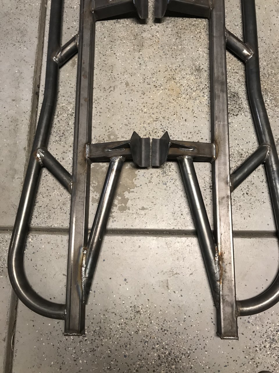

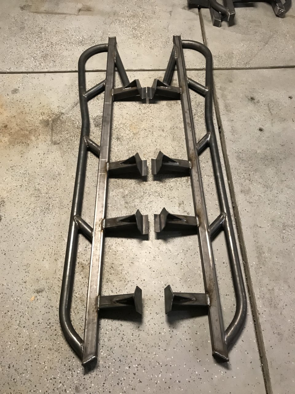

    Finally making progress on my own sliders. The whole process with these has been experimental to say the least. At some point, I may make these available to build to order. We’ll see.
    So far I’ve gotten the outers completed and the legs are tacked in place. I’m adding a rear reinforcement as well as shown. Just need to make one more for the other side.

    Been thinking of adding the bracing to my sliders like you did at the kickout. Haven't seen a reason to need it, just wouldn't hurt to have a little extra something under there.

    Absolutely. I saw quite a bit of flex in that area with my CBI Sliders so I decided I won't chance it this time. Cutting that piece at that extreme of an angle was quite difficult though. Main reason I haven't incorporated that in to the sets I build for other folks yet.

    Would it be any easier to cut / grind out with square tube?

    Nope. Not really. The fun part of this cut is that you make the long 70 degree cut then twist the tubing 15 degrees and make the other cut at 20 degrees. Getting a 15 degree offset with square tubing would be much more difficult since it naturally wants to be clamped at a right angle. Round tubing doesn't care.

    lol, I didn't think about the angle of the sliders when making the cuts....

    Yeah, Its quite the headache. Lol.

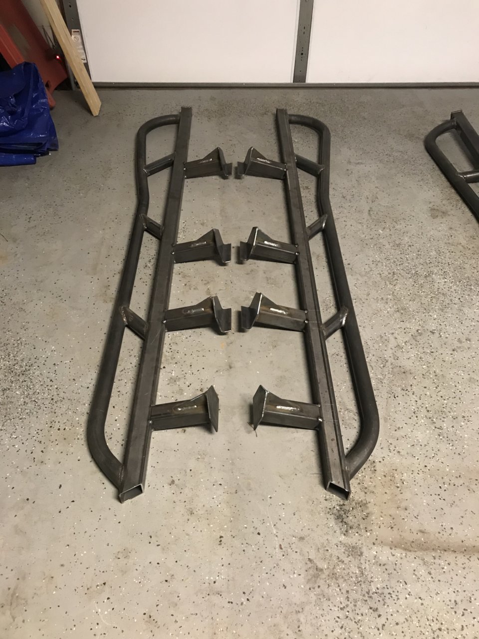

    Finished my personal sliders this evening. Now the boring part: cleaning them up with the wire wheel and paint. Then the install.
