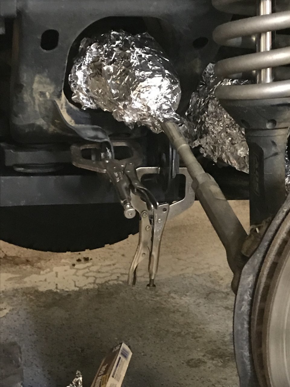

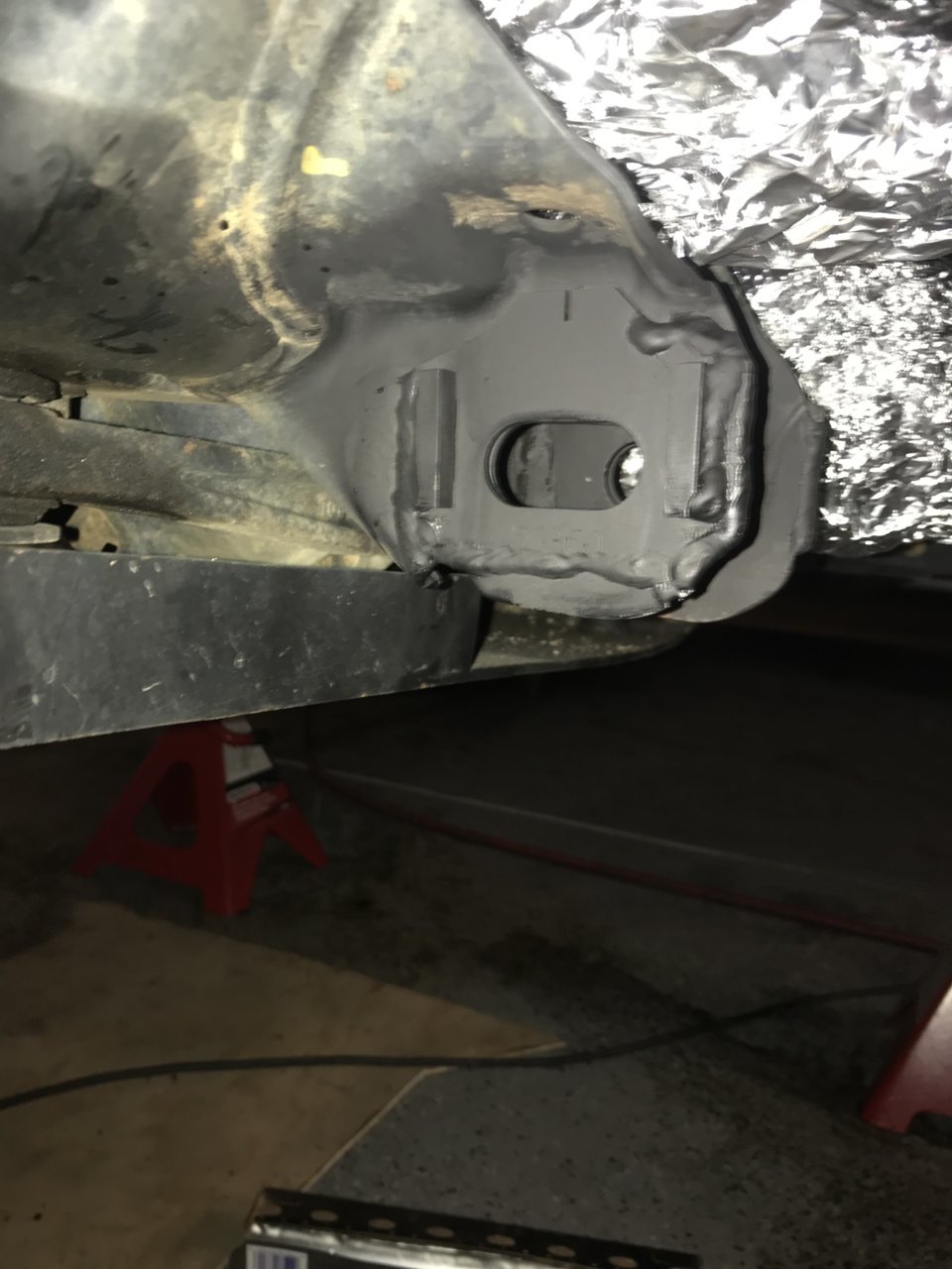

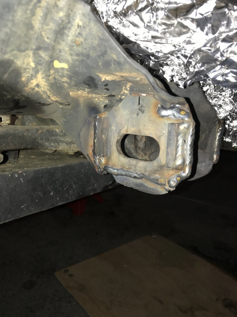

    Added the Total Chaos Cam Tab gussets. The trucks holds an alignment great now.

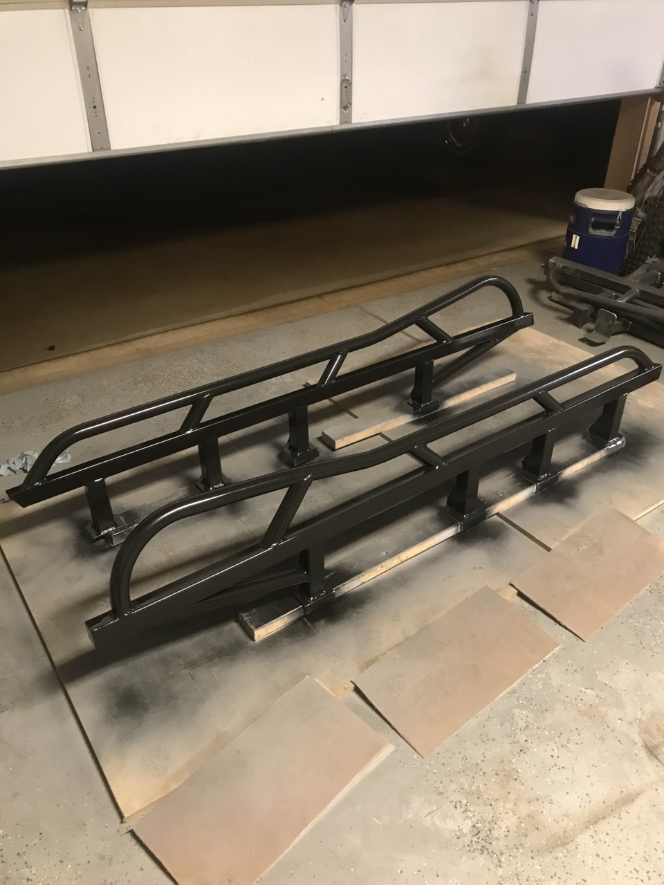

    Sliders are painted and as soon as they’re done drying, will be welded on the truck. Tried a gloss black this time instead of matte since that’s all Walmart had that day. I actually like it so far. Excited to finally have a wheelable (is that a word?) truck again.

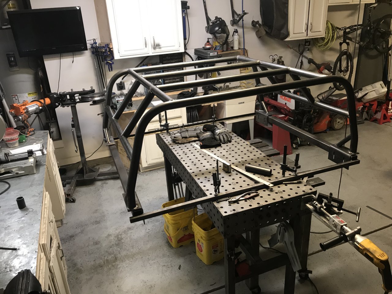

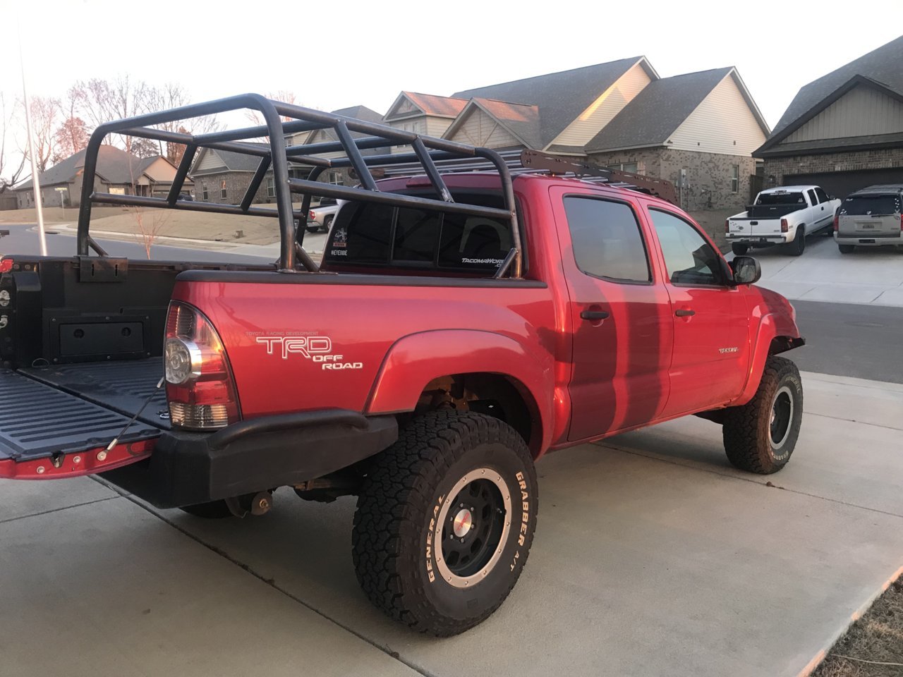

    Built a bed rack last night. Going to be finishing the welding this evening.

    Thanks! I'm happy with it so far. Finish welding everything will get interesting this evening. May have to break out the ladder.

    That's kind of the thought process behind it. And the extra tubing just gives you more real estate to mount to. I like the idea of using U-bolts to attach mounting brackets so you can move them around and try new stuff other than welding solid mounts directly to the rack. This should allow for that.

    Its a 22 inch tall rack. Plenty big for most people.

    Got the rack finished yesterday night. Here it is mocked up on my truck. Almost makes me want one for myself it looks so good.

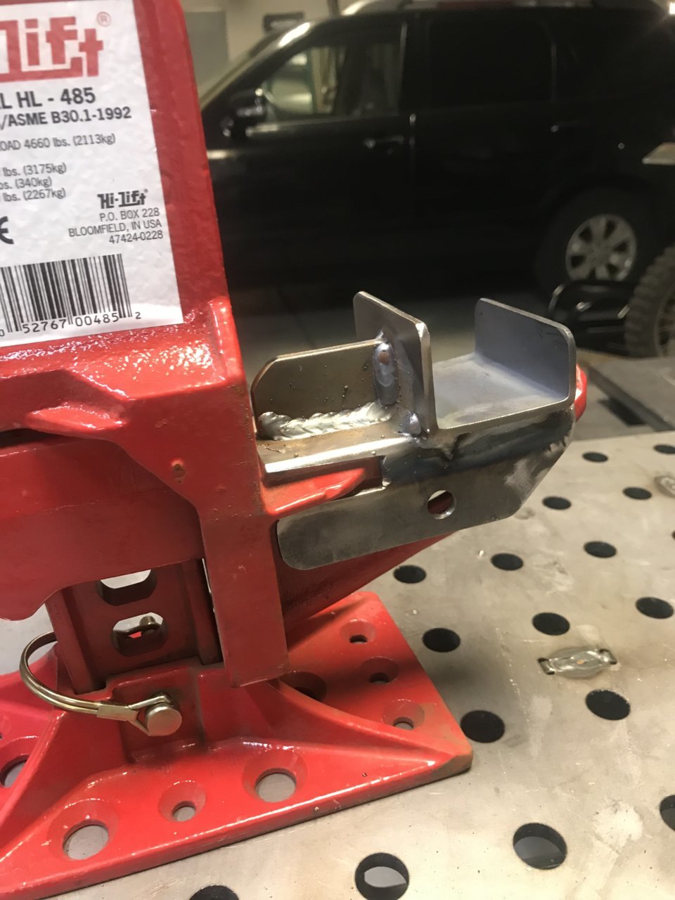

    Little hi lift slider adapter I whipped up last night for @InfernoChalupa

    Every time you build something I think of another tool that I need to buy.
    Did you square use tube for the base or bend plate to fit?

    That whole thing, minus the "spine" was made from square tube. The spine was made from 1" flat stock. All material was from my scrap bin for this project.

    Seems like something within my capabilities. Is that 2” square 3/16” thick tube?

    It's 11 gauge. Ideally, I would build this kind of stuff with 3/16" but all my tubing is 11 ga, or .120" wall thickness. My original that I built was from the same material and I was able to safely use it with my hi-lift with no deflection in the material. I may experiment making the "cradle" from 3/16 plate next time and bend it up with the press brake.

    Logical. Most (if not all) of the sliders on the market are made out of 11 gague and they hold up just fine. With such a small surface area and with the bracing on it, I can’t imag it would move at all.
    11 gague is the only thickness I have worked with thus far.
