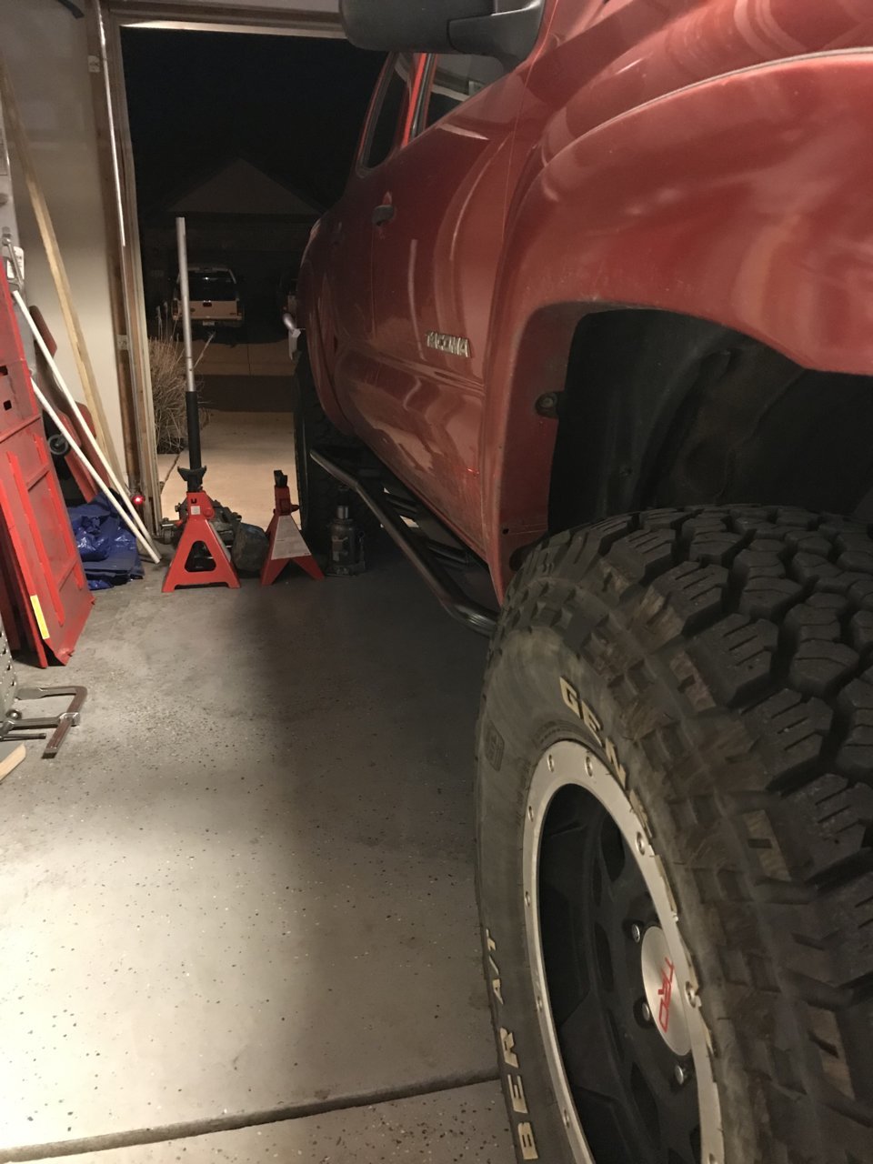

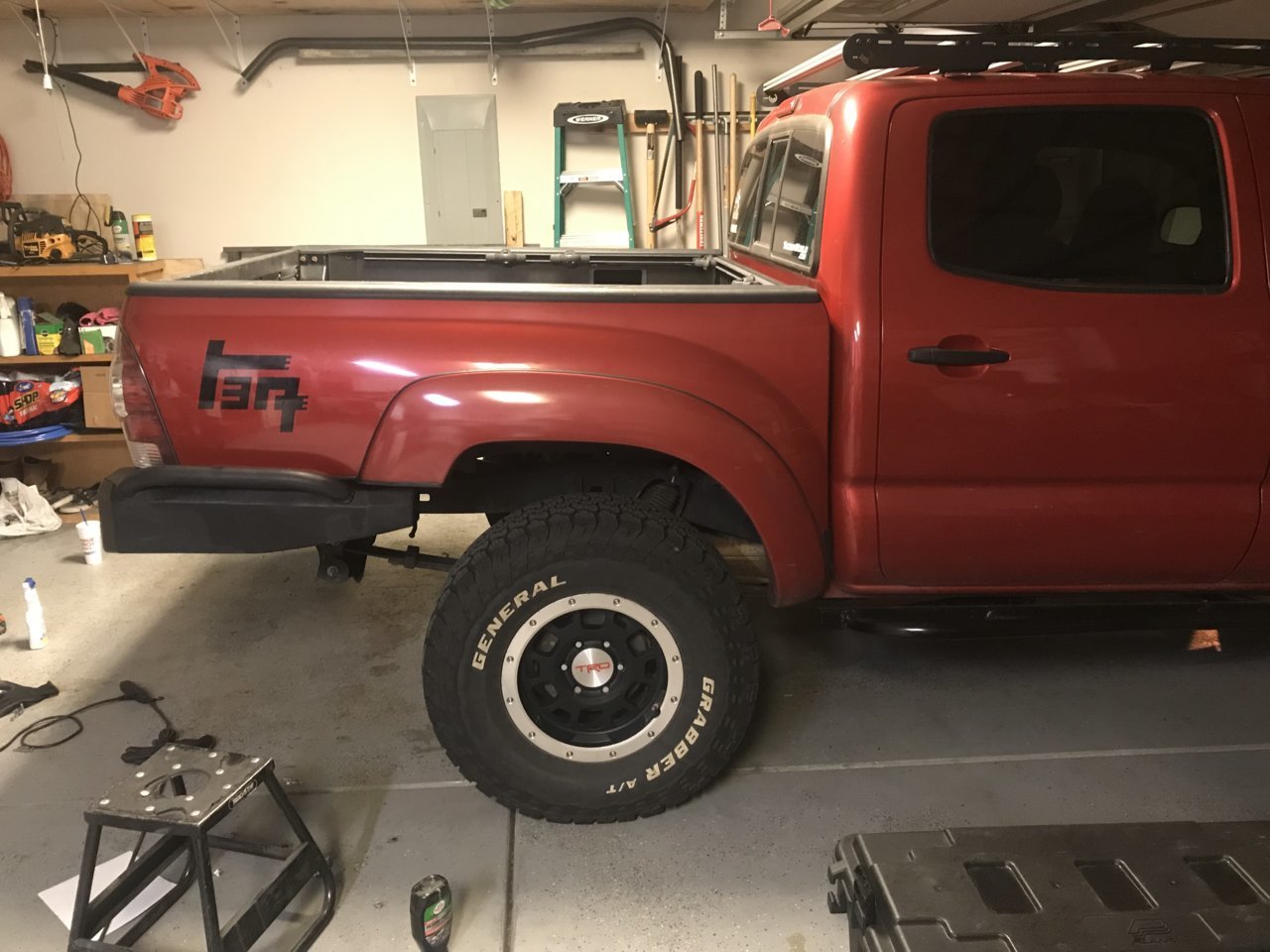

  8. Mar 22, 2019 at 9:54 PM
    #88
    Jerneyman
    Jerneyman [OP] Well-Known Member
    Nov 6, 2015
    #168886
    5,135
    Wes
    Huntsville, AL
    2011 Tacoma TRD OffRoad 4x4
    **Armor** Home Fabbed Hybrid Front Bumper Home Fabbed Rock Sliders Home Fabbed IFS Skid Plate Home Fabbed Mid Skid Plate Home Fabbed Transfer Case Skid Home Fabbed High Clearance Rear Bumper **Suspension** ADS Front Coilovers (Extended Travel, 700lb coils, Remote Resi) Total Chaos UCAs Chevy 63 Swap w/ custom shock hoops 14" Bilstein 7100s **Wheels/ Tires** Spidertrax 1.25" Wheel Spacers Front/Rear TRD Rock Warrior Wheels 285/75/16 BFG KO2s **Electrical** Pelfreybilt Auxiliary Fuse/Relay Panel Blue Sea Fuse Box Bussman 100 AMP Breaker **Recovery** Smittybilt 9.5k Winch **Lights** 20 Inch Single Row LED Bar Rigid Side Shooters (Flood/Pair) w/ CBI Offroad Ditch Light Brackets Rigid Duallys, Amber for fog lights **Miscelaneous Mods** Rear Diff Breather Relocation RAM Mount A-Pillar Mod w/ Garmin Power Cable DRT Fabrication Cab Mount Relocation Pinch Weld Mod (Mini Sledge Special) Short Rise Bed Bar for Tire Storage/ Hi-Lift Mount

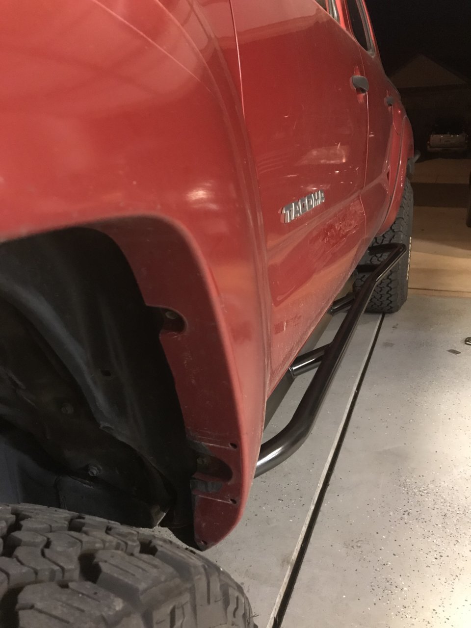

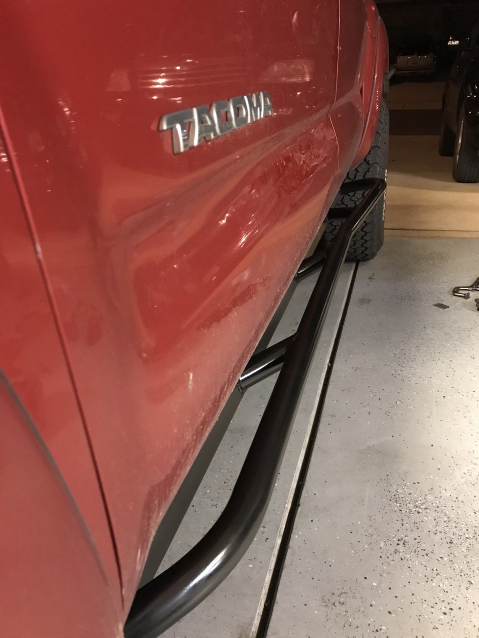

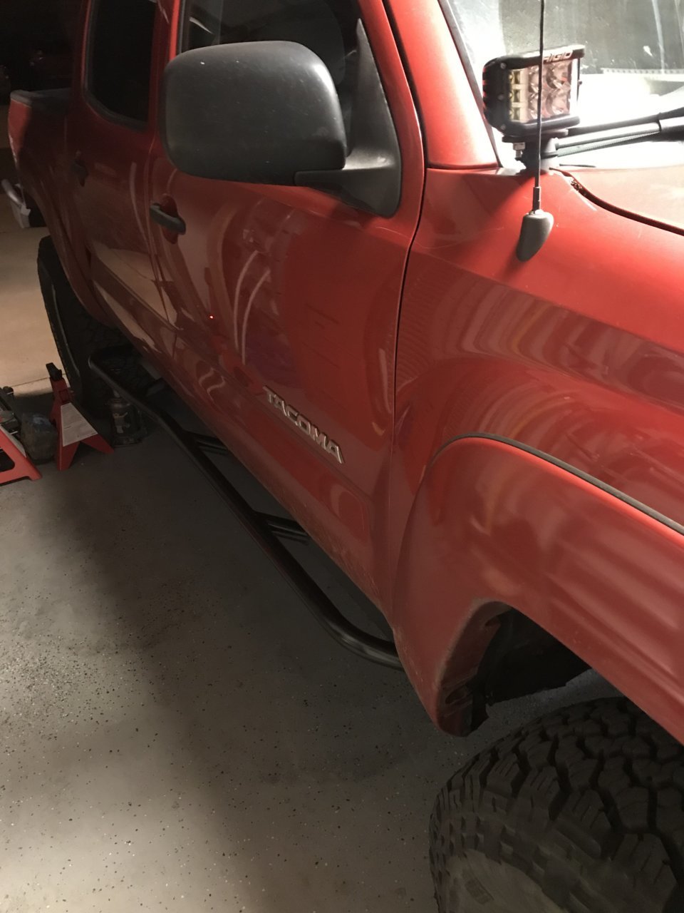

    Welded on my own personal sliders finally. I love how they look. I got on it and bounced a bit to look for flex, there is none in the sliders, however it’s twisting the frame. Guess it’s time to fully box everything too. :muscleflexing:
    C25C9DDB-AC4E-4180-8E47-AD32E9C93066.jpg 057703DB-C953-4BCB-92D6-37695EDE3901.jpg 3F8055BE-A0D4-4BBA-874D-7AA76D6439E7.jpg 9F79D554-9773-482F-A946-CE5C7C34AD90.jpg

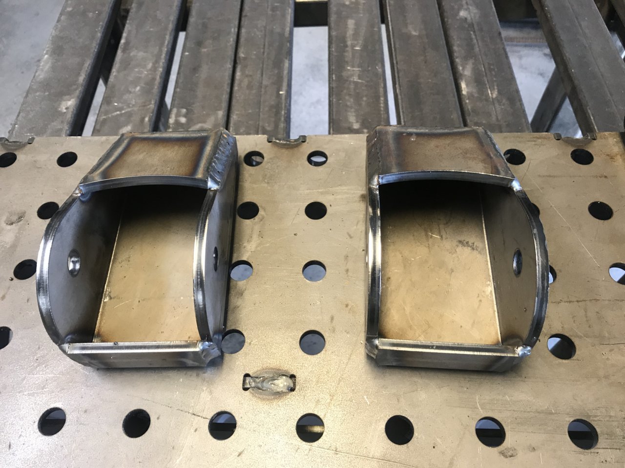

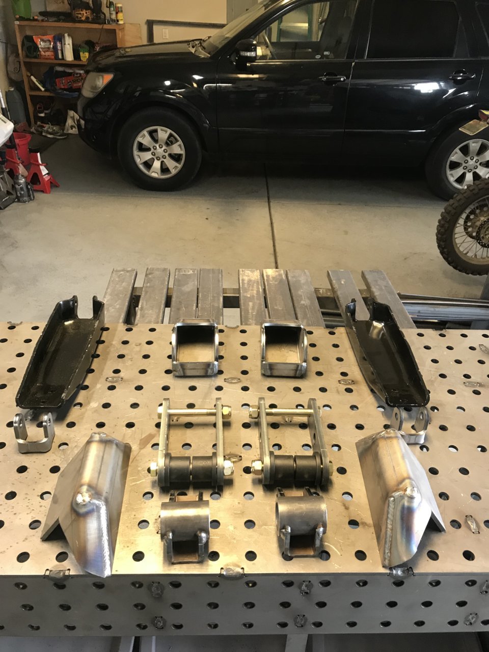

  9. Mar 24, 2019 at 2:42 PM
    #89
    Jerneyman
    Nov 6, 2015
    #168886
    5,135
    Wes
    Huntsville, AL

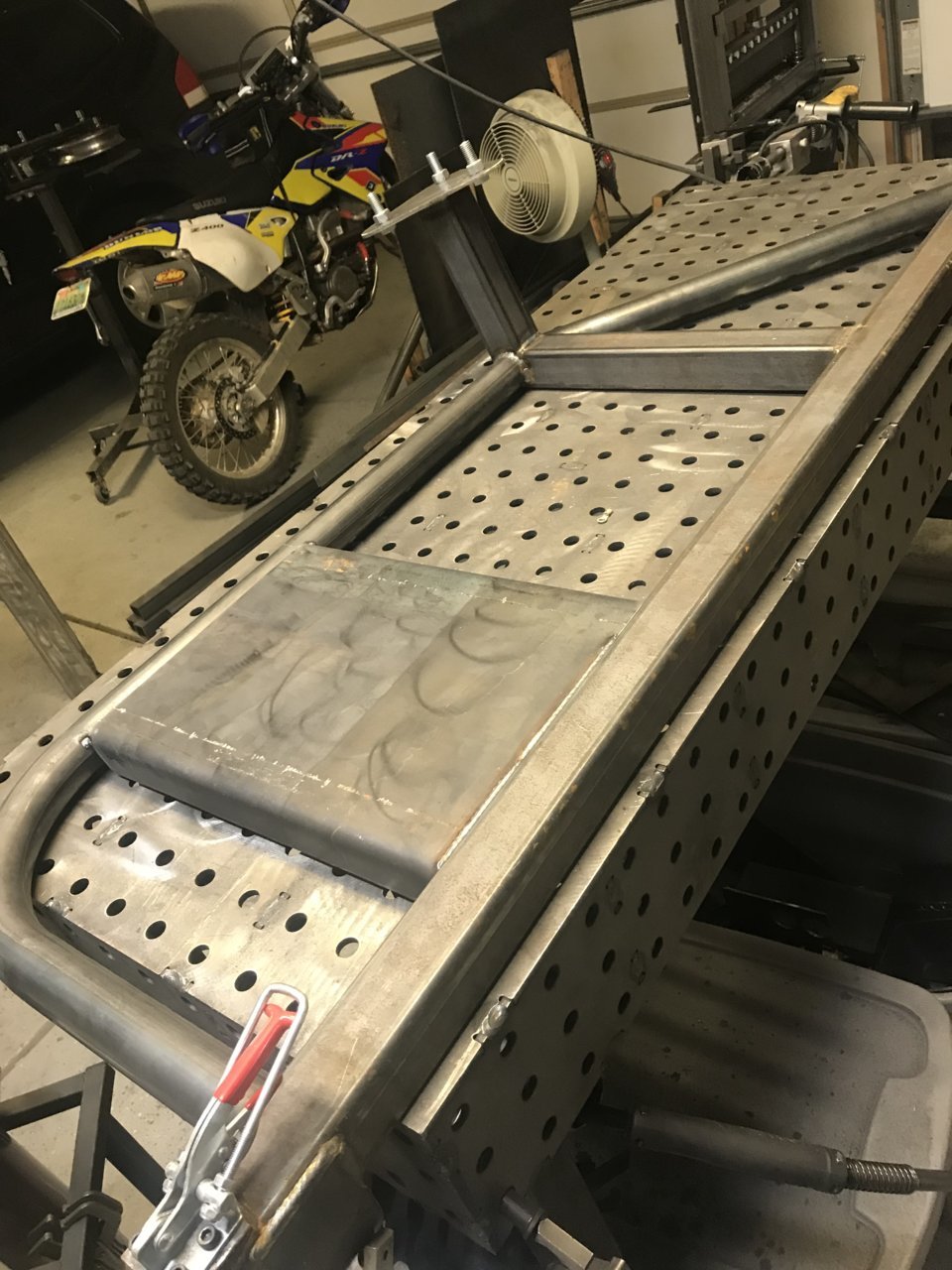

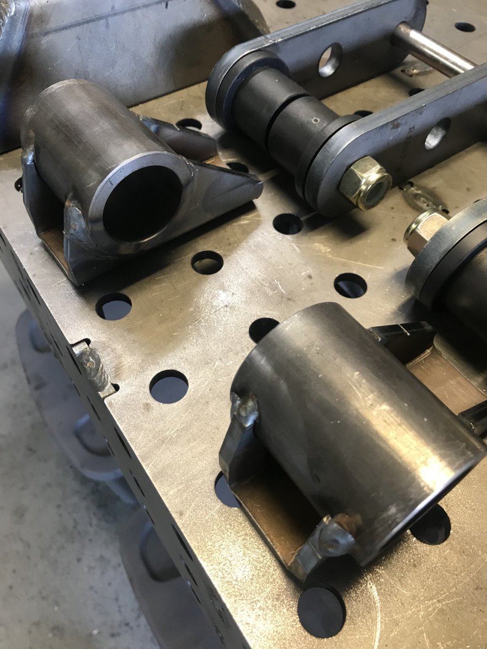

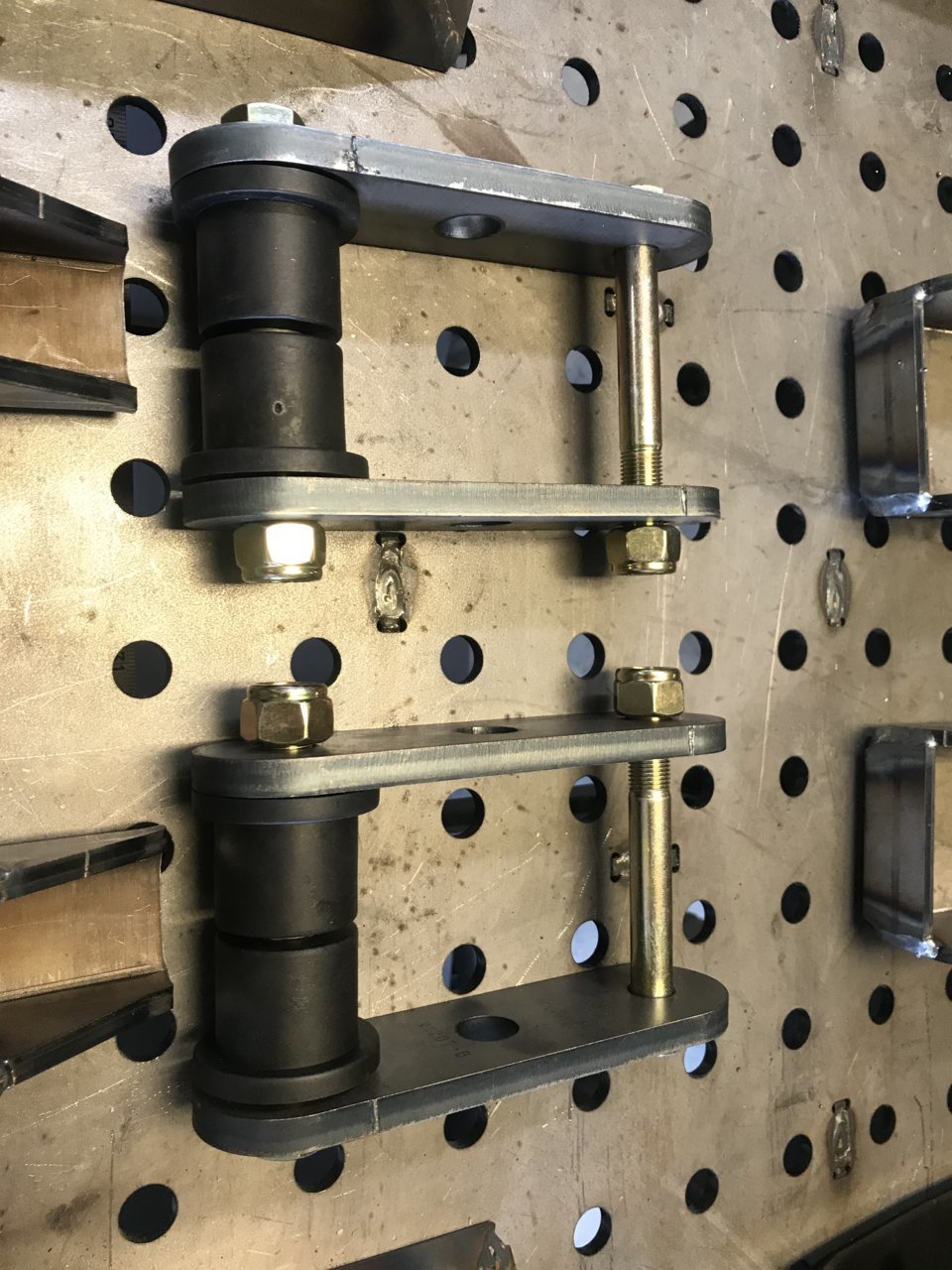

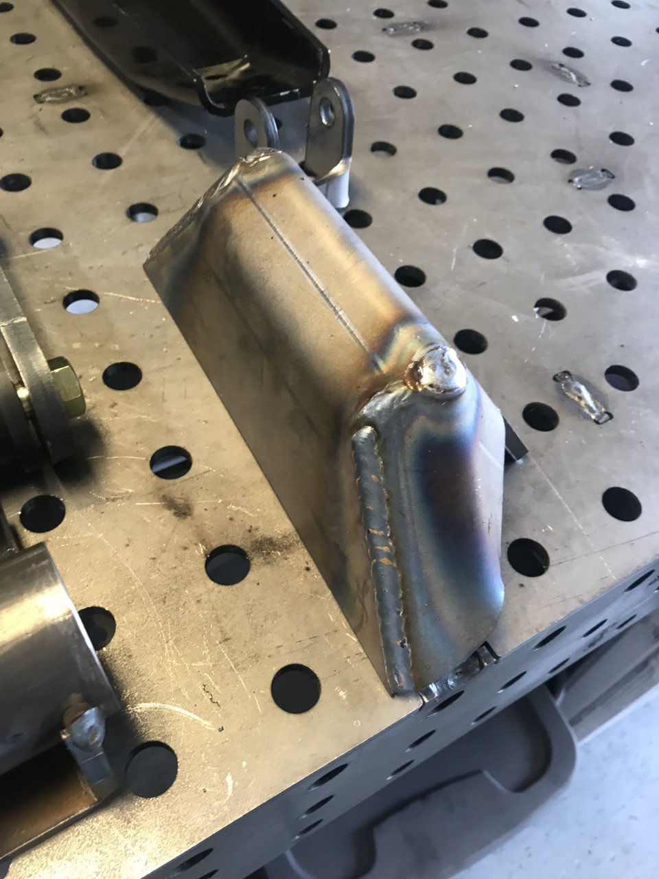

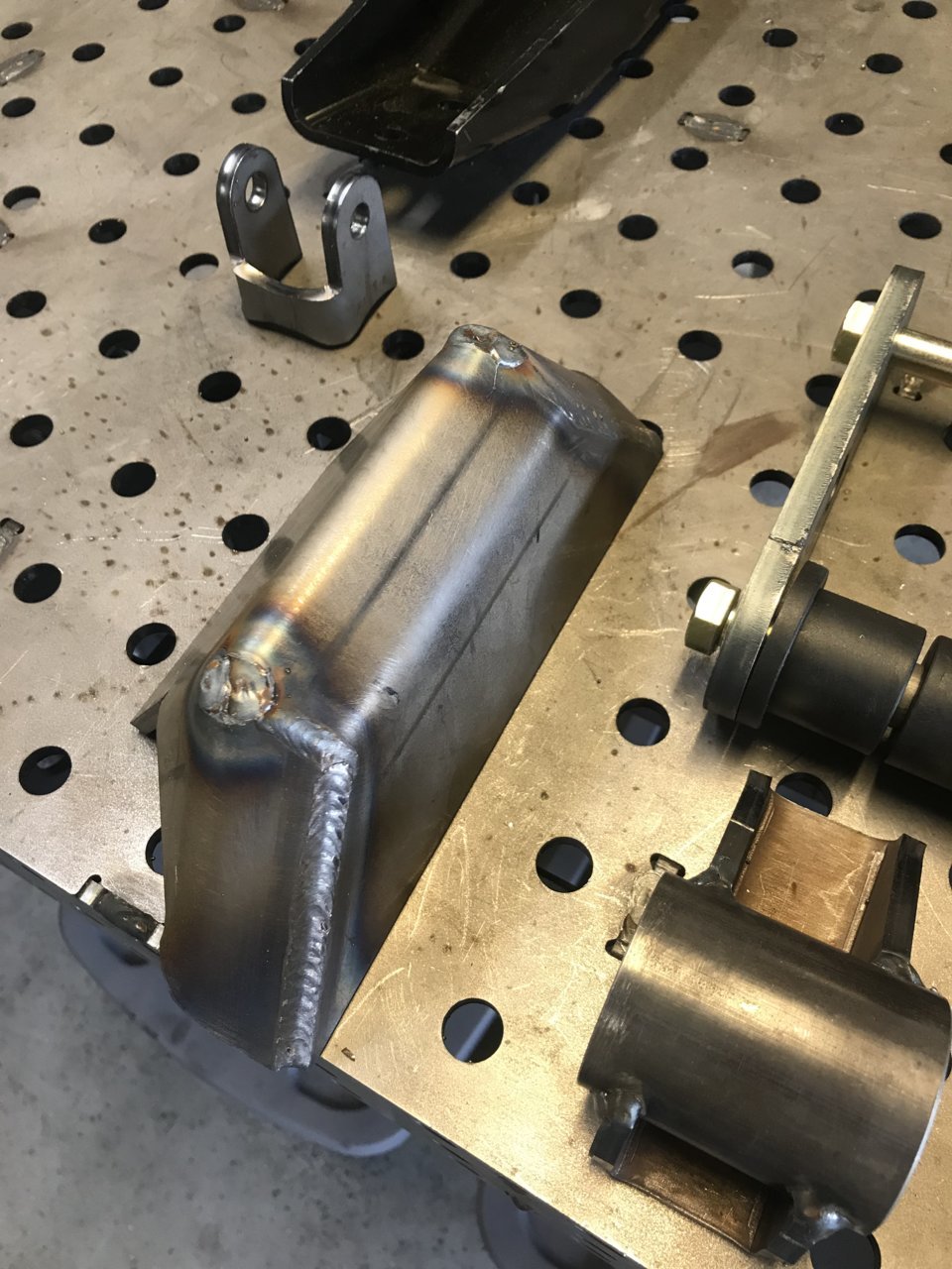

    The Chevy 63 leaf spring swap is finally starting to take shape. Got all the parts welded together on the work bench this evening. Next is finding the time to tear in to the truck and start the real fun.

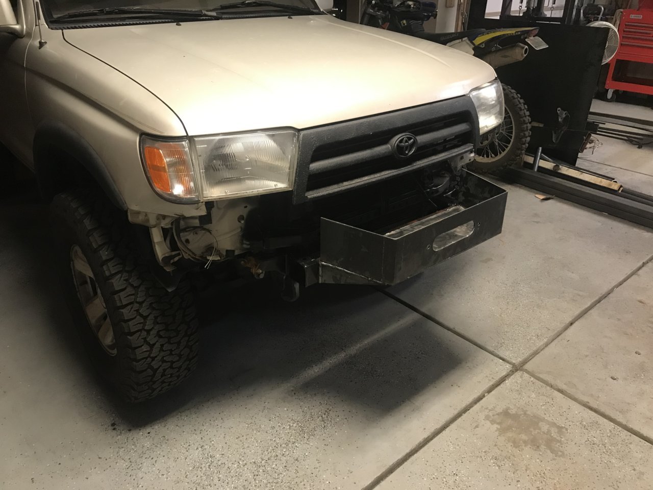

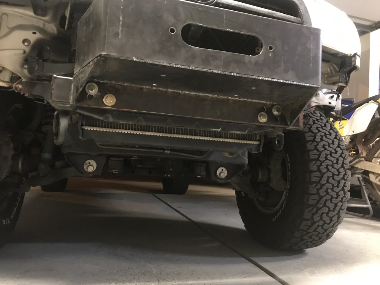

  10. Mar 25, 2019 at 1:00 PM
    #90
    Jerneyman
    Nov 6, 2015
    #168886
    5,135
    Wes
    Huntsville, AL

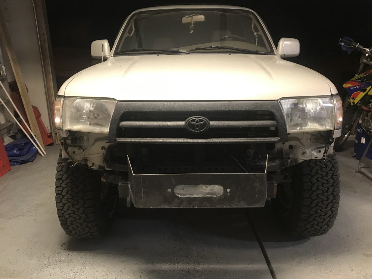

    Got a little progress made on a buddy of mine's hybrid bumper for his 4Runner. The winch tray is done for the most part. Probably going to trim down the sides a bit ones we get the tubing mounted and figure out how we want it shaped. So far it feels way stronger than I think he'll need so that's a good thing.
    Bigdaddy4760 likes this.

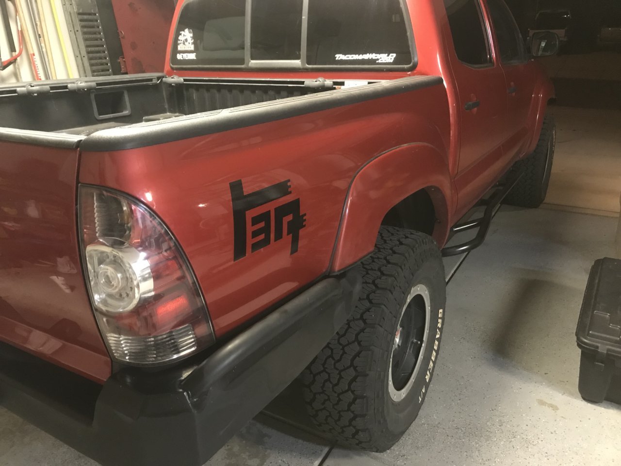

  12. Apr 16, 2019 at 6:47 PM
    #92
    Jerneyman
    Nov 6, 2015
    #168886
    5,135
    Wes
    Huntsville, AL
    Replaced my wore out TuRD decals with some vintage Toyota lettering. Pleased with how it looks. Thanks @CBoy808 for the custom vinyl!

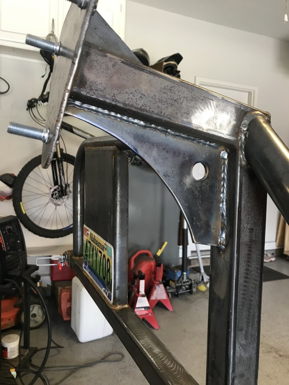

  16. May 8, 2019 at 10:42 AM
    #96
    Jerneyman
    Nov 6, 2015
    #168886
    5,135
    Wes
    Huntsville, AL

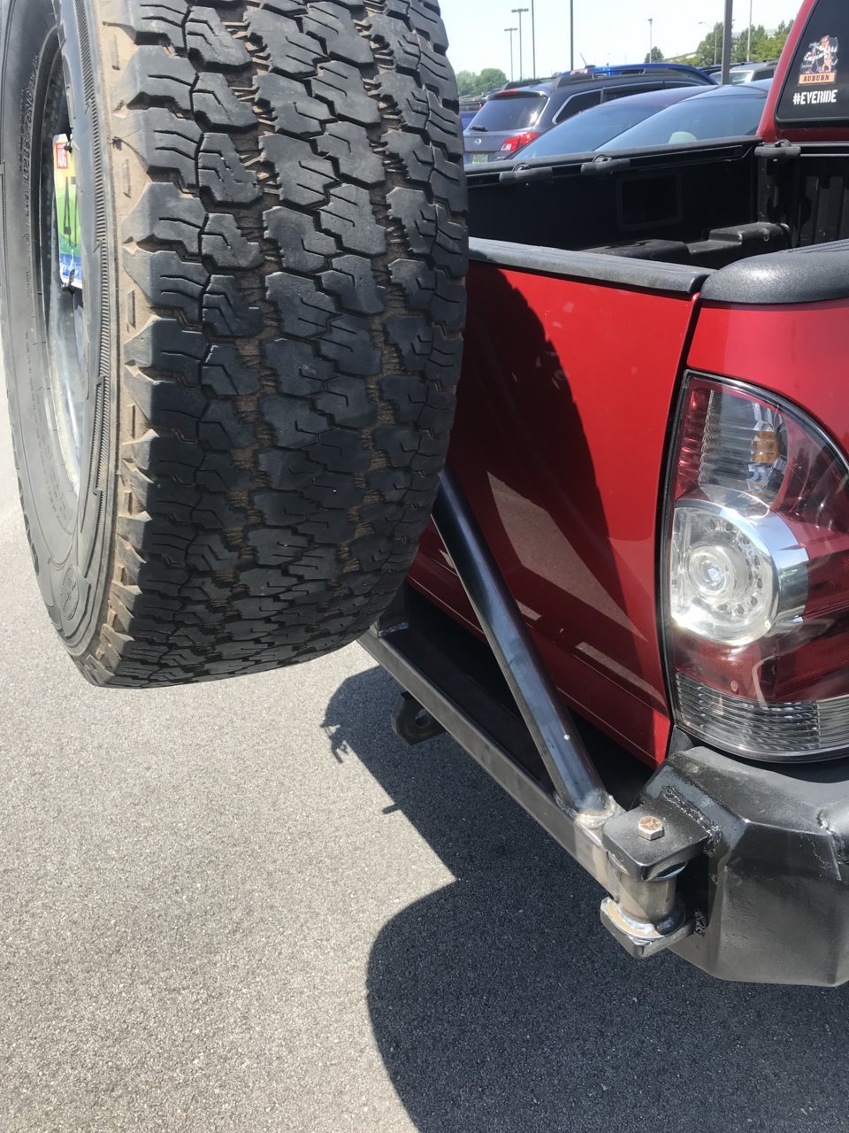

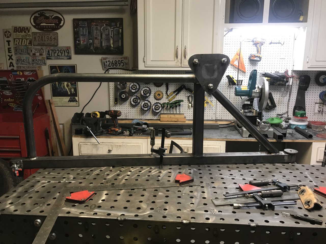

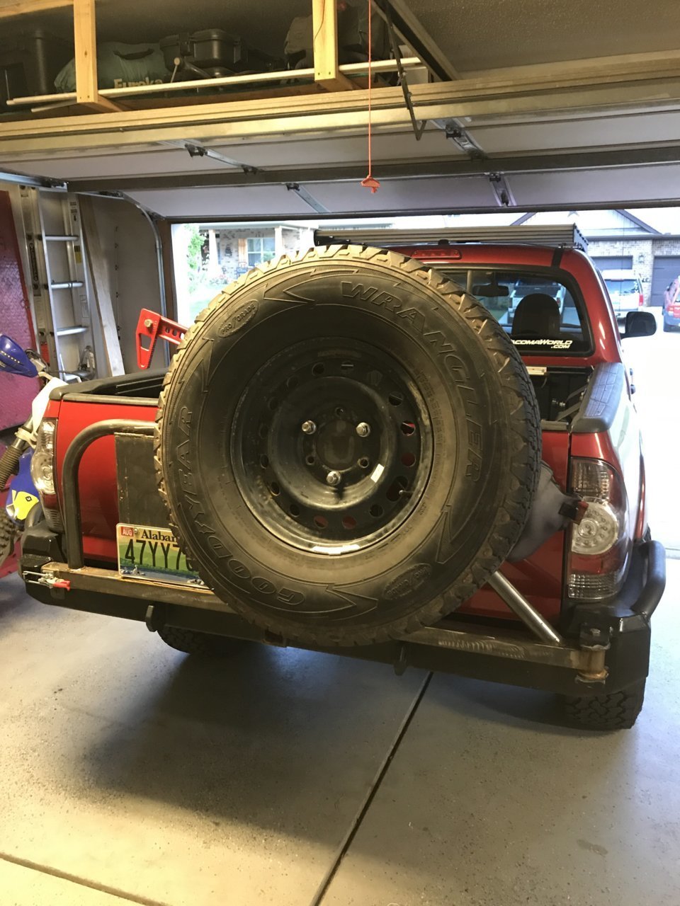

    Got some stuff done on the tire carrier finally. Still need to add some gussets and an accessory plate on the drivers side and I think I'm going to try and fit my hi lift on there somewhere... IDK. Happy with how it turned out so far though.
    IMG_2323.jpg IMG_2324.jpg IMG_2326.jpg IMG_2327.jpg IMG_2328.jpg IMG_2329.jpg IMG_2330.jpg

  19. May 10, 2019 at 7:05 AM
    #99
    Jerneyman
    Nov 6, 2015
    #168886
    5,135
    Wes
    Huntsville, AL

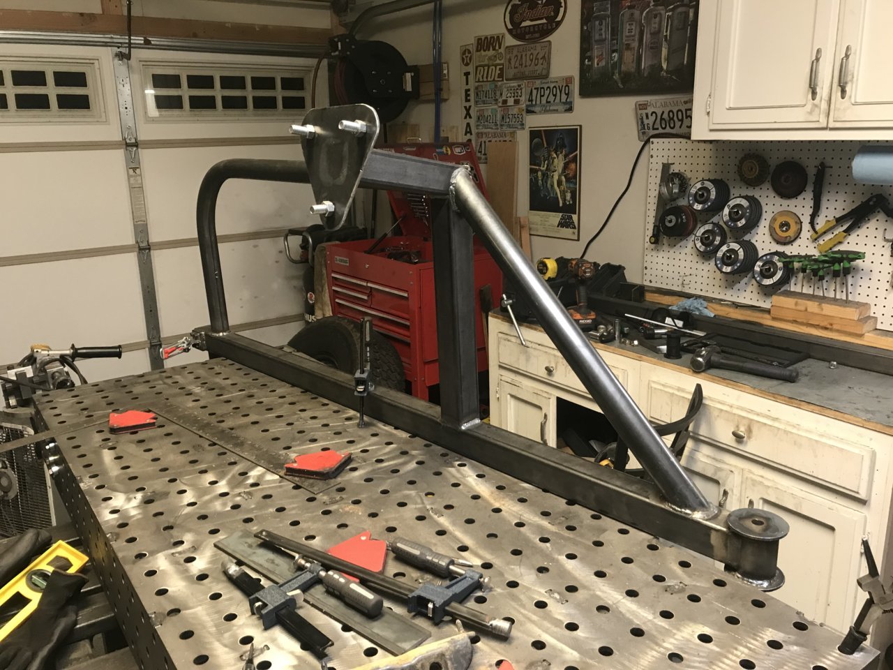

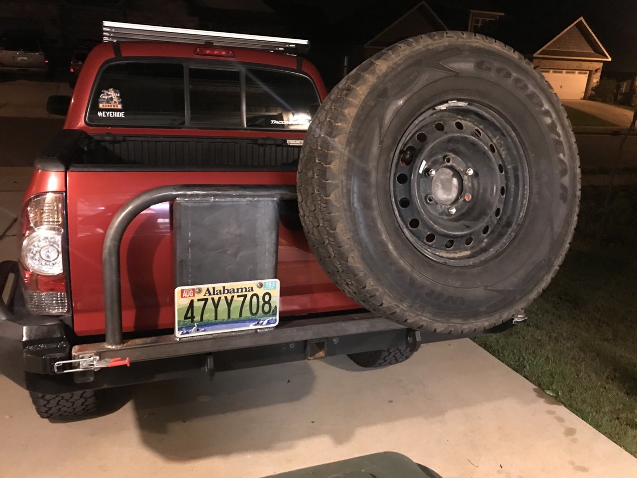

    Added my "accessory plate" to the swingout last night. Made it from 3/16" plate and added 1.5 inch flanges to both vertical sides to add some strength which was a bit overkill but it added no weight to the assembly. Once I decide to mount something to it, thinking a small utility box, I'll then drill holes but until then, no reason to have unnecessary holes or slots.

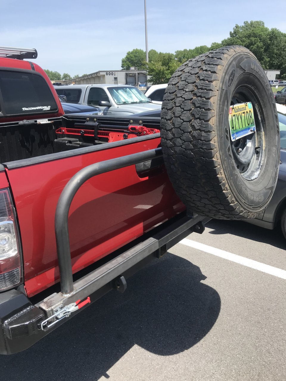

  20. May 12, 2019 at 7:41 PM
    #100
    Jerneyman
    Nov 6, 2015
    #168886
    5,135
    Wes
    Huntsville, AL

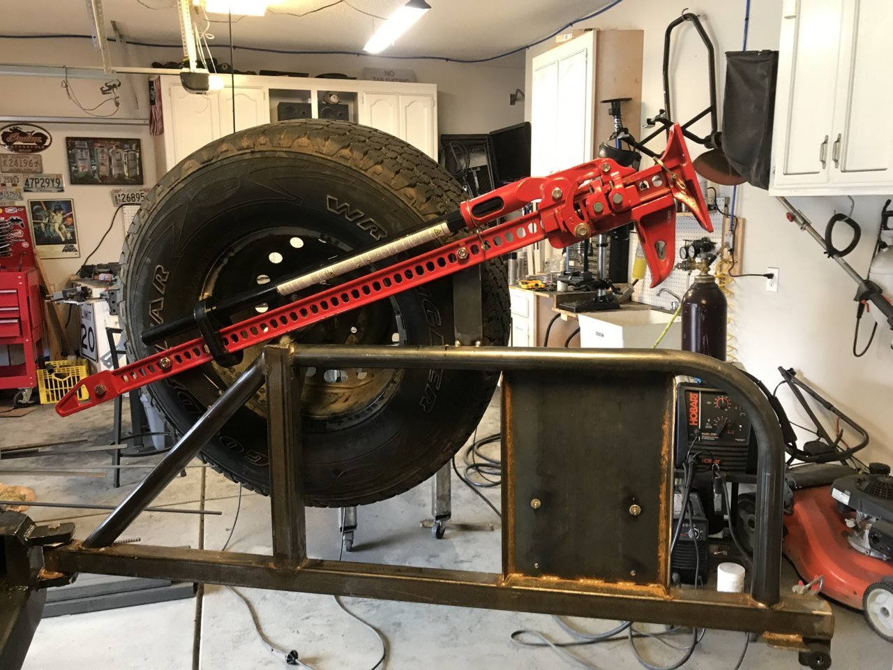

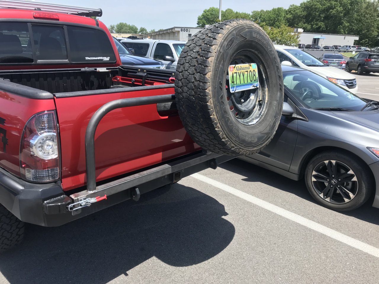

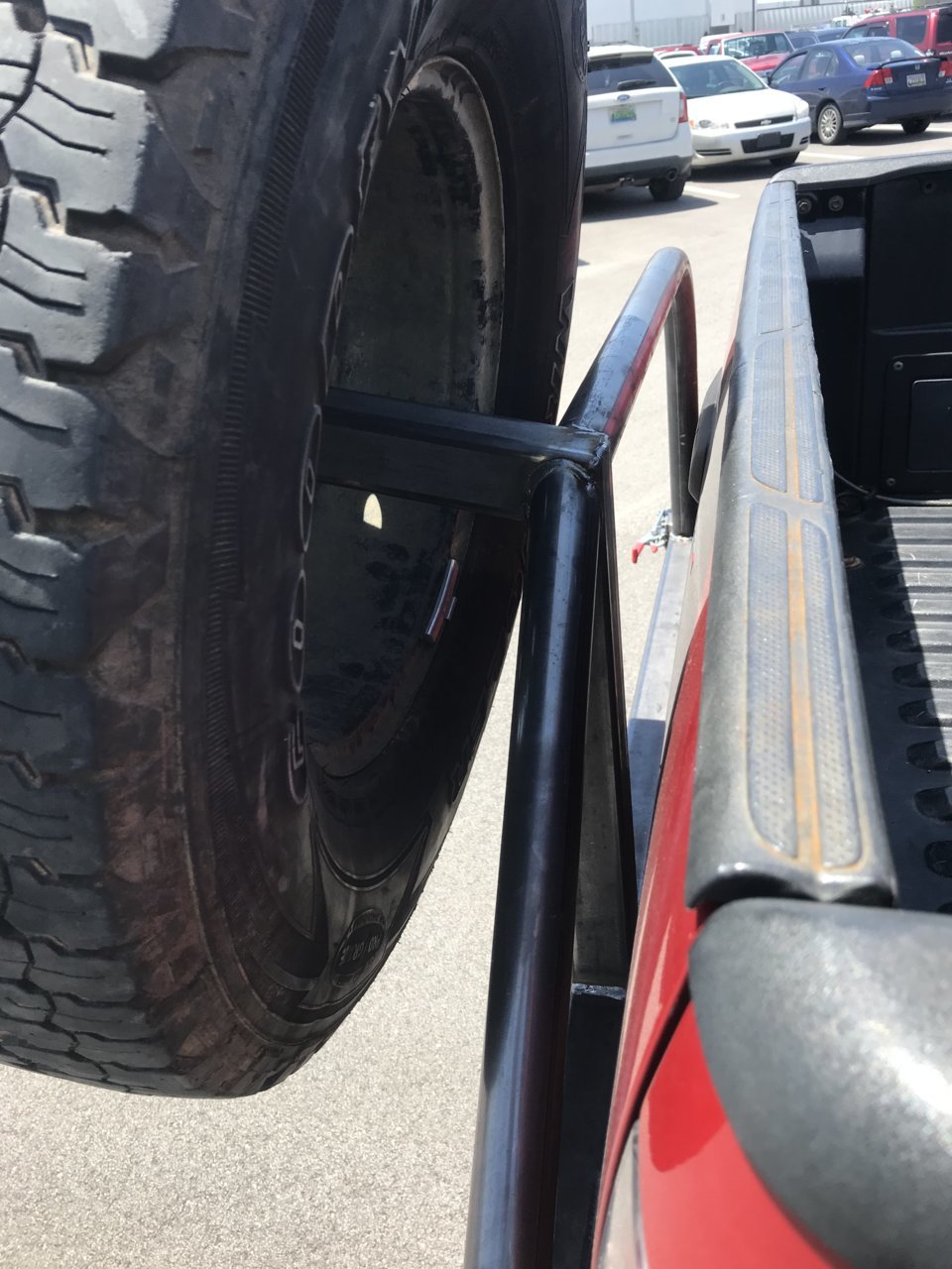

    Added in my final touches to the swingout. Have a hi lift mount, still undecided if I like it or not, added a much needed gusset under the tire mount and pressed in some actual wheel studs. Also, the hi lift is actually flipped around with the mechanism at the bottom now after removing the foot of the jack to visually clear the tail light like in the last picture.
