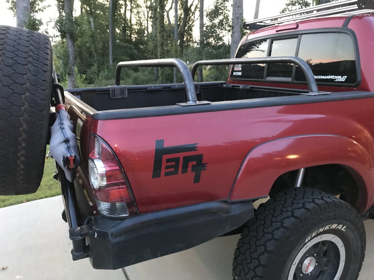

    Bed bars with an 8” rise. Turned out nicely. Good, snug fit to the bed rails thanks to my bed rail jig. Not for me, by the way. My truck is heavy enough as is. :D

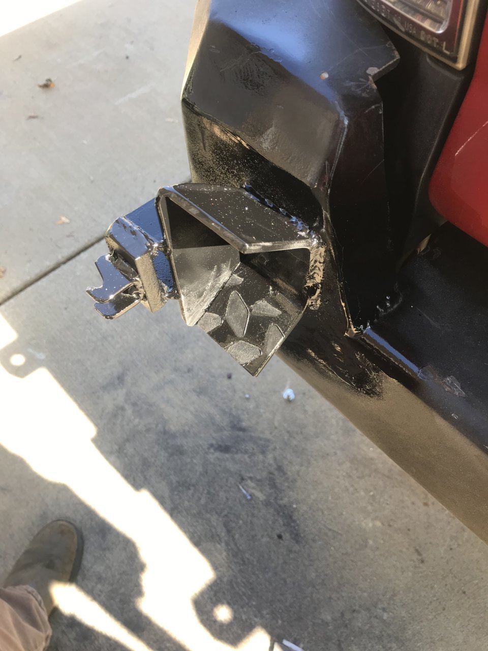

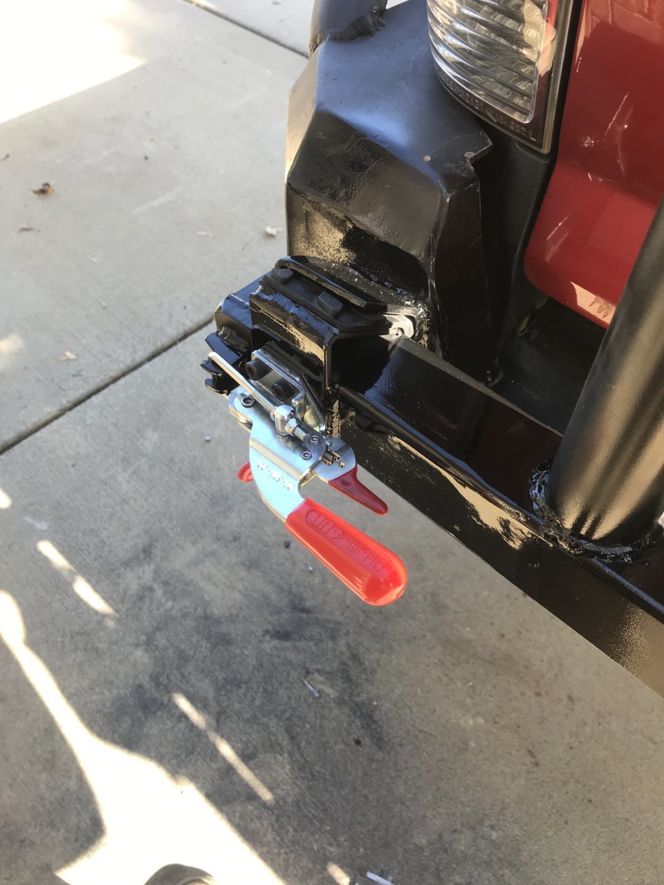

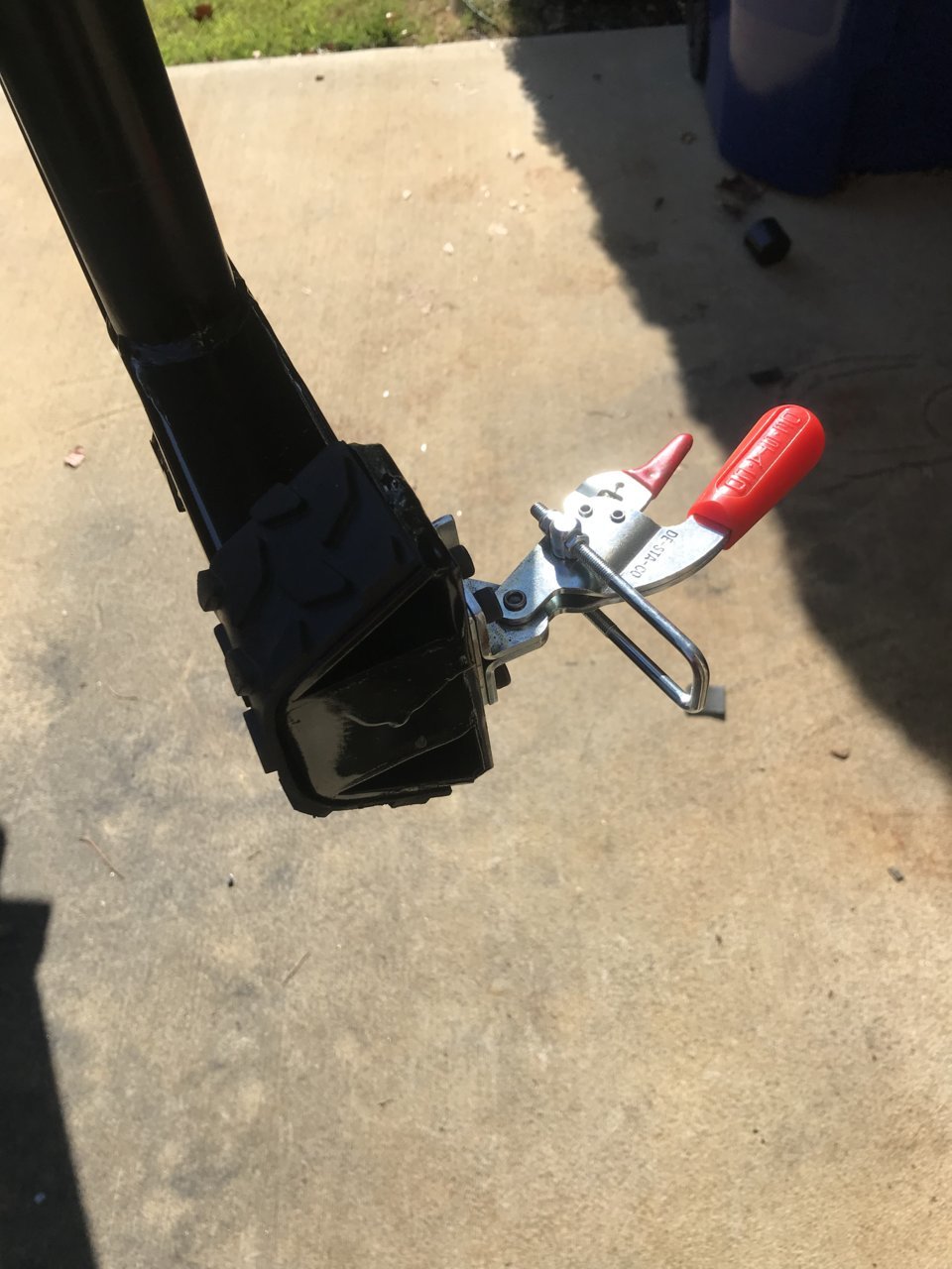

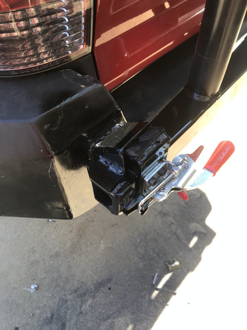

    Finally got around to fixing my swingout latch setup. Much happier now. Built it so that it self centers and locks down with a bit of preload to avoid any shifting. No more knocking sounds when I hit a bump.

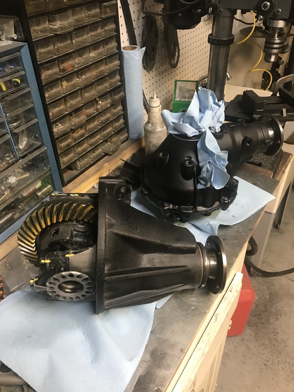

    Gears ordered from East Coast Gear Supply! Looking forward to getting my 4.56 gears swapped in. Will be a definite improvement over what I'm currently driving around with.

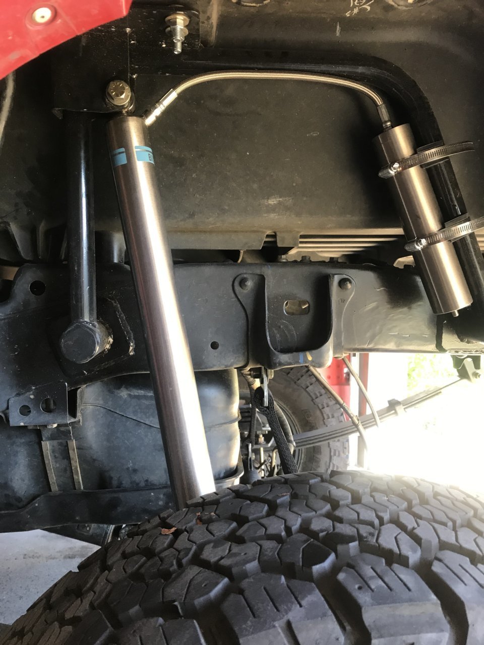

    Bilstein 7100s with heavy compression/rebound damping installed today. Ride is so much more manageable now with minimal body roll (for a truck). Truck feels all around tighter now and much more responsive to steering inputs. Dimensions are the same (within a 1/4 inch) of the last set of shocks that were mounted so I had no issues getting to work with my custom setup with the 63s.

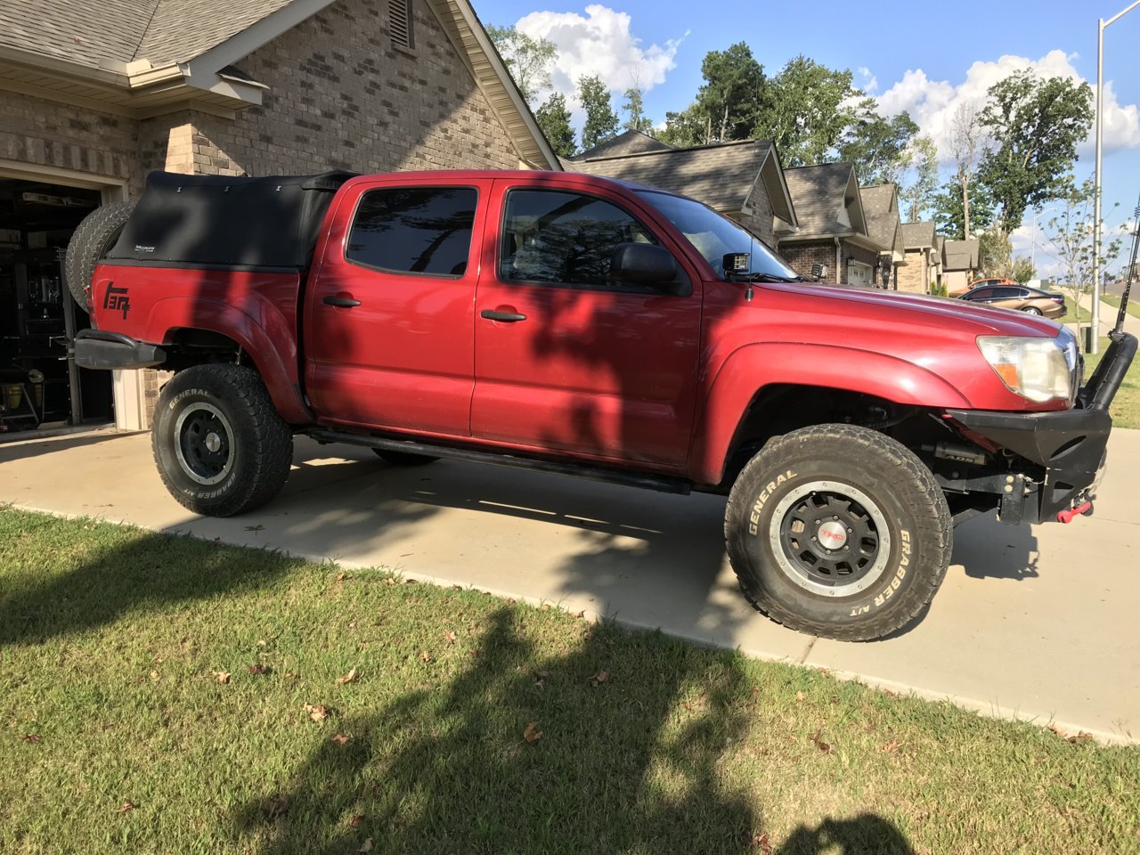

    Traded my Prinsu Rack today for a Softopper. I think it was a solid trade, I’ll be getting more use out of this than I did the rack.

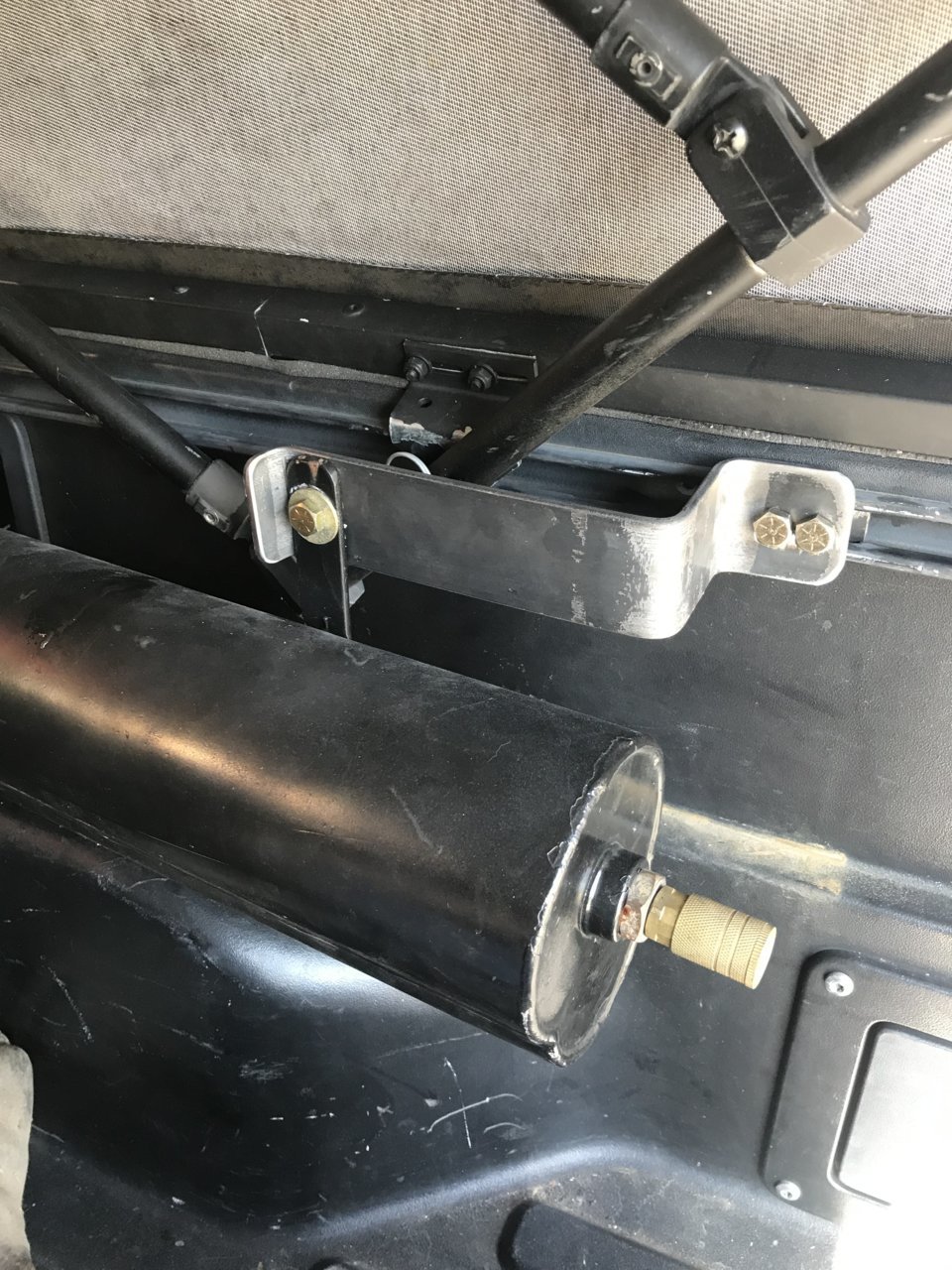

    Needed a work around for my air tank to be able to mount to the original location on the bed rail with my softopper installed. So I bent up a bracket from some 2”x3/16” flat stock.

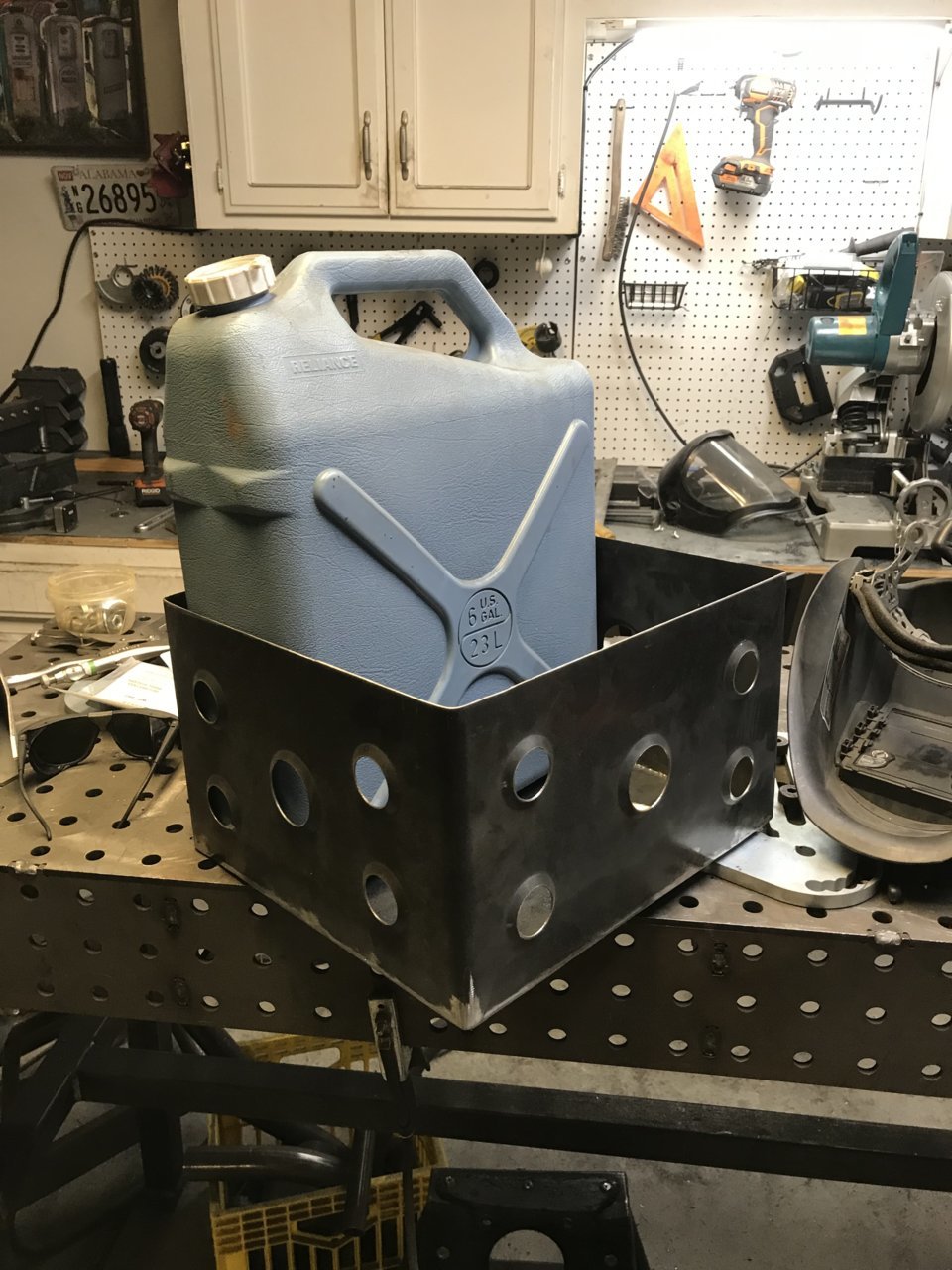

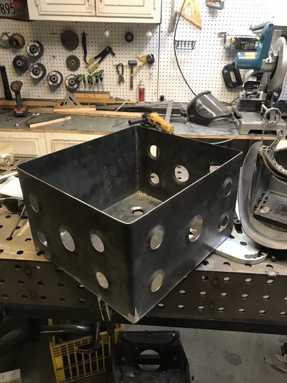

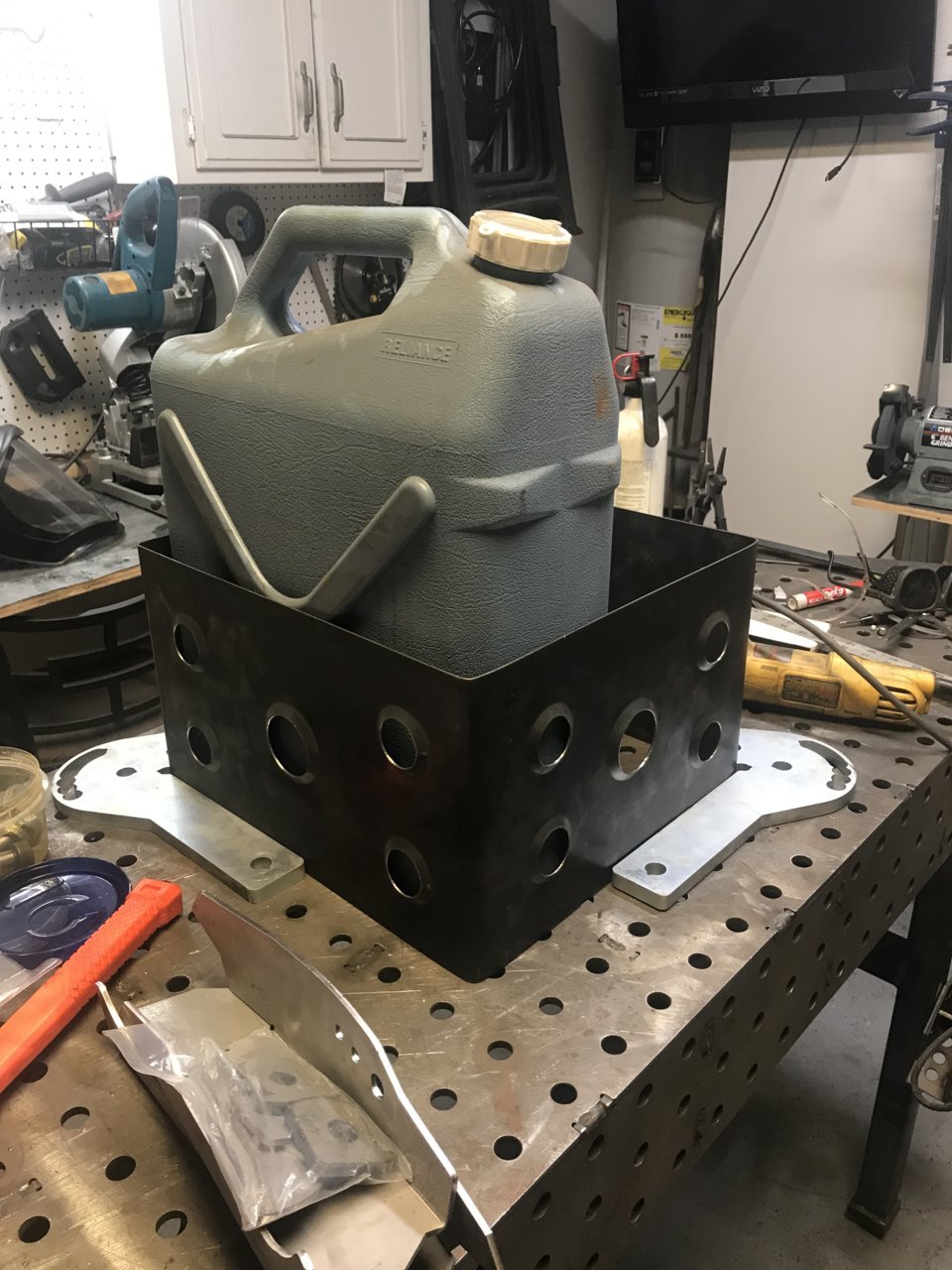

    Finished the jerry can/whatever holder basket thing for my swingout. First time working with 16 gauge sheet. My welder is not a fan of thinner sheet metal. Makes me want a TIG welder.... anyways, I’m happy with the dimple placement and overall strength. It hardly weighs anything too which is nice.

    What do y’all think? I feel like it’s a bit much... probably only use it when I actually have the need for additional water or fuel. Looks too weird to have attached for daily driving.

    Like the concept just looks kinda like the plastic "designer" egg crates that you can get at a department store. I like the crate as you can haul more than just the cans if the need arises.
