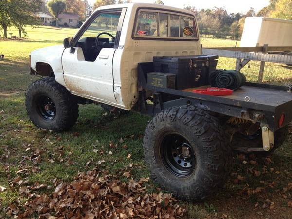

    figured i would give an update on this thing.. got it all put back together new brakes, master cylinder, some new tread and got 4.7 case gears on the way.

    Did you use the bigger 1" bore master cylinder? I put in a dual diaphram booster, 1" master, and blocked the LSPV and installed a manual proportioning valve for the rear. All that made a huge difference.

    the axle that i got to put back under it the brakes were ceased up so i put 88 pickup rotors and calipers on it and they wouldnt bleed properly so i had to replace a wheel cylinder in the rear and put a oem master cylinder back in and everything seems to be working fine now.

    I had just put a new master cyl on, that's odd it needed another..

    Yea man I guess whenever the seals came in contact with air when we disconnected the lines it just ruined them because it wouldn't build pressure to bleed.
