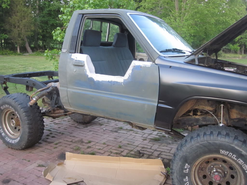

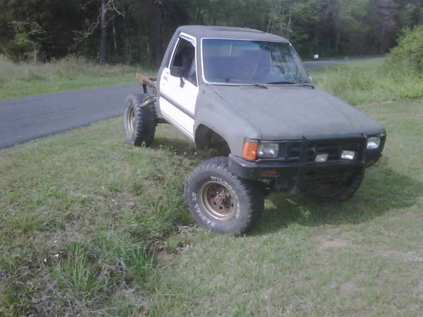

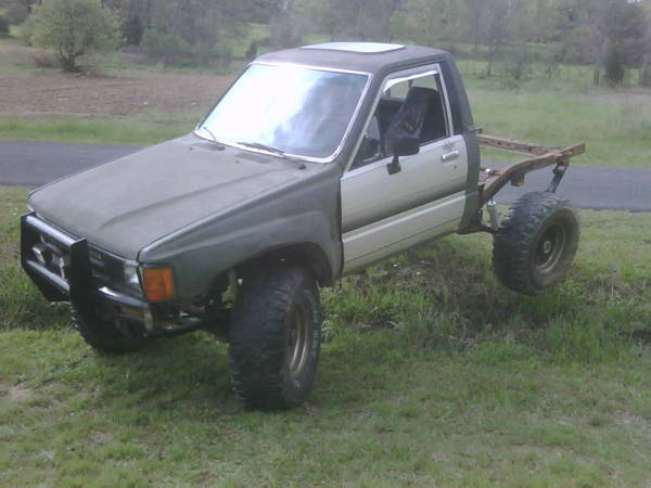

    I meant to post this the other day, how it looked pre-lift

    i think its awesome that you can and did the work but honestly i think you shoulda took more out of them
  6. Mar 31, 2012 at 4:35 AM
    #26
    jerretxx
    jerretxx [OP] Some do, others talk
    May 23, 2010
    #37692
    2,233
    Jerret
    North Carolina
    2017 DCSB Tacoma TRD Sport 4x4

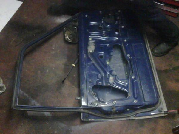

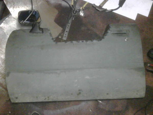

    the reason i didn't take more is because i wanted to keep the factory outside handle and mirror, but also, we measured it to the perfect arm rest height :D

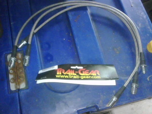

    ^ new bench seat installed (Thanks to chris at MARSFAB off road)
    ^ SS Trail-Gear Brake lines (Thanks to damion at MOBSFAB)

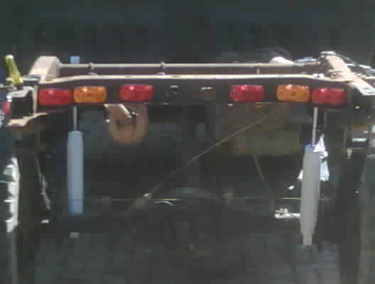

    Hooked up new tail,stop, and turn lights. Also was able to hook up my aftermarket temp gauge

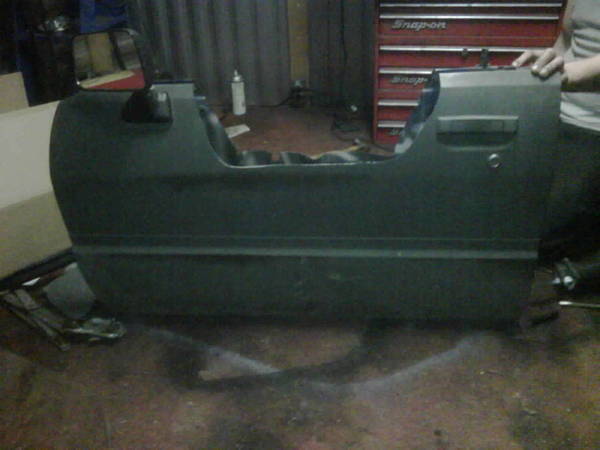

    I also meant to add that the half doors are almost finished, just need to do a little more bondo and sanding and they will be complete

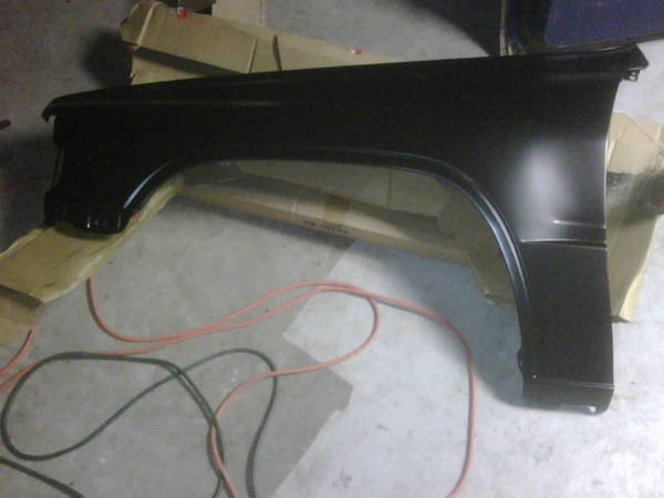

    I got my new fenders in this afternoon. Bought them from my buddy matt at Halls body shop, great guys to deal with! I went with fenders off of a 1984 toyota 2WD, yes I am putting 2wd fenders on a 4wd. I put 2wd because they do not flare so they are a little narrower. Ill post pics tomorrow once I get them installed

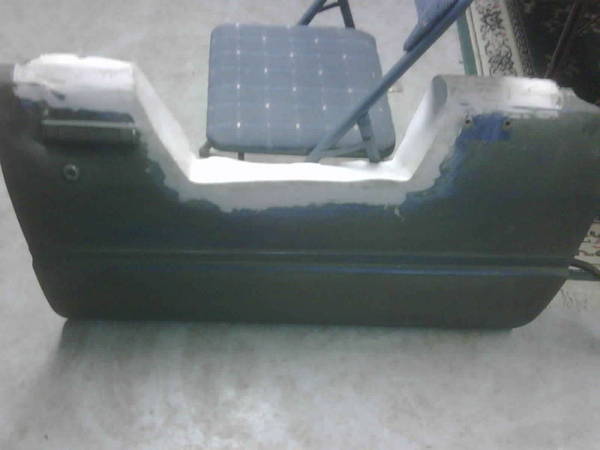

    Finally finished up one half door. turned out good IMO. I put some bondo to smooth out the imprefections and make them look sleek when it is painted. Not too bad considering I only have $6.77 in them :cool:

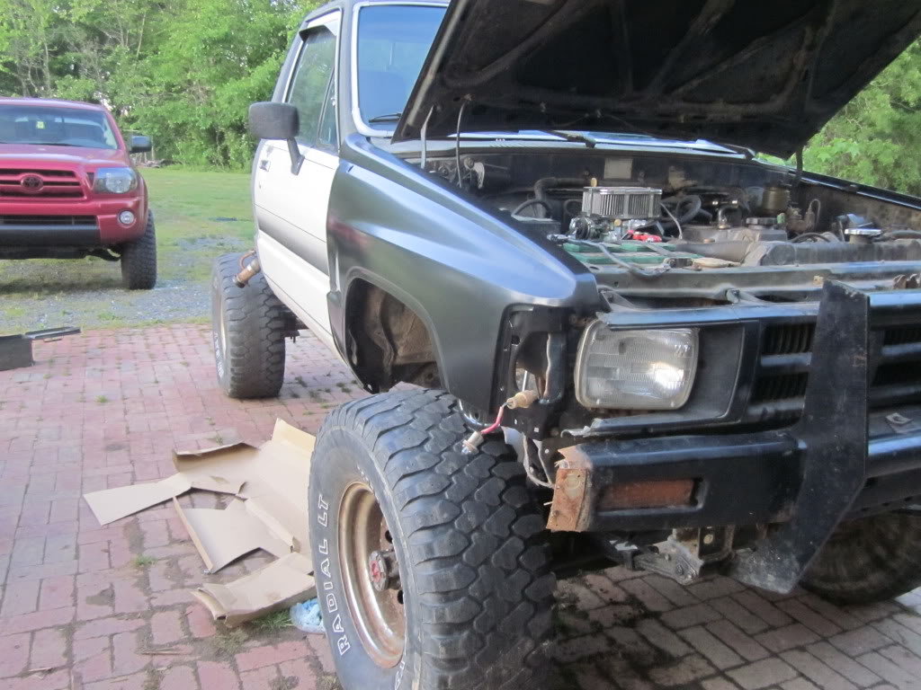

    So i have the fenders mounted. I bought fenders for a 1985 pickup 2WD and they mounted up PERFECT, im very pleased with the result. Also I mounted up a half door just to see how it looked, and i must say im impressed with them as well.
