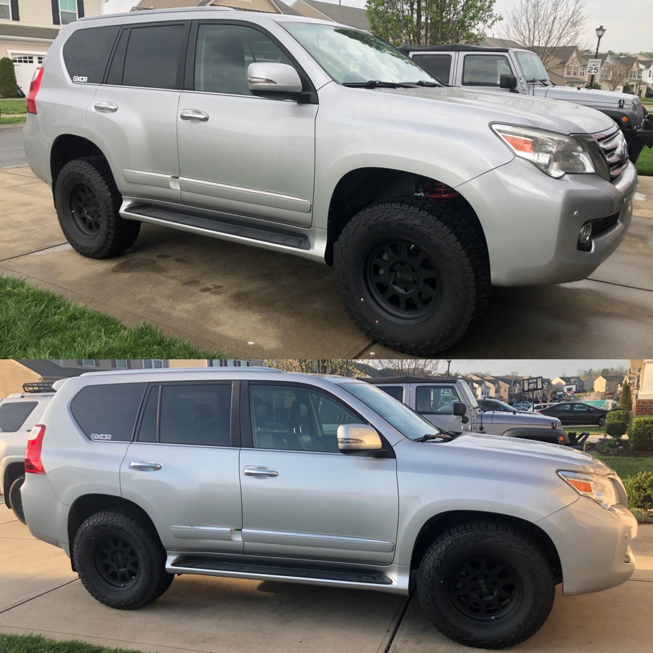

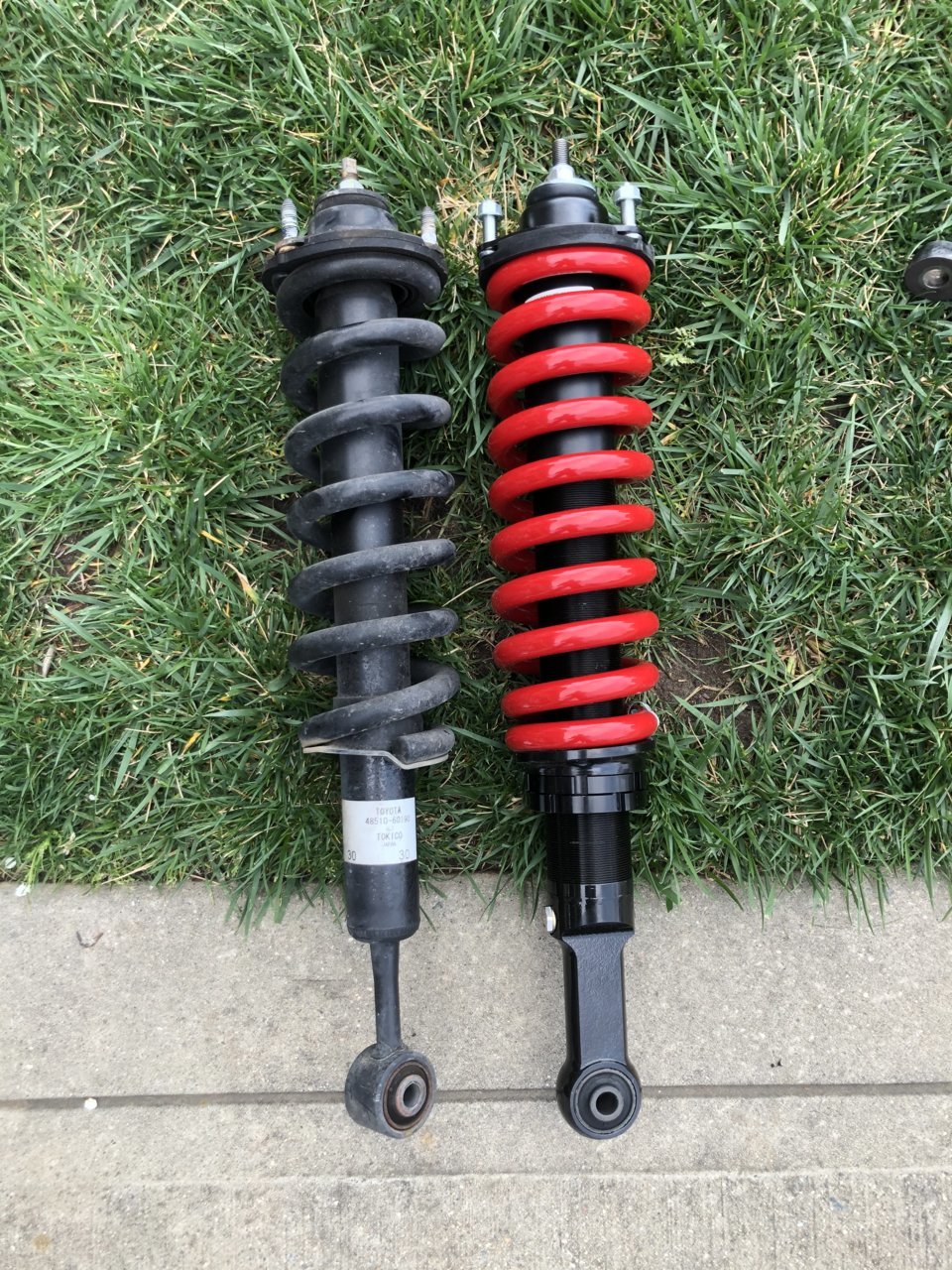

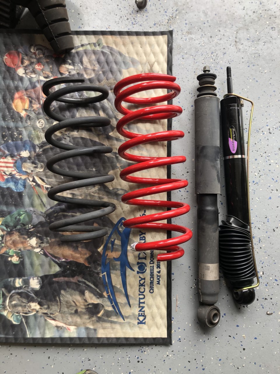

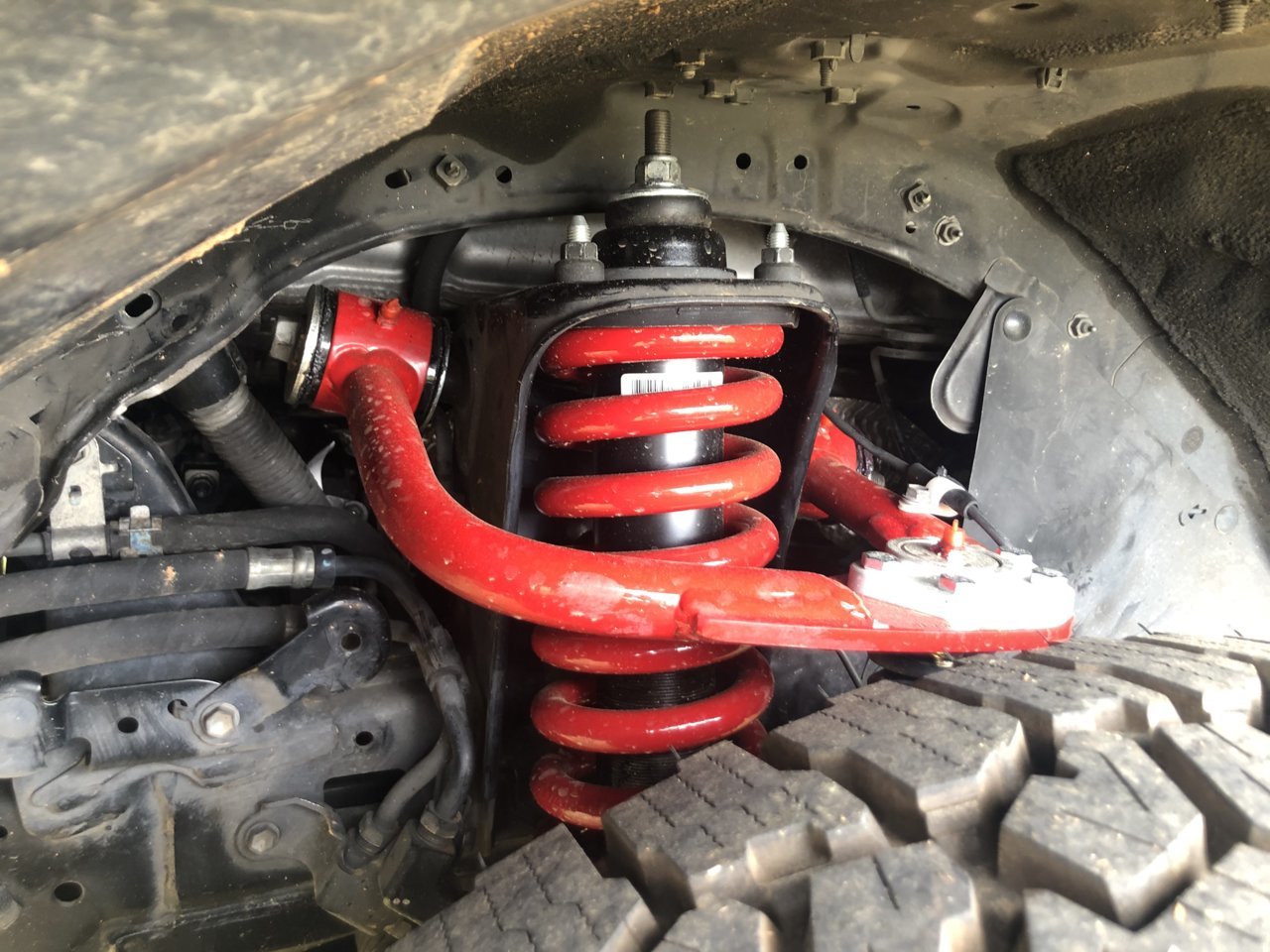

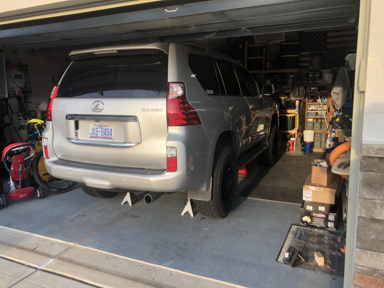

    Lift Update:
    2 half-days of work (had family plans)
    2 guys (friend welded my spindle gussets, I did most wrenching)
    2 trips to Lowe’s + 1 Amazon order
    Rear is complete except for KDSS spacers (see below)
    Front will be completed one evening this week, currently the paint is drying on the spindles
    KDSS is a PITA. I decided to open the valves 3 turns per the ExitOffroad method LINK. With the valves open, the KDSS does move easily but it still requires a jack so getting enough space to insert the Treaty Oak spacers is still a little tough. But that’s not the worst part...
    I had 2 bolts snap on the rear KDSS! The forward-most bolt on both sides of the rear snapped. Both were very rusted and I have practically zero rust on my vehicle. The rear-most bolts were not rusted and came out pretty easily with hand tools. We tried liquid wrench and heat on the second one but it still snapped. Now I have a handful of screw extractors and cobalt bits inbound from Amazon. Annoying and wasted some time but whatever.
    My friend questioned whether I need extended rear brake lines while we were trying to shove the rear spring in there, and I agree with him, it looks like I may but it’s only 2” lift, not LT. I’ll see what it all looks like once I get the wheels back on and can flex it out a little bit. I have no problem doing rear brake lines if needed.
    The Dobinson IMS are beefy compared to stock or 5100’s like I had on my Tacoma!
    A72E04D6-076E-4C42-A4AC-23C43A634800.jpg 94E26E3E-3C79-4446-BB1E-479DD0198CCE.jpg
    I have been capturing some video along the way, so I plan on putting together a simple video once it’s all done in the next few days.
    Thankfully I work from home so no rush on getting this done, but it will be done by Friday since I’m off work and plan on going off roading Friday!

    Unfortunately, KDSS has turned this from a weekend job into a week long job. At least for an avid DIYer like myself. Those 2 snapped bolts on the rear KDSS have been impossible to remove so I’m drilling them out and re-tapping.
    The rear KDSS spacers turned out to be out of spec. I bought them from Exit Offroad and to their credit, they reached out to me before I had a chance to test fit and offered to replace if mine were out of spec. Treaty Oak is sending me new rear spacers.
    Im hoping to get the front end buttoned up tonight and the KDSS broken bolt hole sre-tapped tonight or tomorrow. If all goes well, I’ll be off roading Friday.
    Good news is the spindles came out great! And I’m still able to get my impact in there to attach the JBA nylock nut.

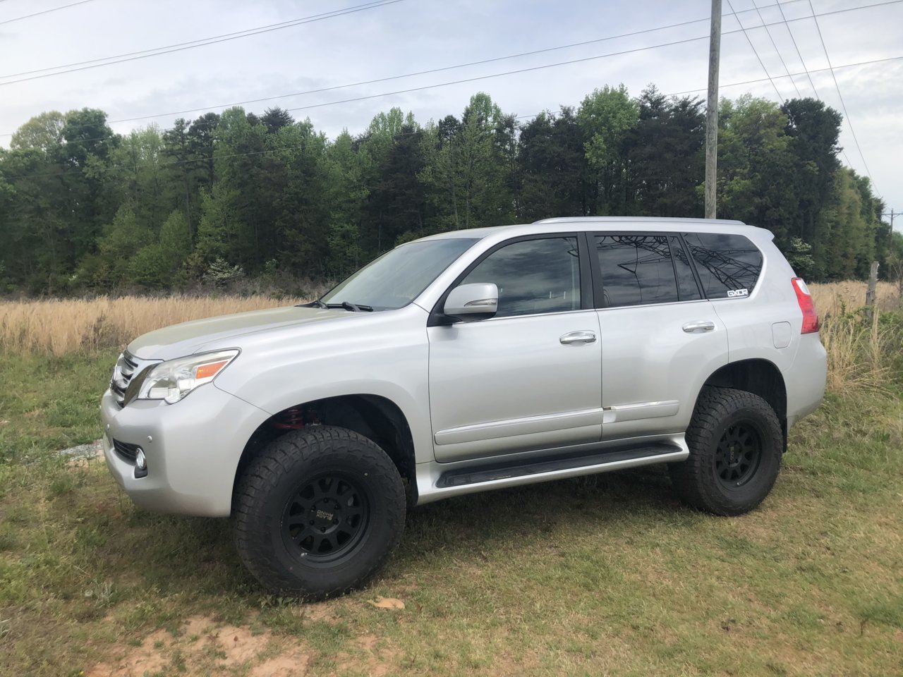

    Sorry, totally forgot about coming back to update the thread after sharing it on GXOR.
    It took a few trips to the hardware store and a few Amazon orders but I finally got it. I was able to drill out the snapped bolts and re-tap/clean the original threads. Dewalt cobalt bits and a good center punch were the key here.
    I work from home so I don’t drive much but I’ve got almost 1k mi on it since the lift. No complaints at all. It’s slightly firmer but I also got medium weight springs since I plan on doing a bumper. The 2.5” lift is perfect for 33”s IMO!
    Even with the KDSS spacers I did have some lean, so I did the KDSS valve trick and that definitely helped. I haven’t taken it off road yet, aside from some dirt roads, since I really want to have my skid and sliders on first.

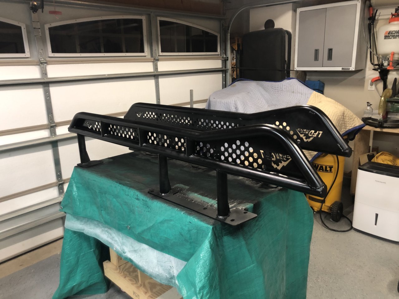

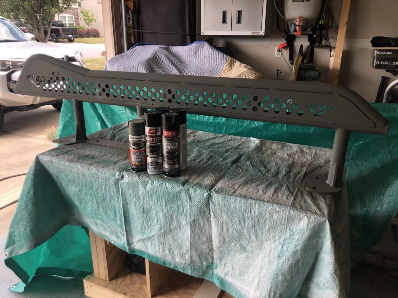

    Speaking of Sliders...
    I was finally able to pick up my sliders from LFD the other day. It took about 15wk but I figured 4-6mo is about the norm these days for anything fabricated, even longer for bumpers. Due to a little mix up, I’ll pick up my skid plate Friday. I went with LFD because they make GX specific sliders, are local, and I won a gift card in a raffle at their shop.

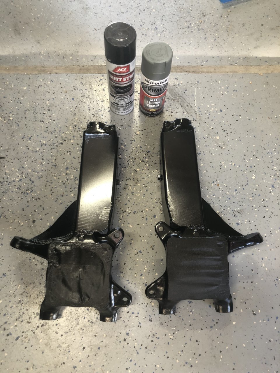

    Right now I’m prepping and painting my sliders. Good wipe down with alcohol, scotch brite pad, wipe down with clean rag. Self etching primer, then black enamel paint, and lastly bed liner. I like using rattle can paint and bed liner because it’s a piece of cake to touch up every 6mo to keep the metal protected and looking new. Plus $7/can for bed liner is some pretty cheap maintenance.
    On the topic of bed liner, that stuff has been almost impossible to find lately. I’ll use what I have but will definitely be doing more coats once I find it. I use the same process for my skids as well.

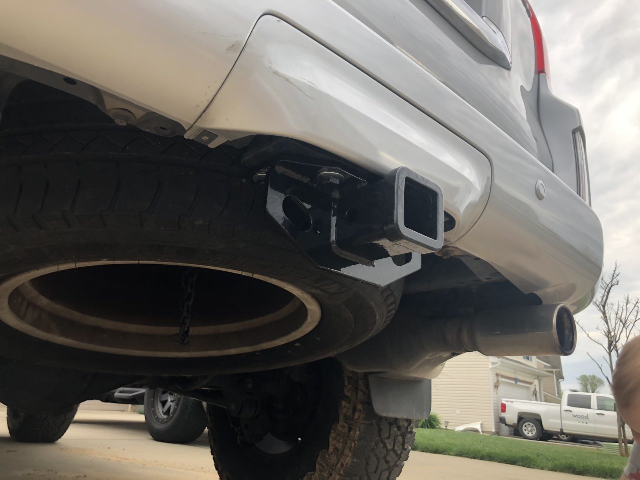

    Hitch Install:
    I needed a basic hitch receiver for my MTB rack, never plan on towing anything. A basic class III hitch will do the trick for me. It was under $100 and took maybe 5min to install. Clean and simple.

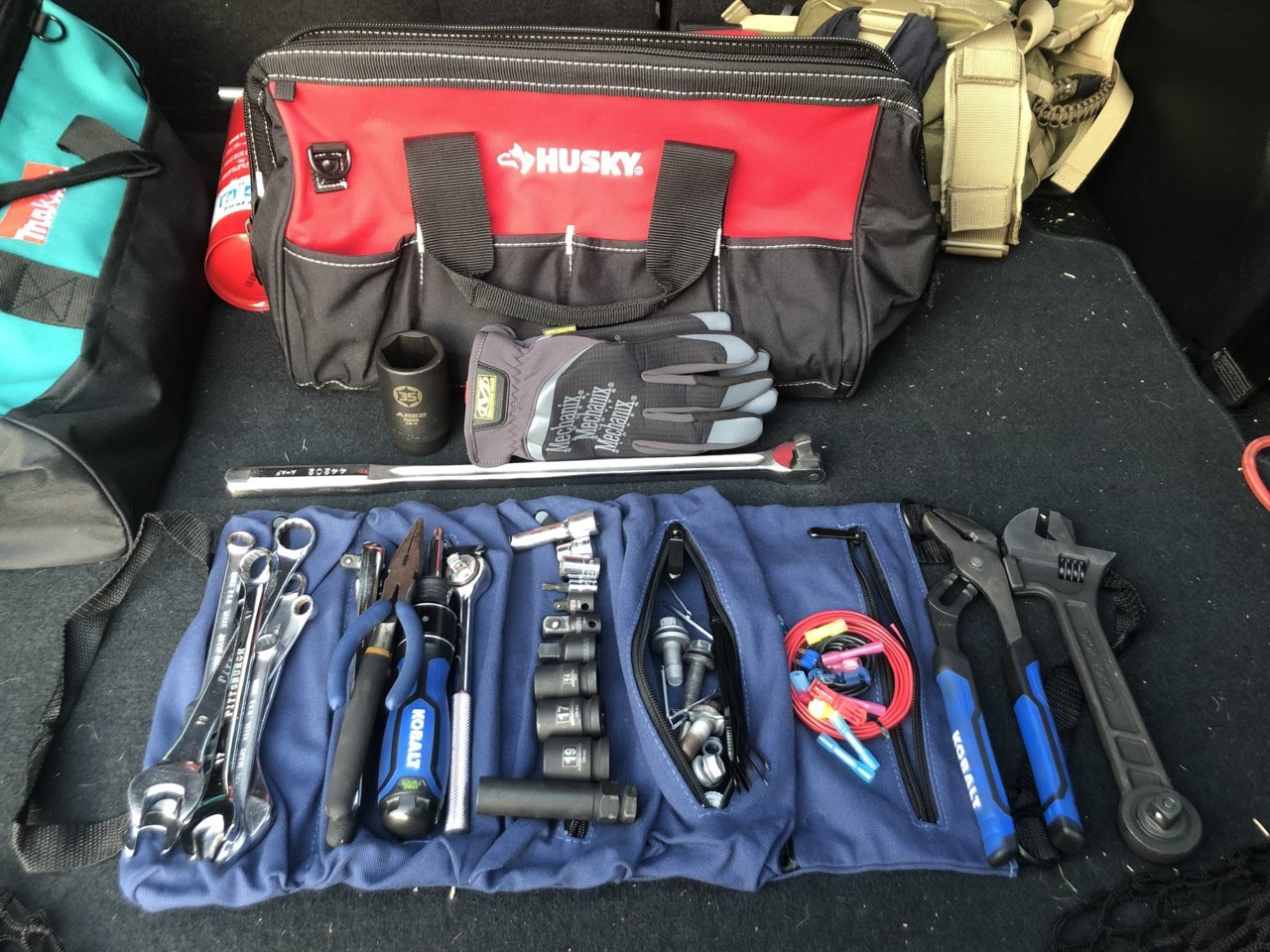

    Tool Kit:
    After doing my lift, I had all of the wrench and socket sizes fresh in my head so I decided to put together a basic tool kit that would allow me to do *most* repairs on the trail/road side. I also threw in some assorted fasteners that fit the vehicle, and various 12v items just in case.
    I chose a tool roll on Amazon and basic Husky tool bag.

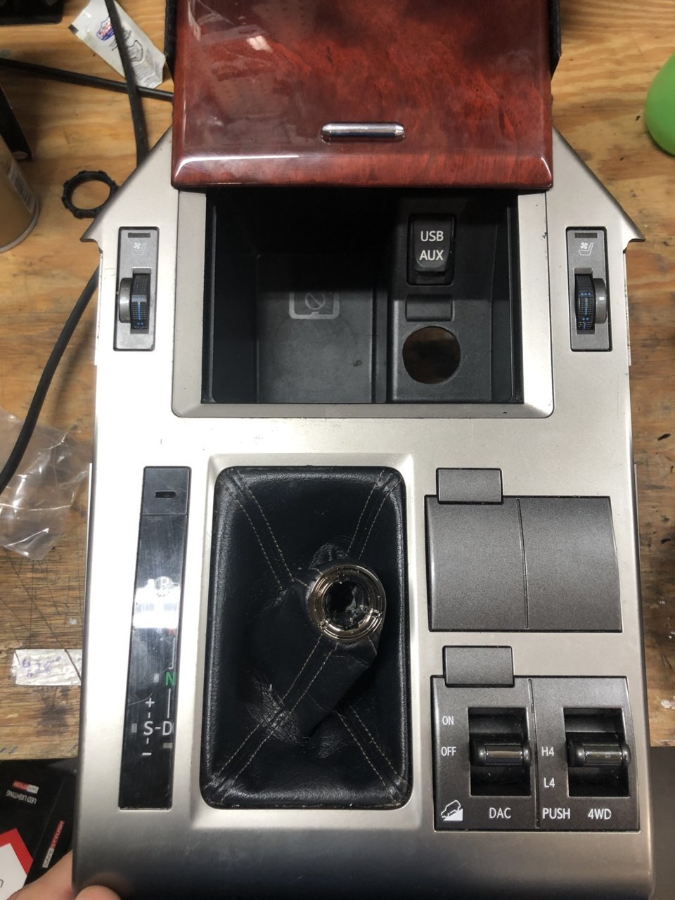

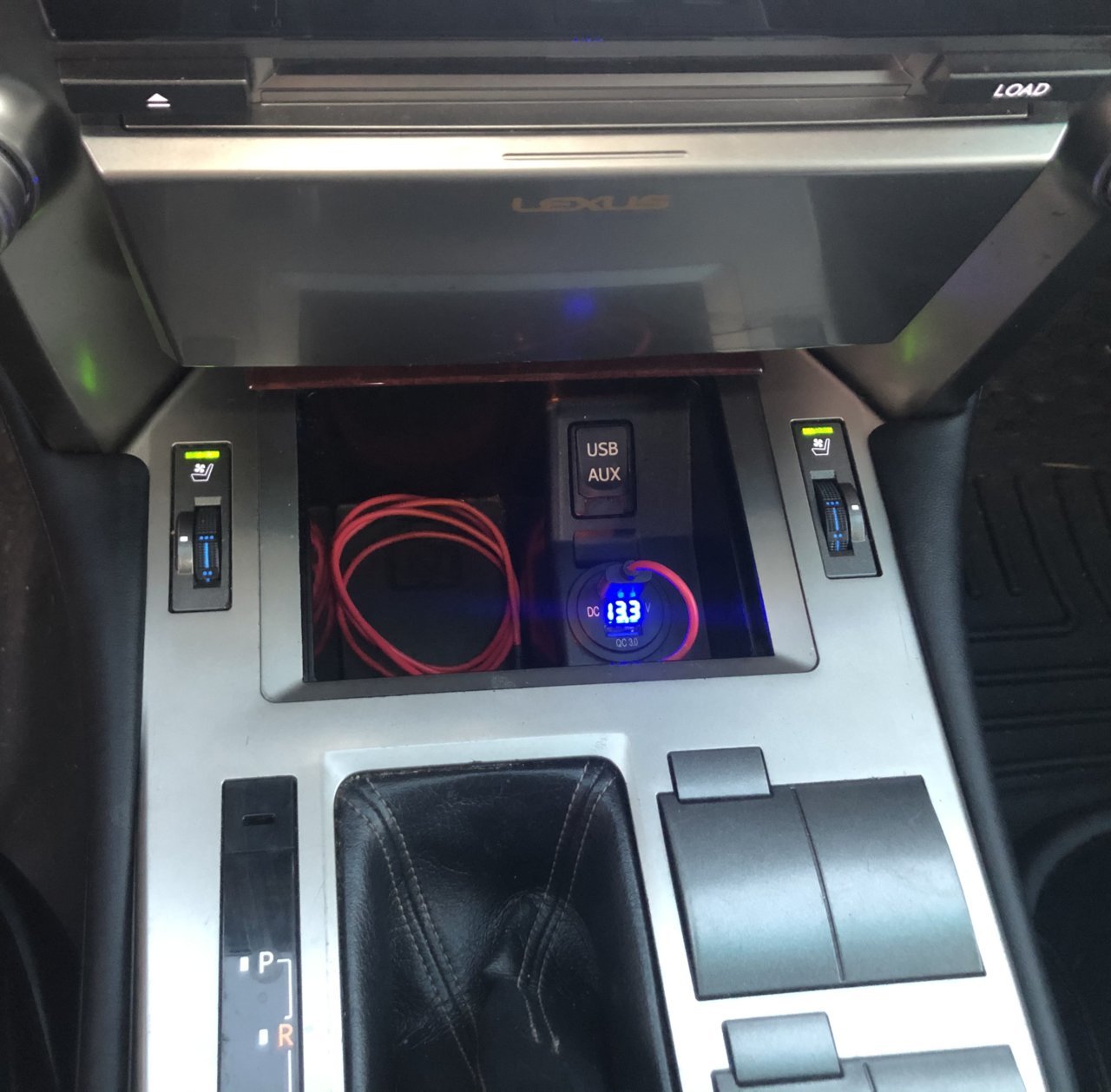

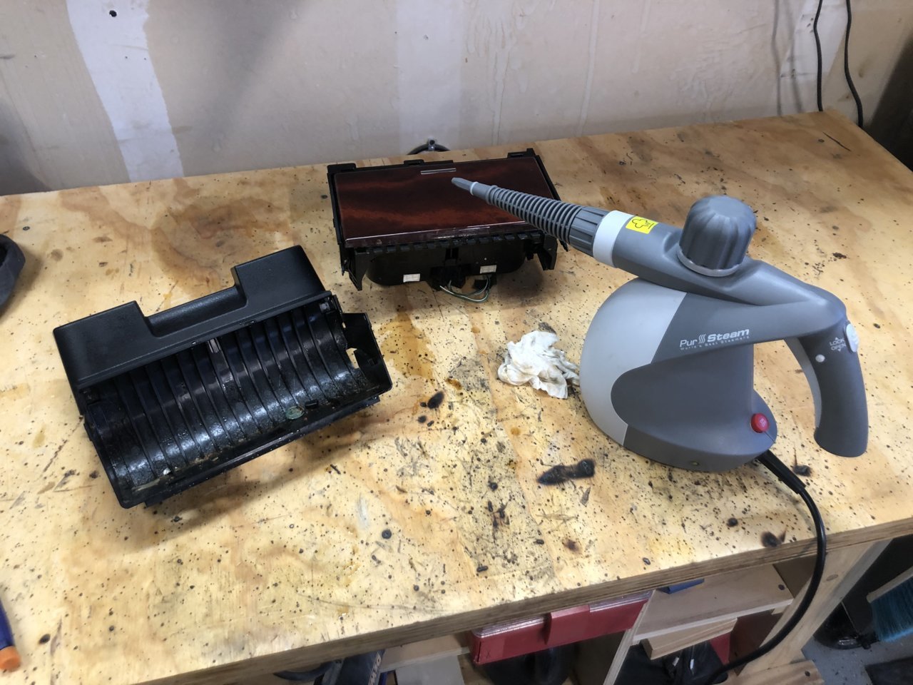

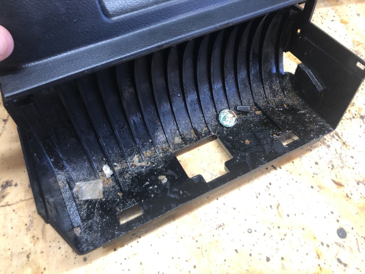

    Dual USB Outlet

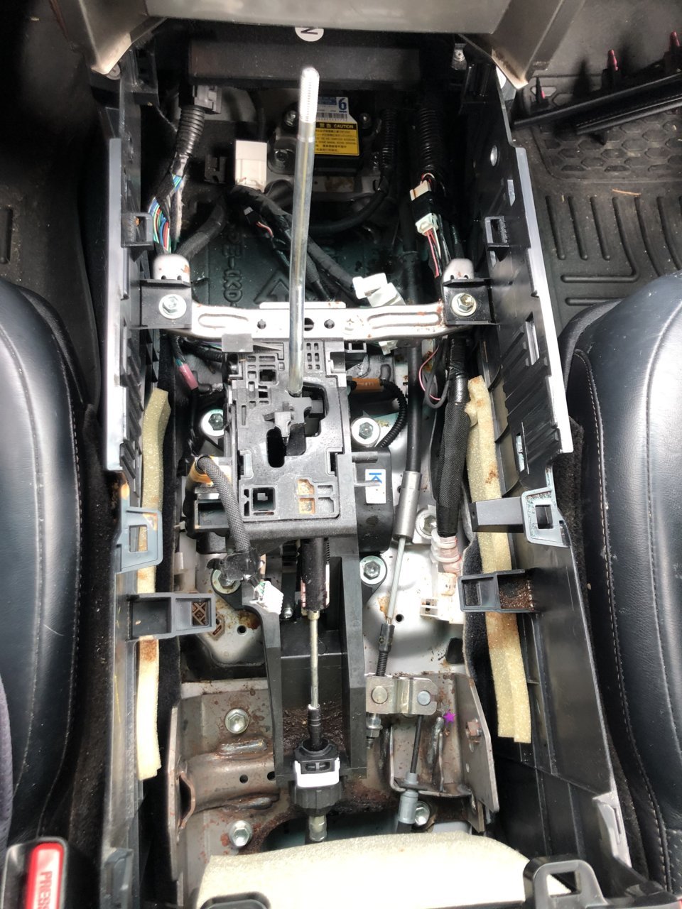

    In July I decided to remove the 12v socket in the center console and replace it with a dual USB outlet w voltage read out. I did the same on my wife’s 4R and it is the perfect solution to not having to debate who gets to use the charger, plus it’s not bulky like the plug in adapters.
    BUT FIRST, as I removed the console parts, I quickly realized I had a disgusting mess in there! Clearly a previous owner spilled some dark soda and it went everywhere!
    I steam cleaned it all and wiped out everything possible. Removing all of these pieces was really easy.
    Now I was able to focus on the job at hand. I used a dremel sanding drum to open up the hole a little bit to fit the USB socket. I was careful to make sure there was room for the jam nut on the underside.
    I popped in the USB socket and used a couple T-taps to to use the existing 12v socket wiring. Nice and clean(literally!).

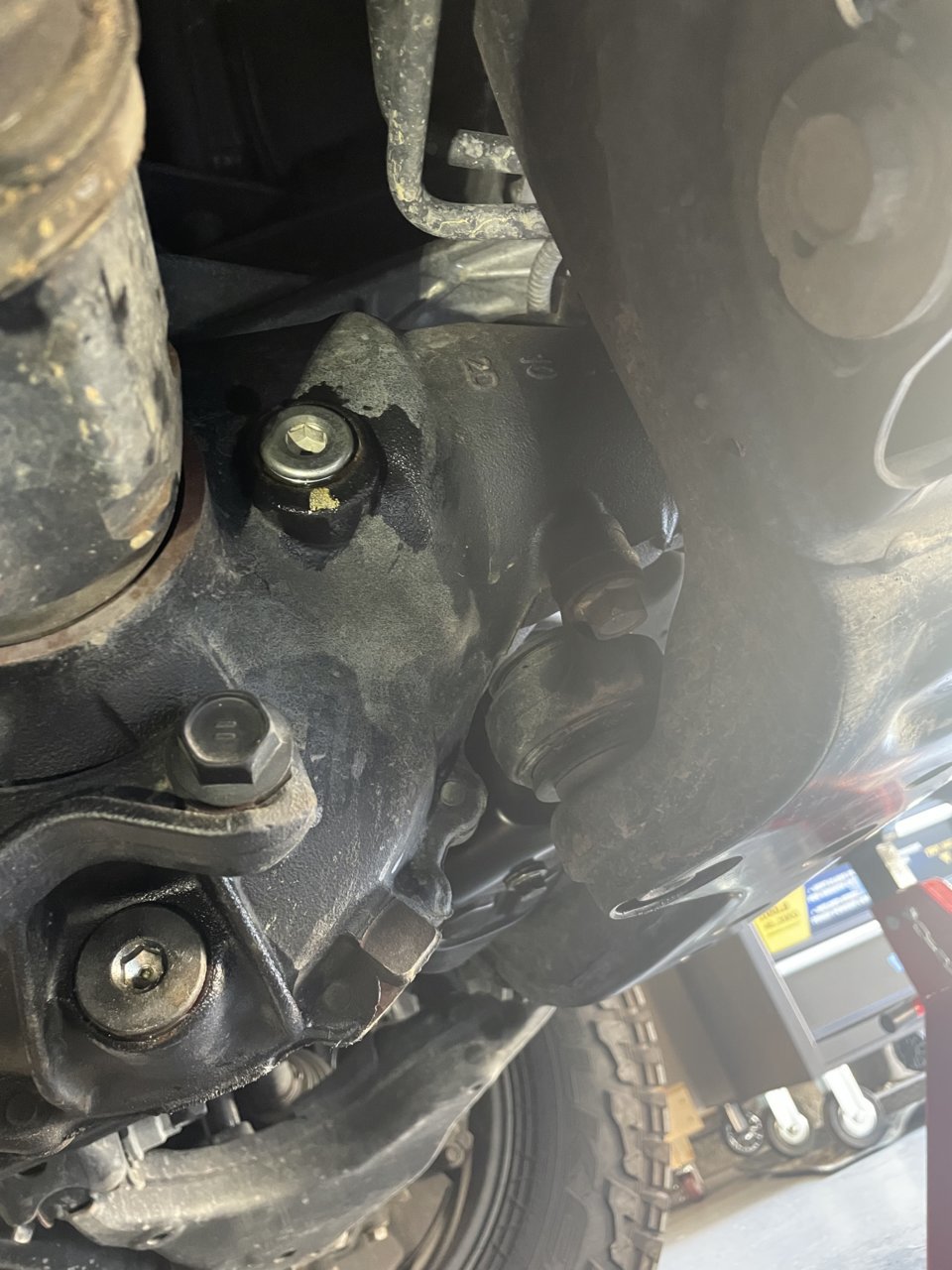

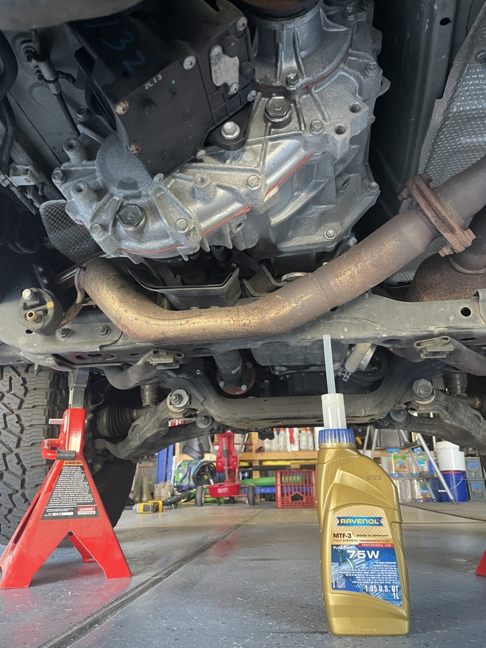

    Long Overdue Fluid Swaps
    Shortly after purchasing the GX, I bought fluids for almost everything, including diff and Xfer case oils. Unfortunately I put off doing those two until I did my oil change.
    Labor Day weekend I finally did my first oil change (I work from home so I don’t drive much these days), and so that meant I was doing the front and rear diffs asking with transfer case. The only fluid I haven’t touched is the trans, to do a drain and fill/top-off. Oh and I sent off an engine oil sample to Blackstone for analysis.
    I decided against the Toyota OEM liquid gold and decided to go with Ravenol MTF-3 75w which is labeled as and widely regarded as a high quality substitute. These Ravenol bottles are interesting, but I was able to maneuver them in such a way to squeeze out what I needed from each of the two bottles, then combine the extra in a single bottle at the end. You can squeeze about 60% of the bottle out but can’t get the bottle high enough under the car to get anymore.
    The diffs got Lucas full synthetic 75w-90 GL5
    627D7684-DA77-492B-BCCD-171C7BA5A714.jpg 44A78105-0119-4FB1-A9AA-C552FF37EF61.jpg
    Thankfully all fluids removed looked really good but I’m glad I changed it to have the piece of mind that good quality oils are in there.

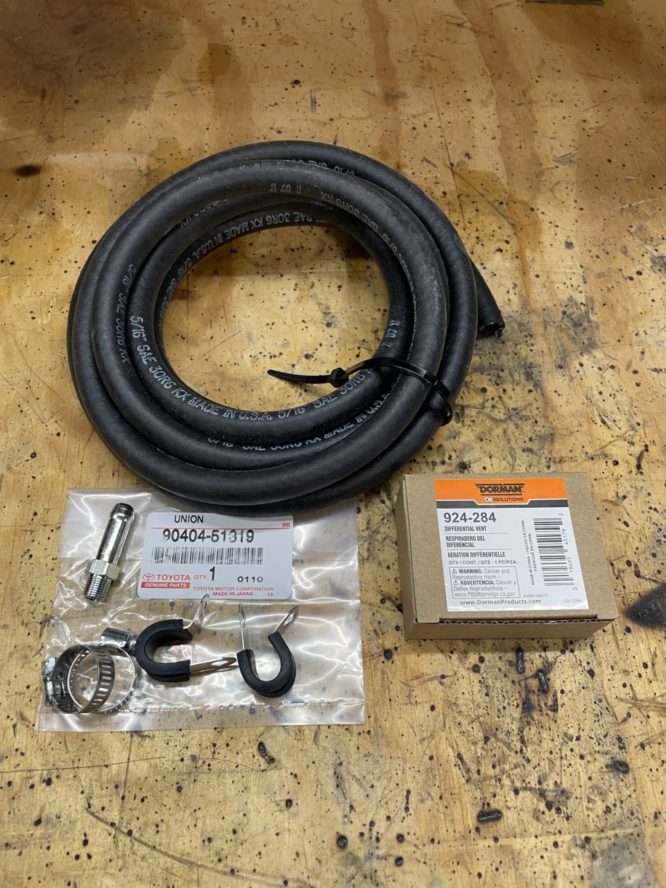

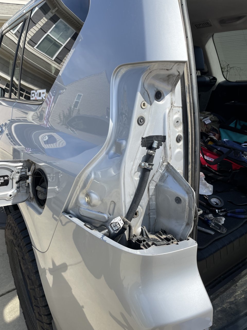

    Rear Diff Breather Relocation
    Just as I did on my Tacoma, I did the breather relocation. Thankfully I still had extra materials from the Tacoma so all I had to buy was the make fitting and the 2-way breather itself.
    I routed it along the brake lines up to the body, kept it high to prevent snagging off road, and then up behind the tail light. I put some electrical tape behind the breather just in case it rubbed the body, but I’m going to check this after a couple months to see if I need a more permanent solution or not.

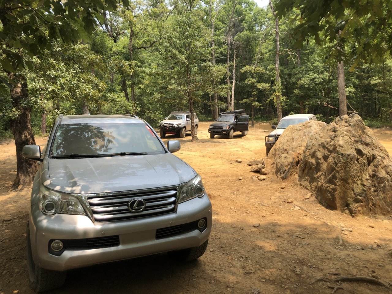

    Part 1: Uwharrie
    The last weekend of July, I went out to Uwharrie with some fellow Charlotte Toyota guys, and we had a Jeep Cherokee with us as well. Sadly, we had 2 mechanical failures, both FJ’s, early on, but they were able to be fixed and driven home.
    We had a pretty slow pace with a lot of stops but it was still fun and served as a good confidence builder for the GX.
    BC402BF1-C24E-472D-B58B-30E37D6BB318.jpg FA7B4496-6761-4216-B28F-1480E4BAB58B.jpg

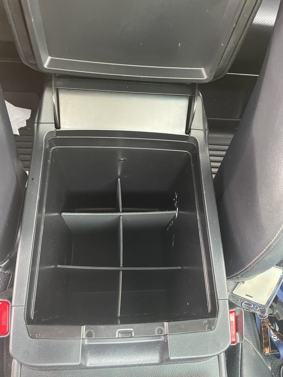

    Center Console Organizer
    I’ve been looking for this since buying my GX but OCD didn’t make one. Apparently now they do! This one is a textured slightly flexible plastic material, almost like kydex. The ones for my Tacoma and wife’s 4R are a sturdier, smooth ABS plastic. I prefer the ABS but this will do.
    The sections aren’t all the exact same size but they allow you to easily fit a pair of sunglasses, radio, a few masks, or a knife/light/pepper spray in each one.

    #35923
    3,247
    i just installed a diff breather on my 2012. i jammed it up into the bumper and ziptied it in place. i like your location a lot more. the light can still be installed and clip in correctly with that back there?

    ‘13 GX460
    Yup, it fits behind the light just fine. There’s not a ton of space behind GX tails like there is with 3G Tacoma’s, but right where I have it works like a charm.
    While I don’t plan on going through water over my bumper, I think that’s a little too low for a 2 way vent. I would use a 1 way vent there to be safe. You can also install the vent in your gas cap area, I’ve seen a few guys do that.

    3,247
    Cool good to know. Yeah, I've added diff breathers on all of my rigs. I like the behind the tail light location - think i'll move mine later. thanks for the idea!

    Dobinsons has 3 different types of shocks for the Tacoma (twin tube, IMS monotube, and MRA 3-way adjustable with resi), so there are more options than OME has, as well as more spring options in multiple rates.
