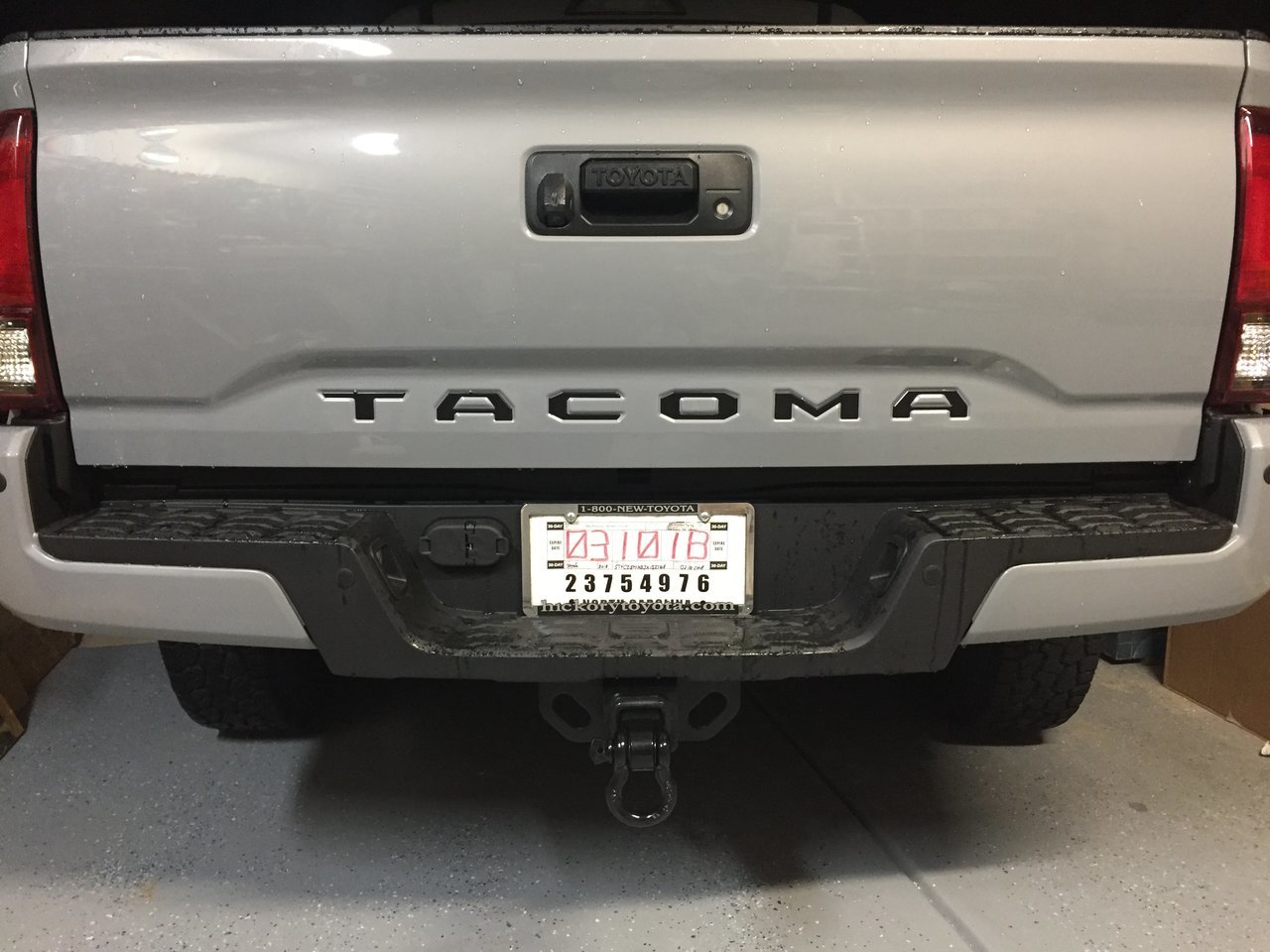

    Shackle tow hitch
    Smittybilt tow strap
    Installed my LED lights and some decals today, and I removed the V6 badge on the tailgate.

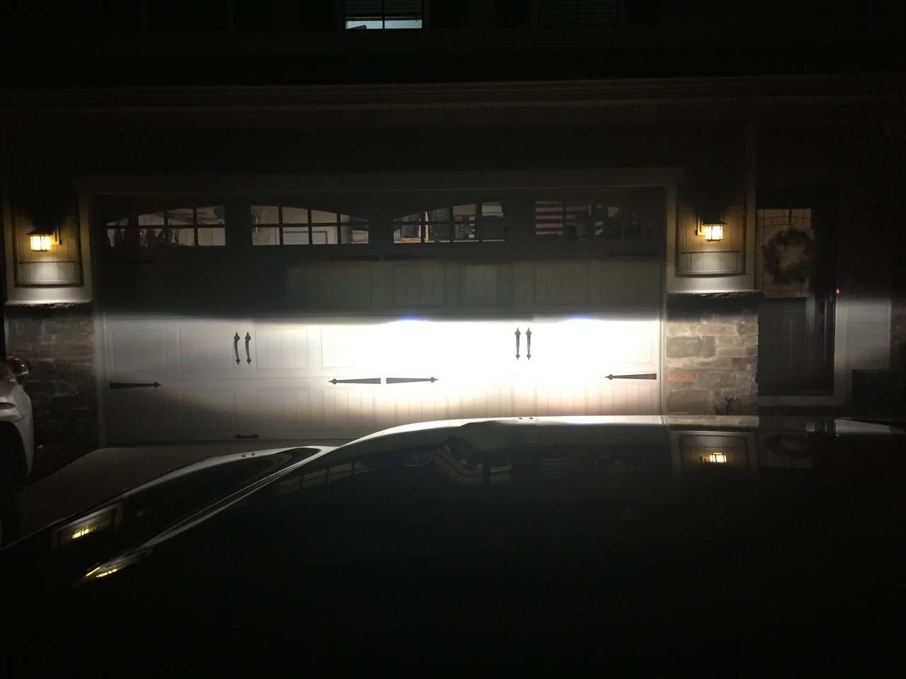

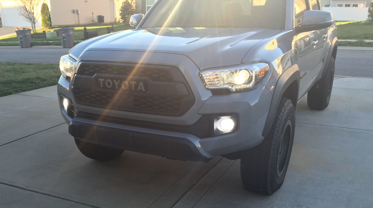

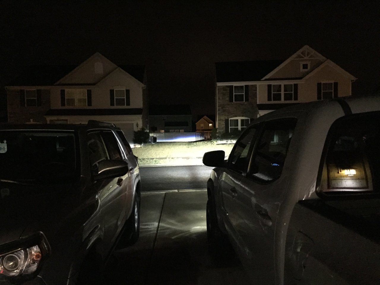

    Installed my Hylux CNLight HID kit last night and OMG!!! I hate the stock lights on my wife's 2016 4Runner and the Tacoma's are identical in performance, or lack thereof. When I first turned on the HID kit, I immediately noticed a pretty clean cutoff and easily twice the light output.
    I took it for a short drive down a country road nearby. That road is nothing but trees and/or open fields on each side of the road, no light source in sight. The throw was easily 25% greater and the light output had to be double. I could actually see everything clearly rather than fighting to make out what was only 75ft in front of me, barely illuminated by the stock nearly-yellow H11 halogens.
    I spent $90 on the HID kit and $60 for 2 sets of the LED bulbs for my fogs and highs, and it completely transformed my lighting. I was set on adding a lightbar, but I'm not sure I need one now.

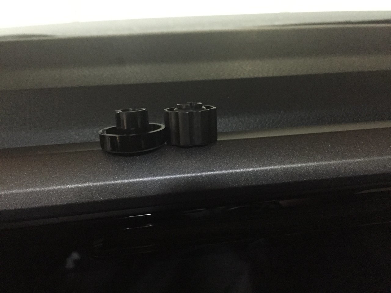

    I stumbled upon some Hondo Garage radio knobs and do dislike the OEM knobs because they're so shallow. The Hondo knobs give you a little more to grab onto and what sold me was the AR15 bolt engraving, that was a done deal. Knobs inbound!

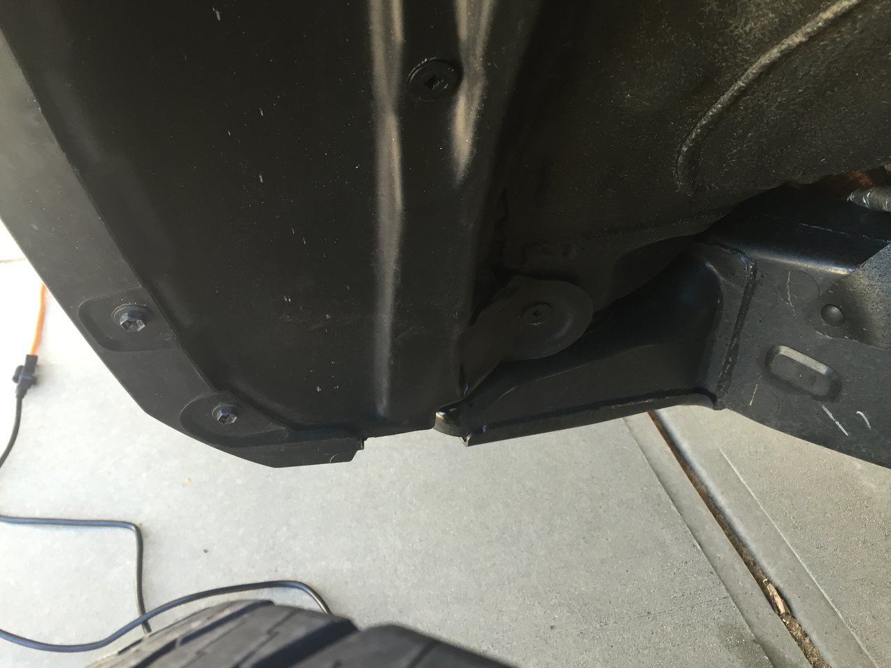

    I've noticed some rubbing while pulling in and out of my driveway, so I'll have to investigate this weekend when I can get a friend to help me pinpoint the spot. Hopefully it's just the wheel liner or some other plastic that a heat gun can take care of.

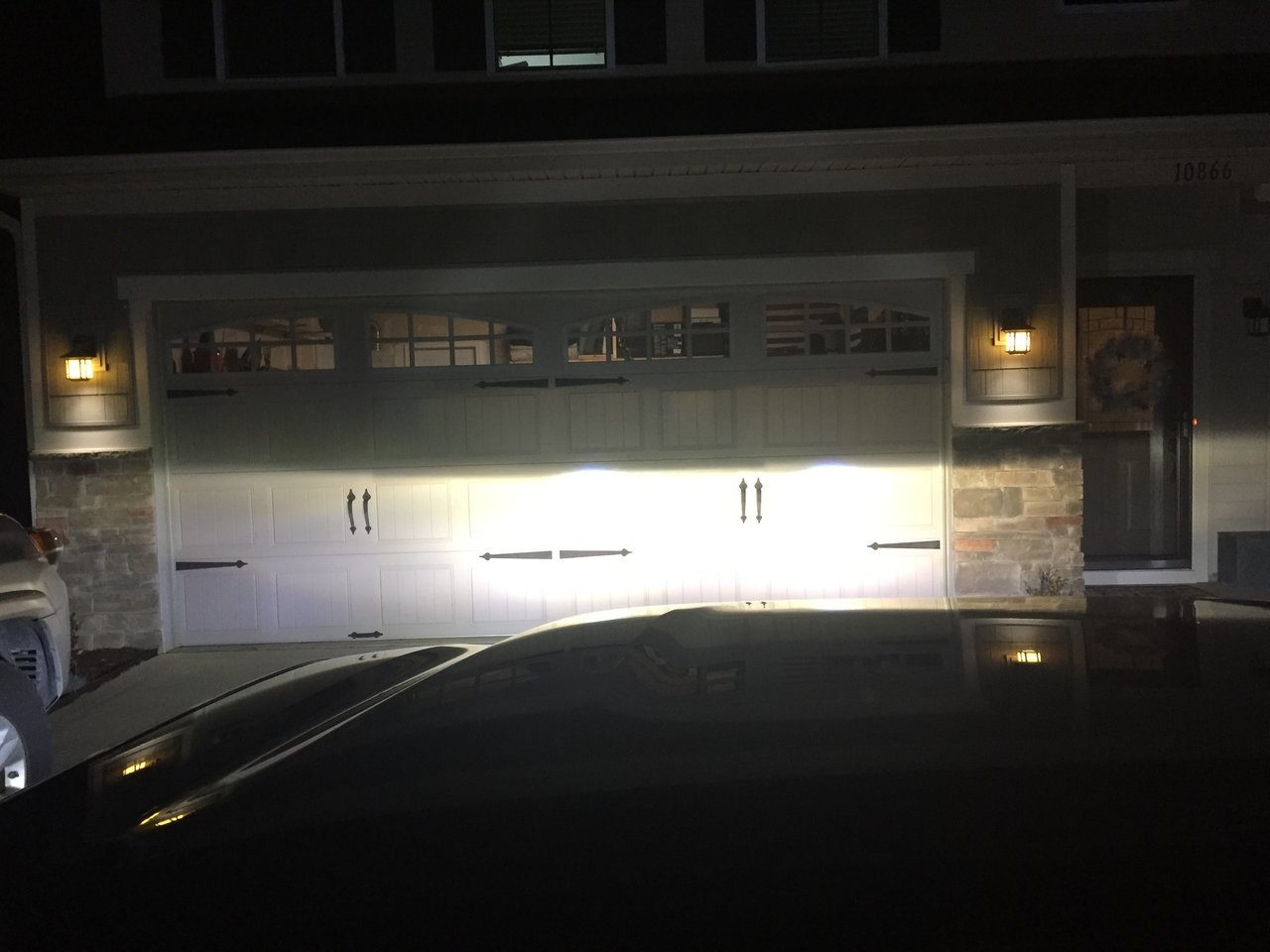

    I had to modify the base of the H11 HID bulbs to fit the Tacoma's H11B socket, so that the return wire wasn't in the 12o'clock position which created a long shadow directly in front of the vehicle. This shadow can be seen in previous pics.
    I also leveled the fog lights so to not blind oncoming drivers.
    I'm really liking this Hylux HID kit with CNLight ball type bulbs! Super bright, clean cut offs, no humming/buzzing, or bouncing. Can't beat it for $80.
    Low beams only
    Low beams + fogs

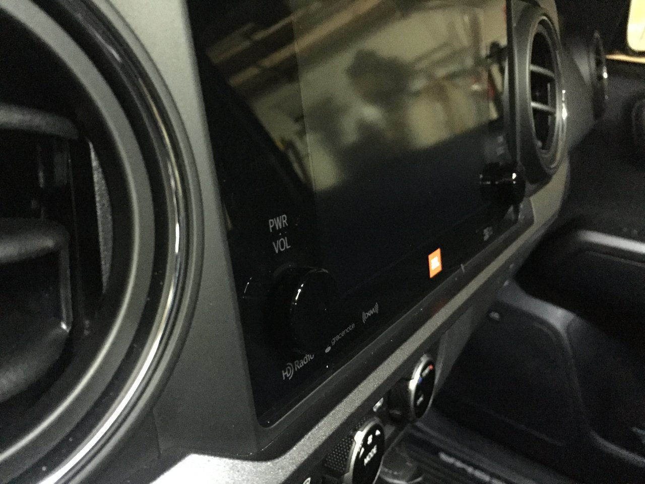

    Added Hondo garage radio knobs. @wileydavis
    I disliked the short knobs from day 1 and came across the aluminum Hondo knobs. Admittedly, I balked at them until seeing that they offered an option with the AR bolt face logo (BFL). I'm a big AR guy so it was a done deal.
    I received them yesterday and they're perfect.
    Before

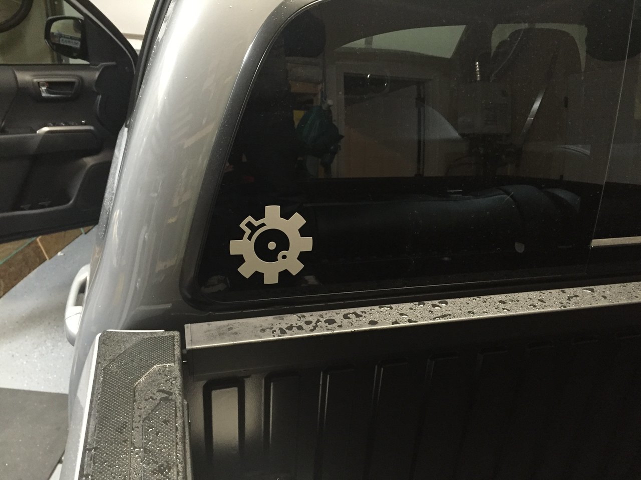

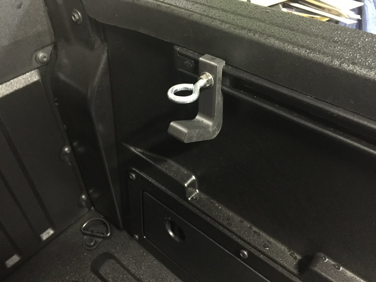

    I 3D printed a couple bed rail hooks based on this model from Thingiverse.
    https://www.thingiverse.com/thing:2347251

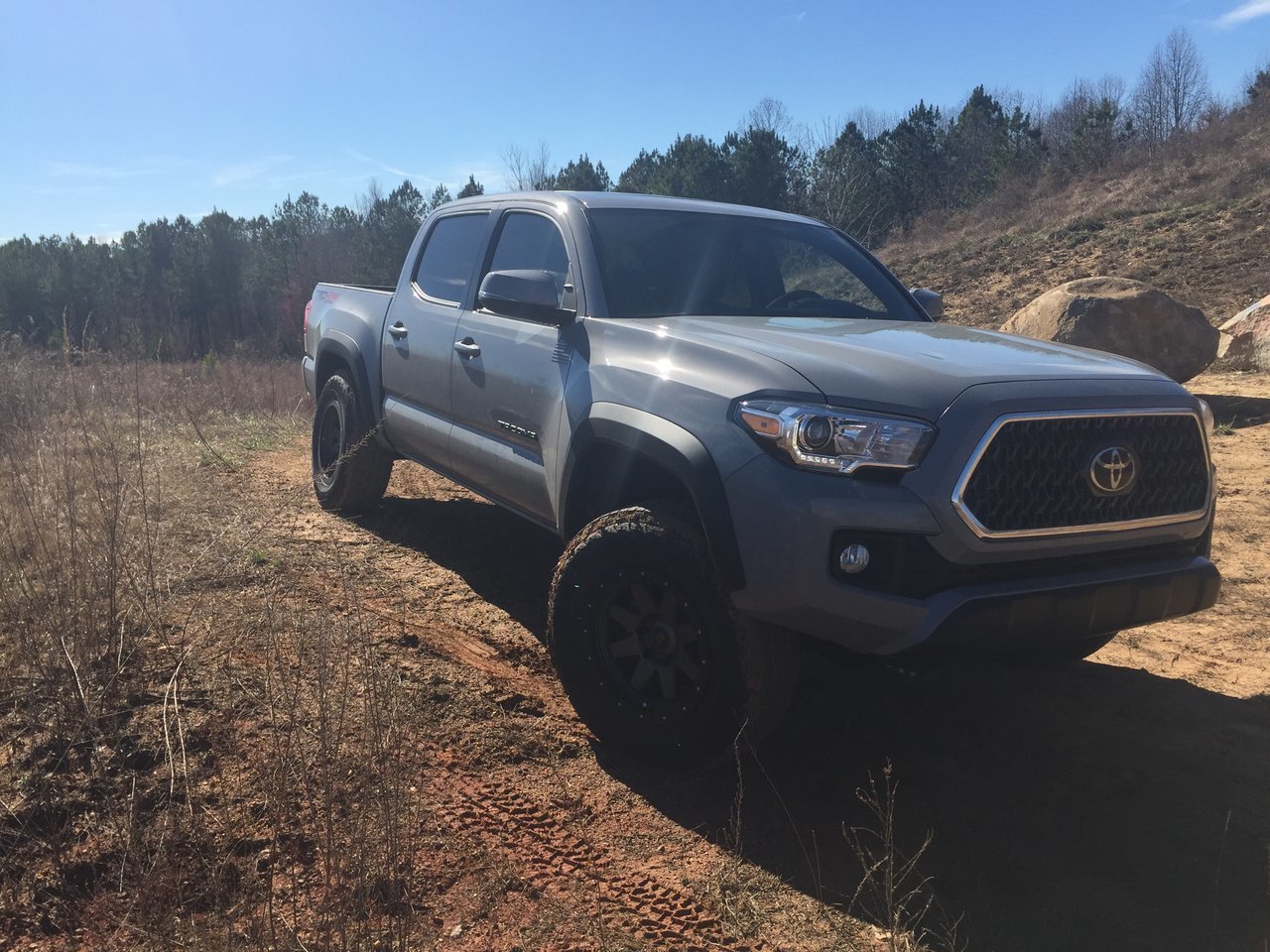

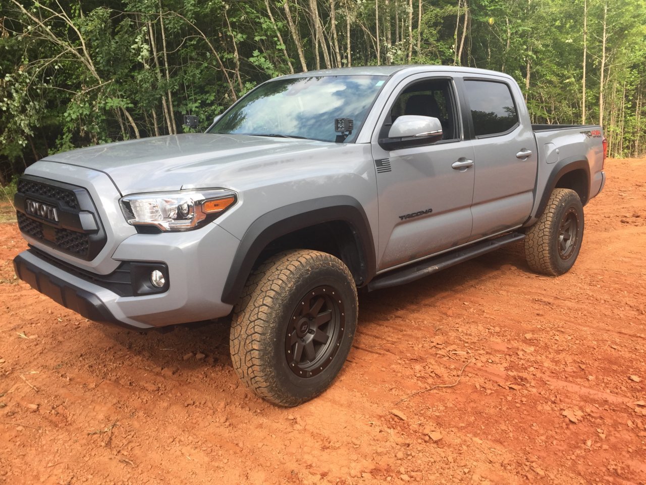

    Well I took car of the rubbing today. The areas outlined in white were where the tire was rubbing while pulling into my driveway. I'll have to do a little more trimming and heat gun work to prevent rubbing at full stuff but that'll be another weekend.
    Before
    After
    I took her off road for the first time to see how well the trimming worked. And it worked great.

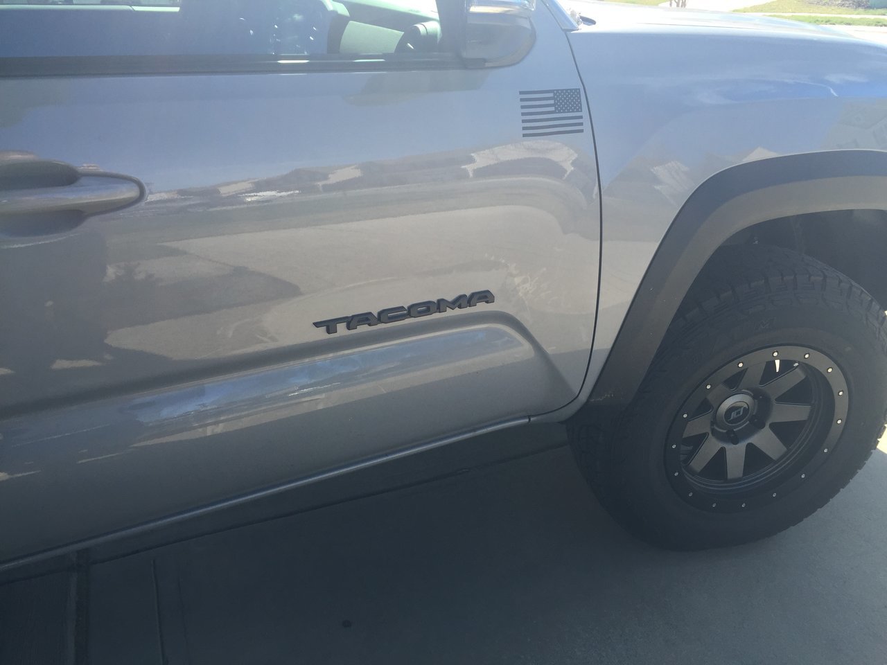

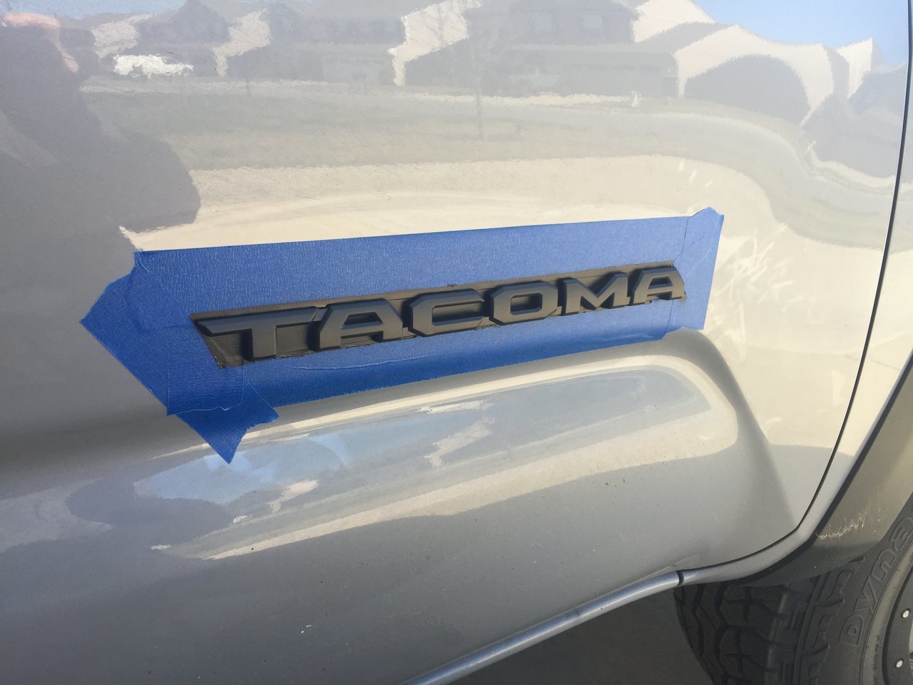

    I blacked out the Tacoma badges with plastidip, just as I did on my wife's 4Runner 2.5yr ago. Since her's is holding great I didn't see the value in getting the Nox Lux overlays for $100 when I only needed 2 pieces.

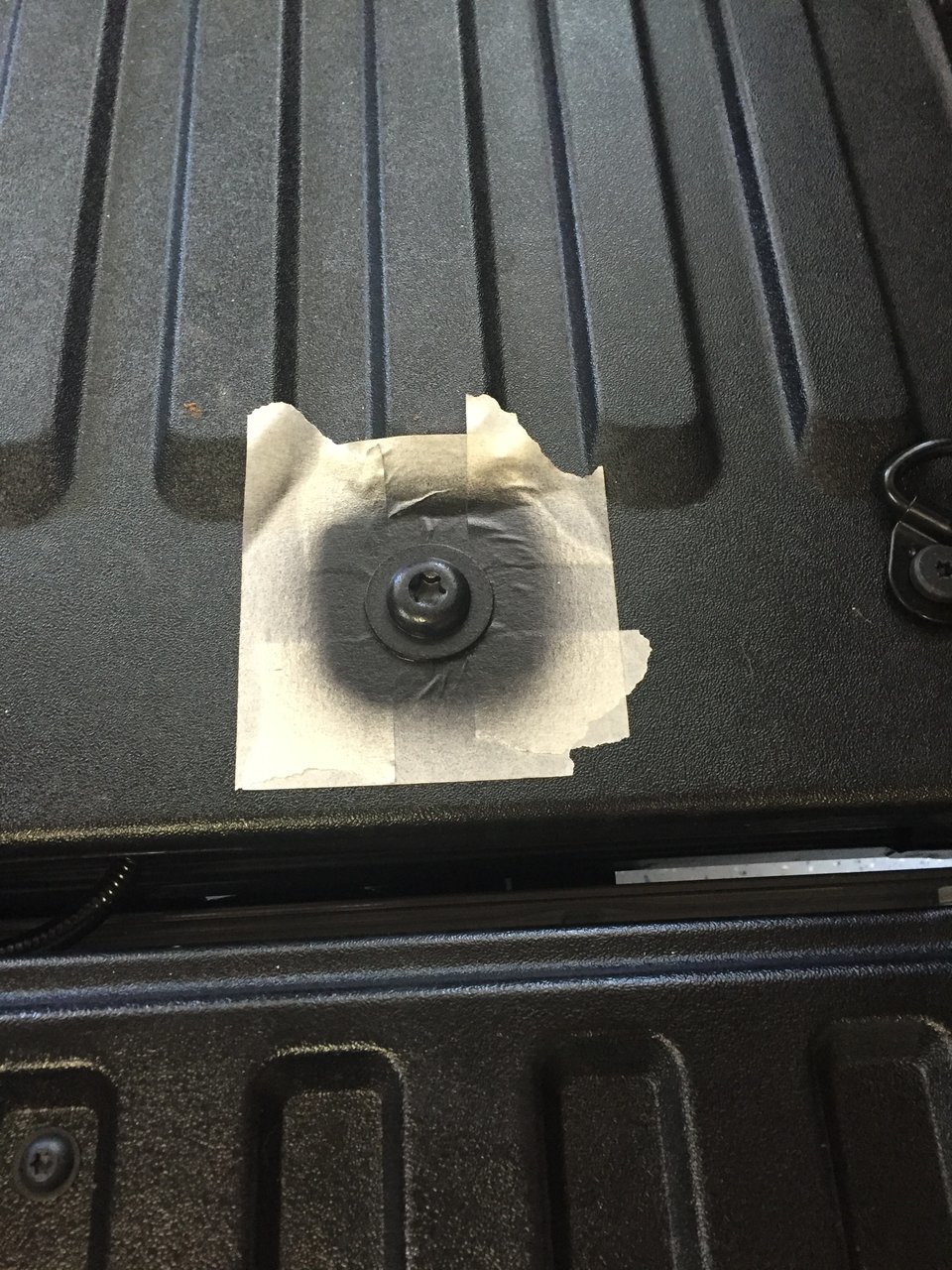

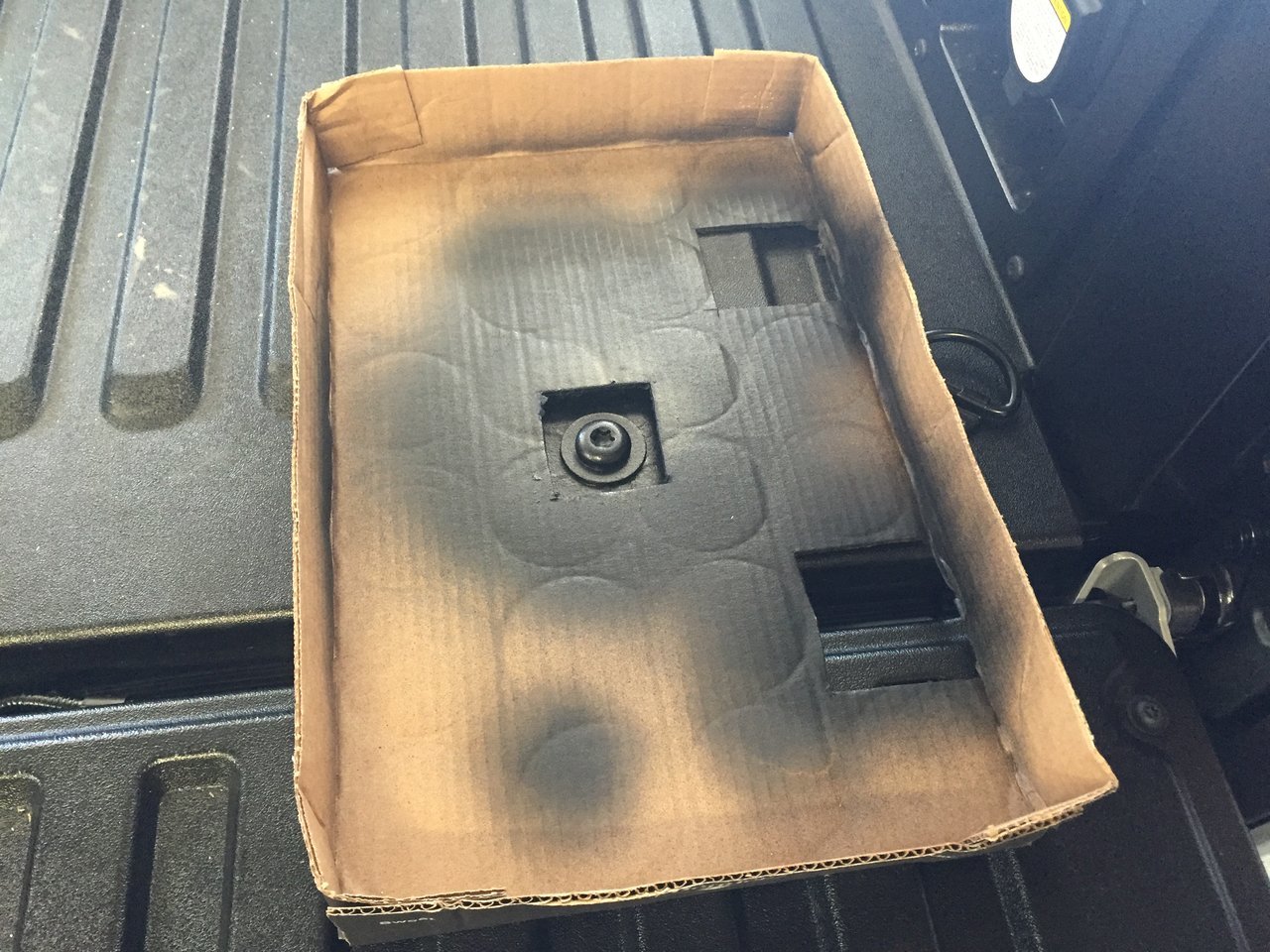

    A $7 can of spray bedliner made easy work of blacking out the silver bed bolts. I would highly recommend bedliner and NOT the rubberized underbody spray. I did the forward tie down hooks in underbody spray and they are not as nice.
