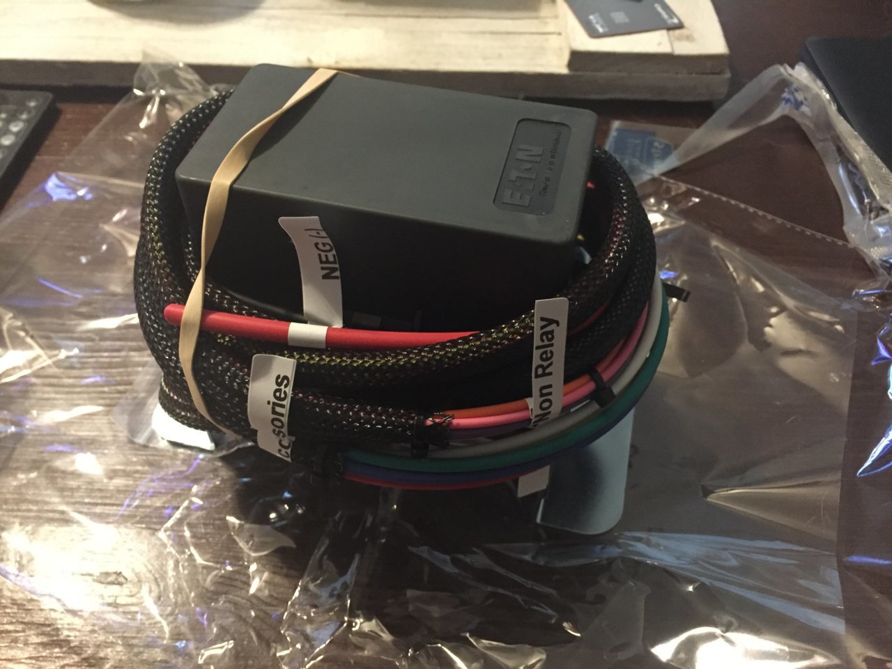

    Bussman RTMR Relay Box
    The following weekend I got a couple Bussman RTMR's off eBay during a 15% off sale. We hooked up my friend's, cleaning up his engine bay quite a bit.
    I don't want to install anything else electrical before installing my RTMR which I plan on doing in the next couple weeks.

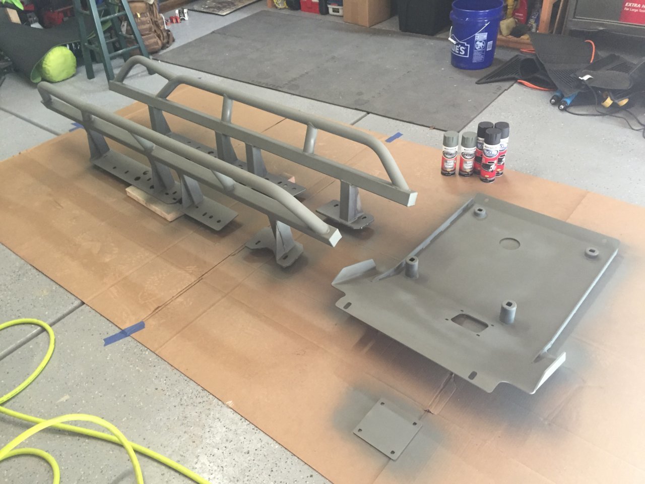

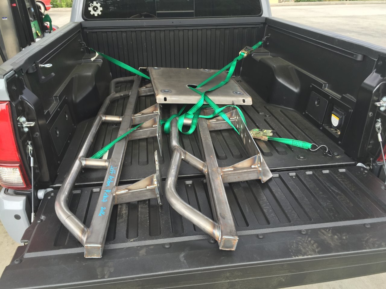

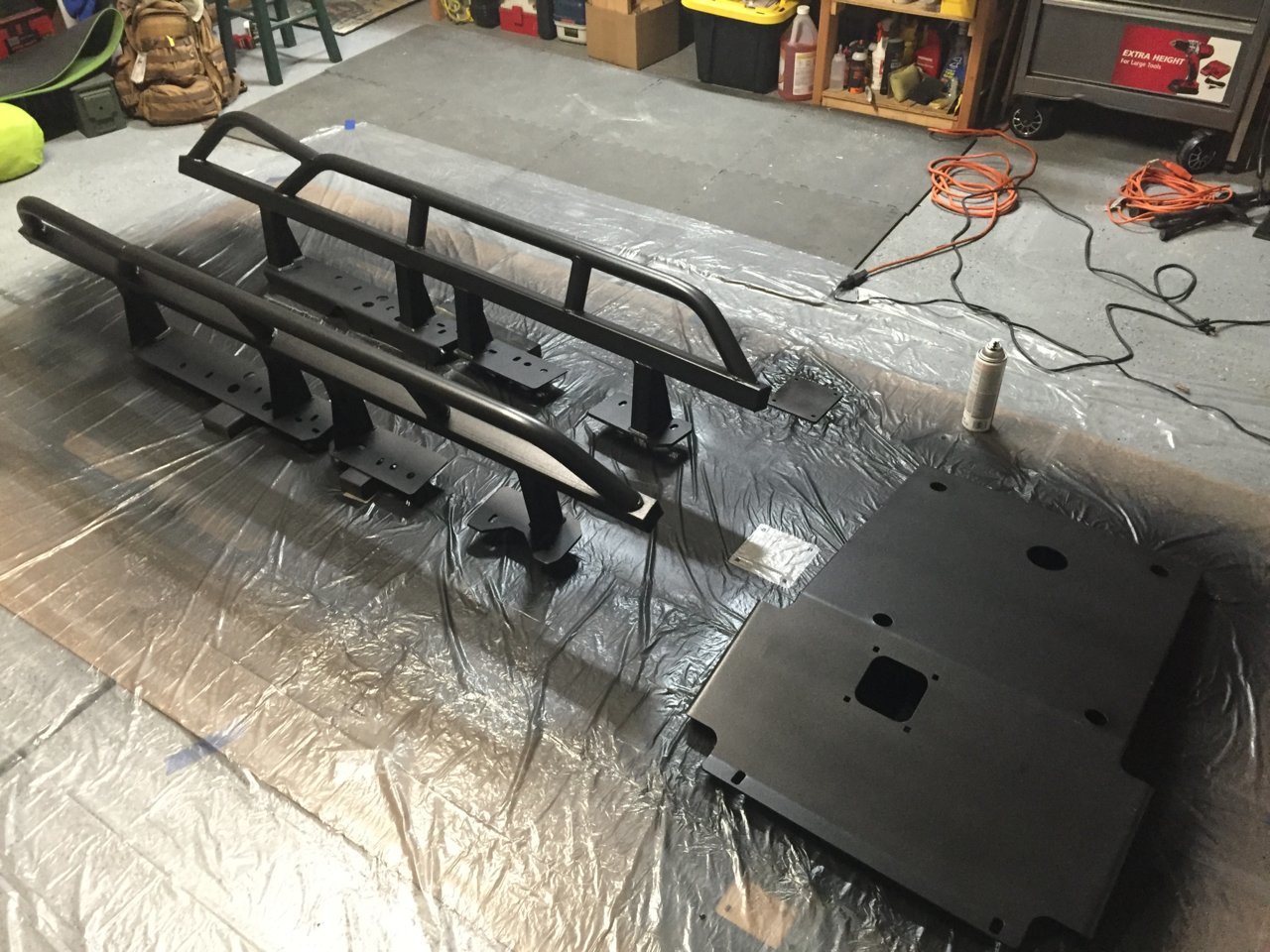

    SOS Sliders and IFS Skid
    I got in on the last SOS sale, everything was ready in 6 weeks as expected (quoted 6-8), and I picked them up since a tank of gas was cheaper than shipping. Eddy is a super nice guy and the workmanship is great!
    I hit everything with a scotchbrite pad then wiped it down with alcohol.
    I gave it 2 coats of Rustoleum self etching primer.
    Lastly I used a total of 5.5 cans of Rustoleum spray on bed liner giving everything about 4 coats. It came out awesome! I love the light texture and satin finish, not too rough and definitely not slick.
    It took a little work to get them mounted up, definitely have a friend help. I head to drill out 2 holes in the frame on each side and a HF step bit made super quick work of it. I first tried normal drill bits, took forever.
    Even the wife likes them, mostly because she has something to step on now haha.

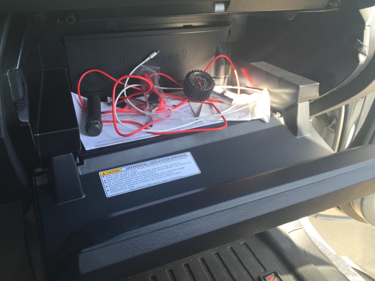

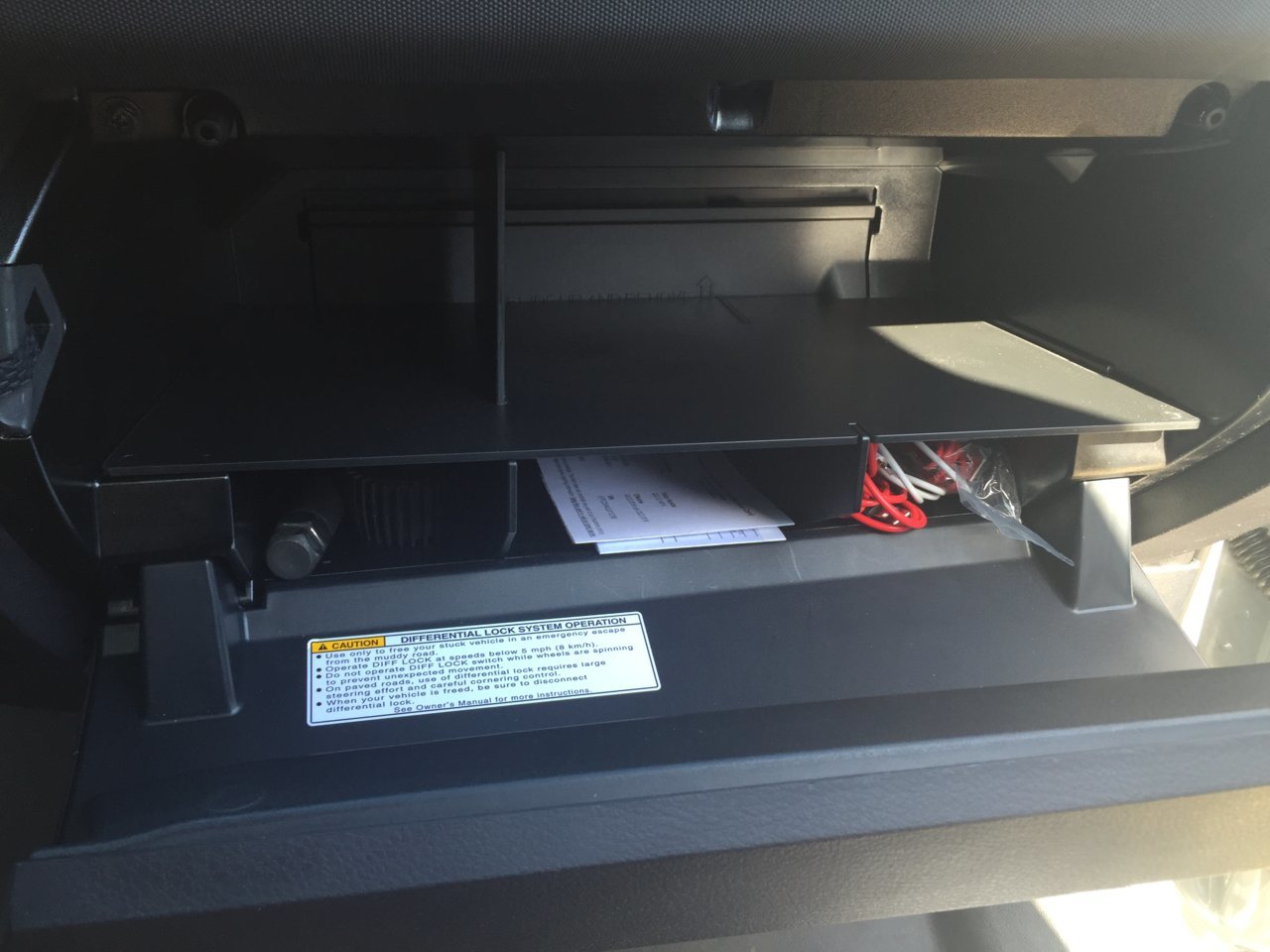

    OCD Glove Box Organizer
    After getting the OCD console organizer, I was contemplating 3D printing a glove box version. Thankfully they released one for the 3rd gen finally because $17 is a lot cheaper than it would cost me to design and print one. Our trucks should come stock with this!!
    Before
    After

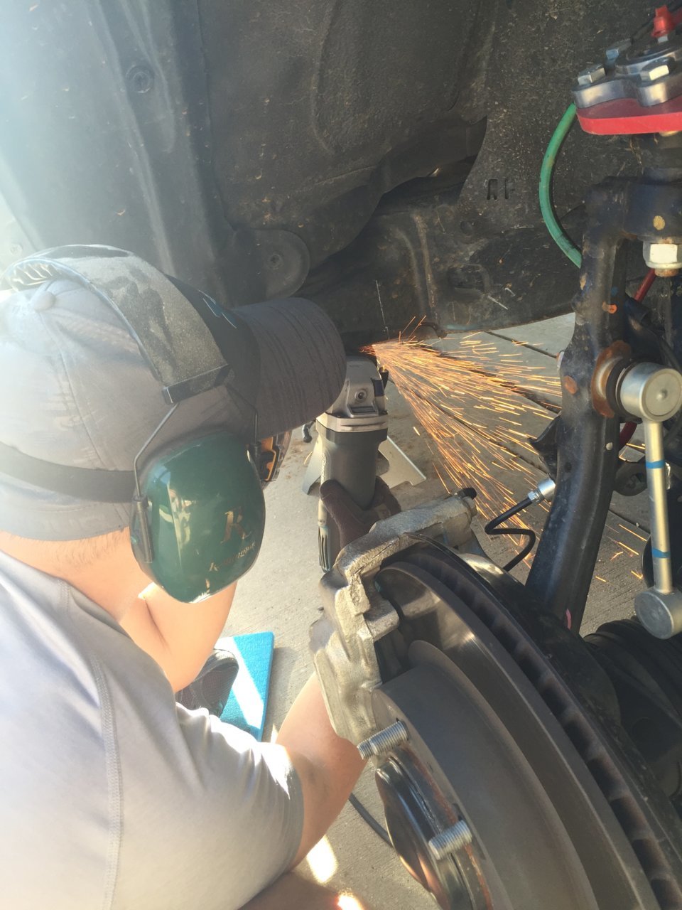

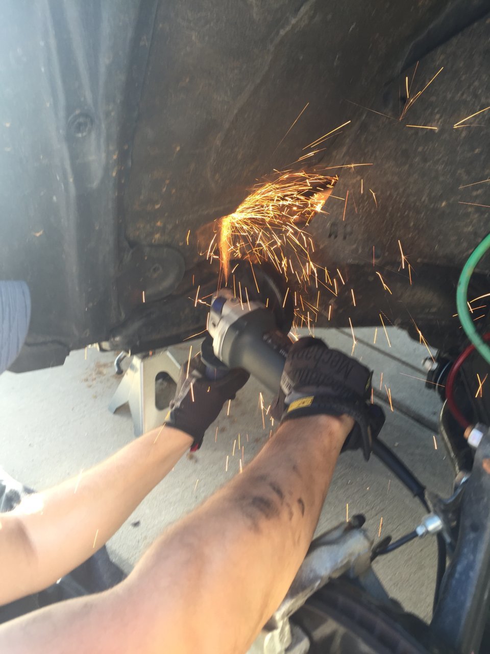

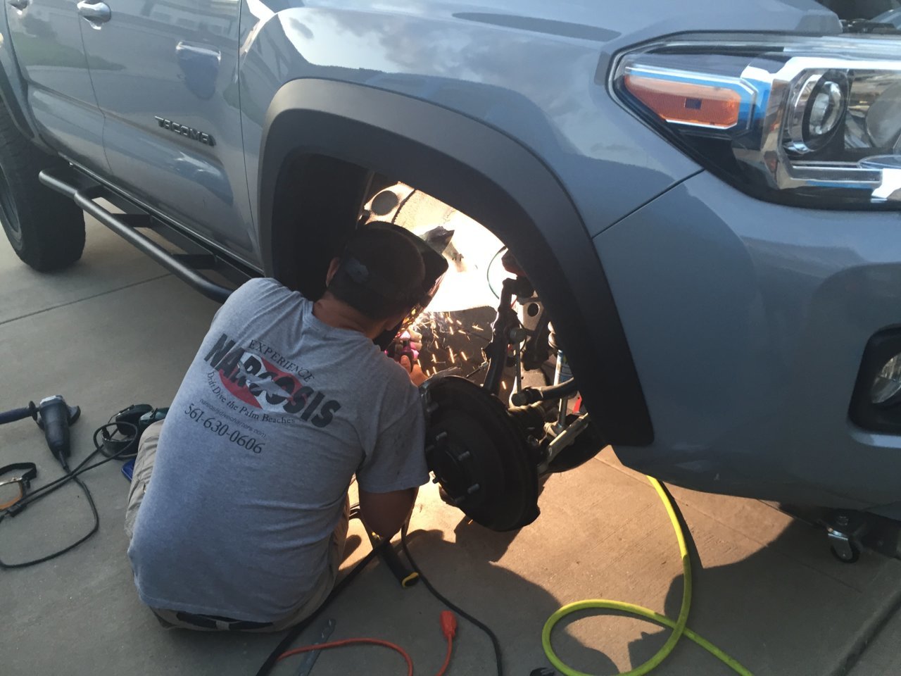

    Cab Mount Chop (CMC)
    I initially ranked "no need for a CMC" to be #1 in choosing my wheel/tire combo. Little did I know that the CMC is a bit of a misnomer IMO. All you're doing is shaving the rounded part of the mount that protrudes in front of the firewall and into the wheel well. Even before my lift, I was rubbing a little bit while turning into my driveway.
    When I installed the lift, I began flexing the suspension a little more and was still rubbing. Since my friend has a welder and did his CMC, I decided what the heck.
    I tried to take the chop back as far as I could so that I would only ever have to do this once. We found an angle grinder and cut off wheel worked best, but mainly because my 16gal dewalt compressor couldn't keep up with my cut off tool.
    Pro tip: don't wear a brand new shirt and be sure to wear ear pro, goggles, and a jacket or welding gloves!
    I did the majority of the cutting and let my friend do the welding. I bought SOS plates but we ended up just cutting our own from some extra plate I had so that we could get them to fit perfectly.
    It took us the better part of a day to complete it. I finished it off with rubberized under coating, 4-5 layers, including on the inside of the mount.

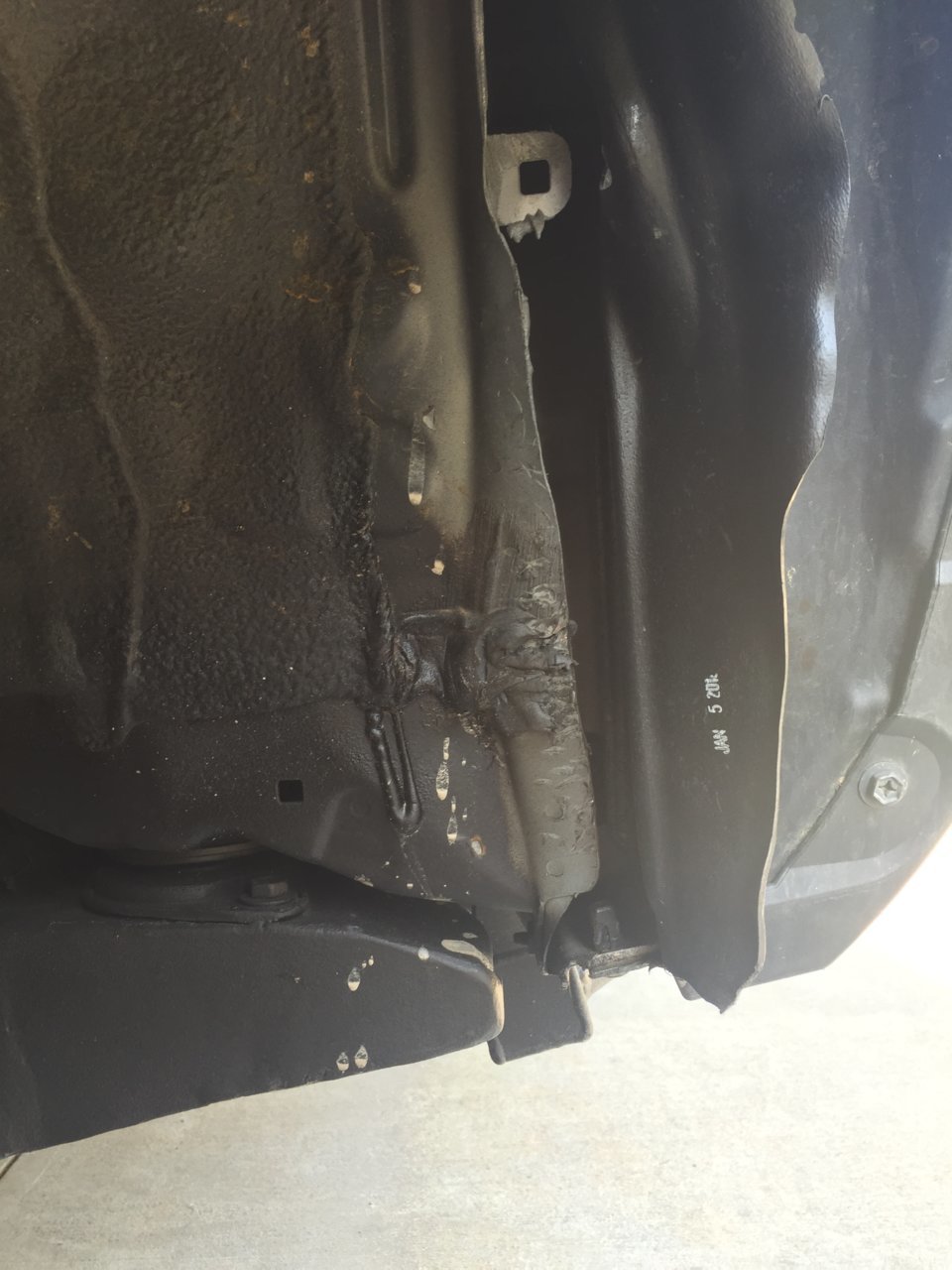

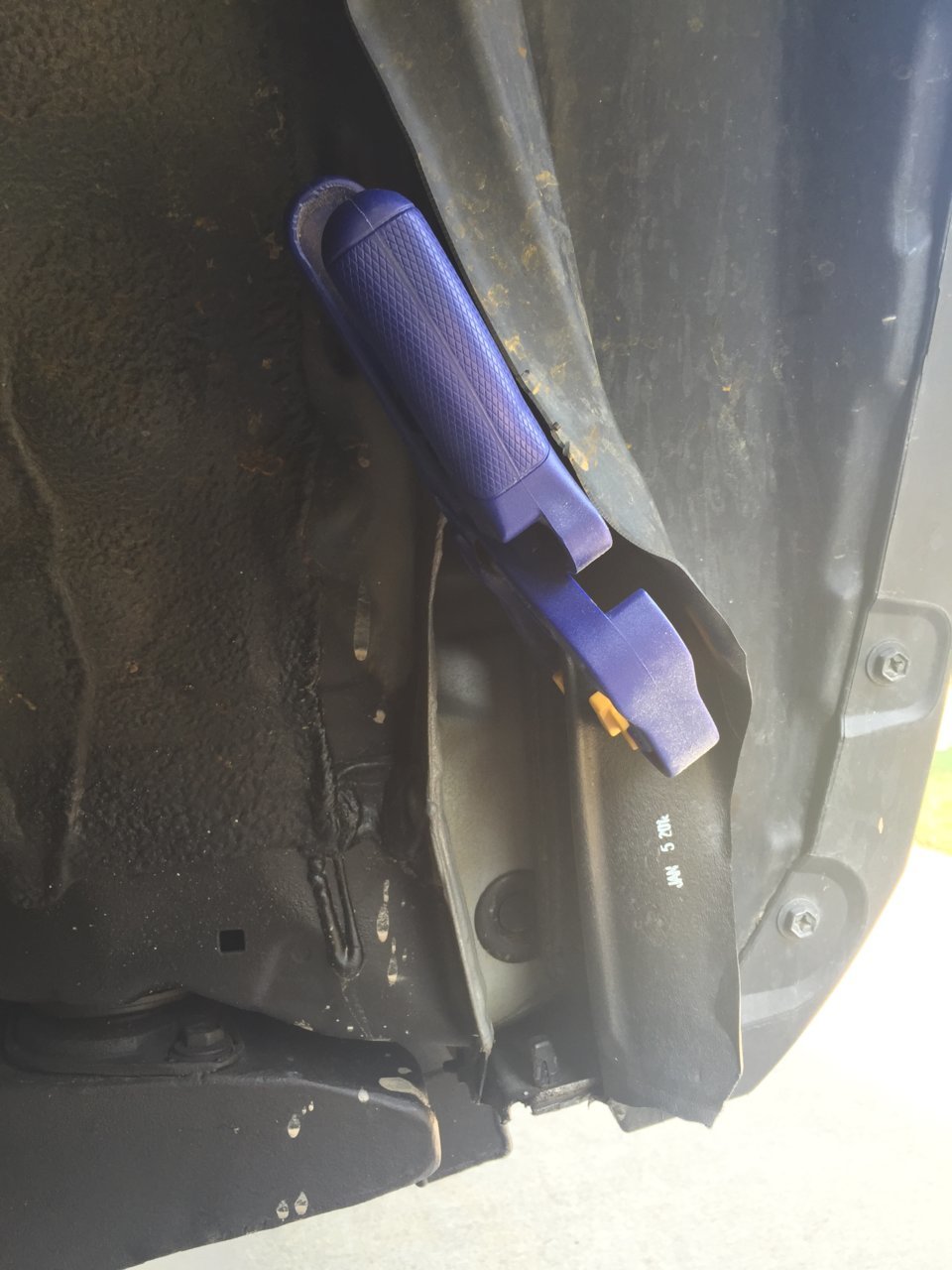

    Pinch Weld Folding
    I was still getting some rubbing but now it was the tire catching the wheel well liner. I trimmed a little bit of it off but I want to keep as much of the liner as possible. I realized the pinch weld was pushing the liner into the tire.
    This was super easy. I removed the front wheels, folded the wheel liner back and took a 2lb sledge to the verticle pinch weld. I decided to fold the weld outward and only did about 8" from the bottom. I wasn't concerned with making it super flat since my rubbing was very minor. You can also see my CMC in these pics.
    Before:
    After:
    I gave it a verrry liberal coating of rubberized undercoating spray and let it set up for 24hr. I just put a 1" washer and self tapper in the bottom inside corner of each wheel liner, into the folded part of the pinch weld. I now have tons of clearance and plan on wheeling in the next few weeks.

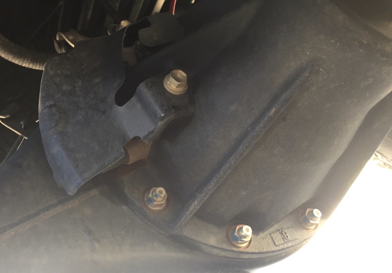

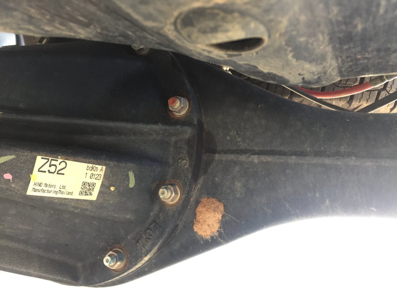

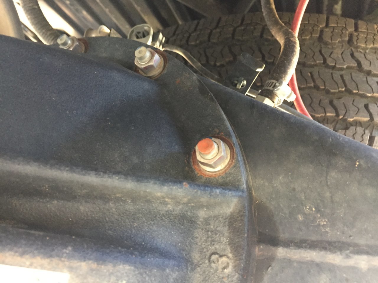

    5K Service
    Had my 5k service Friday and to no surprise for a clean bill of health.
    Unfortunately, while under my truck yesterday, I noticed that my rear doff is weeping at 3 different spots. I checked the gear oil and found its about 1/2” low. At only 5k, this is a little concerning.
    D42A593B-D05E-449B-9736-8354EC0E7244.jpg CE0FD104-449A-4D48-A3AC-FFBC87BF8F3F.jpg 2B06F6E7-60A2-432A-AA9E-CBDFC1991F1E.jpg 1E9B5FBB-25C5-476E-ABCF-7B6274E1BD5E.jpg
    I took it back to the dealer this morning to ask them why they didn’t catch this when their checklist says they checked all fluids and topped them off, among other things. The service writer had no explanation, agreed with me, and scheduled a Tuesday appointment to get it fixed under warranty.

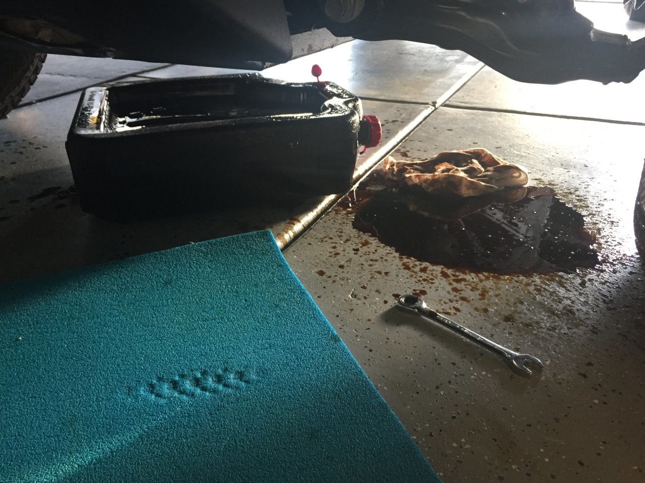

    First Oil Change
    I don’t really like the idea of waiting 10k on the first oil change. I did mine at 5457 and since it’s only $30 for Castrol Full Syn & OEM filter I plan on doing my own oil every 5k and let Toyota Care do them on the 10’s.
    Unfortunately my oil catch tray isn’t made for Tacomas. The pan drained with so much force that it splashed all over the place. Thankfully I keep some kitty litter on hand.
    Follow up on Rear Diff Weeping:
    So the dealer claims that the weeping was so minor that there is no measurable loss of oil. They say the factory puts in the exact amount of gear oil vs filling to the bottom of the fill hole like we usually do. Because of that, that’s why it seems like it’s 1/2” low.
    They wouldn’t add any oil and claimed because the oil level was in spec Toyota wouldn’t cover replacing the seal. I didn’t push the issue of adding oil because I’ll do that myself. If it leaked, there is obviously less oil.
    They did retorque the diff cover bolts and noted the issue in my file.
