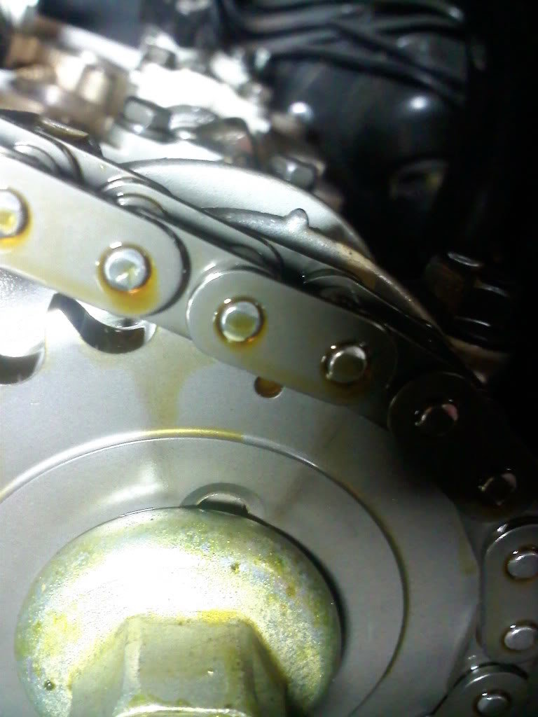

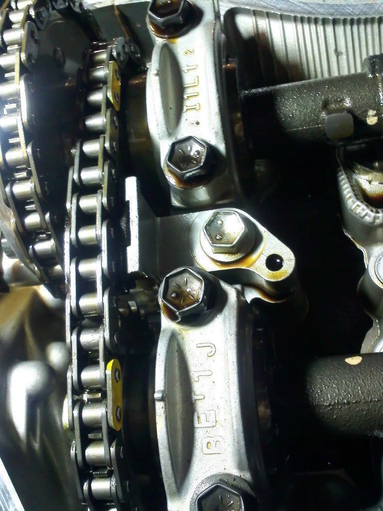

    the thing is the timing is already set on the truck...in the instructions it tells you to rotate the crankshaft till the yellow indicators on the back of the timing chain line up to the middle marks on the VVTI indicators...once that's done you just have to make sure that the timing mark on the crank pulley is at zero...after all is said and done its really easy to do...just takes time and patients as you sit there rotating the crankshaft until everything lines up...
    if you look at this picture below you can see that I have all the timing marks and VVTI marks lined up correctly...that should ease your mind on this installation process...:D
