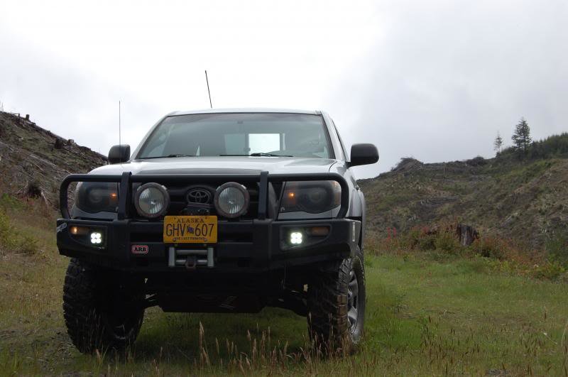

    Went with the 3LRs from BlitzPro. Pretty awesome for $30/each!!

    Ehh.. they don't quite fit just right, there is some space around them in the inserts. But, the output is awesome.

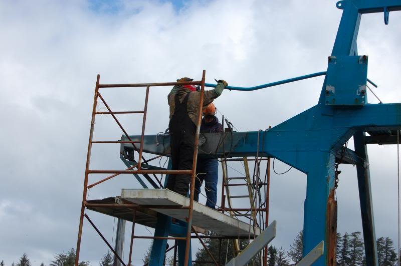

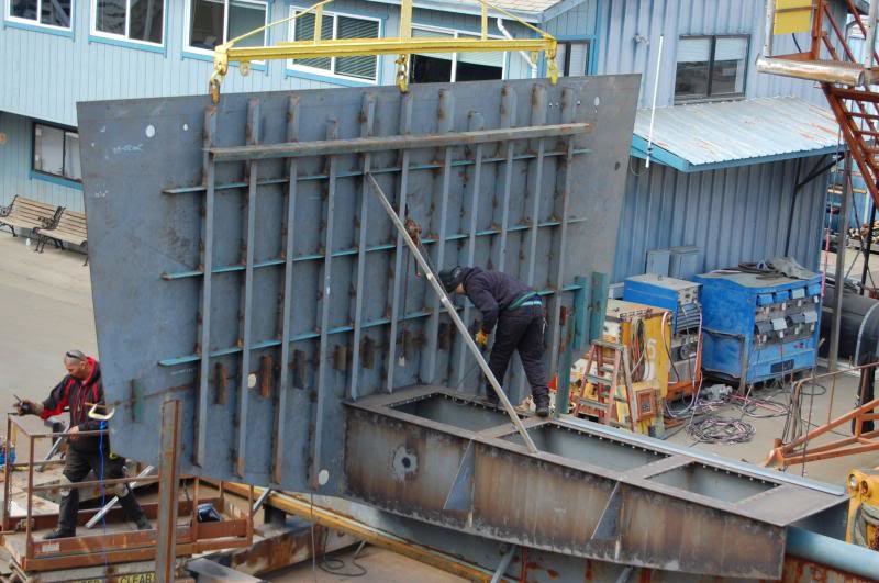

    Here are a few pictures from the area that I'll be in for the next month - Reedsport, Oregon. Beautiful place, just not too much going on.

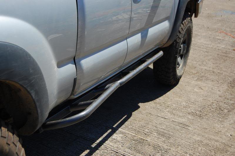

    Welding on my sliders in a couple of hours with one of the welders from the shipyard; he's got a built FJ40. I'm embarrassed to park my Taco anywhere near it..

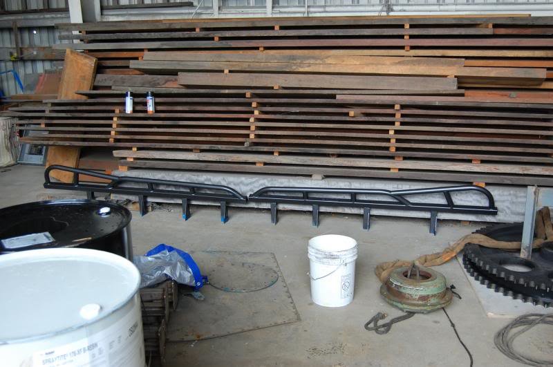

    Finally got my sliders sand blasted, painted with a zinc based marine primer, and finished with Hammerite.

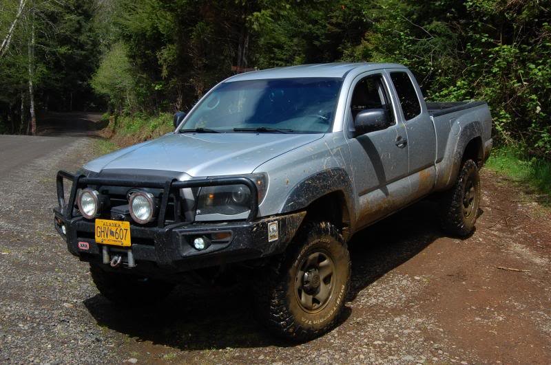

    Managed to find a few logging roads to explore, last one was a little bit of a challenge - yet another reason why I should upgrade to 36s..
    Holy chit, that Oregon red clay is slippery stuff. Of course, I didn't bother to air down either - and was running at 45 PSI.

    looks good jake, you going to be back up here the first couple weeks of aug?

    Finally got my sliders welded on, will put pictures up when I can. They look good - although, it's going to take a little bit of getting used to the kickout.

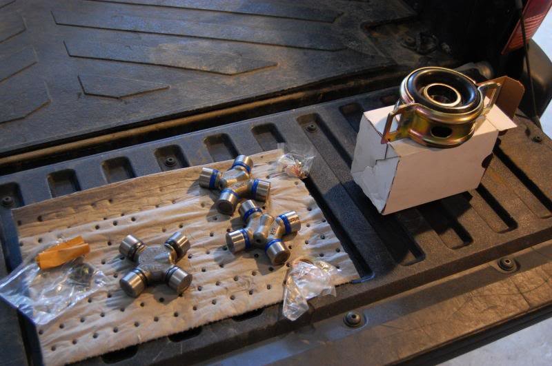

    Have new U-Joints, carrier bearing and a Yaesu FT-2900R 2 Meter all waiting to be installed. Have next week off - hoping to get everything taken car of.
    Carrier bearing has been squeaking like a 'sum bitch for the last few months now, although for whatever reason it has stopped ever since a few water crossings I made last weekend. Odd. Since I'll be in that portion of the driveline, figured it'd be a good time to change out u-joints as well. I'll retain the take outs as trail spares.

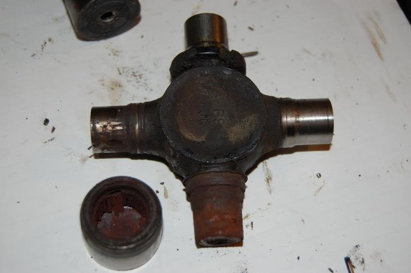

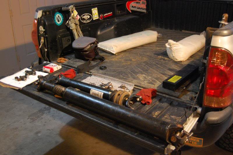

    Started in on my driveshaft project this afternoon, totally spaced that I'm going to need a gear puller to separate the front driveshaft yoke in order to replace the carrier bearing. Hopefully, the auto shop next door has one - will check tomorrow.
    Everything went pretty much as planned - although using the BFH/C-Clamp method is kind of a bear. Yes, it works - but a bearing press makes the job much, much faster and easier. Although, flip side it's good experience if I ever need to swap one out in the field. Most of them looked pretty good, probably could have skipped replacement. Since I was going to be in that region already, why not refresh everything?
    Kept the best looking one as a spare, cleaned it out and greased it up... it'll go behind the passenger seat.

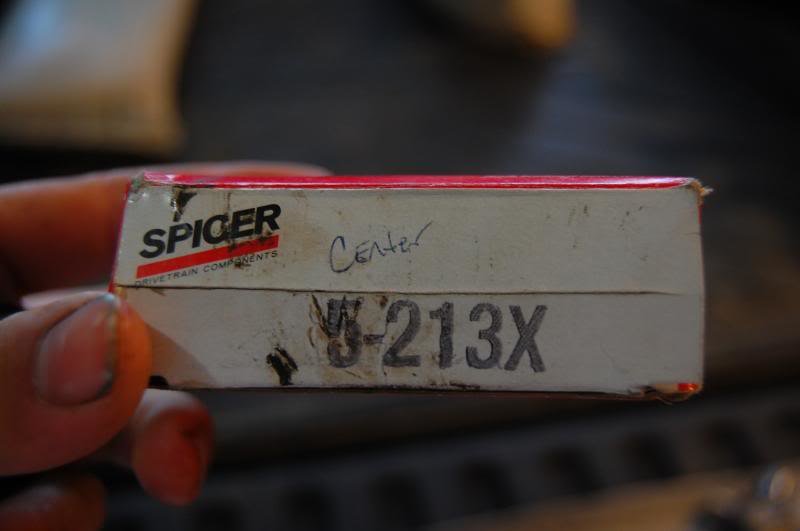

    Pretty certain that I found the source of a few driveline vibes and squeaks... One of the sides of the rear U-Joint looks as though it never received any lubrication. Kind of odd, actually. Seems as though the grease passage way was never thru-drilled direct from the factory.
    Used Dana Spicer Part# 5 - 213X

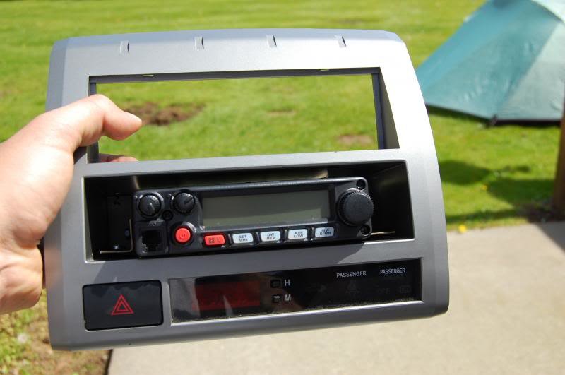

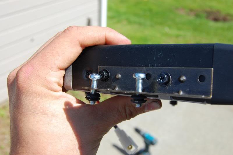

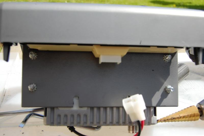

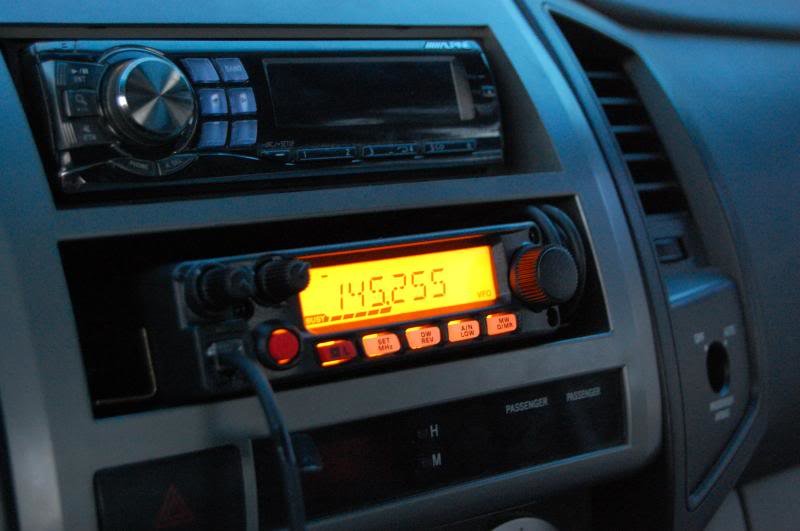

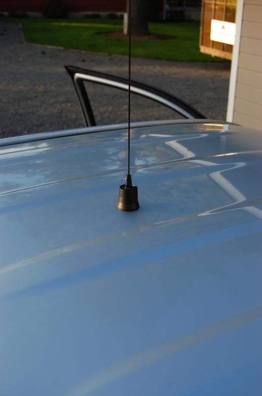

    Added this little dandy today..
    Wow! Lot's of trimming, fitting and running cabling.. Had to have my Dad drill the hole in the roof, didn't quite have the sack to do it. All I can say is measure four times and cut once. You've only got one shot to make it dead nuts on..
    Yeasu FT-1900R, with a Larson 150B 5/8 Wave NMO Mount.
    Truly makes CB look like a redheaded stepchild now! Sitting for my ticket on Tuesday in Eugene, OR.

    AMAZING the difference in ride quality and elimination of driveline vibes with the new U-Joints and Carrier Bearing. Wow!!
