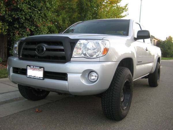

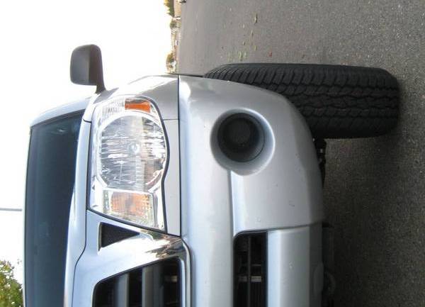

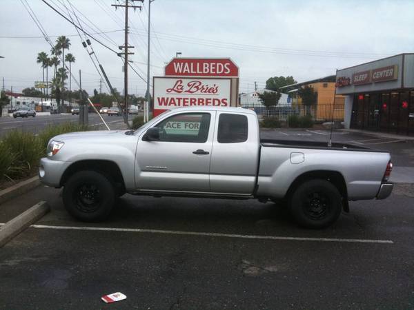

    Picture of stock truck soon after bringing it home:
    Picture of truck as of 10/22/2010:
    Edit 10/25/2010 - Better pics posted!
    Edit 11/13/2010 - Additional pics and details!
    Blacked out all badges, front grille, and rear bumper since last pics. eBay fog light kit also installed since last update.

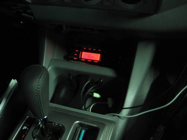

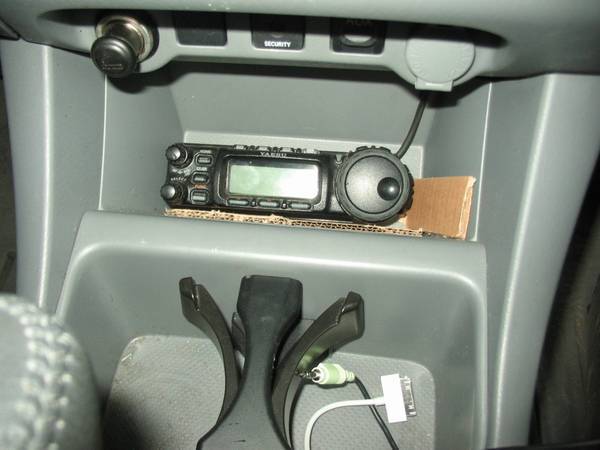

    Yaesu FT-857 All-Mode All-Band Amatuer Radio Transceiver - Radio has been "SoftModded" to expand TX capability. Can output 50 watts on 2m and 70cm bands, and can operate on CB, FRS, and other bands in emergency situations only.
    The FT-857 display even matches the "Tacoma Orange":

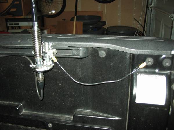

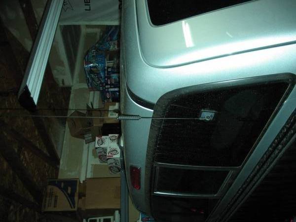

    CB Radio Antenna - Used when going camping with friends.
    I originally attemped to mount the antenna at the front of the bed next to the cab, but I couldn't get it tuned properly at that location. It was MUCH easier to tune when moved to the back of the bed. It also provided a very short grounding location, which is why you see the wire going from the antenna mount to the bed side bolt.

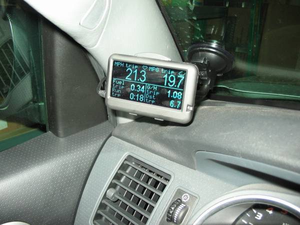

    UltraGauge - mounted using supplied suction mount. Cabling ran to OBD2 port and hidden under rubber seal at the front of the door.

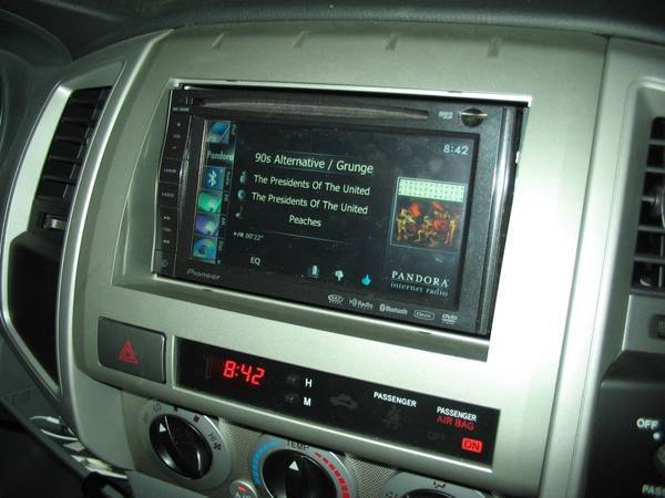

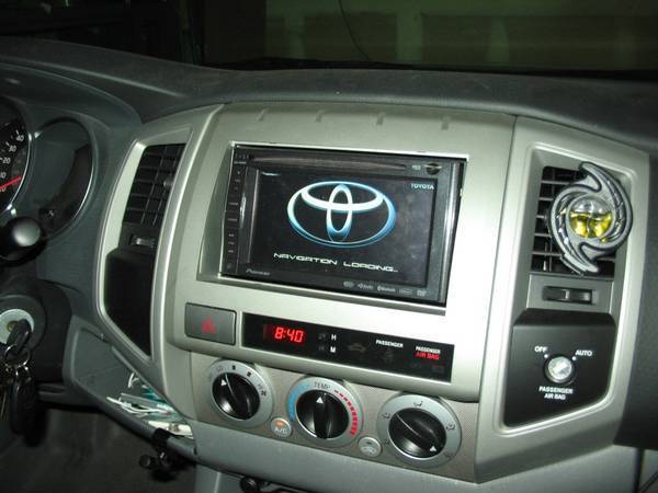

    Pioneer Avic X920BT Receiver - Provides In-Dash Navigation, AV Receiver, DVD Playback, and BlueTooth Hands-Free capabilities. Has had "bypass mod" performed.
    (And yes, I know the Scosche kit's trim ring isn't installed... it was missing from the kit so I had to call to have one sent. I just haven't pulled the dash back apart to install it.)
    Showing "Toyota" startup splash screen:
    Streaming music from my iPhone using the "PandoraLink" feature:

    your truck is lookin good. whats the backspace on your wheels?

    The wheels are Pro Comp 7089's with 4.5" backspacing. This does cause the tires to stick outside the fender a little; nothing bad and in fact I think it gives it a more aggressive stance.

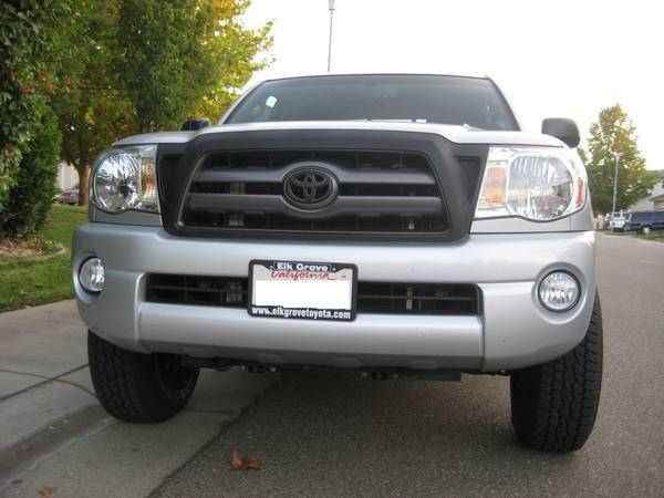

    Blacked-out Badges -
    After reading this thread, I decided that Plasti-Dip would be the easiest way to black out my badges. I wasn't looking forward to the idea of removing them, painting them, and re-applying.
    It came out quite well. I was pretty nervous about taking a rattle can to the paint, but it worked exactly as described. I wouldn't do this mod any other way after seeing the results.
    After the success of using Plasti-Dip to black out my badges, I decided to try it on the bumper and grille. If it doesnt hold up, it's easy to "repair", and will let me see the look before doing anything permanent.
    Front Grille -
    It's either staying black or I'm buying a color-matched grille. Unsure if I'm satisfied with this look, and considering coating the center of the grille to match.

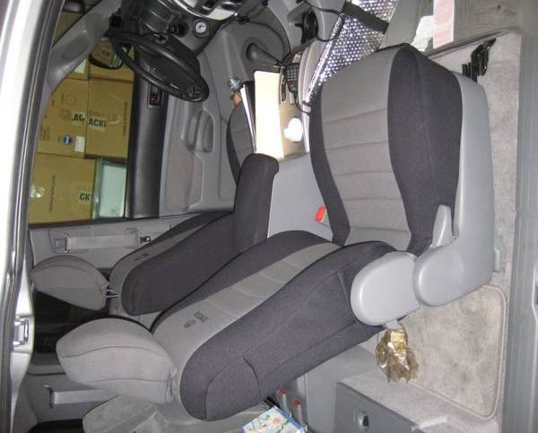

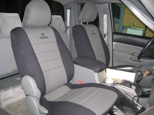

    Wet Okole front seat covers installed.
    They are charcoal and black, have "map pockets" on the backs of each, and the Toyota logo on the front.
