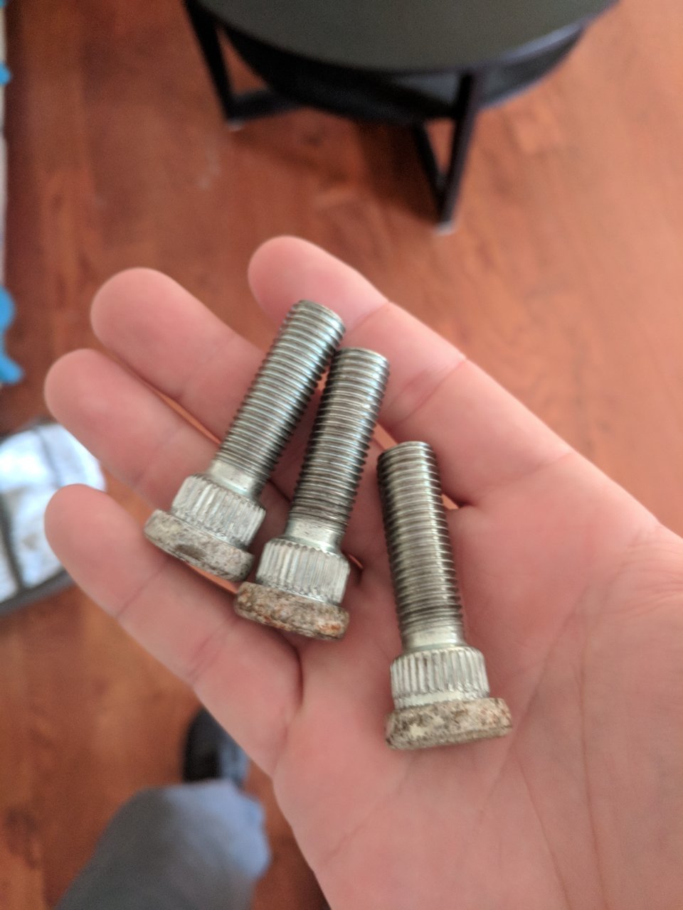

    Whoooooooshchchch

    Hammer those in far as you can using one of the broken ones. Then draw it in the rest of the way with your impact

    I press em in with a vice using a bolt to press and a deep well socket around the stud....works well if you have a big enough vice.
    All the spacer manufacturers cringe when you mention impacts....

    I don't have a vice

    Was about to say, I know he doesn't have a vice. Been in his garage lol
    So...use the new studs or something small and strong enough to beat out the broken ones. Then do what I said above.
    It's how I got mine in on the hubs AND my spacers.
    I pressed them out at work though because convenient. But my method should work. They also didn't look like the broke flush with the spacer face, which is good too. They also recess into the back of it, so it really doesn't need to travel that far before they're loose/tight

    Also....hydraulic jack can be rigged as a press between 2 solid points.
