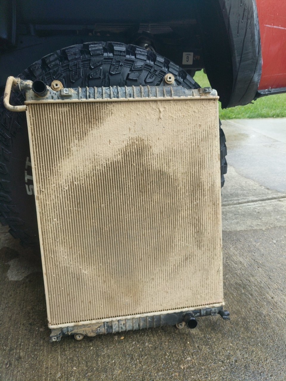

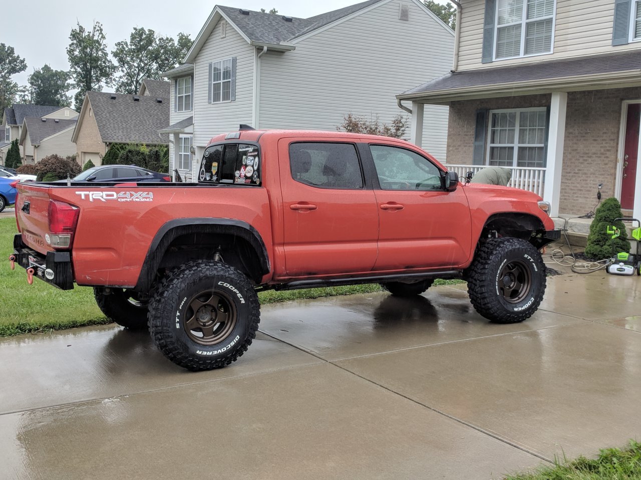

    Love the new look! Got the radiator pulled and hosed out today too. Seems to be helping! Thanks @presta24 for the hand

    Thanks for your handy. 2 rads pulled and cleaned in like 3.5 hrs. Not bad

    much easier than I thought. The hardest part is getting the nuts off the fan. I let josh do that because of his lil bird arms.
    2 bolts hold the shroud on, 4 bolts for the rad, disconnect the 2 hoses, drain, rinse and repeat.
    Seriously we were in no rush, I got to his house about 2p. We were done with both trucks at 530

    post up that pic of your rad bro lol

    It's easier to take the fan off the 3rd gen cause there's a little more room. Besides that yeah it wasn't very bad at all. Just have a bucket on hand when you pull the radiator because it turns out draining it only gets about half the coolant out and all the rest will come pouring out when you take it out.
    Also:

    gross. how are you liking the stt pros? They look pretty sweet, I am considering them this size change.

    They're quieter than KM2s and Extreme Countries and they actually balanced. So far I'm really happy with them. Excited to get them on a trail. They're a little stiffer than the Dicks but that's expected with E rated 3 ply sidewalls. I haven't tinkered with pressures to find a good one because my spindle is still jacked up. Fixing those Tuesday hopefully. Lot of driving to do this week.
