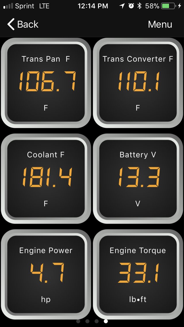

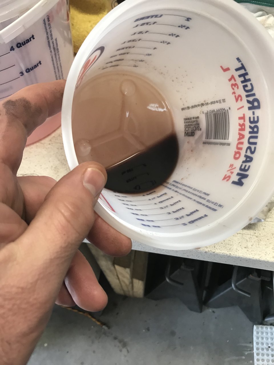

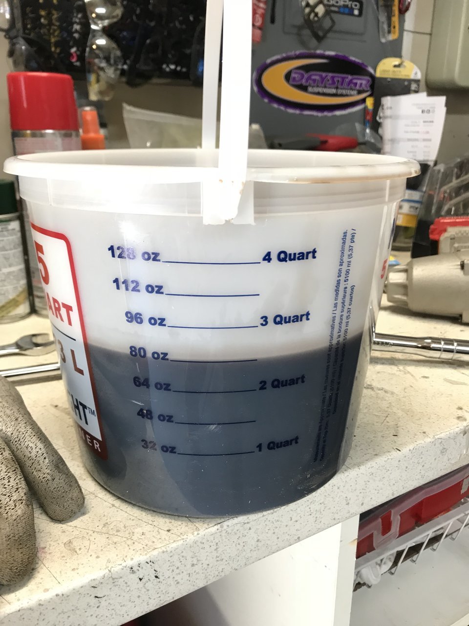

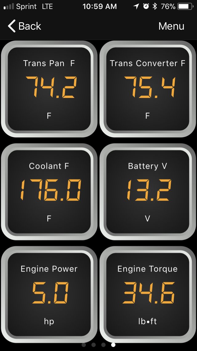

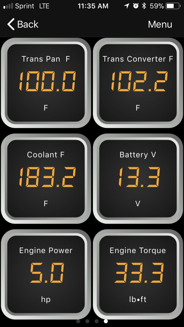

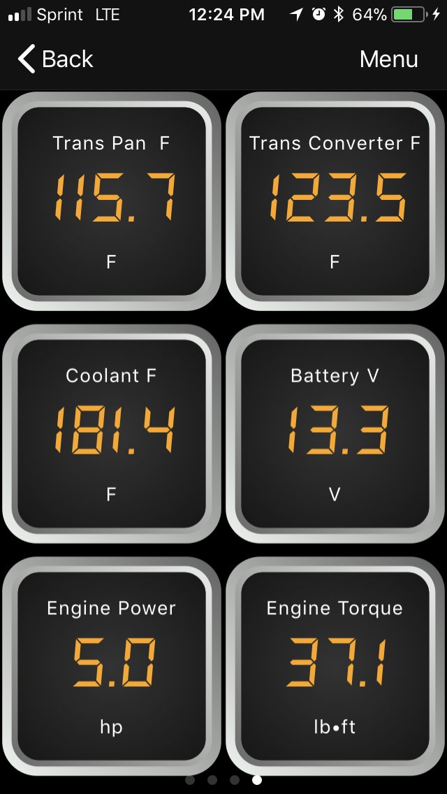

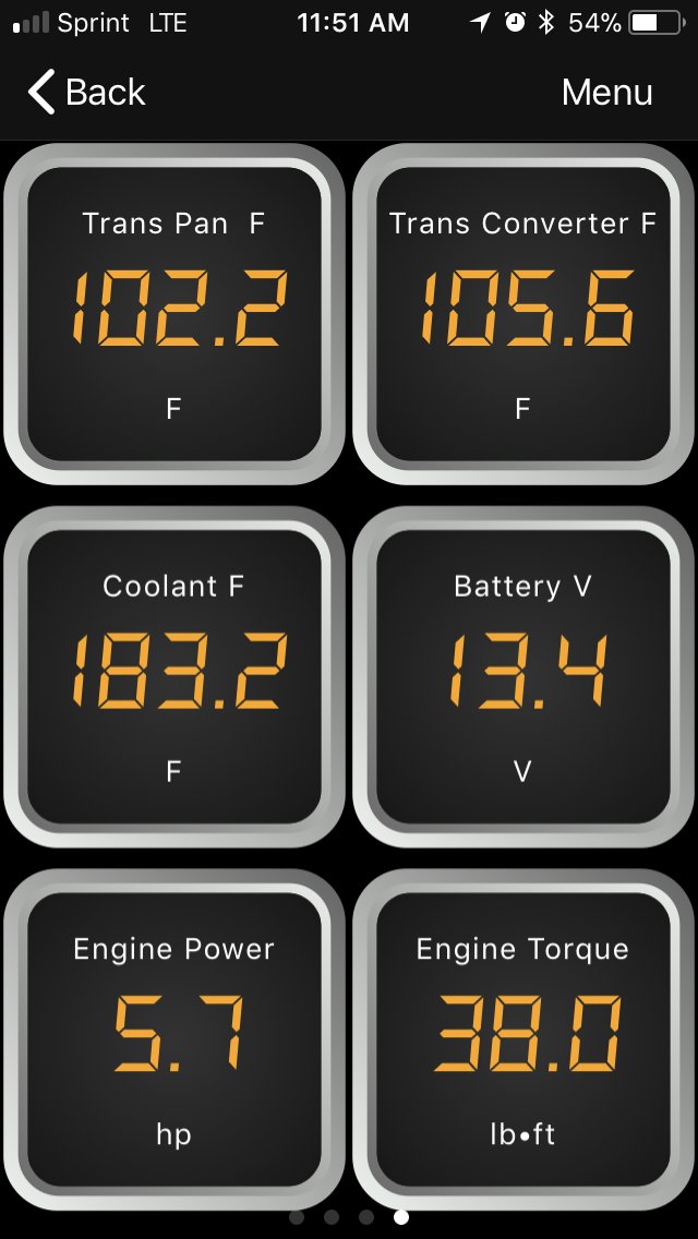

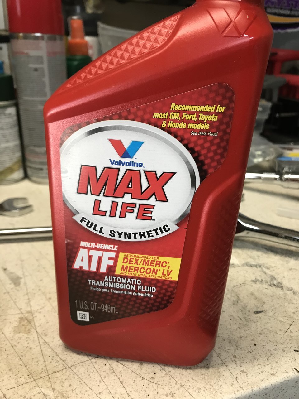

    Drain / fill tranny fluid for first time. 101,000 miles. I beleive I was 1/2 qt low. Drained 2.5 qts, put in 3, and got a very little to come out hot. Took a long time to get up to 115 degrees. Was 20 degrees this am so that did not help. I will likely swap out 3 more qts in a couple weeks before i put my skids back on.
    Also did coolant drain / fill....not as exciting ans tranny fluid
    This much came out, real black looking
    Filled with 3 qts of this
    Waited a long time to get up to temp
    This much came out hot
