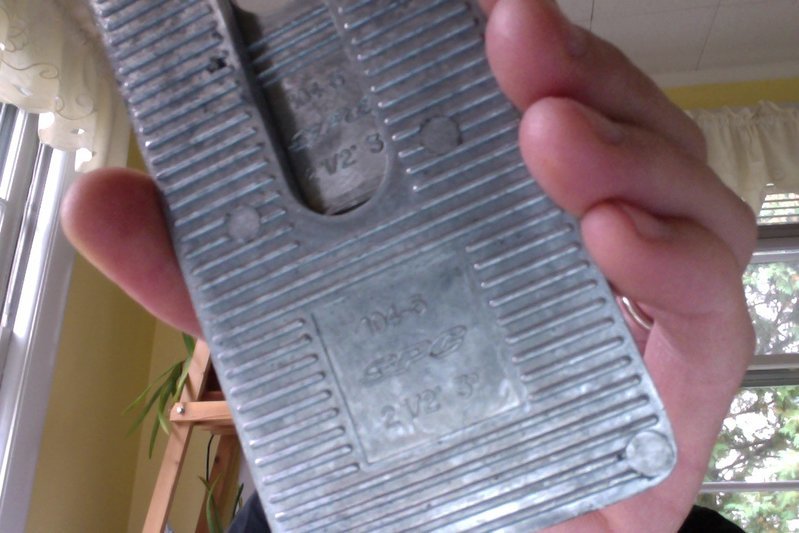

    OK you shim gurus.......do shims like this interfere with the bottom of the leaf centering bolt, fitting into the centering hole on the axle? I want to make sure I get good penetration of the little nub into the hole. :anonymous:

    In answer to the question....Maybe...Maybe not....Some of those centering pins have a longer head than others. Last one I did (for someone else) had plenty of pin....Then I helped someone on a trail (Badlands) a couple summers back that had the axle move on 'em because not enough pin made it into the spring perch.

    10-4, thats what I am thinking. might be close........I may snag some new centering pins with a longer nub on it. :thumbsup:

    I like to use a 3/8" socket cap screw

    Then use a lock washer (that has a diameter same as bolt head) to "grow" the length of the centering pin if you feel it needs to be a bit longer...

    cool. adding shims, want to make sure it has enough head height to clear the shim thickness, and go into the hole. will wait till i have shims in hand......and measure :anonymous:

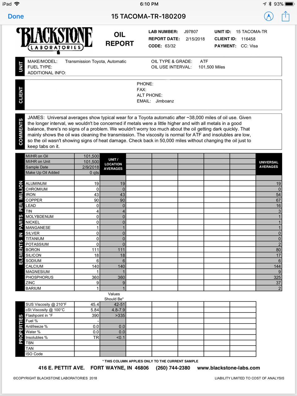

    Recently sent in a #transmission fluid sample to blackstone. This was original fluid. I was concerned becase it was dark, and i determined i was about 1/2 qt low. I am happy with this report, no issues at this time
