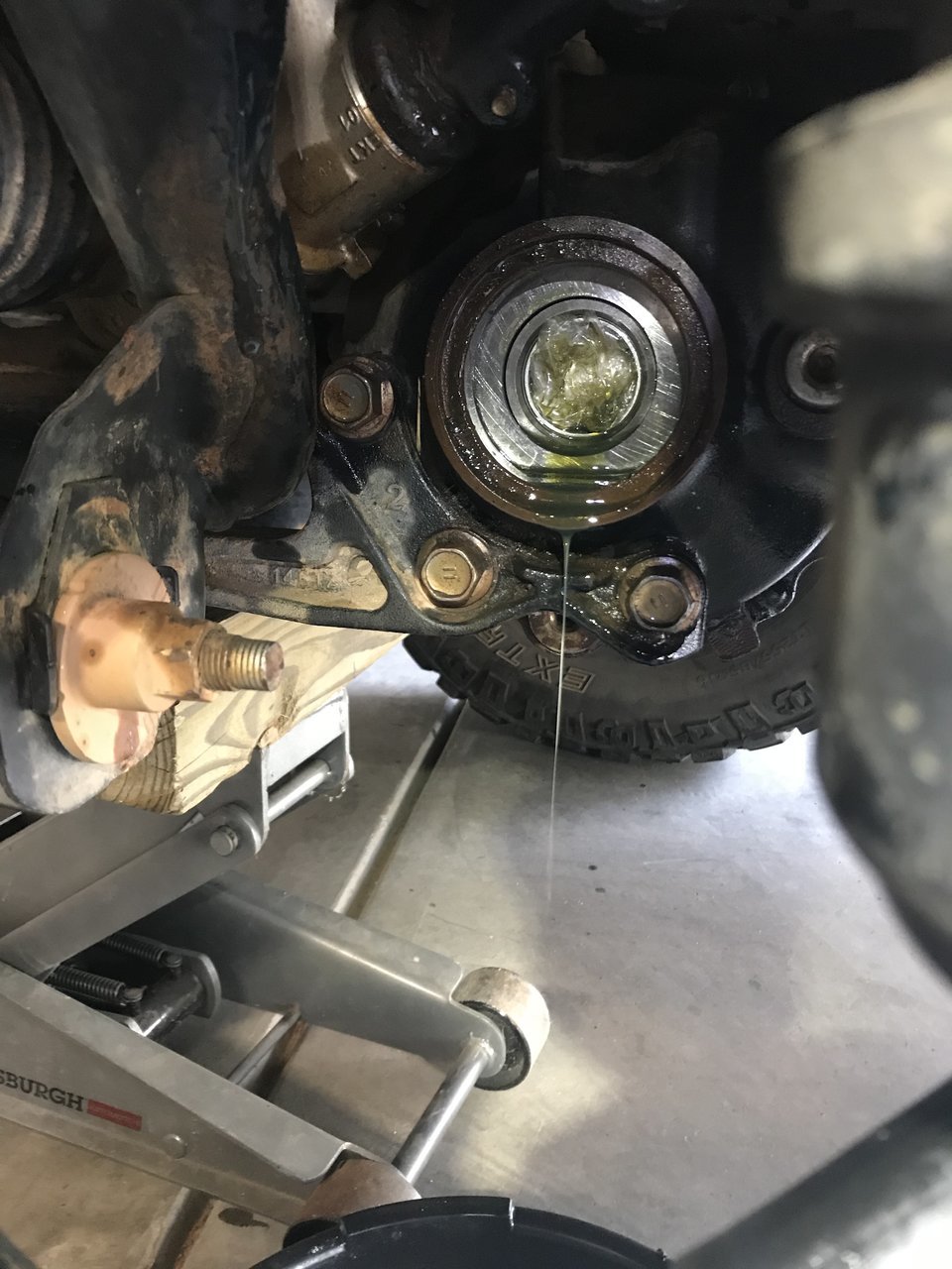

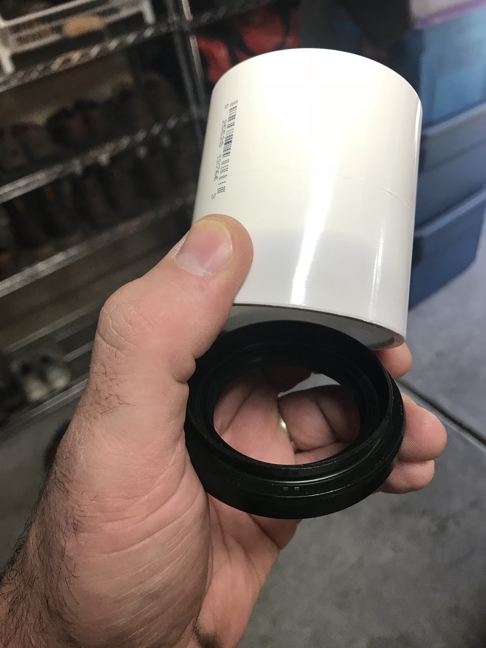

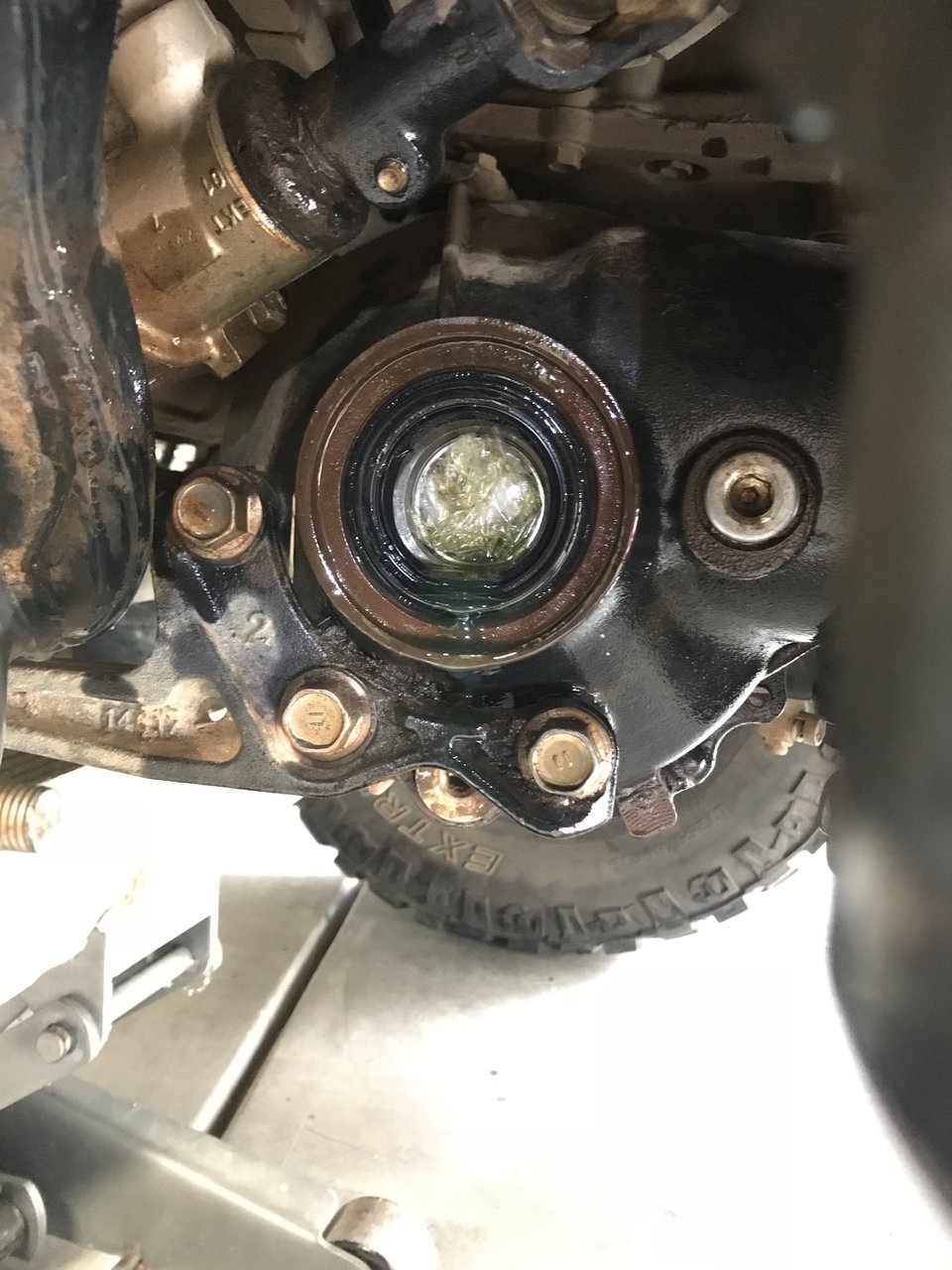

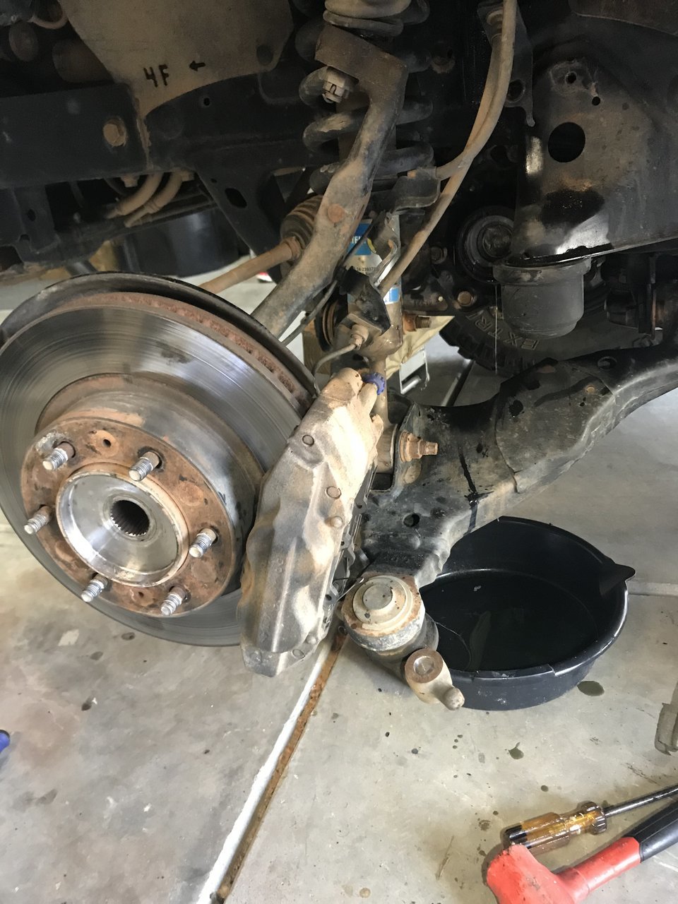

    104,500 miles. Replaced oil seal at front driver side diff this am. Not a bad job, about 2 hours in total. 2” pvc coupler is perfect to use to set the seal.
