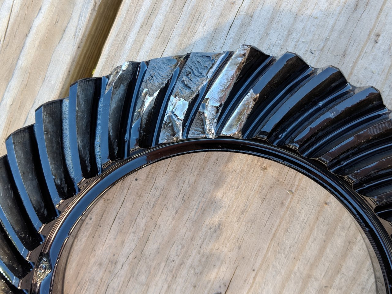

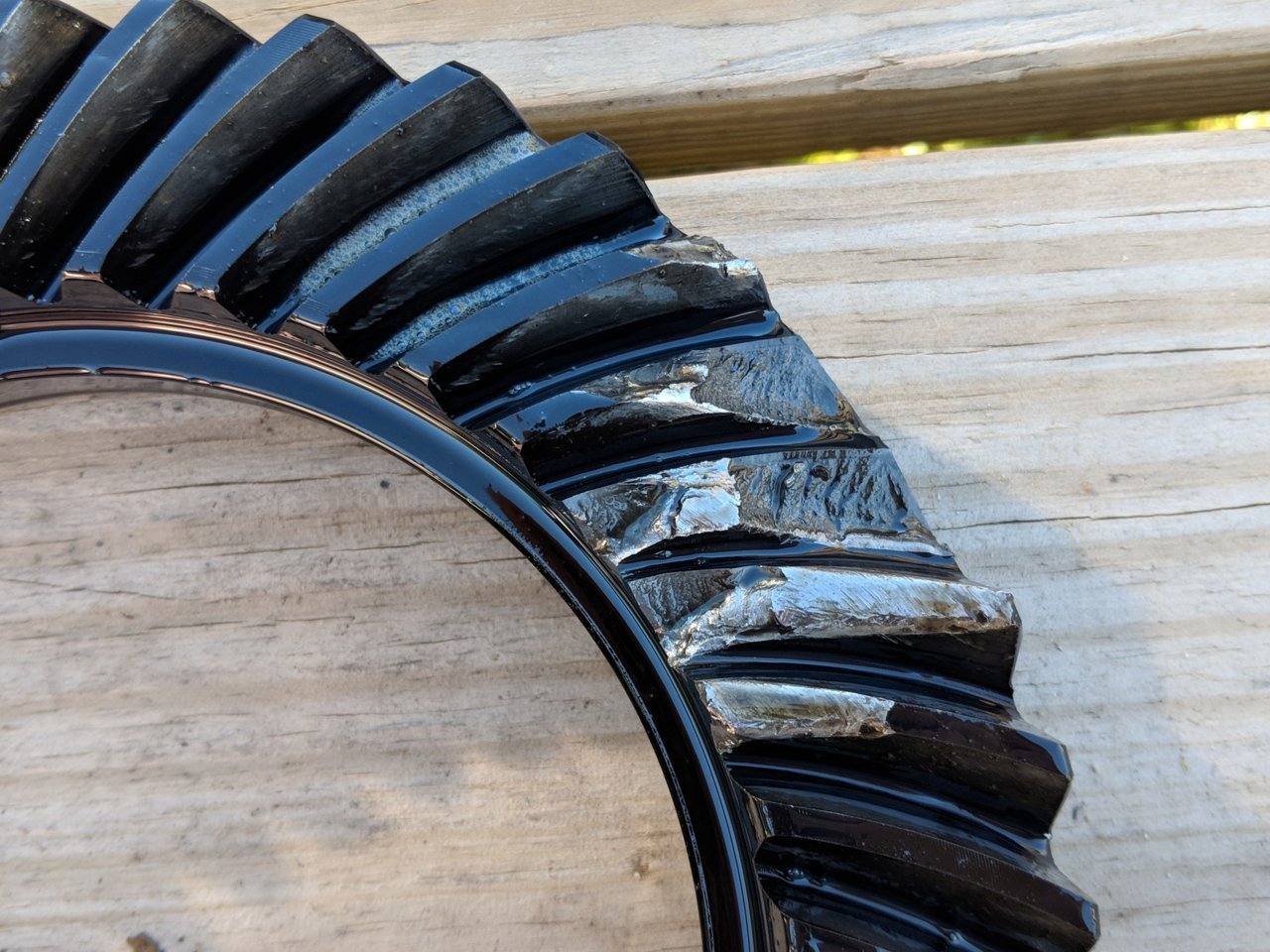

    Can you get any good pics of the teeth where they broke off want to see if I see any stress lines in the grains of the gear or if the grains look normal. Could indicate how they are failing. If there is stress lines then either weak hardening or not enough meat for the stresses induced. If not and the grains look normal then something happened in the casting porosity, poor casting, contaminants, etc.

    Looks like a combination of weak casting and only a couple spots with stress lines so it was what was holding the teeth to the ring then when they gave up the weak casting was exposed. That's what it looks like to me in the pics. Thanks Tim how'd I know you probably have those pics! :thumbsup:
