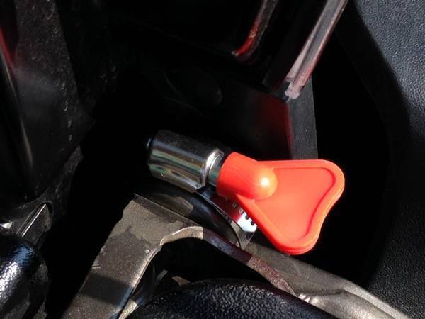

    ^^^ That's what I did with removable key, $ 1.50 for 2

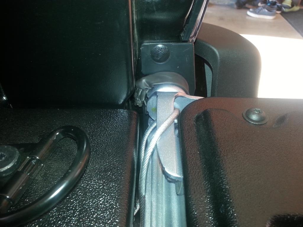

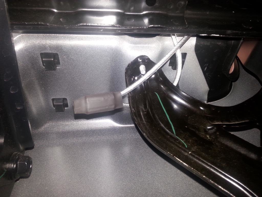

    There is a thread on this...but I haven't seen the JJ...
    I used the clamp method and also cabled the hinges to the frame.

    use a hose clamp face it downwards like the picture above so you have to use a long screwdriver up through the small crack in the tailgate.

    I am currently running the hose clamp face down and an electric pop n lock.
    Tailgate handle would not budge when the truck is lock.
