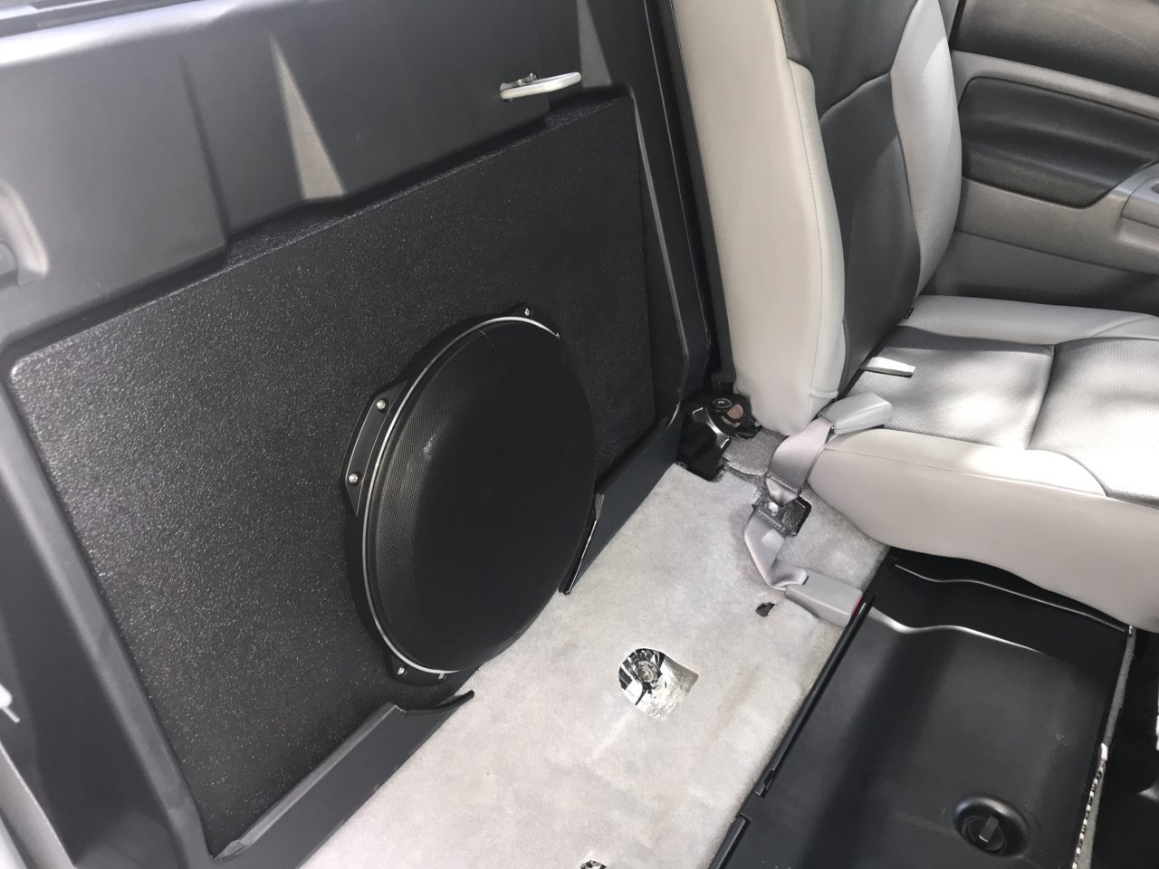

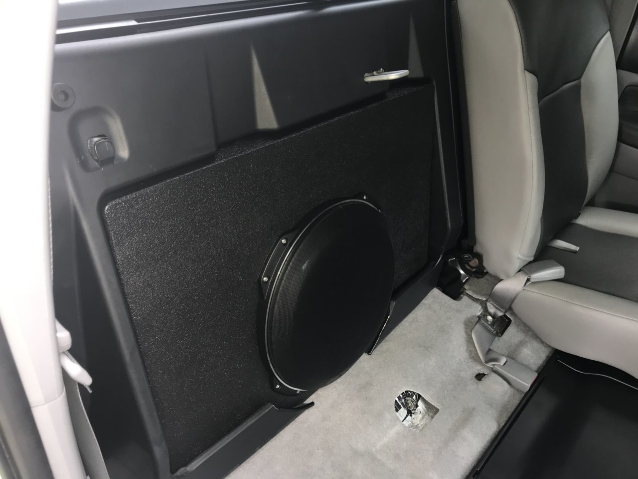

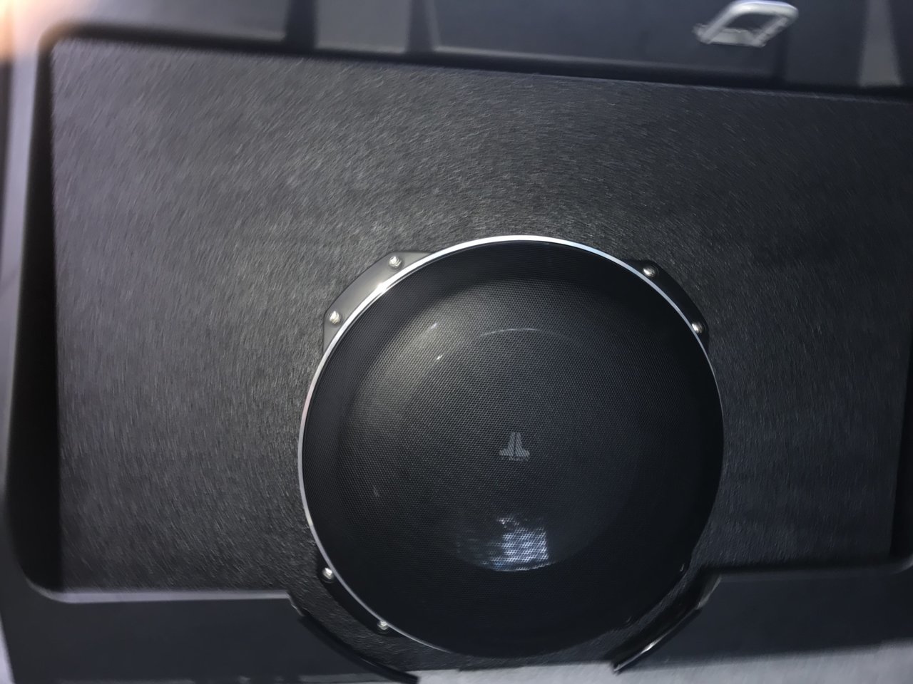

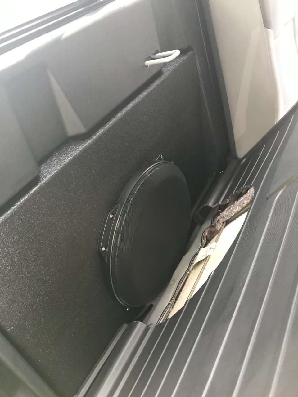

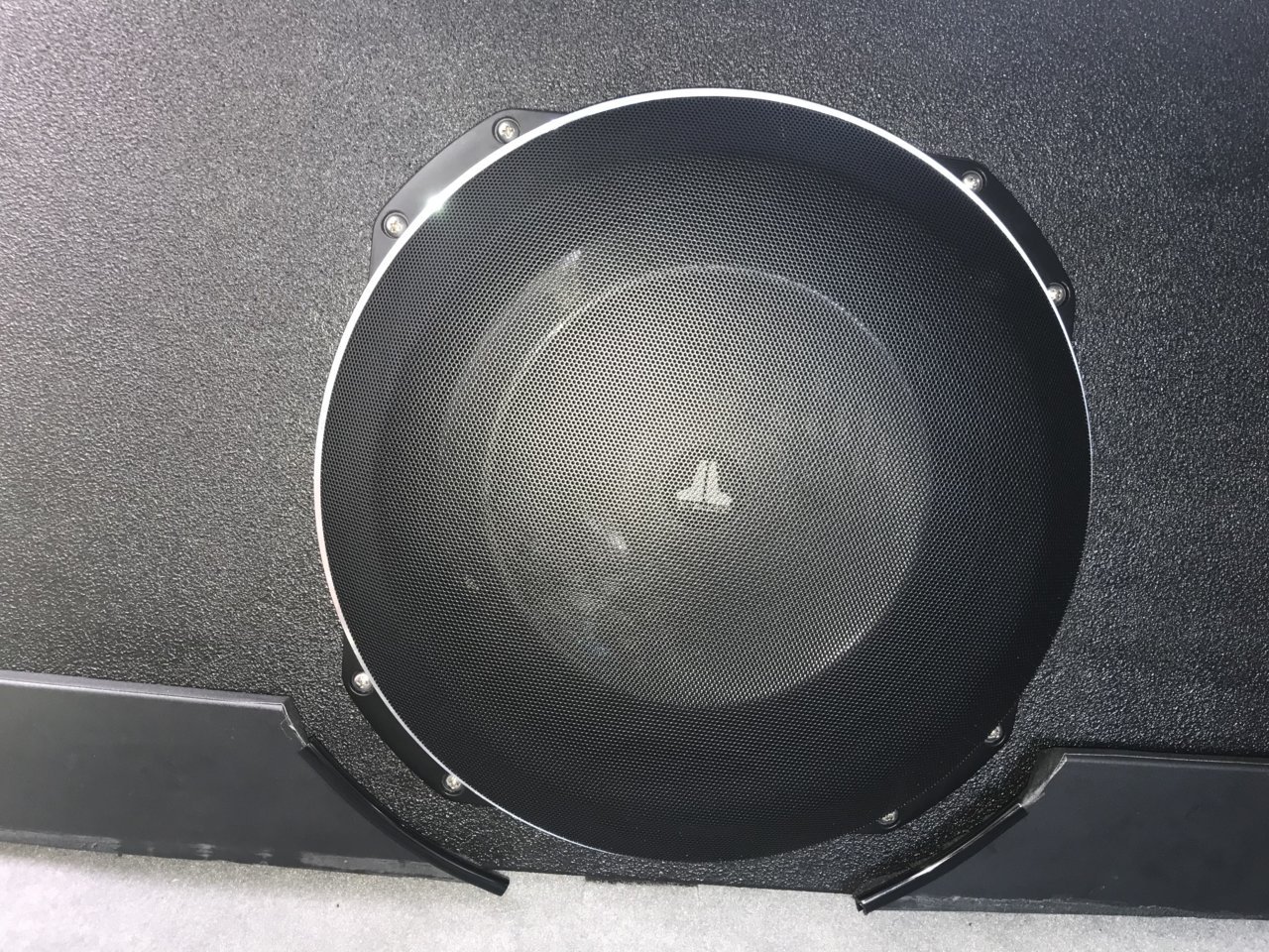

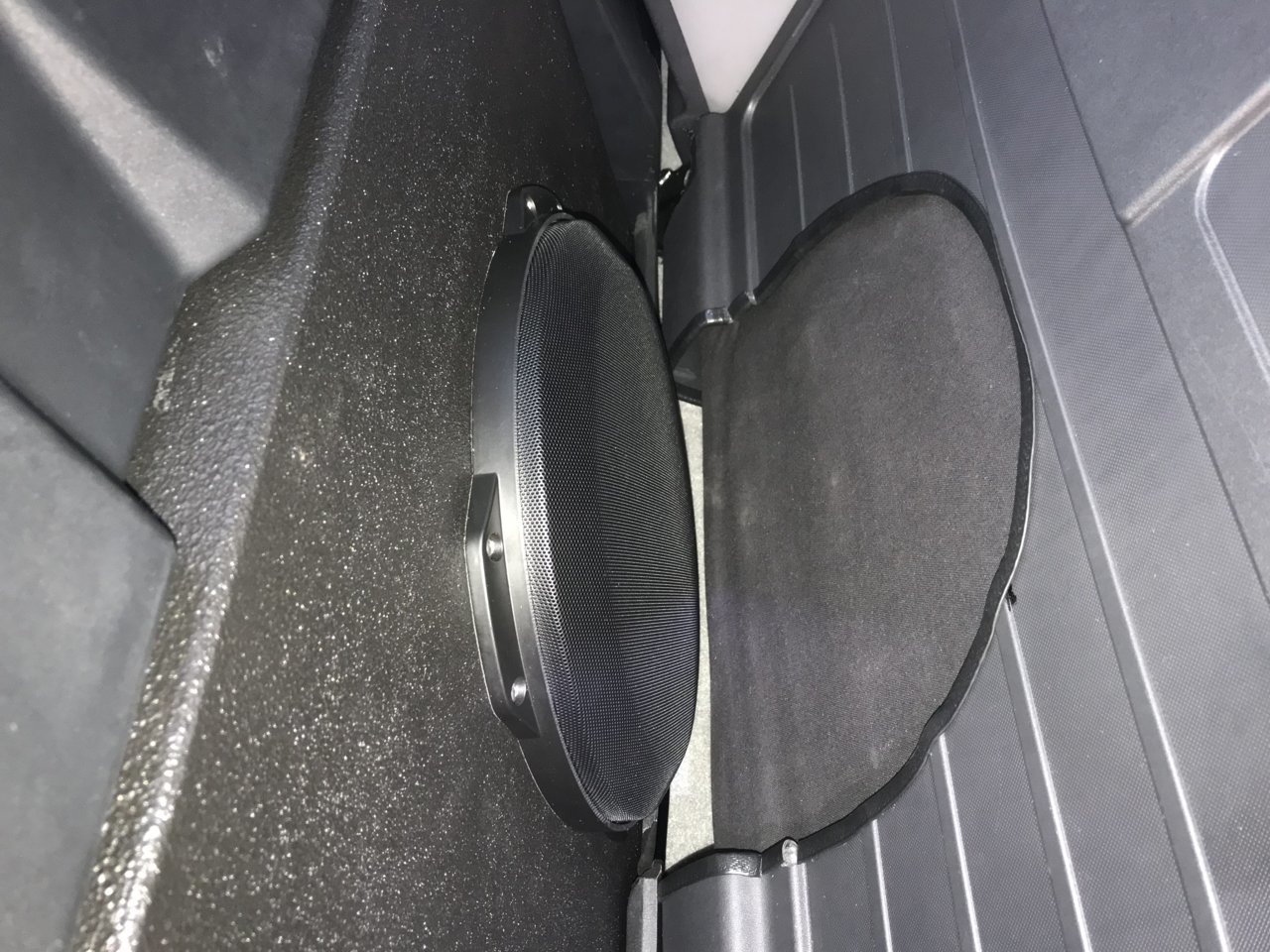

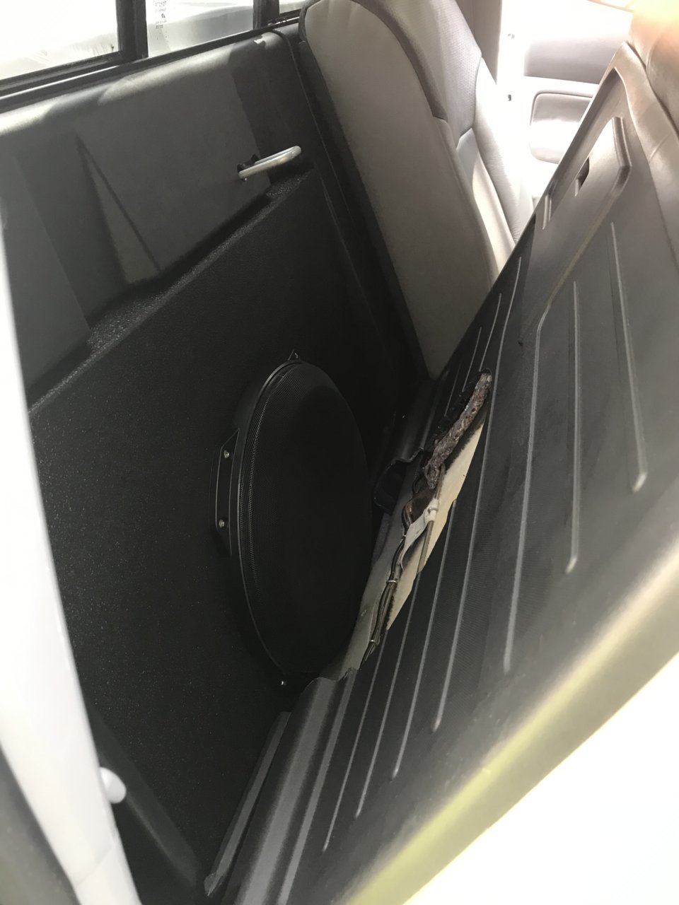

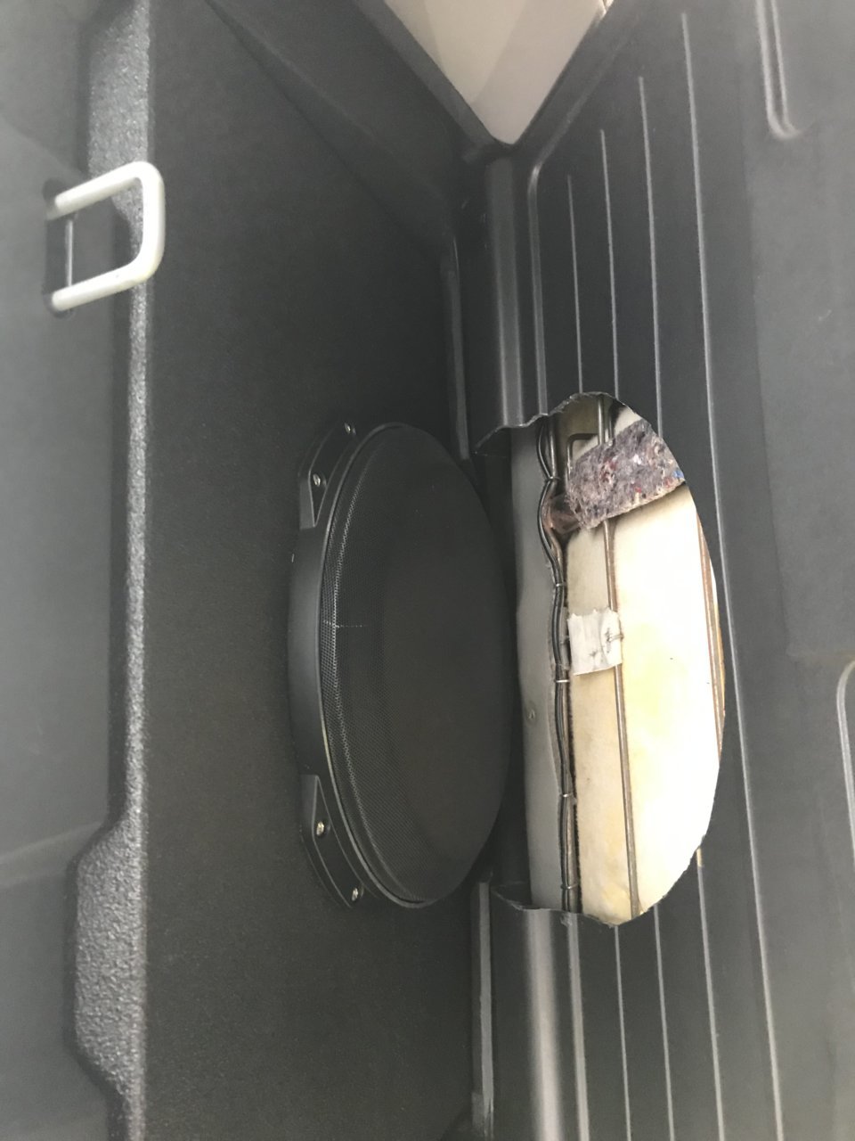

    Here you go Gonzo... not too shabby, that driver is amazing and so accurate.97D7AB51-BB64-4B0A-B0BD-7933809AF4C1.jpg39EAA3E4-7215-4CE4-BE80-C2D5E957205D.jpg657C2EAB-D565-4675-843B-35959632E617.jpg449B29BD-F19D-45D0-B53D-391181AC2C5B.jpgA743EC7D-ABB2-4453-BD11-29554158B583.jpg84C06008-BFF9-451F-A832-1D97EA150955.jpg61A0DD93-A3EE-4185-B03E-EC76A8A0405E.jpg6CC5BAB2-4CA5-4A5A-AC2D-F2AB12BEB9AC.jpg9760BB33-CD1A-45DF-9F96-0321C737DF97.jpg

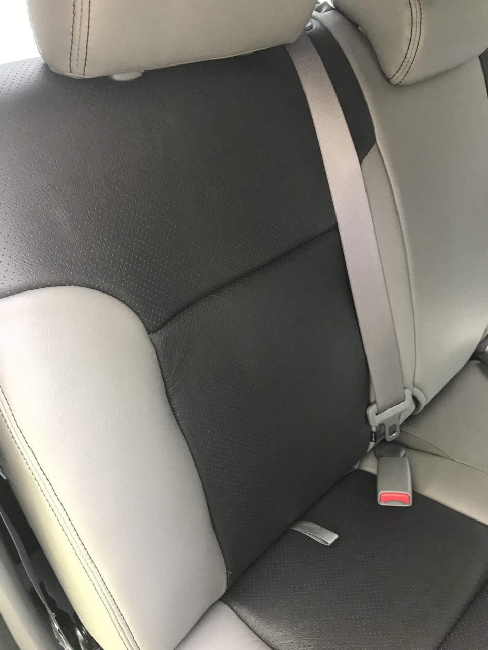

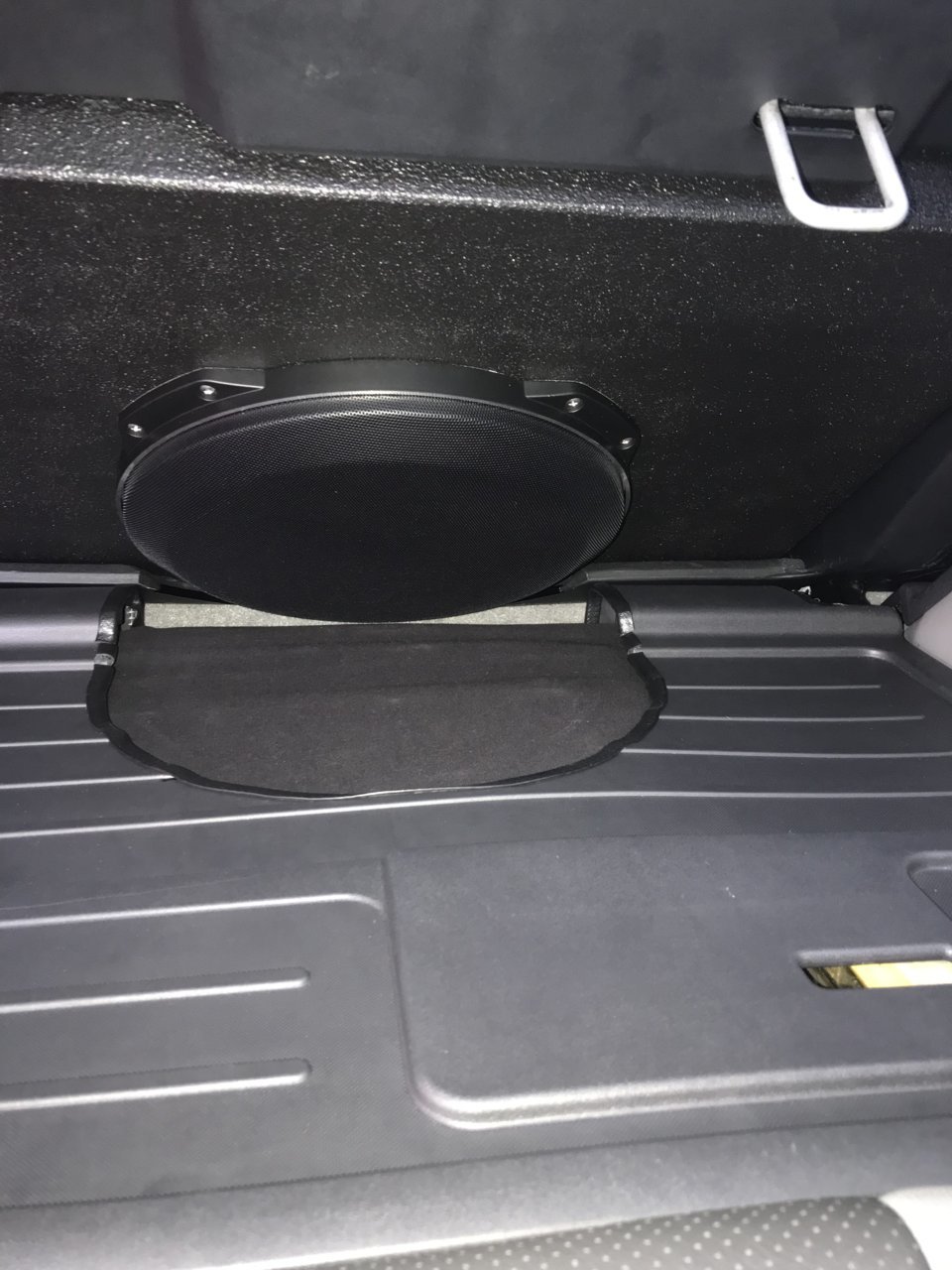

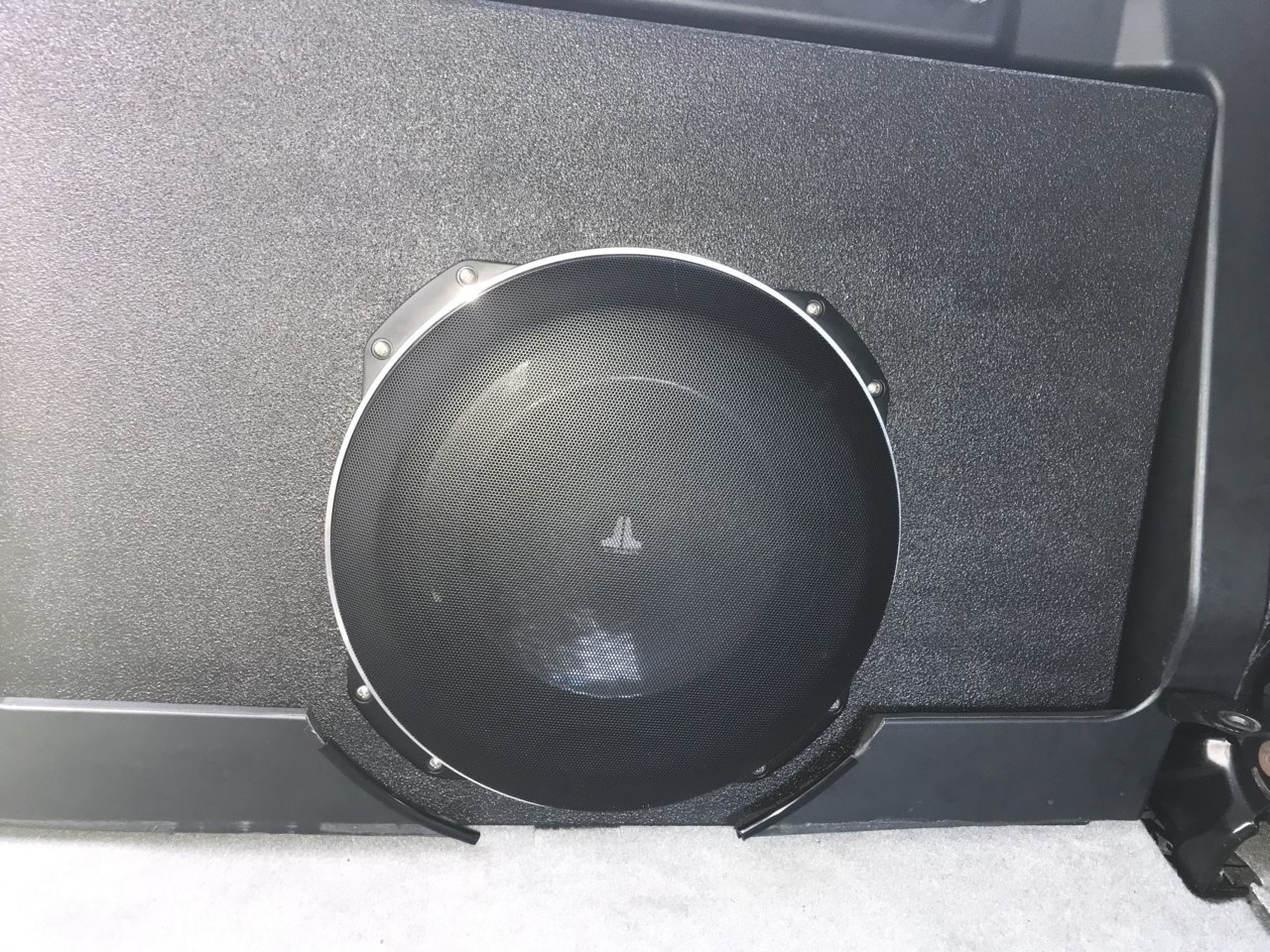

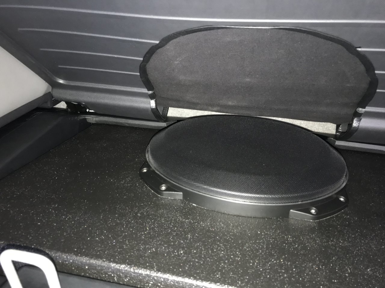

    FINAL SETUP - clean it up a little more.
    A2D77B63-E8B8-4D37-8485-DC83A6CF3529.jpg 942F0CB6-6D5C-4A34-80A4-A163BC94BDAA.jpg D184CA67-D3F5-4EF7-9D4B-EAB6432F61C2.jpg

    Nice! I got my TW3 installed today to replace my JLW1. I like what you did with the cut out and insert. How did you go about doing it and what did you put in there to fill it.

    Used a template and transferred exactly to the back of the seat. Traced the template on the back of the seat and took my time with a Dremmel and a cutting wheel.
    Then I bought some black canvas at Michael’s and used some hog rings I had left over from when I installed my Katzkins and lay it down inside the back of the seat. Then used some edge trim for car doors to dress the edge on the cutout and put it all back together.
    Easy day!

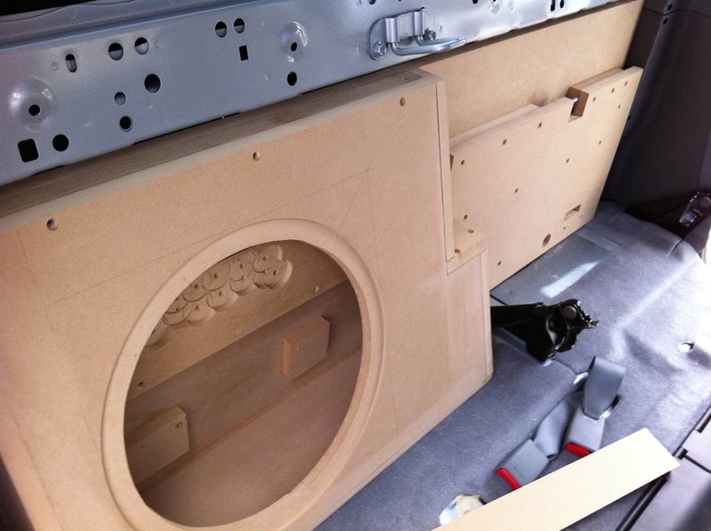

    I built my own box years ago and coated it with Line-X. Since the MDF I used was quite thick, I recessed the mounting ring a little bit. In hindsight, I guess my only regret is that the face of the sub box is sloped instead of vertical which allowed the bottom of the sub to hit the seatback plastic. If the face had been vertical then I could have set the sub back from the seat a little more and avoided that issue. I never have that seat back down anyway so I just removed the plastic panel completely.
    Test fit
    Coated and installed
