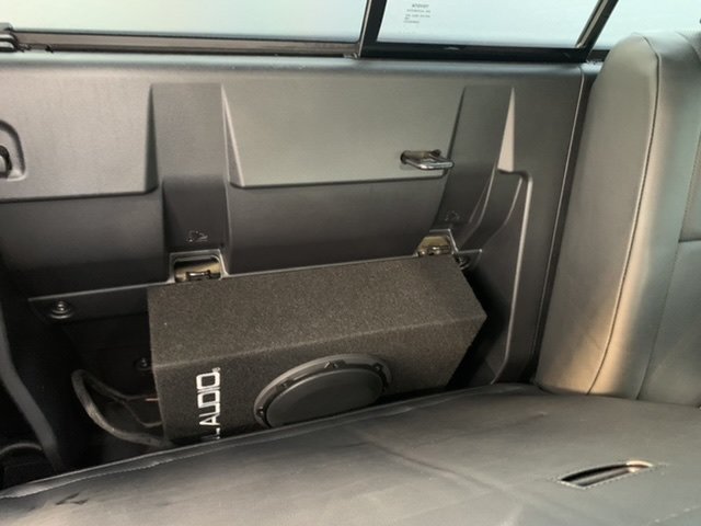

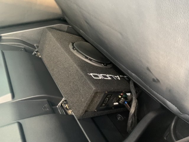

    No it does not slide or move at all. It is super snug and doesn't budge. This sub is very clean sounding.

    Do you happen to have Clazzios or another type of seat covers? Kinda looks like it judging by your pics. I have Clazzios and was wondering if the sub box will work with them.

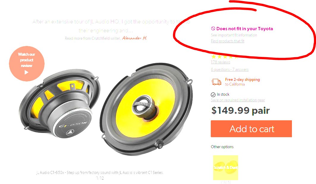

    Did you need to make any modification to the Back Door for the 6.5inch? Crutchfield is getting on my nerves.

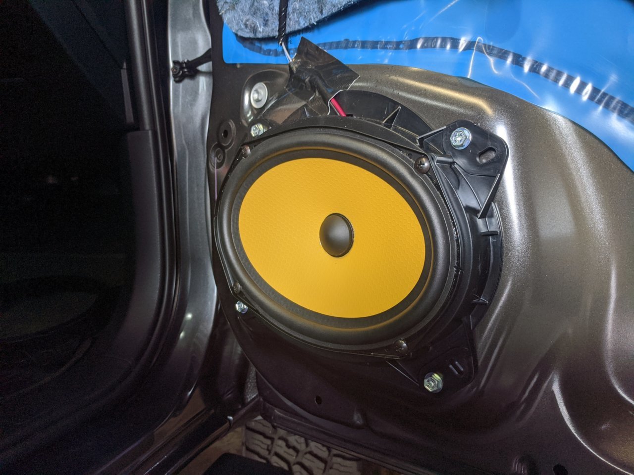

    With the Metra or other brands of adapters, you gain 1” of space. Overall, that makes it about 2 1/4” to the window on the back door.

    i measured 2-3/4" to the shallowest point, which is the window clamping mechanism. and that's from the door sheet metal-- any adapter/bracket(that you'll need anyways) is going to only increase that depth.
    i despise crutchfields fit guide. the phrase "hotdog down a hallway" is more apt to what they consider 'fits'...
