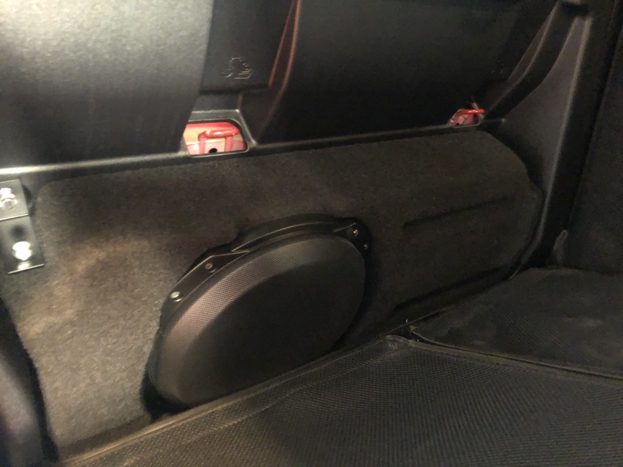

    Honestly it’s as the saying goes you get what you pay for I honestly thought it was high priced stealthbox but it is worth it
    In my opinion I did not want to rip out the back cubbies and have to find someplace in my garage to store it.

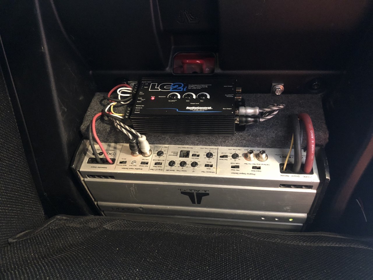

    As for the performance it sounds great it’s no JL W7 but it’s worth the 700$ price tag I have a JL 500/1 amp pushing it the sub is on the passenger side and built an amp rack on the driver side
    I also upgraded my door speakers to JL C1 series I’m just type of guy wants to keep it all the same
    I had a lot of sound system before from mix and match to all one company
    But each his own hope this helps

    how does it sound? i was thinking going that route, or, buying the pre-made dual enclosure and buying my own subs

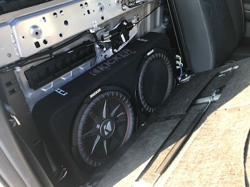

    0EC7F0CA-B9D2-4A7B-BD08-6EEB3A5270F4.jpg the guys have my pocket there maken be one to fit inside the storage pocket other then this one

    I'm very happy with it. Hit's hard enough for the occasional rap song, hits deep enough for the occasional EDM/house, and handles my flavors of rock very well. Bass guitar especially. Very clean.

    Coming from a JL Audio homer...the TW-3 is going to sound better than any kicker you buy. The kicker can get loud and will rumble but in terms of sound quality you cant beat the TW-3 shallow mount. That is, subs you will fit behind the seat.
    I did 2 JL 10”s in factory boxes. Same price as 1 stealth box. Never have to push the limits and it will give you all you want unless you’re looking for a 4 x 15” type setup. A little plastic cutting and they fit perfect.

    I might add there is nothing wrong with the kicker, especially to save some money. It’s just not the same quality the JL will be.
