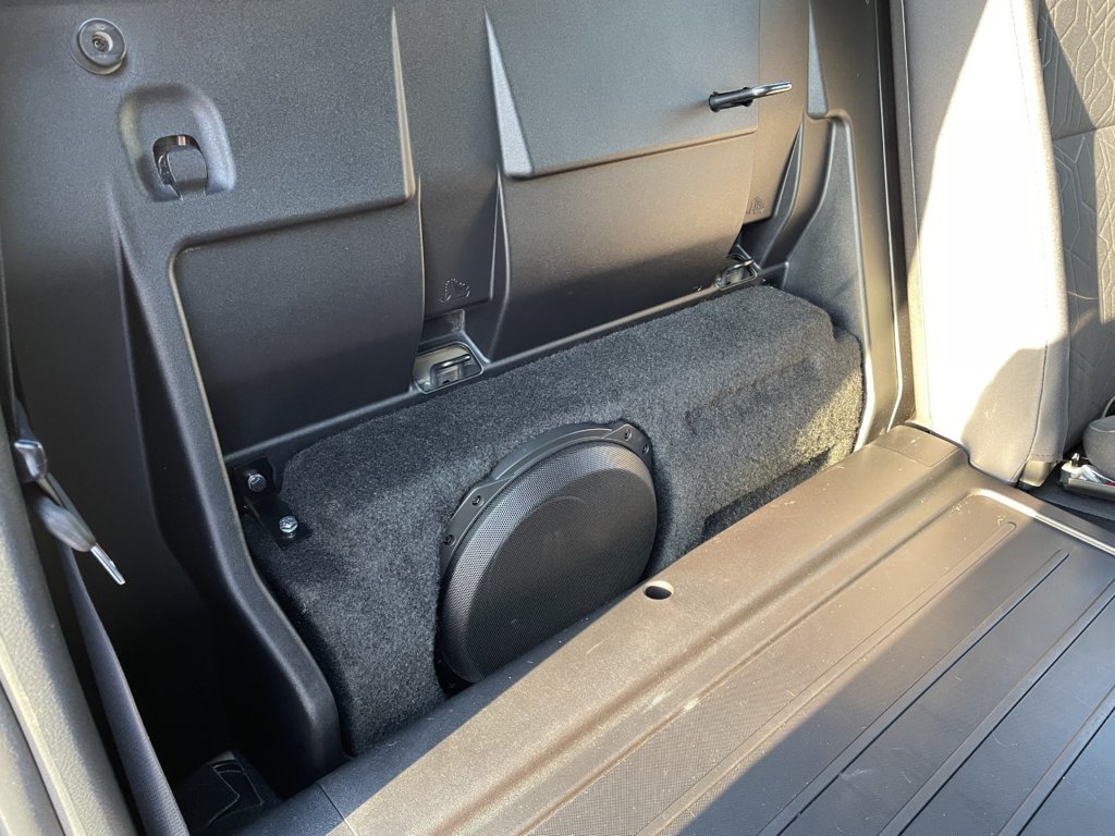

    Just installed today and the bass is awesome for a slimline 10 inch, running a JL RD900/5 channel amp with powerbass components, Im very happy with the sound!

    I have that box also with 350 watts class d power going to it , and I will say it definitely has some nice clean punch . Love it

    It hits for a 10 no doubt

    Considering the speaker is shallow and the box is small , it hits really hard . The amp I have isn’t super powerful either . There’s no doubt with some serious power and a bigger box and maybe two 10,s you could really get some serious bass . But I am past all that now . This sounds good and keeps my ears intact at the same time.Now when I was younger that was a different story . For a while when in school I worked part time and weekends for a car stereo shop, and back then you needed to fabricate everything custom . The only thing good out of that I learned a lot .

    Look on crutchfield they usually have them , very easy install , on the amp side I would say max go with 400 watts and cross over and around 80 Hz and sometimes even 100 Hz , you can play around with that .

    It's also drop in and wire it up with amp, and your good your good to go, it uses the the space behind driver seat with out modification except for a little piece of plastic that needs to be cut or a little dremel grinder

    That little ridge sticking up in the cubby at the bottom

    Sorry, paseger seat is where it's supposed to go

    Yes that little half inch piece that protrudes
