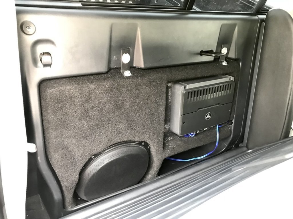

    I powered all speakers with JL Rd900/5 channel amp, fits perfectly under drivers seat, so about 500 watts to sub.

    JL fit like a glove,only thing is trimming a 1/2 inch piece of plastic in cubby area that will allow it to sit down flush in the drop in area of back seat, no other modifications at all, probably a five minute trim job, simple, yes a blade or dremel.

    Just need to trim the inner plastic tabs on the cubby. A razor blade works fine. It's a very snug fit.

    Back of seat has plenty of room to close without touching behind seat folded up, looks like factory install.

    Been running mine for 6.5 years with a 500w JL amp and absolutely love it. That sub punches way above its weight and sounds fantastic.

    Nice setup, my amp is under drivers seat, any issues with seat hitting amp? Is that the rd900/5 JL?
