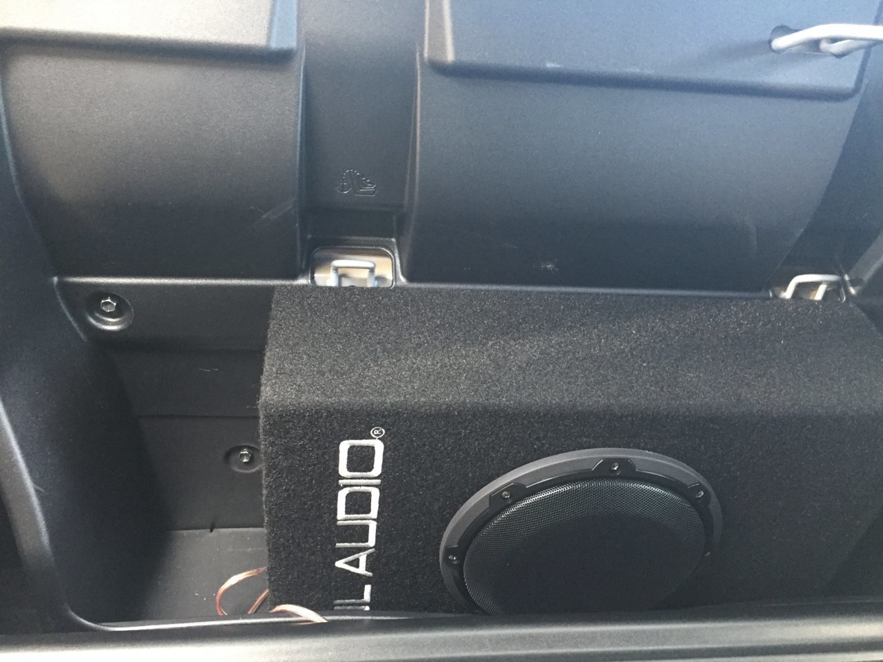

    You will definitely need to remove the plastic bins and quite likely have to remove the plastic backing on the seats. The 10" box is definitely taller and absent removing those things I don't think you will be able to get your seat to lock in place. See this photo of the 8" ported box and it's height relative to the child anchors. [​IMG]

    Looks like your 8" box fits in there really well, is this a 8w3v3 you've got in there?

    I'm very impressed with the output of that little guy. Easily shakes the rearview mirror. I am using the JL JX500 amp. That said I also did the subaru tweeter, kicker CS speaker upgrade and have the Kicker Key amp powering the front and rear doors. I have no need for anything bigger.

    That sounds like the perfect setup, i think i'll be going with this 8" box so that i can keep that plastics in place, did you dynamat at all behind the plastics?

    No - I didn't do any noico or dynamat. So far so good - I don't have any buzzing or rattling. I should also mention I used the roadkill fast rings for the front and rear door speakers.

    Looks like removing at least the one plastic bin behind the passenger rear seat is going to be unavoidable in my quest to shove a 10” back there. It’s no worries really. I’ll just have to seal up the vent on the back wall to keep any possible water for getting on whatever box i end up with.
