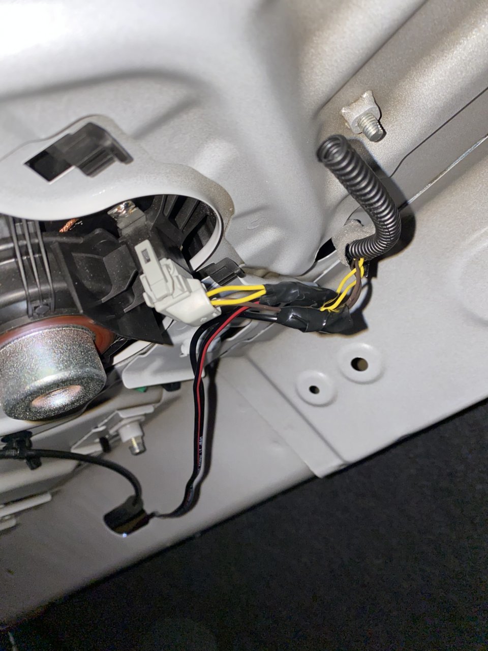

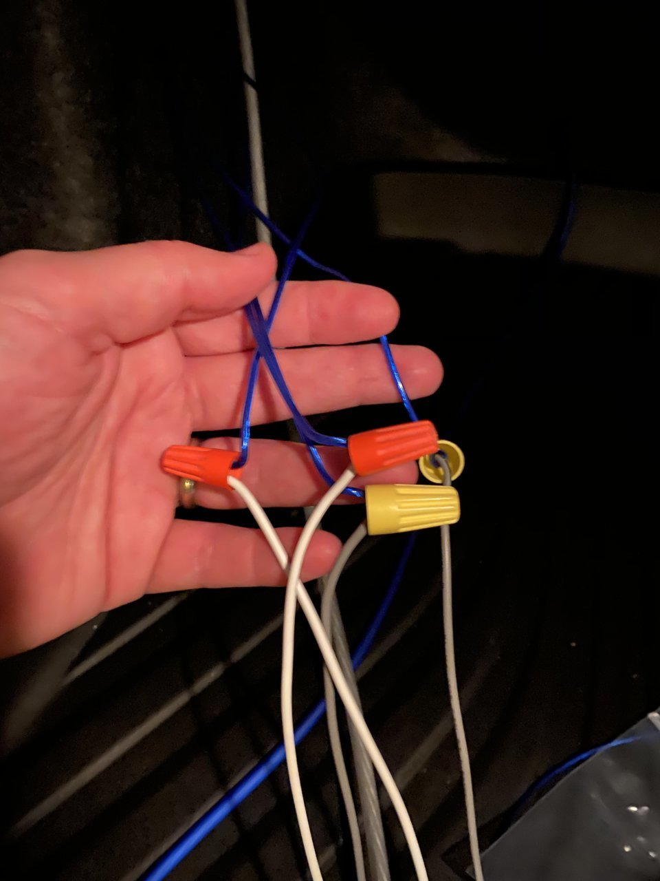

    Crimp connectors are designed to be used with dedicated Klein-style wire crimpers. If you used pliers or something like that, they are almost guaranteed to fail.
    Can you elaborate on what you meant about using the remote wire from the 6x9’s
  2. Sep 25, 2020 at 5:33 PM
    #22
    Chastaco
    Chastaco [OP] Well-Known Member
    Feb 29, 2016
    #179794
    1,200
    2020 ORDCSB Cement 4x4 Auto
    Damn you’re awesome man. I feel bad to keep asking you questions.
    I figured I was making the connections look clean but I could tell when I crimped them that they weren’t tight but was in a rush to finish up before we had to go out to dinner. Haven’t had a chance to mess with it again. I forgot that I would need some speaker wire so I used the 18 gauge remote wire included in the amp kit pictured here to run the signal from the 6 x 9 speaker wire to the sub. Ended up switching to wire nuts.

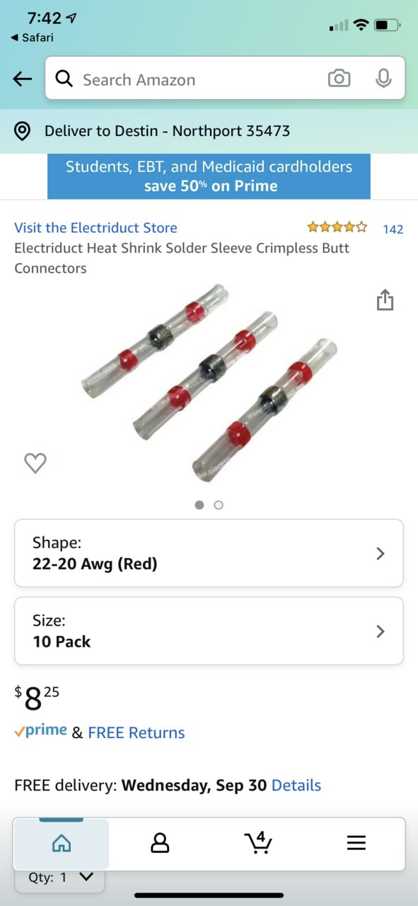

    Wire nuts aren’t meant for vehicle use so expect a failure there sometime down the road. They’re made for home use, where there is roughly zero vibration and movement. Cars, on the other hand, have lots of vibration and movement
    for a clean reliable install without buying a specific tool, grab some of these and they work well with just a heat gun.
    Chastaco[QUOTED][OP] likes this.
  5. Sep 25, 2020 at 5:51 PM
    #25
    Chastaco
    Feb 29, 2016
    #179794
    1,200
    Will do, thanks!

    Been Sidetracked. yes, it’s up and running, and works, but is making a Feedback whomp whomp whomp... noise when accelerating or sometimes decelerating. Pretty loud. LOL, I wasn’t even in her car for a week and a half and she didn’t tell me that it was making that noise. Just thought it was normal. One of the things that I wasn’t sure about is that there are two positives and two negatives going to each speaker. I ran both of each into one wire going into the sub as shown in the picture.
  10. Oct 16, 2020 at 5:58 PM
    #30
    destin_meeks
    destin_meeks I used to fix people's crappy stereos
    Jul 14, 2017
    #223997
    3,933
    Destin
    Tuscaloosa, AL
    2017 SSM DoubleCab TRD Off-Road 4x4
    I’ve been out of the game too long and you describing that brought be back into it. The accords (since like 2015 or so) have ANC (ambient noise cancelling)
    there are mics placed around the cab on the ceiling that listen for road noise, and they pipe audio signals into the radio to cancel out these road noises.
    When it plays these frequencies, they are now being played through the sub as well now, which the mics pic up, which makes them play more to counteract this new noise it’s not calibrated for, and all that happens over and over like microphone feedback.
    you’ll need to disconnect the ANC module. It’s buried way down under the radio, right behind the little cubby down there. You can pop off the side panel in the passenger floorboard and access it relatively easy. Just google “disconnect ANC module 2019 accord” or whatever year it was

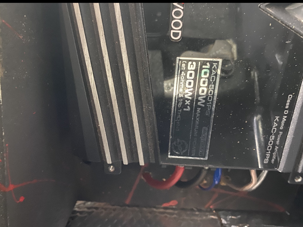

    Do you have the exact model number on that amp? I'm curious on it's dimensions to see what fits alongside the CP108LG-W3v3.

    Yup, not a 250 like I said though.
