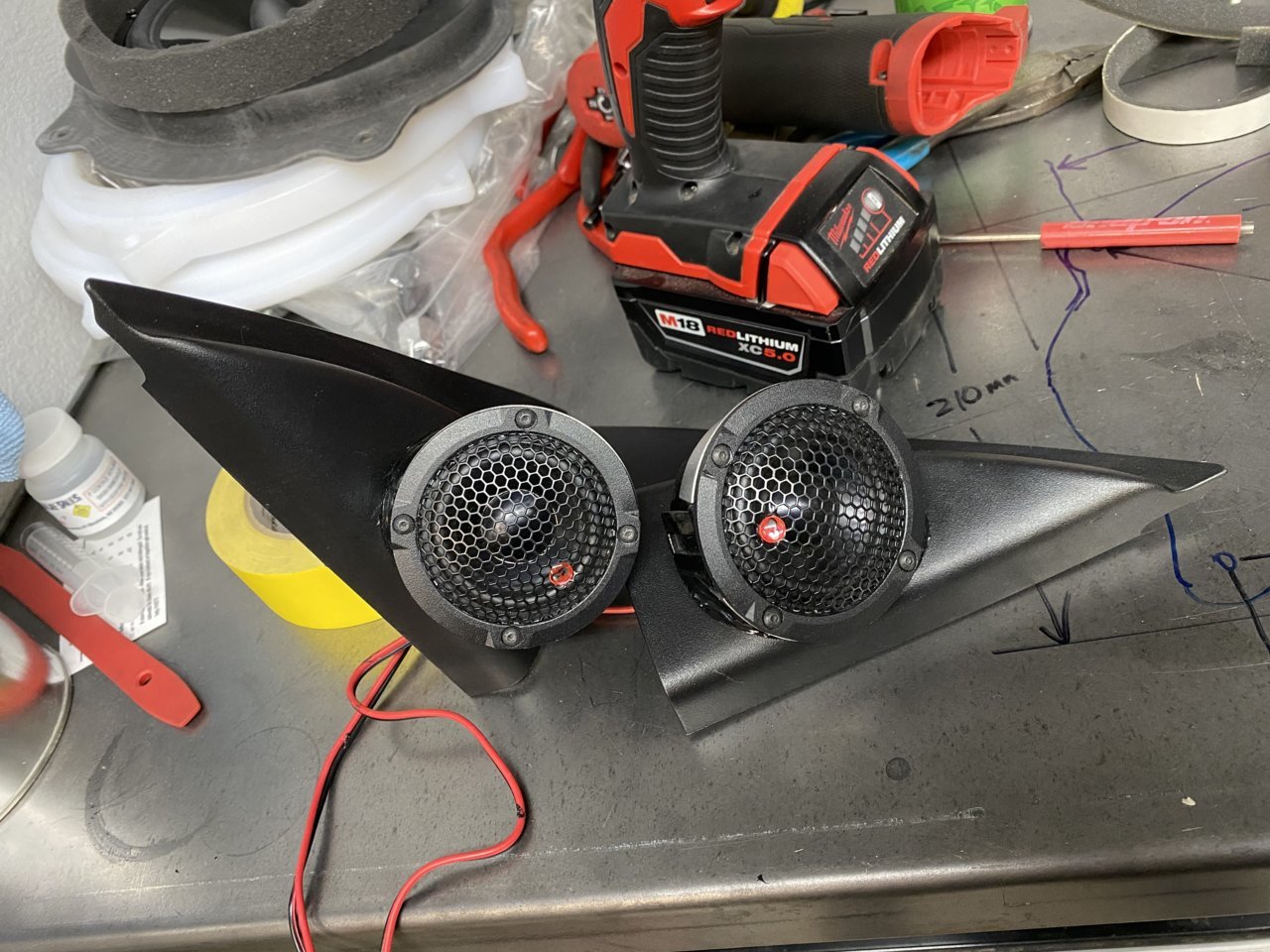

    CoastieRon
    CoastieRon [OP] Hammocking Fool
    Jan 1, 2018
    #239946
    2,431
    Ron
    Nashua
    Lil' Silver
    Too much.
    I'm now "making" pods for the new cdt 2" coaxial. I love playing around with the stuff.

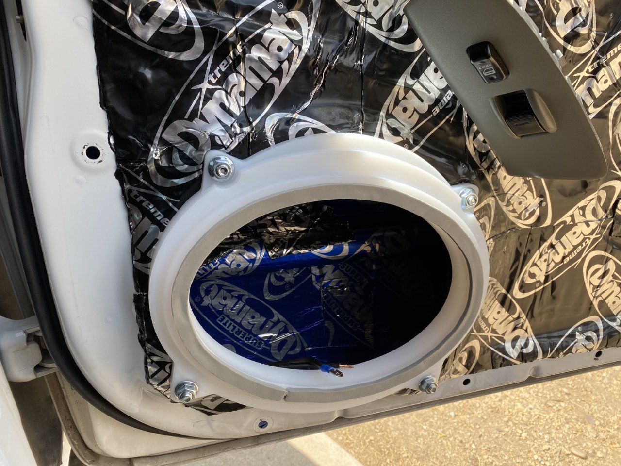

    Mine are admittedly mounted less cool. I just sunk the pods into the mirror garnishes. Please share more of your apillar build pics.
    Also, I had @delander over on DIYMA make me a set of speaker adapters for the midbass in the front doors. They’re bad ass. If either of you guys need adapters. He’s the guy.

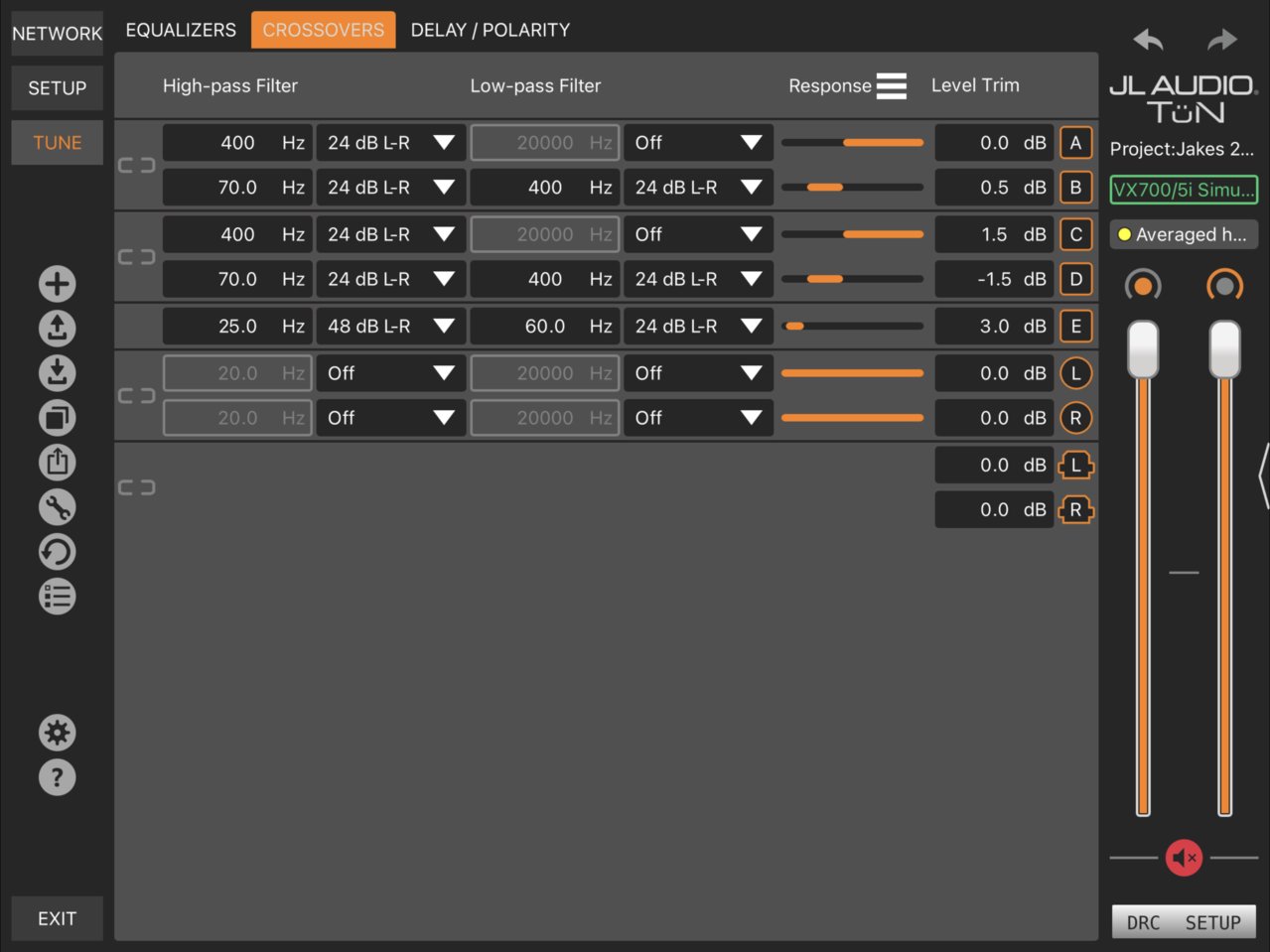

    I’m guessing that crossover stuff would be most beneficial for you right now eh.

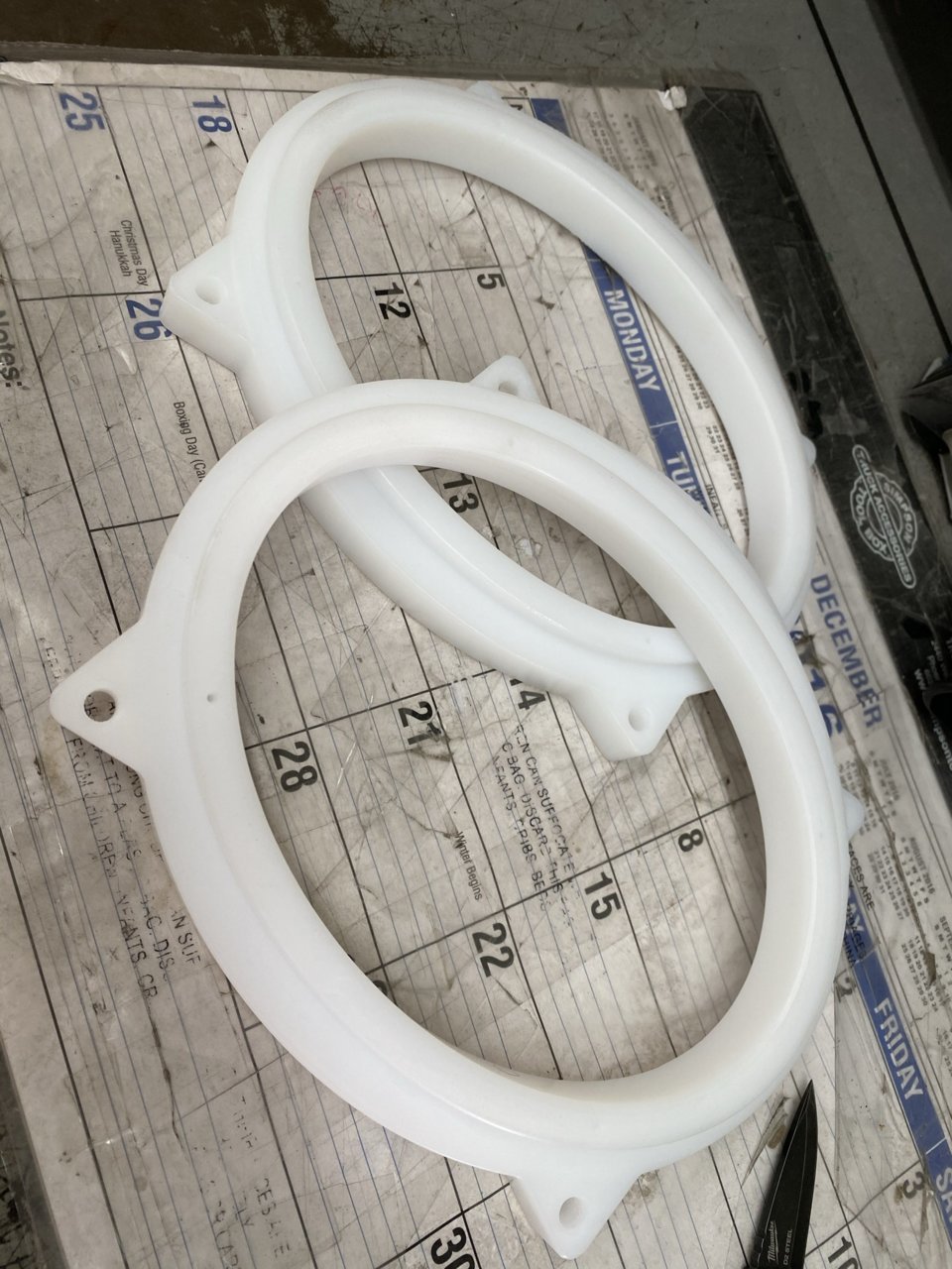

    Here’s basically what I’m running.

    I think I’ve got a handle on the crossovers, pretty much like that there.

    Wish id seen that a bit earlier, I somehow ordered the wrong Metra rear speaker adapters on Crutchfield and went back and bought the right ones but hear they aren’t great either.

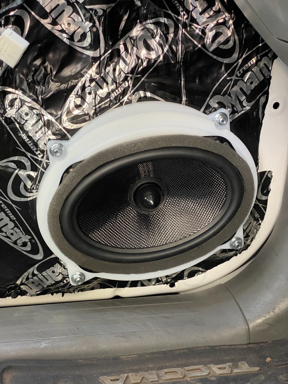

    These things are beef! Heavy HPDE. Solid M8 mounting holes. Lots of mass to quell any vibes. Clears everything and is designed to space the driver to meet the trim panel just like the OE speaker. I was picky about that.
    As for your tune, what else are you looking for besides xovers? Pretty much everything else will be customized when you get down to tuning.

    are those vacuformed, or pre-made housings? can't say i've seen a design like that before

  17. Jun 7, 2021 at 5:31 AM
    #57
    CoastieRon
    Jan 1, 2018
    #239946
    2,431
    Ron
    Nashua
    Lil' Silver
    Too much.
    They're premade from Custom Speaker Pods. I epoxied them to the A-pillars and am working on them with body filler this week.

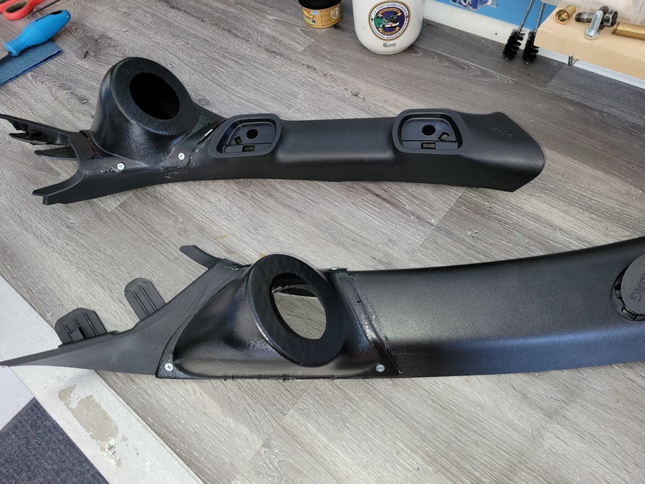

  20. Jul 18, 2021 at 6:02 PM
    #60
    CoastieRon
    Jan 1, 2018
    #239946
    2,431
    Ron
    Nashua
    Lil' Silver
    Too much.
    Here are the pods completed
