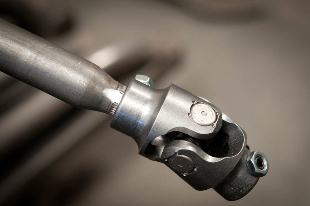

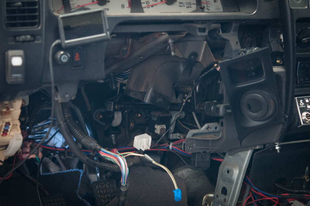

    I figured out the damn U joint!!! the column is keyed on one side just had to be the side I couldn't see. I found that out after pulling the column I shaved it down and the fucker slides right in :cool: I did remove quite a bit of the splines on the other side so i drilled and tapped the column so the set screw go through it. And no welding it on :D
    Wile i had it out I did the tack weld mod as well as set me ribbon cable perfect so I didn't snap it. It all took about an hour to pull everything do the mods and install it all back in.

    Oh the center console is still all tore out that will be the last thing I do before the truck is driving again.

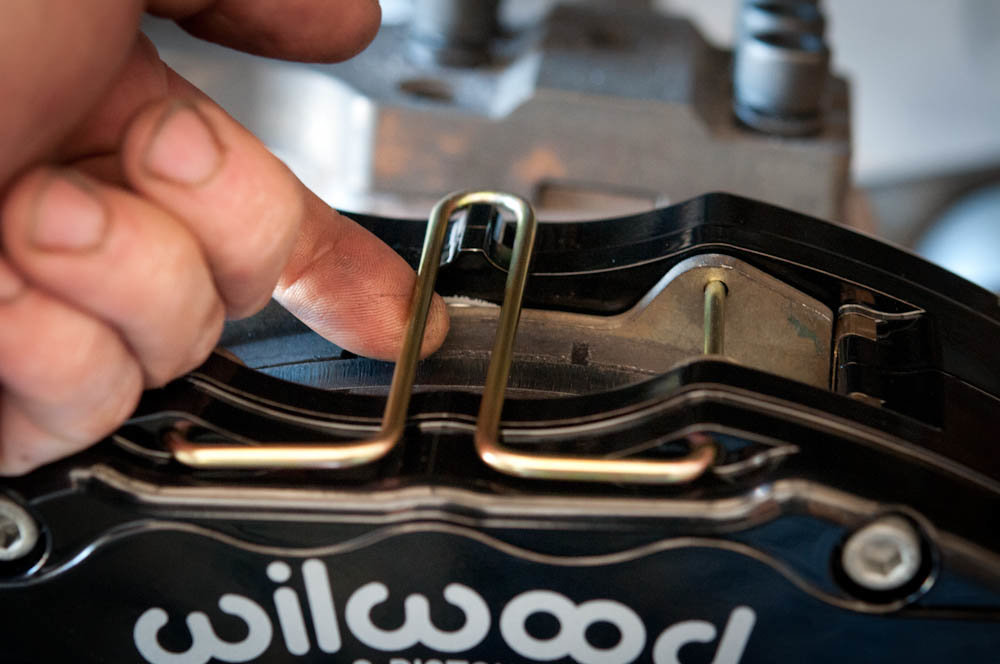

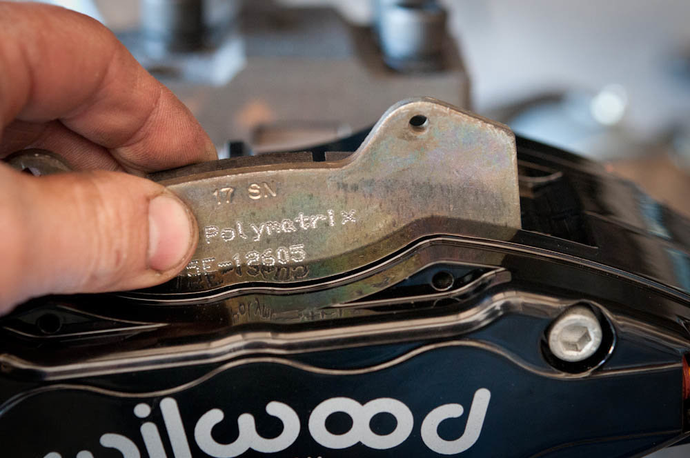

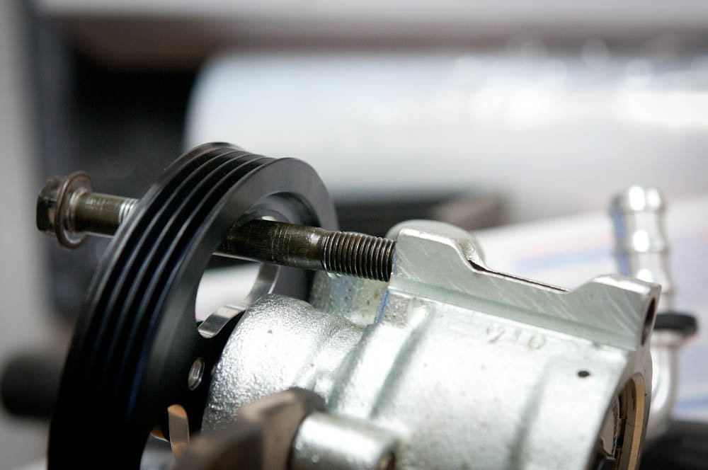

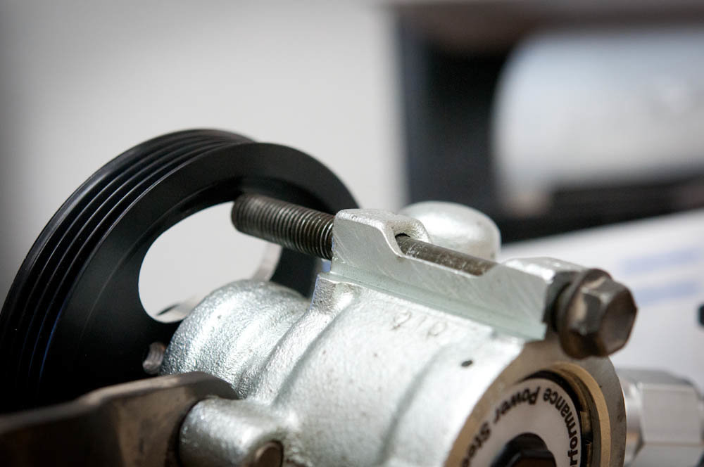

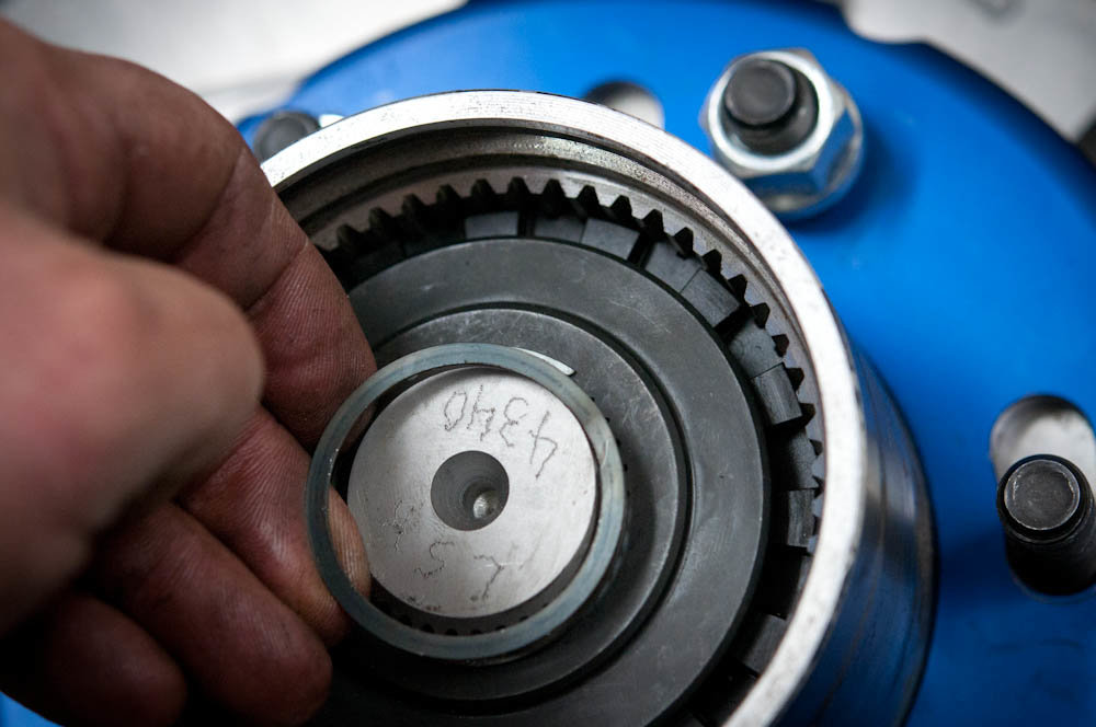

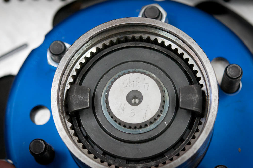

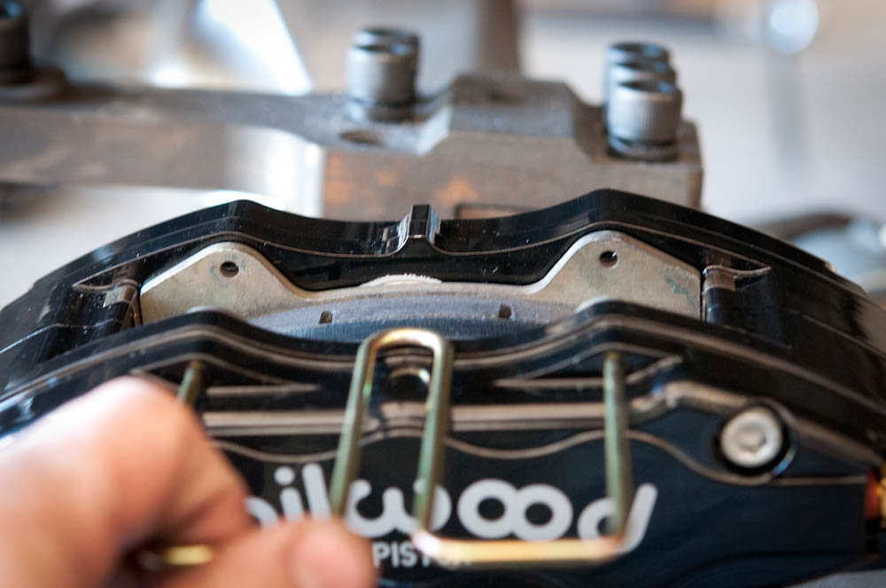

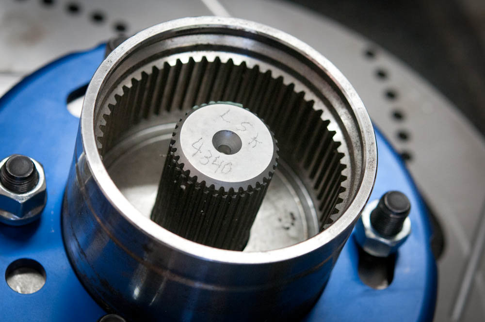

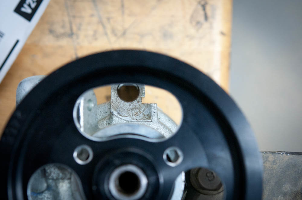

    Well I think PSC sent the wrong pulley :notsure: I'll be calling in the morning to find out what's going on.

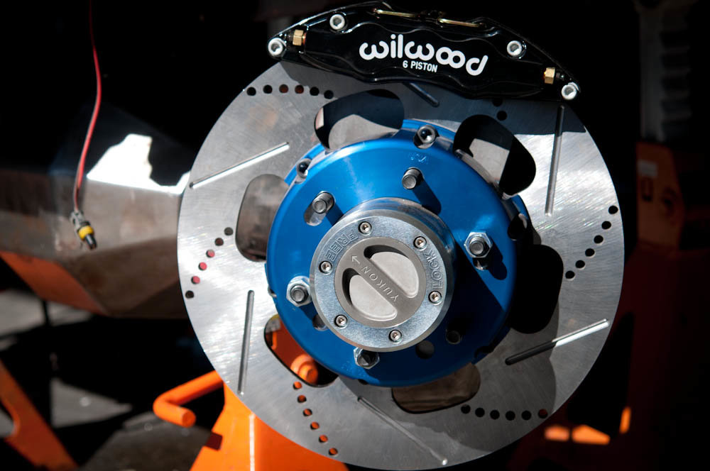

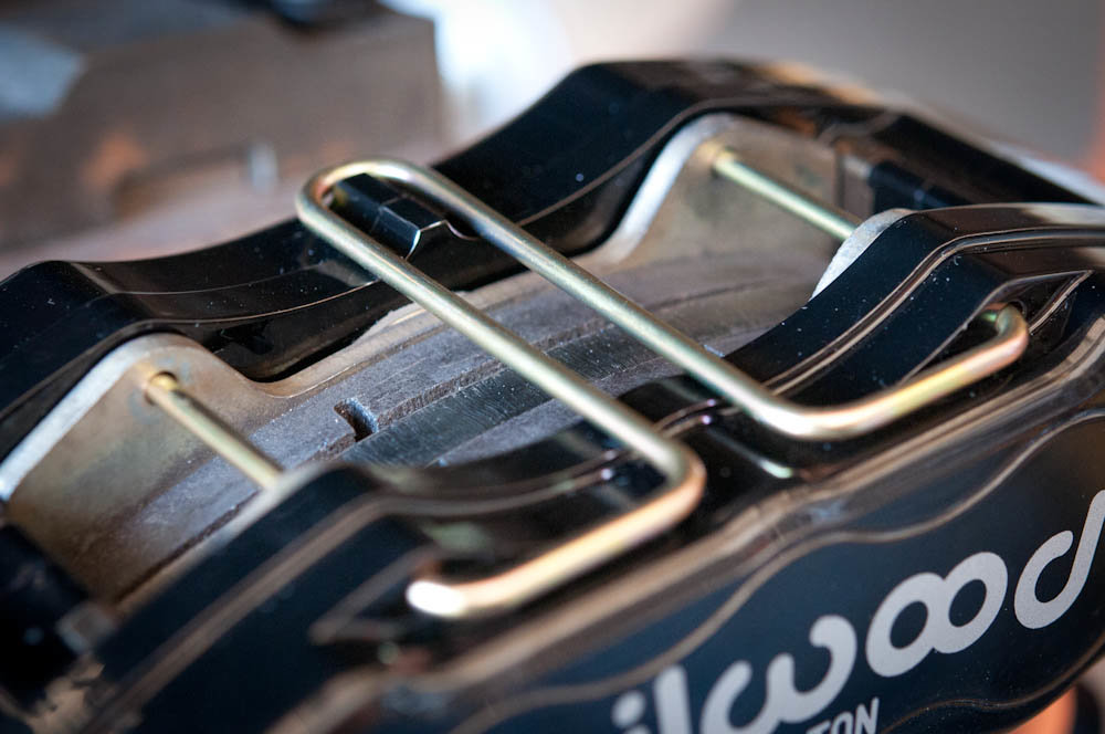

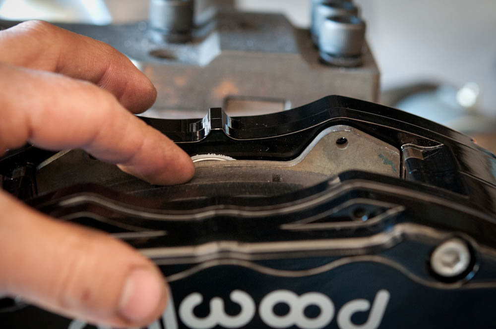

    And I just wanted to show how bad ass these calipers are :D I can swap the pads in about 1min with no tools :cool:

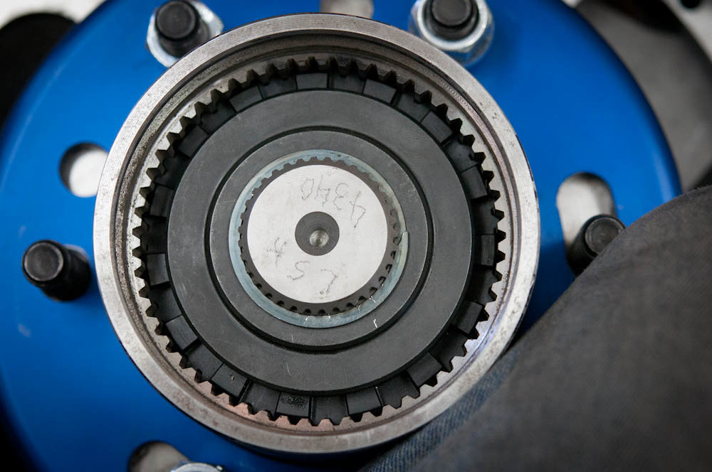

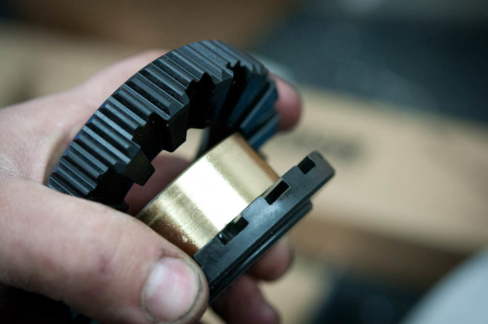

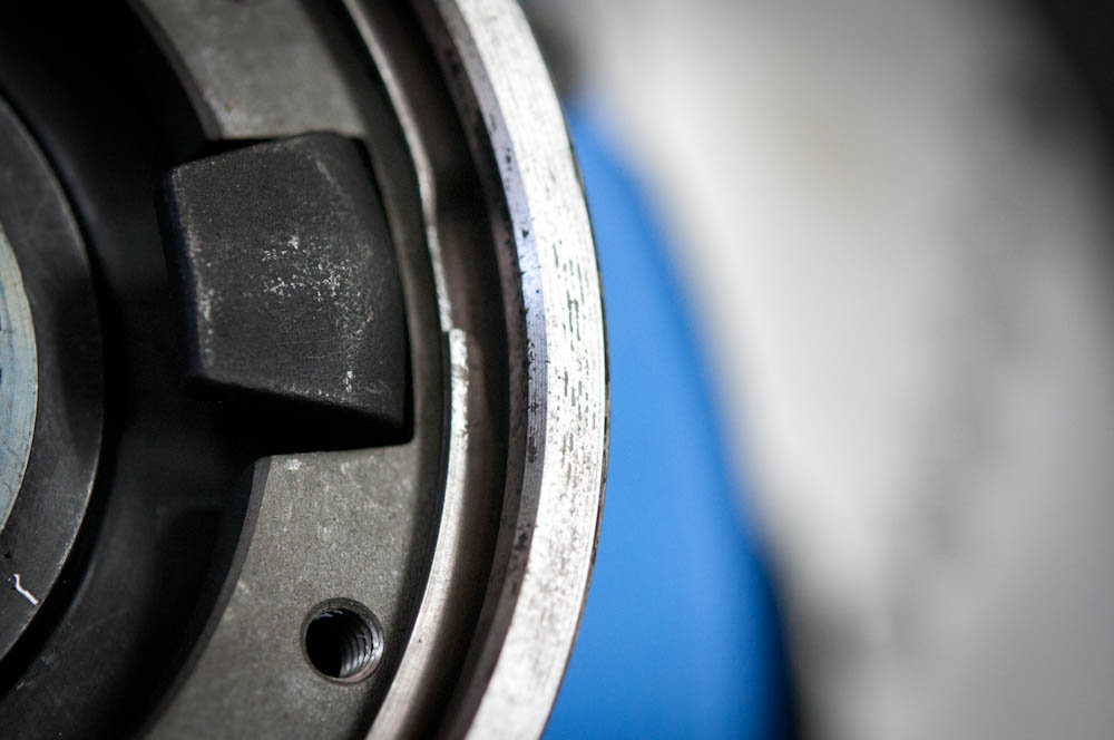

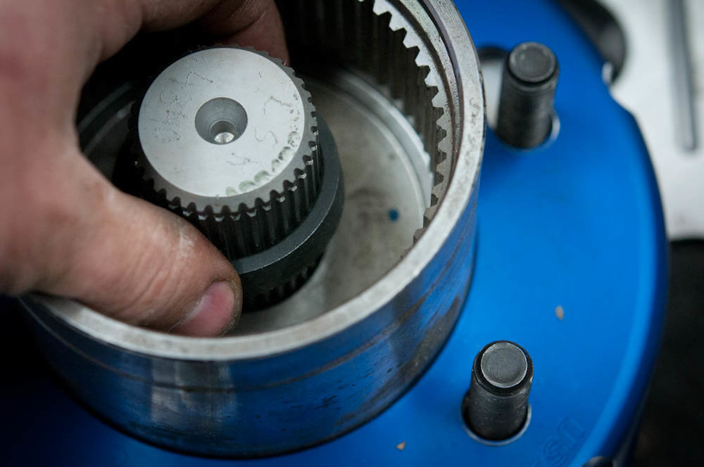

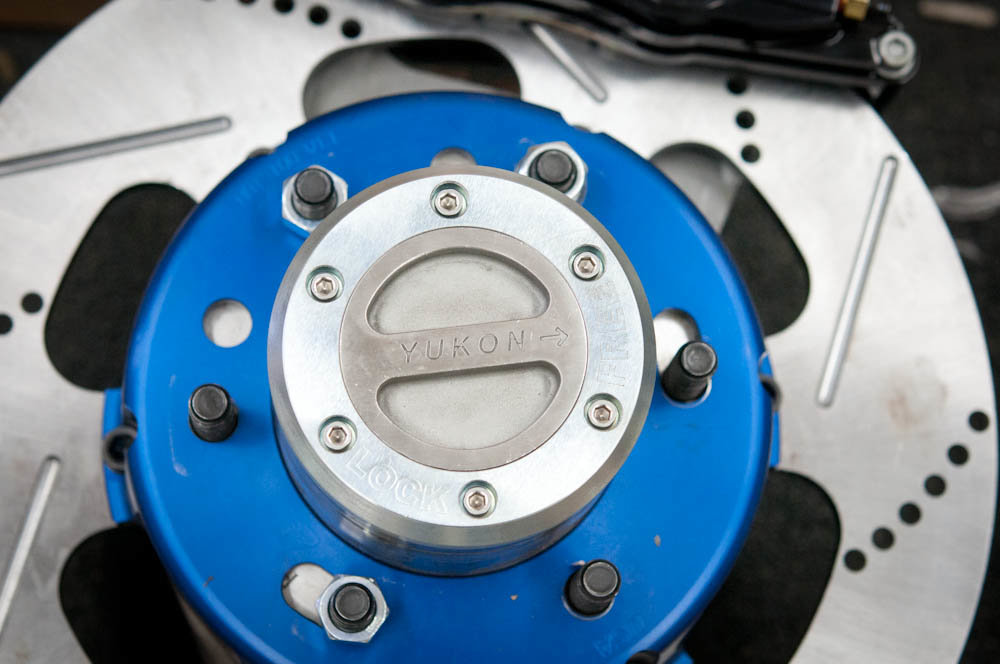

    I dry fitted the Yukon locks to measure for my shafts.

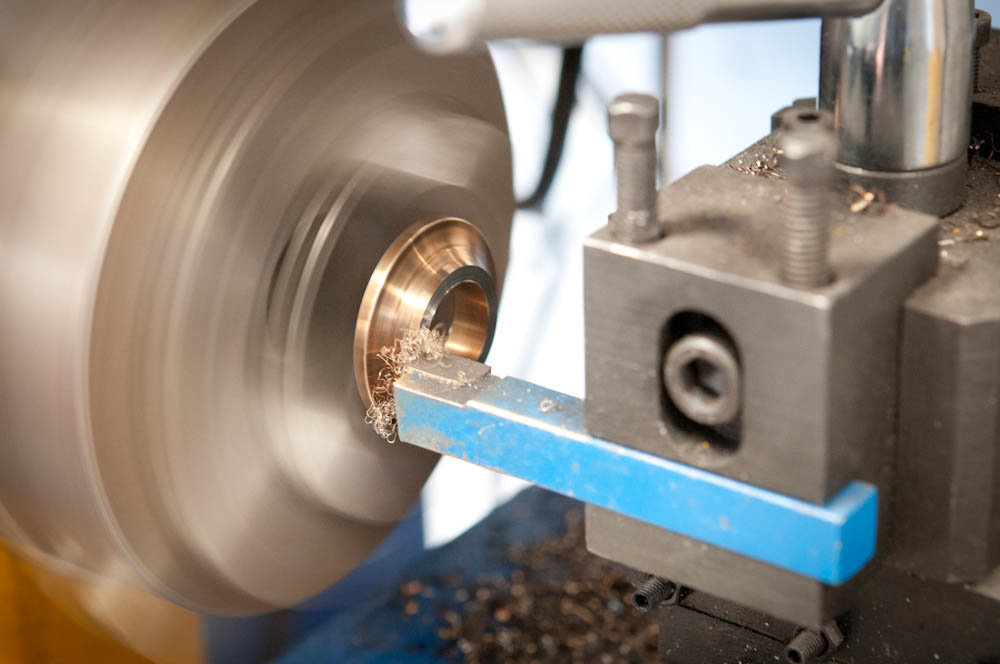

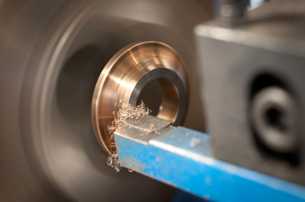

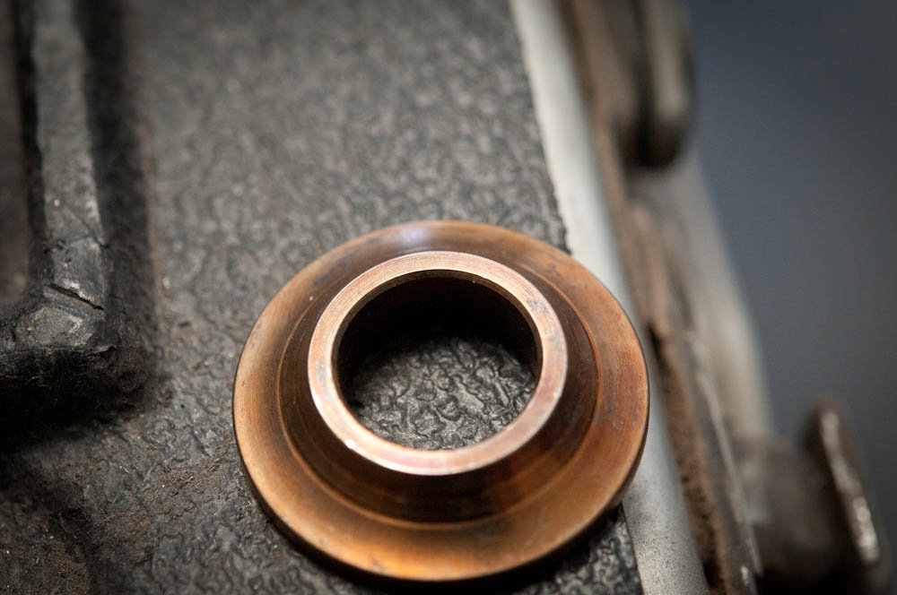

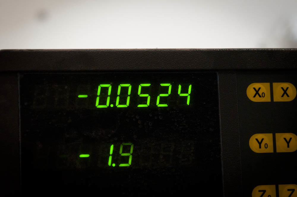

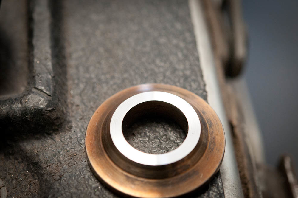

    Also the spacers for the knuckles just wouldn't fit on the lower side so I turned them down 0.0524" and now they fit like a glove :cool:
    Before
    After
    Stubs and calipers installed I'll be ordering my front and rear axle shafts this week.

    Damn, those are some easy ass calipers! Quick change pads for sure.

    Yeah they are I'm glad i went with the 6 pistons up front I just about did the 4's all around and oh fuck it I want the 6's up front :D

    Yeah when I called Willwood to talk about MC replacement I told him the stock one is 13/16th and I was wondering if I needed larger. He said if you want to do indos go for it but trust me those 6 pistons will stop on a dime with a 13/16th MC.

    Nice work! I didn't realize you had a lathe in your shop, soooo nice to have access to.
