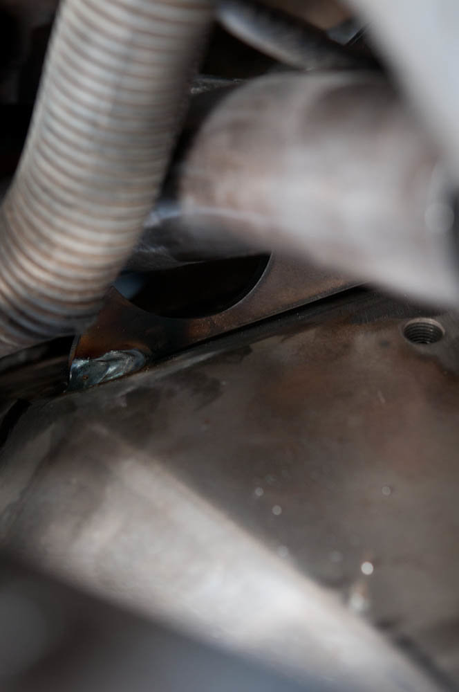

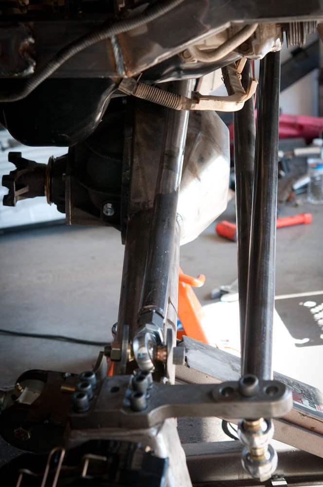

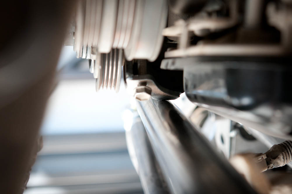

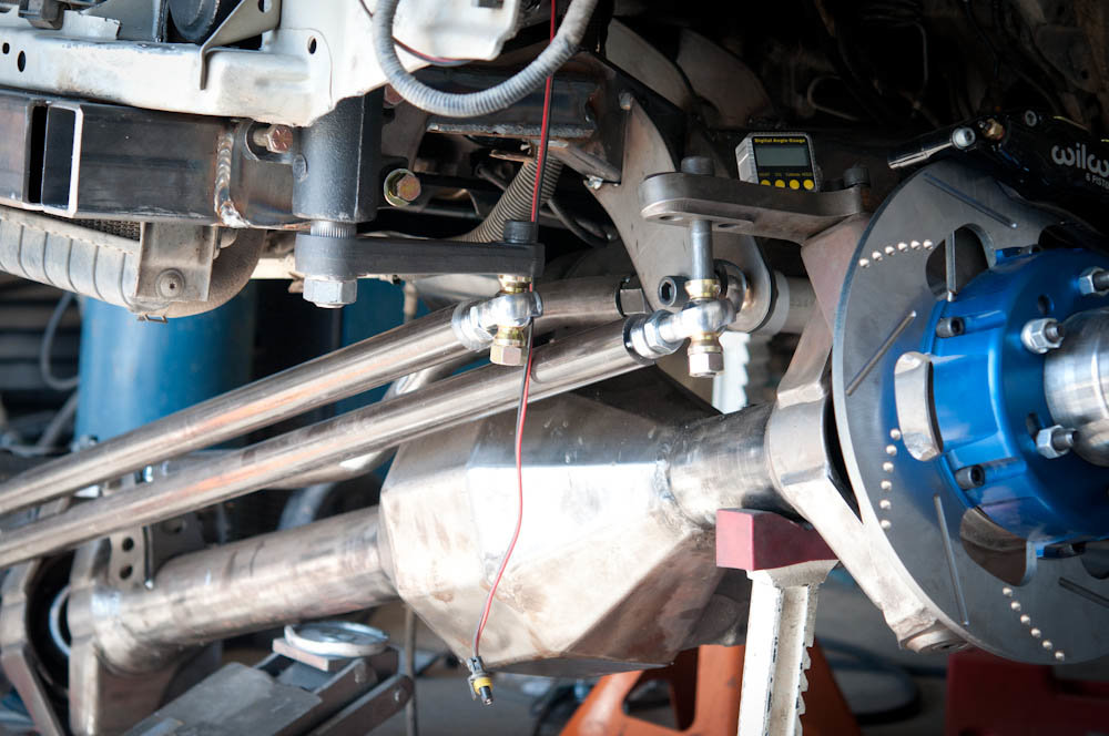

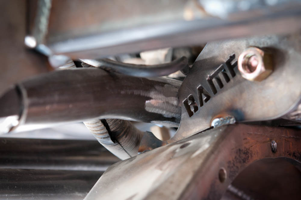

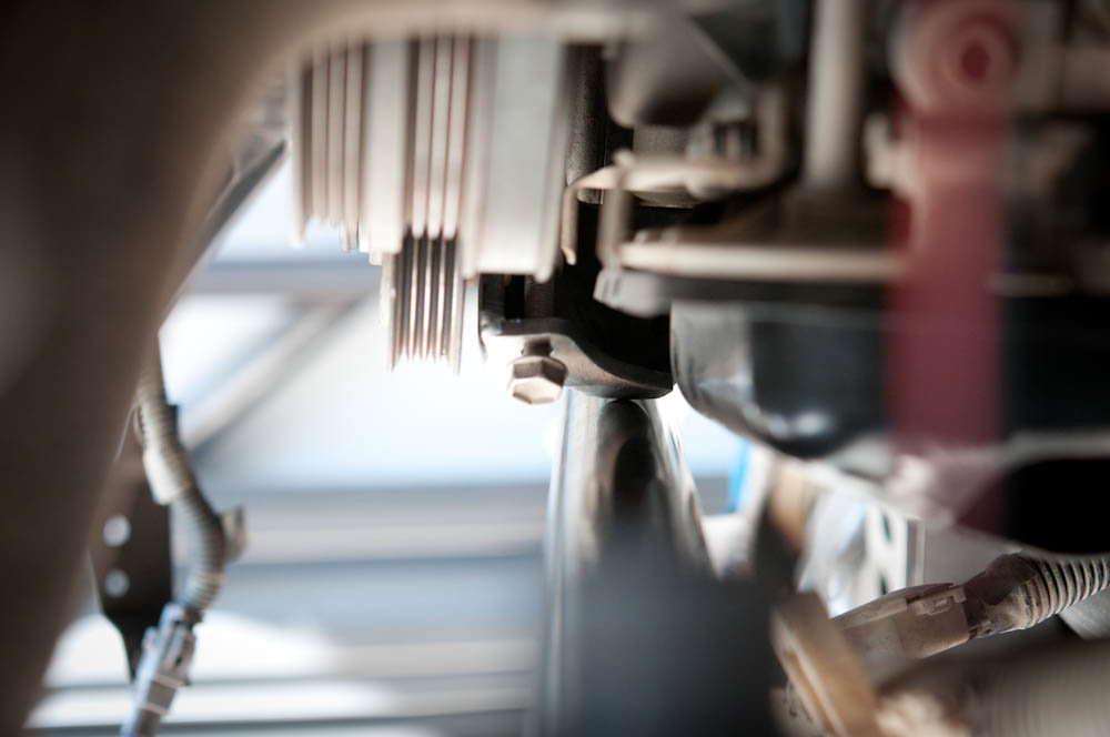

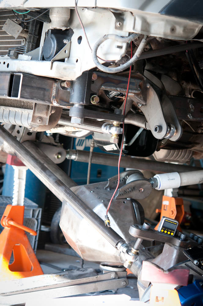

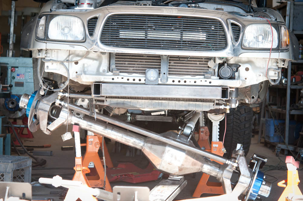

    Got the 5/8th drill bit today and drilled out the pitman arm and installed it. Cycled it and it looks good just a few miner tweaks need to be made. I'm bruning it all in tomorrow I did make the lower links i just need to make the upper. This thing will be sitting on 37's by Sunday :cool:
    One of the little tweaks that need to be done just a shave is all.
    I remade the hacked up upper link mount the panhard tucks right into it at full bump.

    any idea what your flex numbers are coming out to?
  18. Apr 18, 2013 at 5:13 PM
    #2138
    JLee
    JLee [OP] The Man! Vendor
    Jul 20, 2010
    #40461
    19,620
    Jerry
    Grass valley CA
    02 Extra cab SAS Linked front and rear
    I lost track thousands of dollars ago.
    14" of vertical travel 5" up 9" down :cool:
