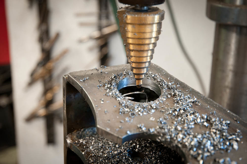

    So I just used an ultra accurate measuring device (my finger). I can't see how the hell you would fit the upper shock bolt in?

    Good eye bud ;) i didnt want to cut i big hole in the side of it just to have it off. So after it was all welded i drilled 3/4" holes in the sides.

    Ahh! I would call it more an "experienced" eye...as in I've made enough mistakes that required re-doing or modifying crap. I'd hate to see you have to rework something like a shock tower, but drilling a hole works!

    Yeah and the angle of the sides it was better to just drill out the holes straight down that way they are on the same plane with the bolts. I did open them up this morning a little more to 1.25" to get a socket in there fucking opened end wrench sucked dick removing that bolt this morning.
