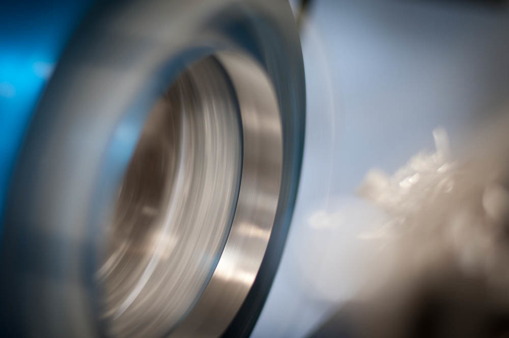

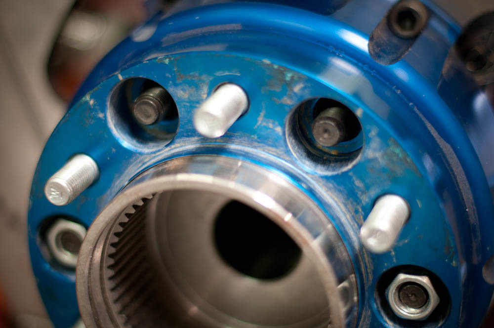

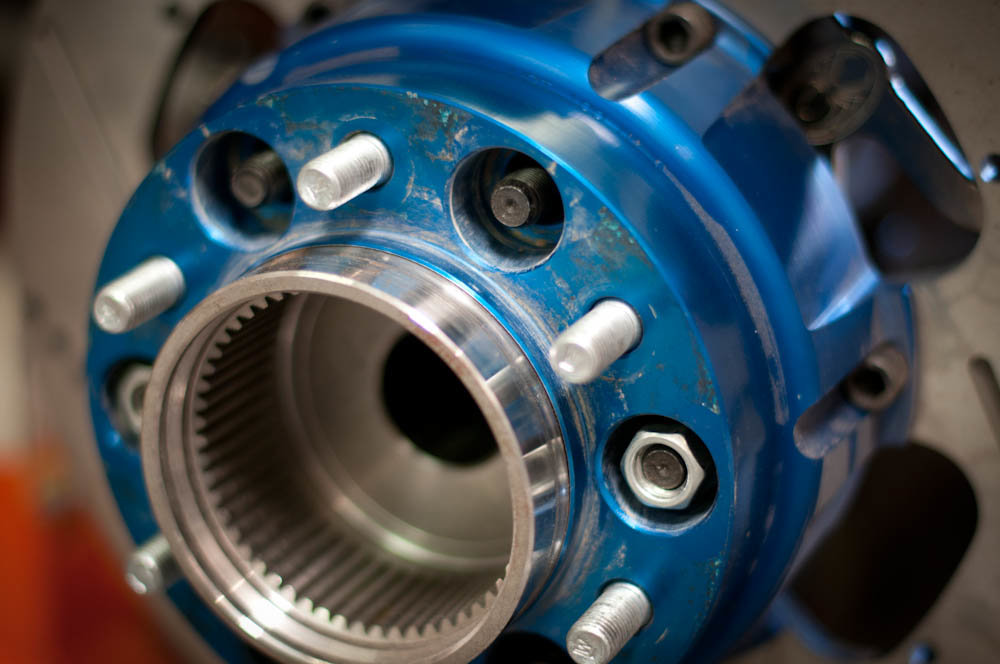

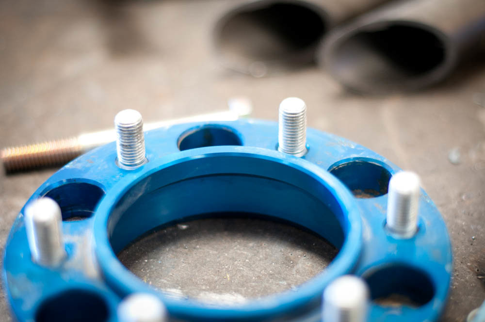

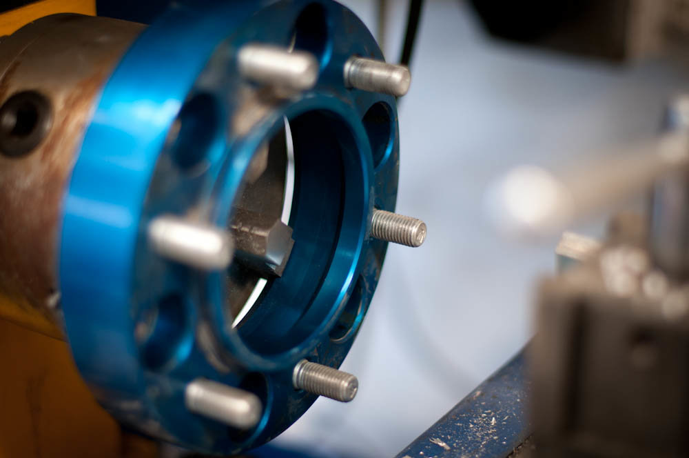

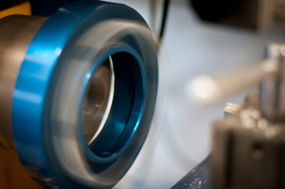

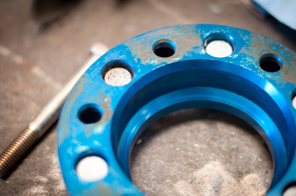

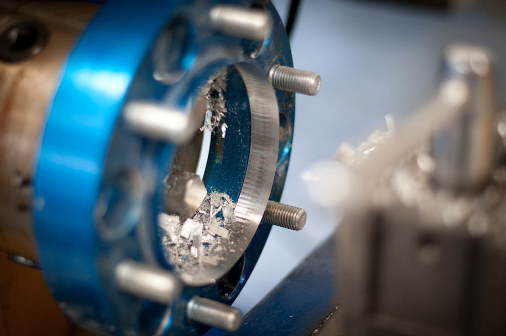

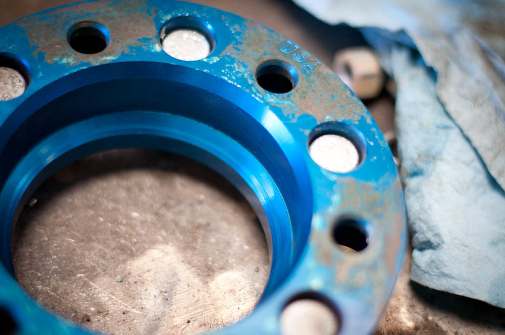

    I picked up some used SpiderTrax spacers to help push the wheels out some seeing how the 4.40" BS on my wheels is not enough. 3.15 should be good :D
    They are made for Toyota's so they won't fit the FORD unit bearing because of the lip without a little modification ;)
    So it was off to the lathe
    I turned them out and now they fit like a glove. I have to tap them on with a dead blow because of the perfect fit :cool: Now i should be good with my steering lock to lock.

    Why exactly are you running spacer on a custom width housing???? :eek::confused:

    he didn't make the axle. He got them "pre-owned" :D nothing he can do about it.

    Because my wheels have a 4.40 BS and I will contact my steering box and links at full lock. So it's buy new wheels, spacers or Limit my steering. I went with spacers. Also the front housing was 1.5" more narrow then I was told when I bought it. If it was 65.5 like I was told I wouldn't be having this problem.

    Should put some ARP studs in those spacers :cool:

    Yep I was already thinking about it :)

    I did not buy it from Diamond I bought it from a guy on Pirate. And he bought it from a guy on TTORA who said it was set at 65.5. But who know's he could of been planning on using different parts then i did. Maybe the spidertrax unit bearings with their hats are not the same as others. It is what it is and it's too late to go back now. I might pick up some bead locks in the fall or late summer so then I'll get a 3.25" BS and not have to use the spacers.
