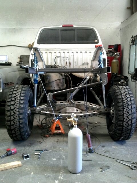

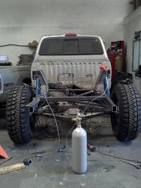

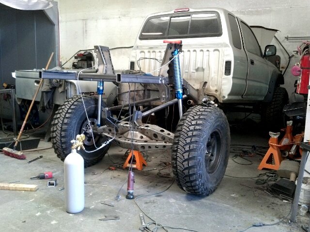

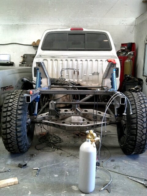

    i went in yesterday to get the truck on all fours for the most part. Its on tires to just move it so i can get to my slider jig. There is still quite a bit of little things left to do to get it back on the road but its getting there. fully weld everything, add gussets, plate the oil pan, measure for drivelines, measure for brake lines and have them made, put it all back together.

    interesting way to lift the rear

    Those ORI's look nice!
    One question...how come the short panhard? That axle has alot of side-to-side movement...you can tell by looking at the pictures how much lateral movement that thing has.
    It just looks like there is plenty of room to run a much longer panhard and eliminate that much movement.
